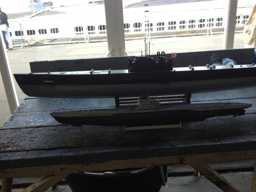

    1/72 Lindberg I-53 to B-3 Class I -58 build

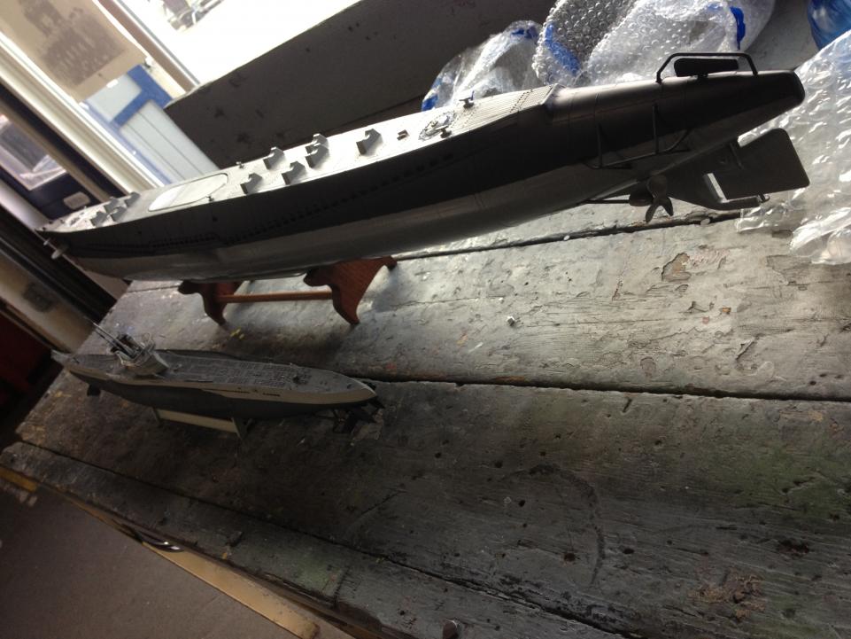

    Here are a few more pics, If you see a Balao Class sub in the back..its my workplace U.S.S Pampanito
  • Scott T
    • May 2009
    • 414

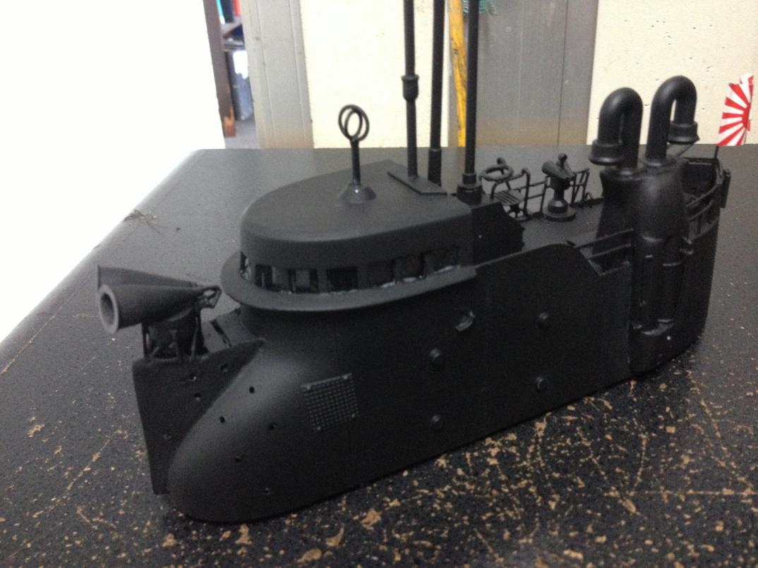

    Sounds like a great place to work if you are into submarine.
    The bridge detail looks cool that you have done on your I-58.
    What are the horn devices used for on the sub?
    Scott T
      • 3768
      **** Jealous ****
      That is a nice 1/72 fleet you have going there.
      Are you going to RC this sub? or make it a static display?
      Peace,
      Tom

        Hi Scott,
        Thanks I have been working on Museum ships for almost 20 years. The Horns are the search Radar the Japanese used on their boats. Not sure exactly how they worked but doing some research.

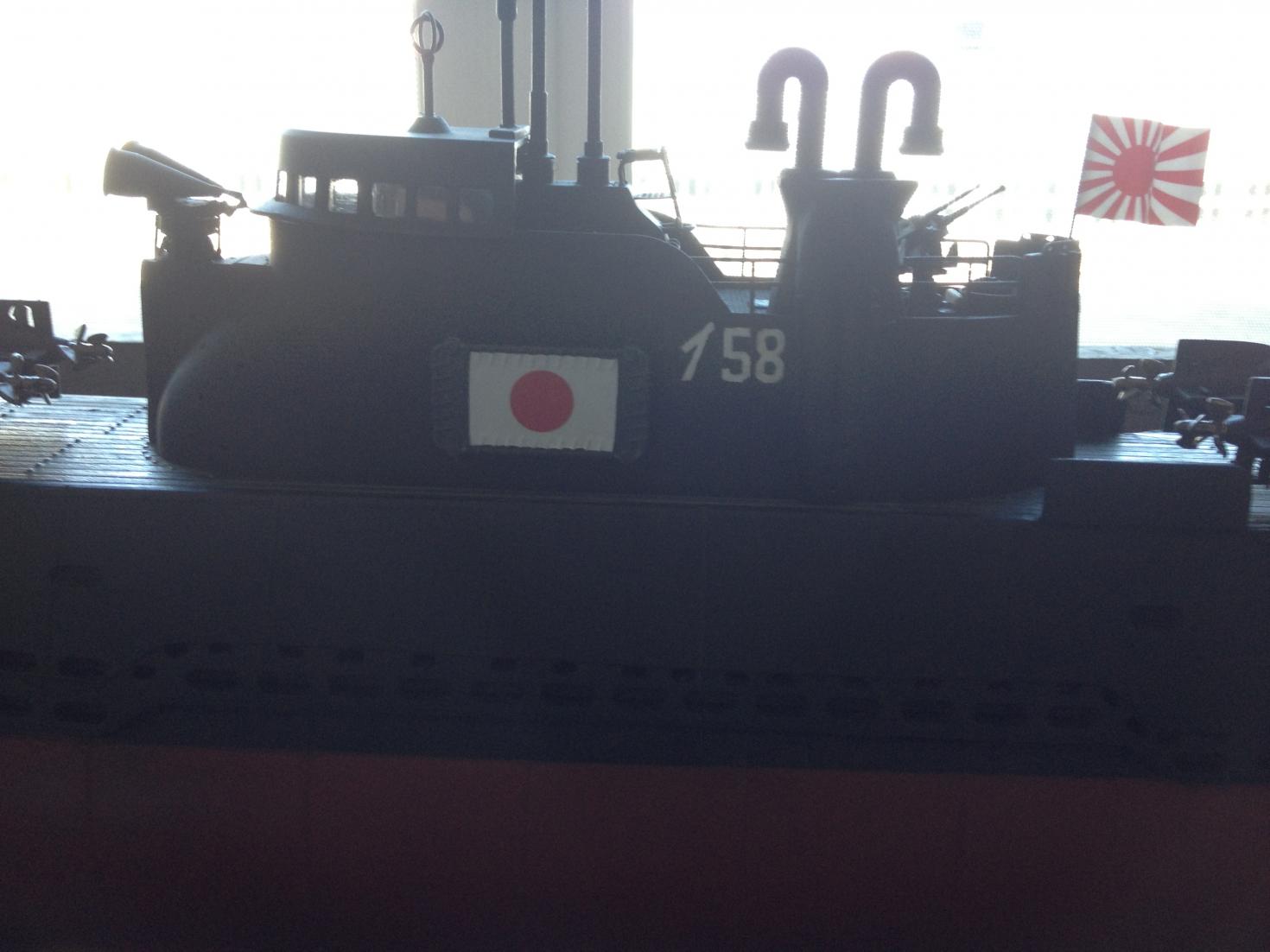

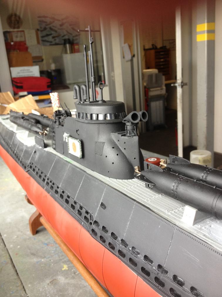

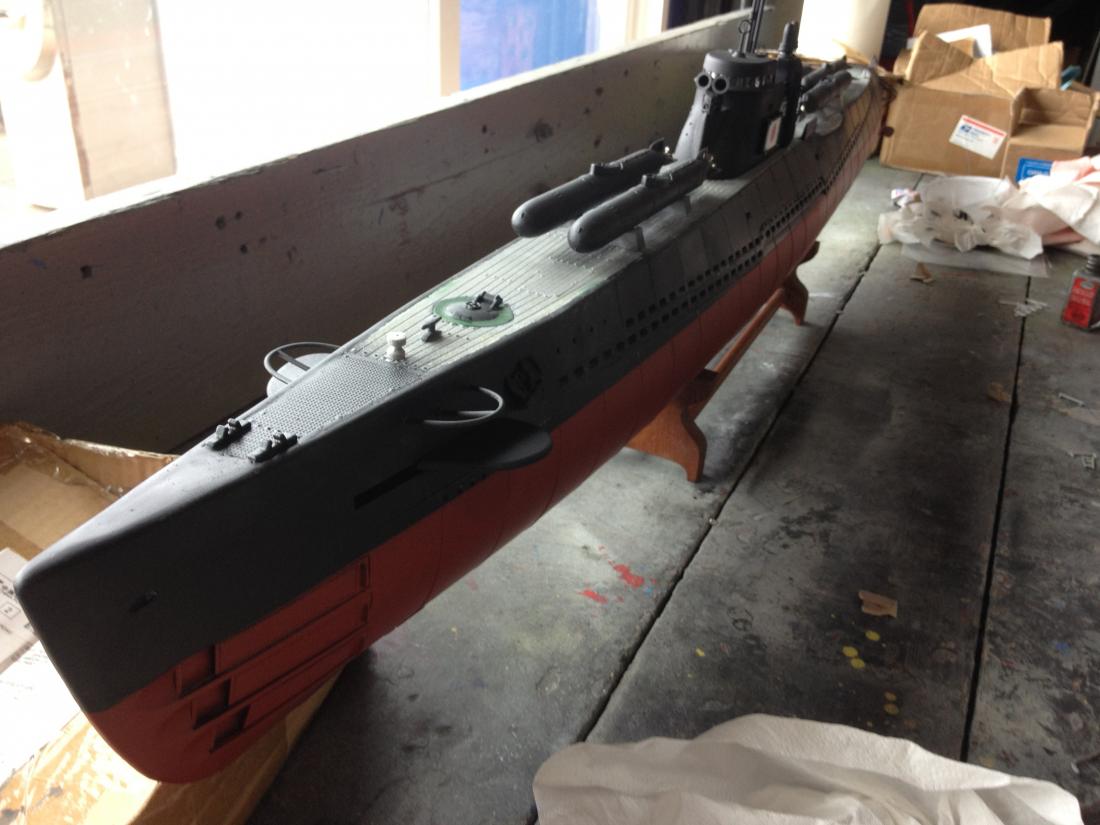

                1/72 I-58 build photo update. Progress is slow but almost ready to start painting the deck and adding some additional bow details. I broke the rudder last night so I will need to pull the post out and do a major repair UGH...Click image for larger version
ID:	83623Click image for larger version
ID:	83626Click image for larger version
ID:	83634Click image for larger version

                  Looks great! Did you have to modify the bow? Any in process shots? We luv pictures.

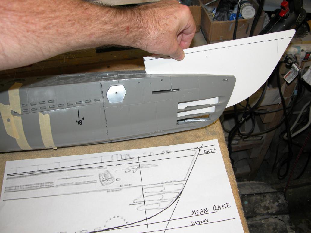

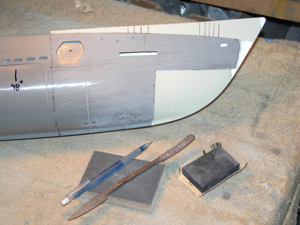

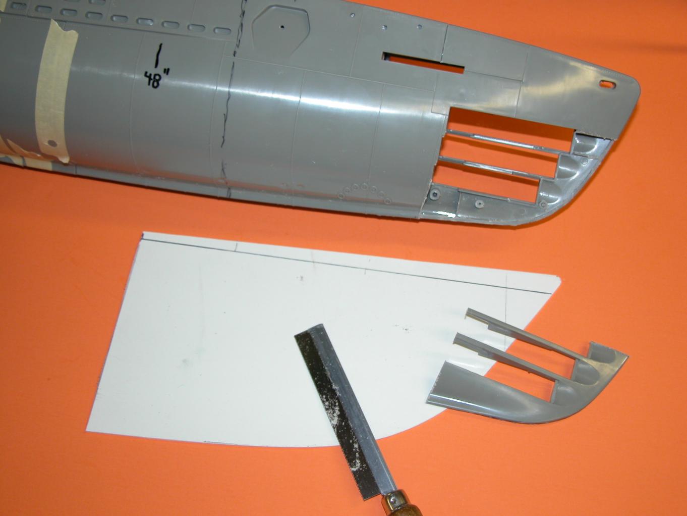

                    Hi Scott,

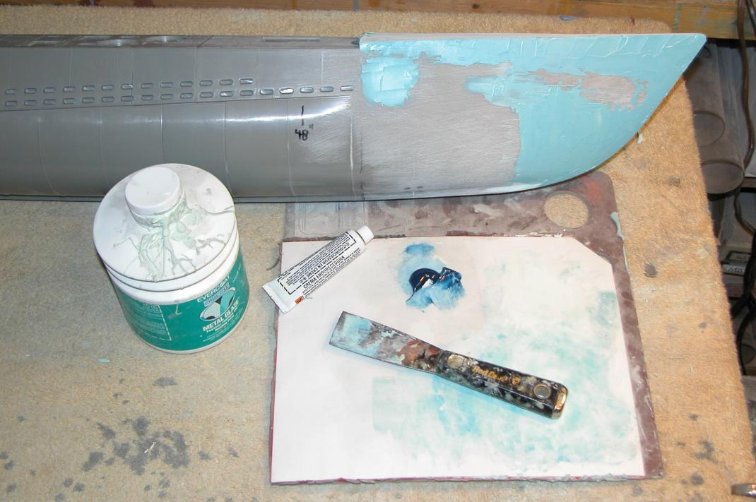

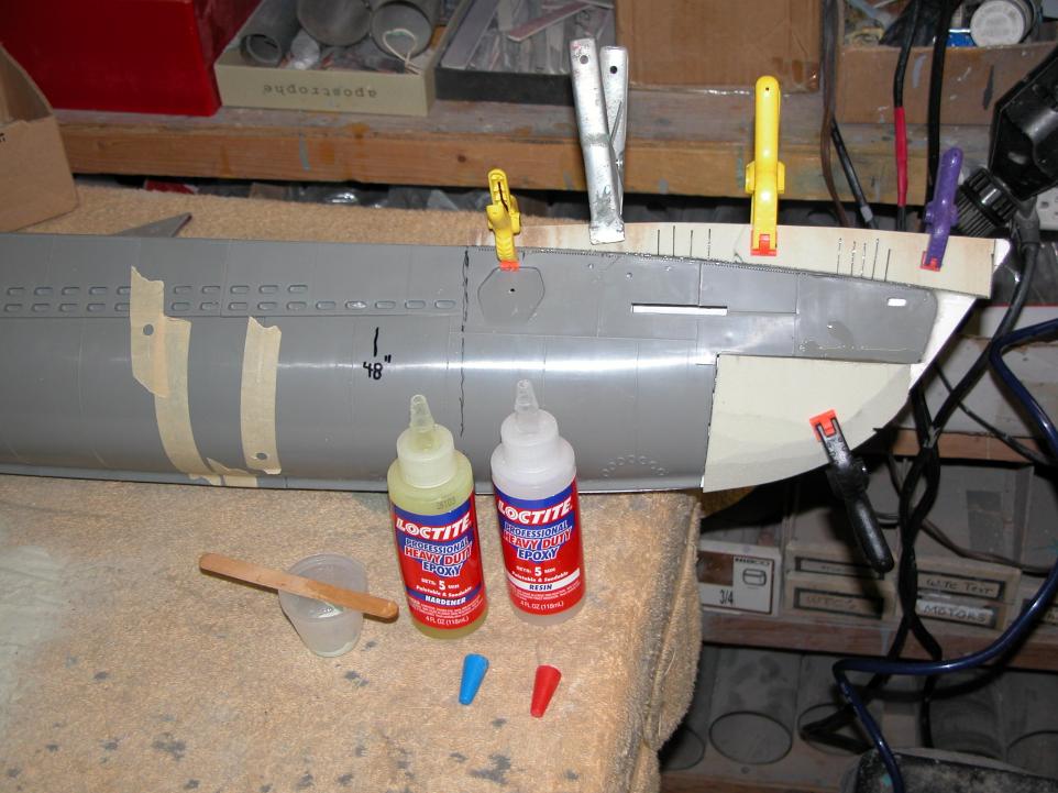

                    When I started this project 3 years or so ago I did not have a camera, however I will list the steps I took to modify the bow..
                    I was happy last week when a fellow modeler told me it looked nothing like the mix up in the Lindberg box, all that has been
                    said this has been a great scratch building experience.
                    Bow modifications.
                    1. I found drawings and photos of a B-1 and B-2 Class Japanese subs for reference.
                    2. Built up bow frame work from Plastic styrene strips.
                    3. Found a 1/72 SU-7 Russian fighter kit in my collection with no fuselage? so I measured
                    and cut delta wings down for use as hull plates.
                    4. after gluing in place I filled and covered with miliput and sanded smooth when dry.
                    5. I used Gray primer on bow and look for cracks and irregularities. Then used Tamiya
                    putty to smooth out cracks and gaps.
                    6. Painted and modified the bow a little more until it looked right to me lol.
                    7. I will use some more sprue strips along the hull to simulate the metal moldings particular
                    to the type. Sure wish I would of had a camera but so far it looks right compared to what it
                    started from.
                    Happy modeling,
                    Keith

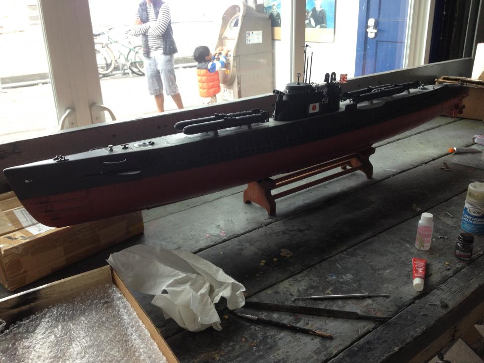

                            • kalakid383
                              • Jul 2013
                              • 17
Name:	Moble uploads 149.jpg
ID:	84174Click image for larger version
ID:	84175Click image for larger version
ID:	84176Click image for larger version
ID:	84177Click image for larger version
                              I bought the I-53 kit while the 1-20 was on pre order, and kinda had a premonition that the 53 was really off. It was pics on this site that motivated me to begin this as a scratch building project, a nightmare at first but fun after that.. its what true modeling is about right? it gained momentum when my I-20 on preorder was cancelled. I am posting some new pics and have been experimenting with the deck weathering this last week.
