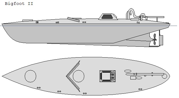

          What if you make a bend in the induction line that is higher than the inlet valve opening to limit any water ingestion like on these
          narco-semesubmersibles exhaust.
              [ATTACH=CONFIG]20969[/ATTACH]
              I don't think a bend would make all that much difference as the LPB pump has a pretty good suction so you'd still get water droplets drawn in.

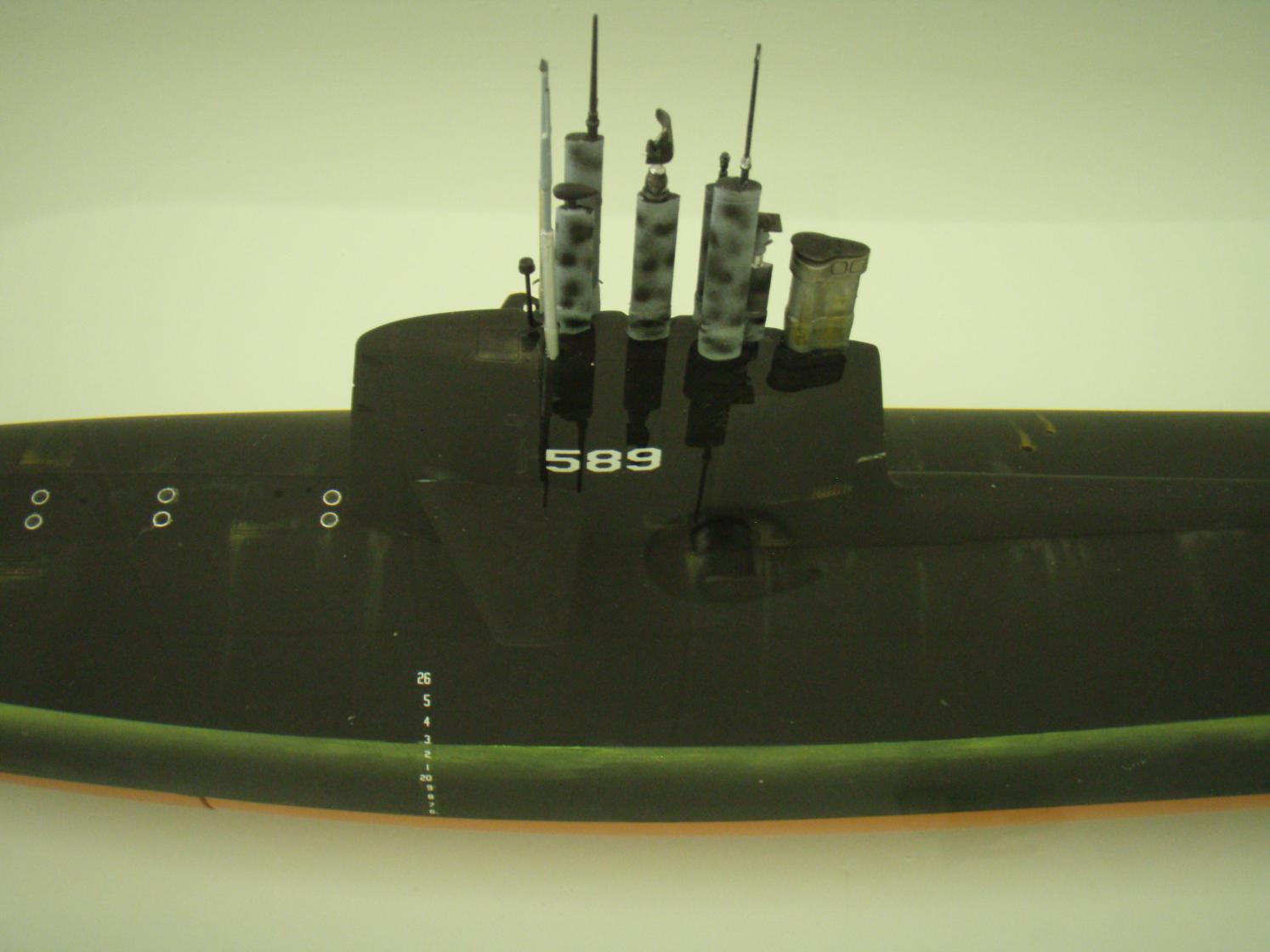

                      #85
                      Thanks David and I'm pretty sure it will.Since my previous post I had it out a couple of times with some quirks happening on the first run. It started the whole porpoising thing... Back on the bench I went through the gamet of tests starting with a good check of the planes for free movement then the the receiver and battery follwed by the adf and its functions and zero bubble recalabration. There was always some clutching on the servo for the rear planes but adjusting the sensitivity usually fixed that... But not this time. It turned out the servo for the rear planes went bad!! It was erratic and then wouldn't throw left and with each attempt it had a fit. So out it came and it was rather hot to touch to boot. Replaced it, retested everything then turned it off. Came back later turned it on and tested it all again readying it and recharging the batteries for last Sundays run. which except for the rain was beaut!http://static.photobucket.com/player...ps4e1998c0.mp4I took this with my mobile so apologies for the picture.

                        • 13990
                        #86
                        Best weathering job on this beast yet. Well done, sir!
                        I bet you had to dial down your throttle end-points a bit? This thing will scoot!

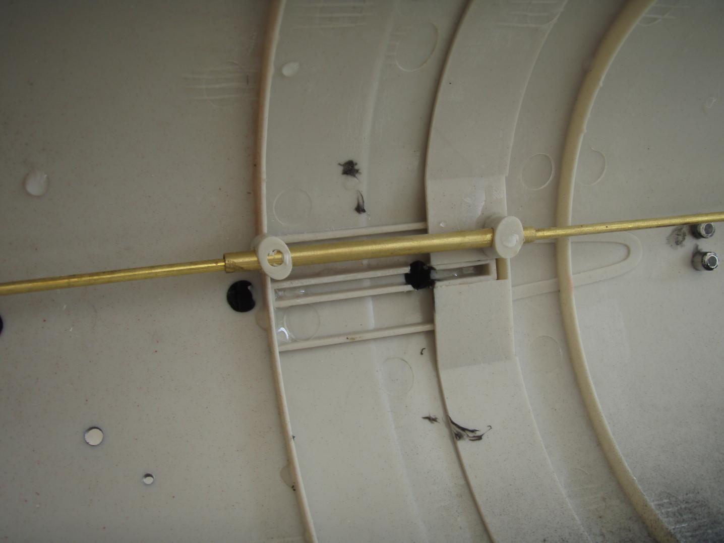

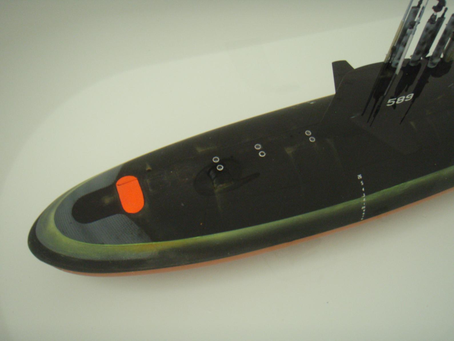

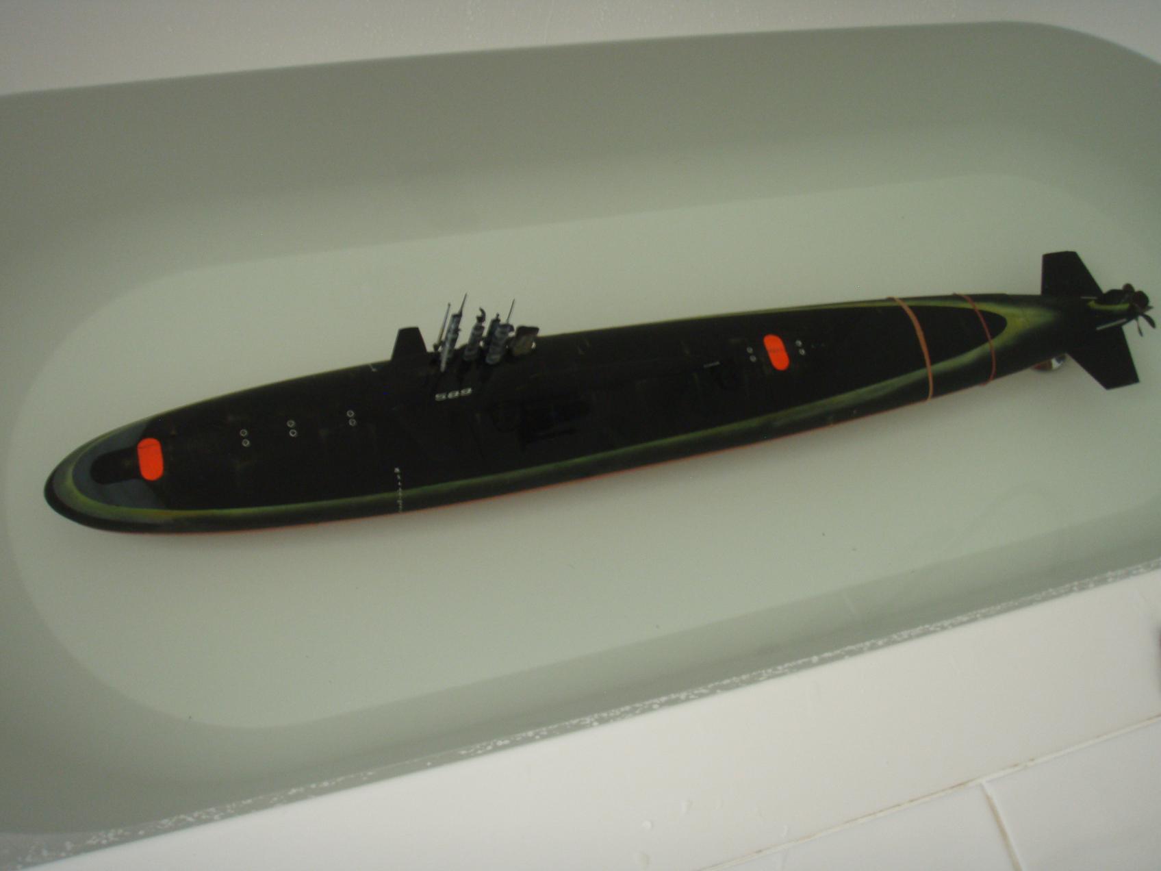

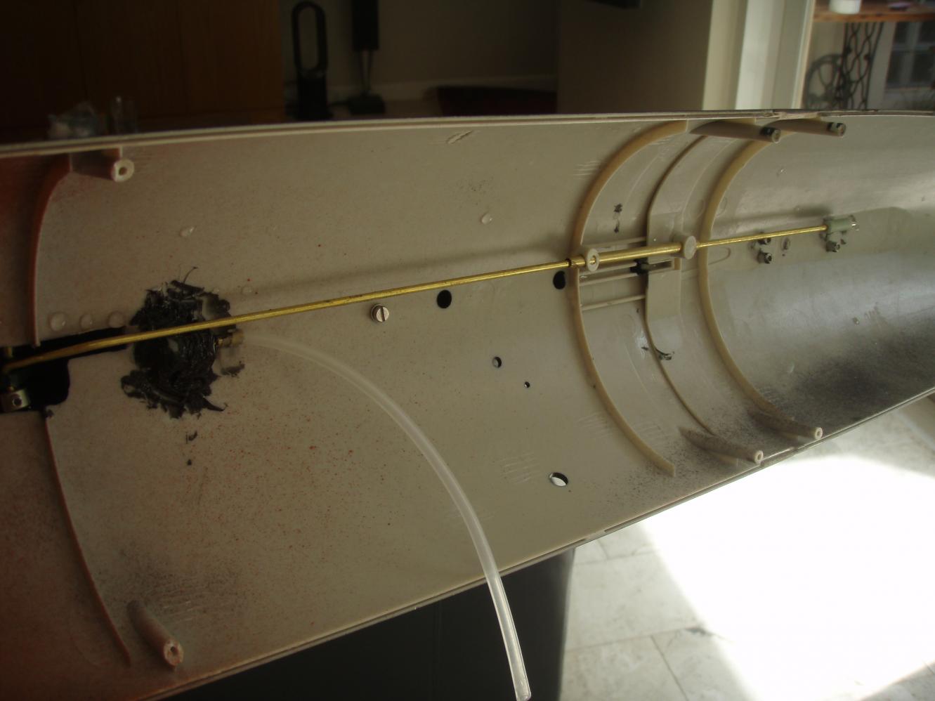

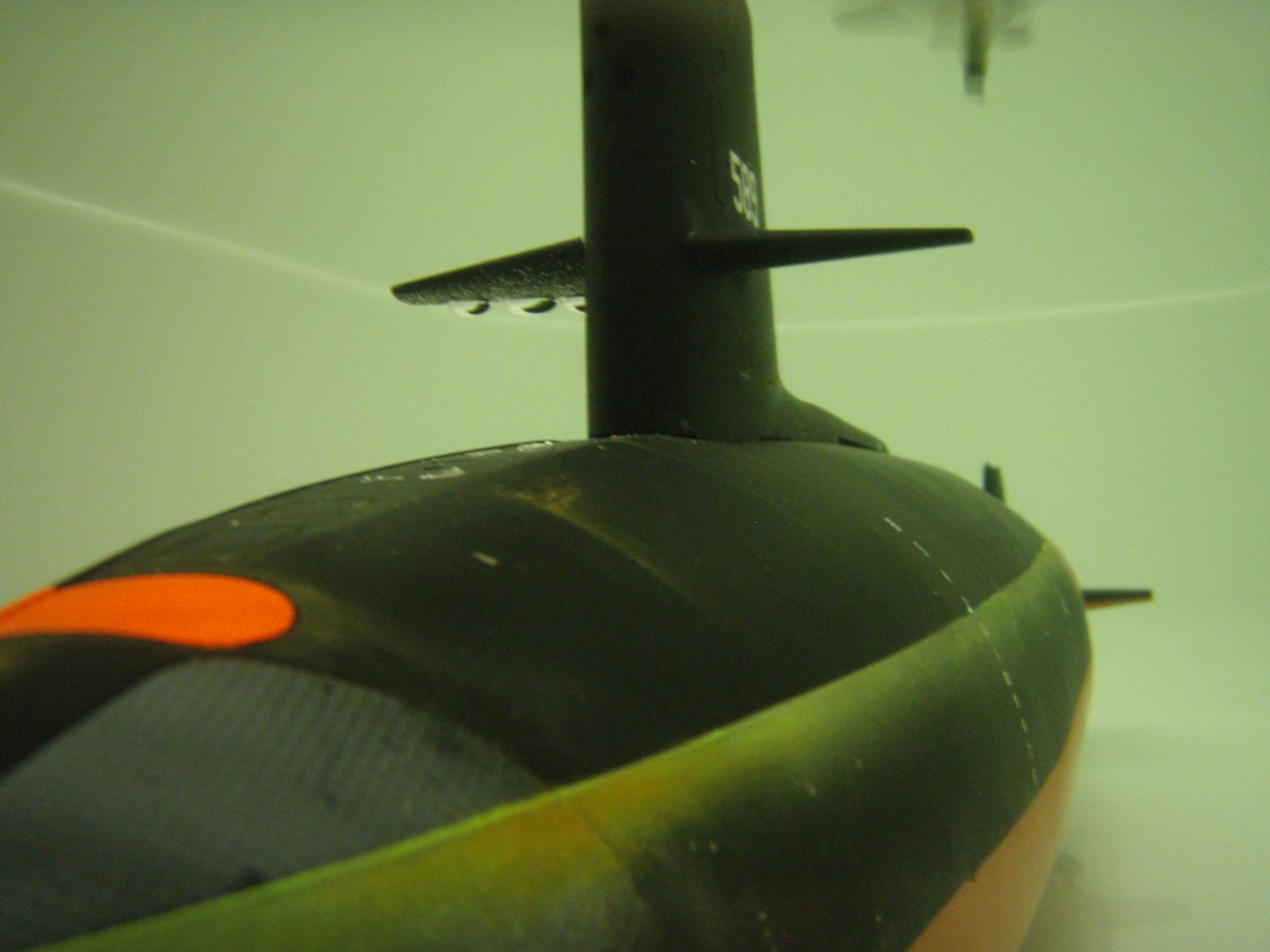

                                I came across this entry earlier today (Sunday here) and suddenly it made the whole trim thing understandable. So I spent the rest of today - simply - trimming the boat. I've decided that I need a bigger bath tub incidentally. It now sits happily with the top of the sail just underwater (in fresh water) and just out in the swimming pool. Also found that I kept loosing the sail planes linkage so I made a small modification to more easily locate the control rod.
                                Thanks for the information. Its made a great deal of difference!
