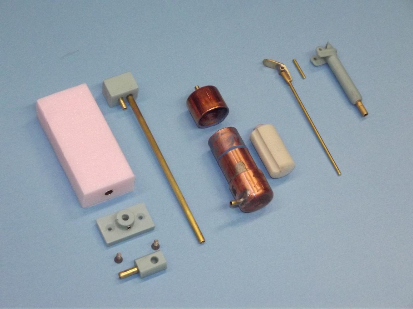

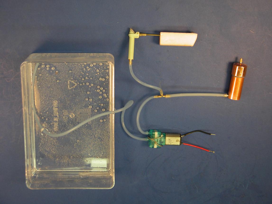

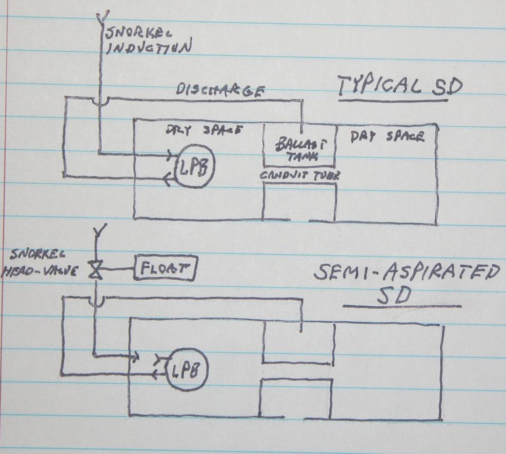

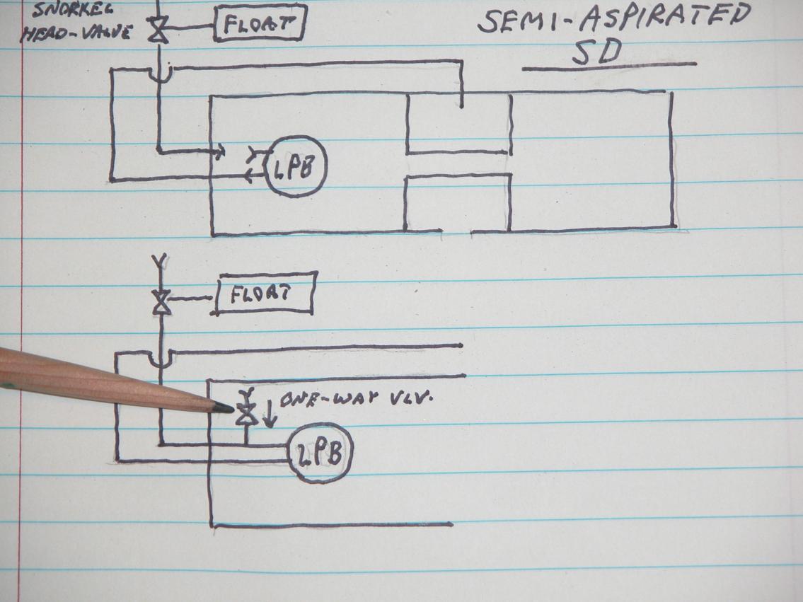

                  Myron's point about too many holes in the SAS system is valid, and a source of concern for the operator of a model submarine employing this type ballast sub-system. However, the inclusion of the safety float-valve in the plumbing of the Caswell-Merriman SAS equipped Sub-drivers addresses the potential of a flooded induction line -- regardless of cause. The SAS, as compared to the gas or Snort ballast sub-systems, is indeed more complicated. But that added complexity is, I think, offset by the SAS sub-systems ease of use and ability to blow out ballast water from depth or at the surface. The SAS ballast sub-system is a simple and reliable means of managing ballast water without the need of gas and gases attendant trim and logistic problems.
                  One more thing: I want to take this opportunity to remind everyone that the SAS ballast sub-system I came up with is very much a copy of the fine work done by Manfred Reusing -- he's the guy who lead the way. I simply followed.
                  And it's no accident that Manfred's system is very much predicated on what actual combat submarines use to manage their main ballast tank water. The SAS very much emulates the design and function of 'real' submarine ballast systems.

                    [ATTACH=CONFIG]20904[/ATTACH][ATTACH=CONFIG]20905[/ATTACH][ATTACH=CONFIG]20906[/ATTACH][ATTACH=CONFIG]20907[/ATTACH]
