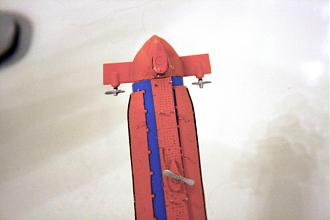

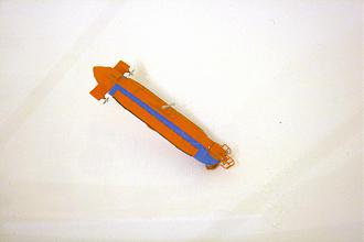

              Painted the the props aluminum. I have seen photos of them painted white or gray, I chose aluminum because the Aluminaut was the first to use aluminum hull for a deep sea vehicle. Checked the reference photos and added the props.
Name:	Aluminaut research submarine 135.jpg

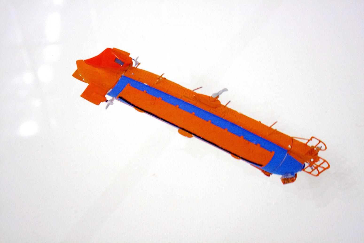

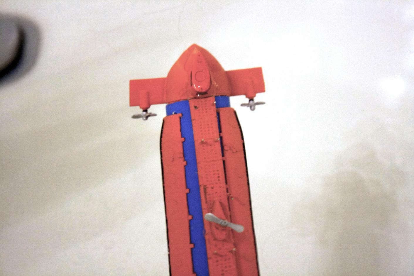

              Assembled the parts together and placed the sub in the water. The Aluminaut is nose heavy.
Name:	Aluminaut research submarine 136.jpg
Name:	Aluminaut research submarine 137.jpg
              But the piston ballast works very nicely.
Name:	Aluminaut research submarine 138.jpg
              I will need to reverse some of the servos and one motor does not turn as quickly as the other when the command was given. The people blender (being run by crazygary's ESC) works like a champ. I will need to limit the power to it. Just a small amount of power and it moves.

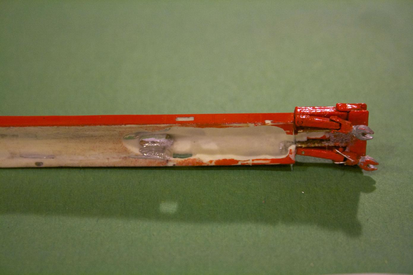

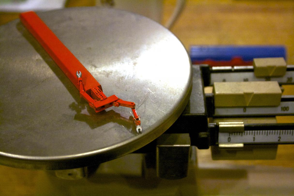

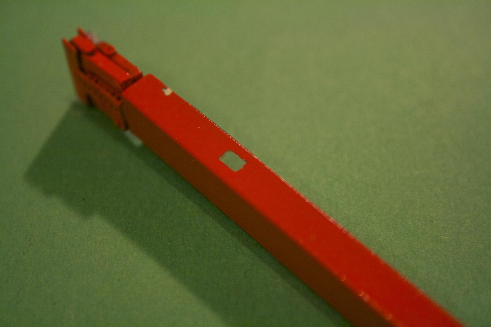

                      Removed the keel, benefit of using an RTV silicon.
                      It weighed 20 Grams. So if I took out 3.5 grams I can add weight if needed, but I will also be adding a light bar at some point.
Name:	Aluminaut research submarine 139.jpg
                      Hollowed out the front were the foam was and worked my way back.
Name:	Aluminaut research submarine 140.jpg
                      Cut open the sides were some scribing was for flood holes (the front is scooped out as an exit path too)
Name:	Aluminaut research submarine 141.jpg
                      Weighed the bar and hit 3.5 grams removed on the nose!

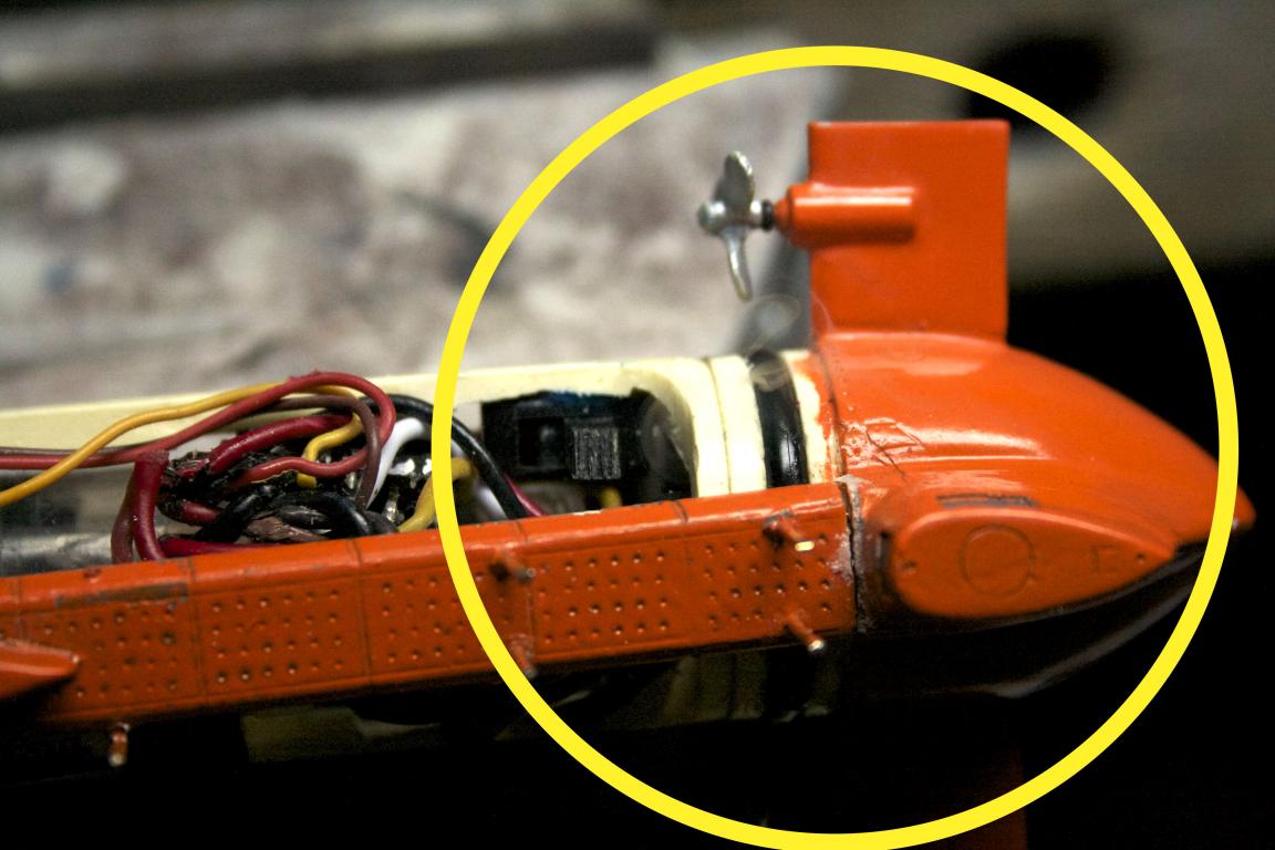

                        .....my world began to go up in smoke. Look carefully at the picture.
Name:	Aluminaut research submarine 142.jpg

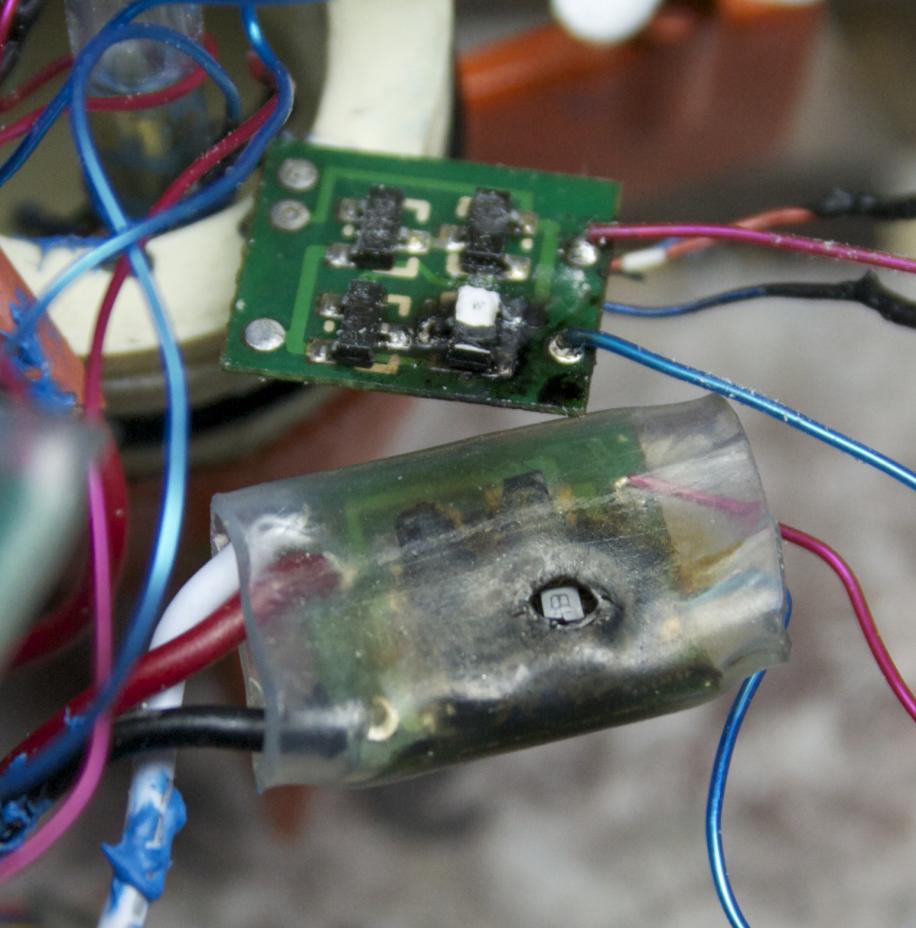

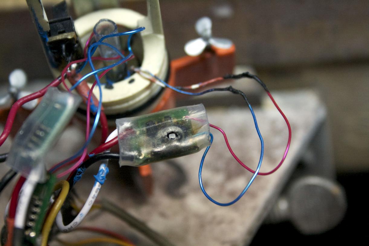

                        Yes, billowy, curling, wisps of electrical meltdown AGAIN!!!!!
                        I went to bed and today after work (I had cooled down significantly) I went to investigate. This time it was the port motor. Here is what it looked like.
Name:	Aluminaut research submarine 143.jpg
                        Interesting, it is the same location on the board that died. So, until I can conclusively rule out these are bad ESC, DO NOT BUY THEM! I will contact the company I bought them from and see if there is any suggestions on their part.

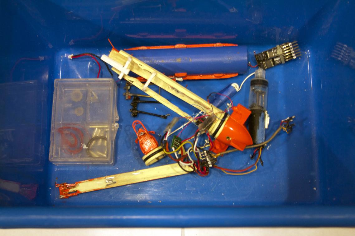

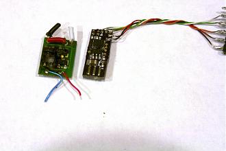

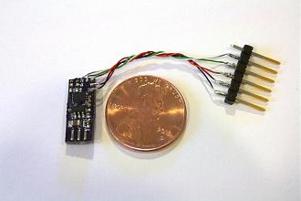

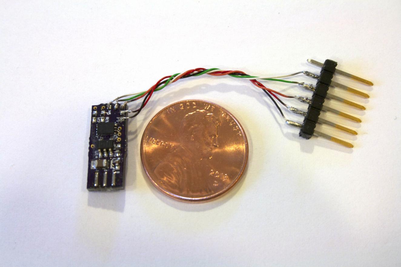

                              Just a small update. Adam Carlson has created a very small ESC for me to test out in the Aluminaut.
Name:	Aluminaut research submarine 146.jpg

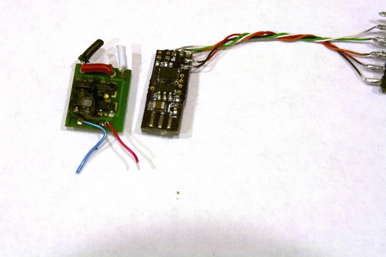

                              Here it is the one that self destructed (left) next to the new one (right)
Name:	Aluminaut research submarine 147.jpg

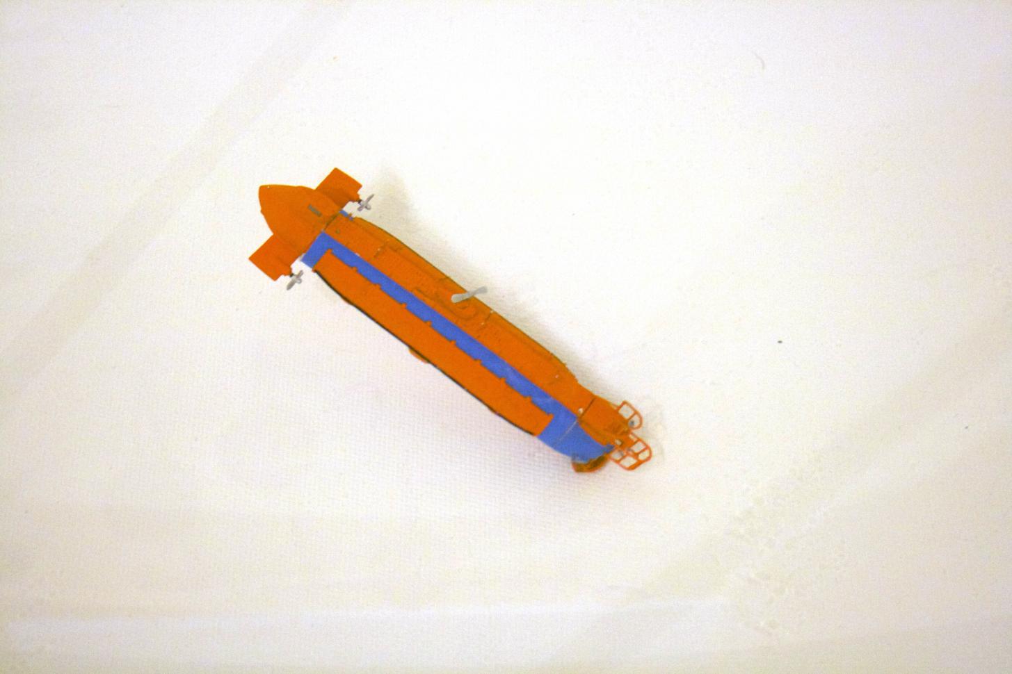

                              Time to dust off the parts and bring life back to this sub!
Name:	Aluminaut research submarine 148.jpg
