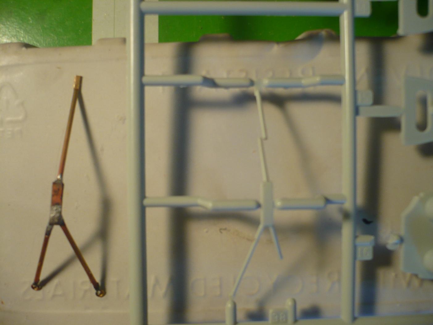

When I eventually start my own Type 7 conversion, I too want to replace the kit rudder support skegs with beefier brass rods. But I plan to flatten the ends so I'll have something to drill out.

I see what you mean when you say eyelet, now. Fill the eye with CA, hit it with zip-kicker, then drill a .032" hole through the CA. Done.

You did that work with a 'hard' silver solder. My hat's off to you.
All soldering and brazing is a means of adhering one metal to another through introduction of a plating metal of low melt temperature (lower than the melting temperature of the metal parts being joined). The higher the melt temperature of the soldering metal or alloy, the closer the possible interaction between the atoms of the associated metals (the solder and the metal of the parts being joined).
And for those looking over our shoulder: Soldering is not welding -- there is no fusion between the metal parts, only adherence as a consequence of atomic binding forces between adjoining atoms. Soldering is adhesion, not cohesion. There is no chemical change involved in soldering (disregarding the chemical changes to the surface of the participating metals induced by a cleaning flux or rosin).
All that to say that silver-soldering employs a solder of considerable temperature -- more difficult to do than soldering employing lower temp. solders such as the classic Lead-Tin, and Tin-Antimony. Well done, Shane.

You still need to punch holes in your metal part to accept the bearing pins of the rudders and stern planes? A .032" drill bit will do the trick.

i can use that?..... might have some in the garage..i thought i read you said the depron foam for airplanes...??? might try that as well...by the way what is soft-soldering.. is that like wicking solder to brass pipe in plumbing?..not familer with the term.. i had to do siver soder for stuff on other projects includeing the target boat mast tops..its never as pretty as i would like it but i keep at it and it's a little better every time.. and a comlement from you is awsome... i was afraid to show it. i think the mast tops turned out better.. need a smaller tip for the iorn or just need to get a good one...that ones a rough fit based of the broken one on the sprue. would like to find a way to reduce the eye holes in the end to the rudder pin.gotta put some thought in to that next.. thank davidLast edited by satlite440; 08-05-2012, 07:53 PM.Leave a comment:
Shane,
First, nice job on the silve-solder rudder-skeg support structure. Me? I would have soft-soldered the thing, but ... what the hey.

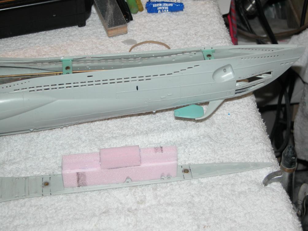

You're putting so much effort into that spongy foam when you would be much better served just to carve out what you need from the closed-cell foam from the hardware store (the pink or blue stuff, not the white).

foam and scrach built rudder support

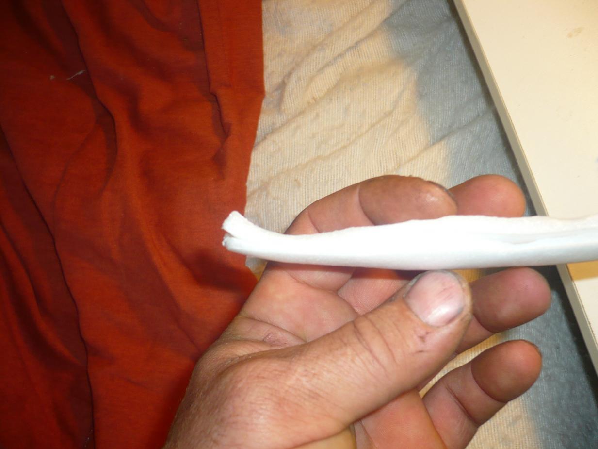

so after sunday chores were done made it up to the hobbie shop.got some depron foam discused in a previous thread.. rough fit it.while talking to the guy there,he said you could mould/shap it with a heat gun(note to self DO NOT get caught with the wife hairdryer or her embossing powder gun without asking again) so i had to give it a shot.. think it was to much heat so i have a question if the depron gets too hot and shrinks a little does it loose its abilty to produce floatation in water? this is a trial run got a whole sheet to practice with,, also going to try the bread&butter style and give a shot at shapeing it... so if you skipped the the pic's 1st i am not responsable for any liquids sprayed on your moniter.if you havent looked swallow now before looking.. so the rudder/skeg support was broke during shipping so this is my 1st attempt in silver sodering in 2 yrs or so,it's not great but it did roadtest the concept going to try brass tube and music wire toether after i pick up another stand as 2 aligater clip will not be enough to hold the wintergarden together as i solder around it..hopefully will have pics of casted weights tomarrow if i have a few extra minets on the gmc envoy moter replacement.but its monday so it will be a mad house at the shop......shaneLeave a comment:

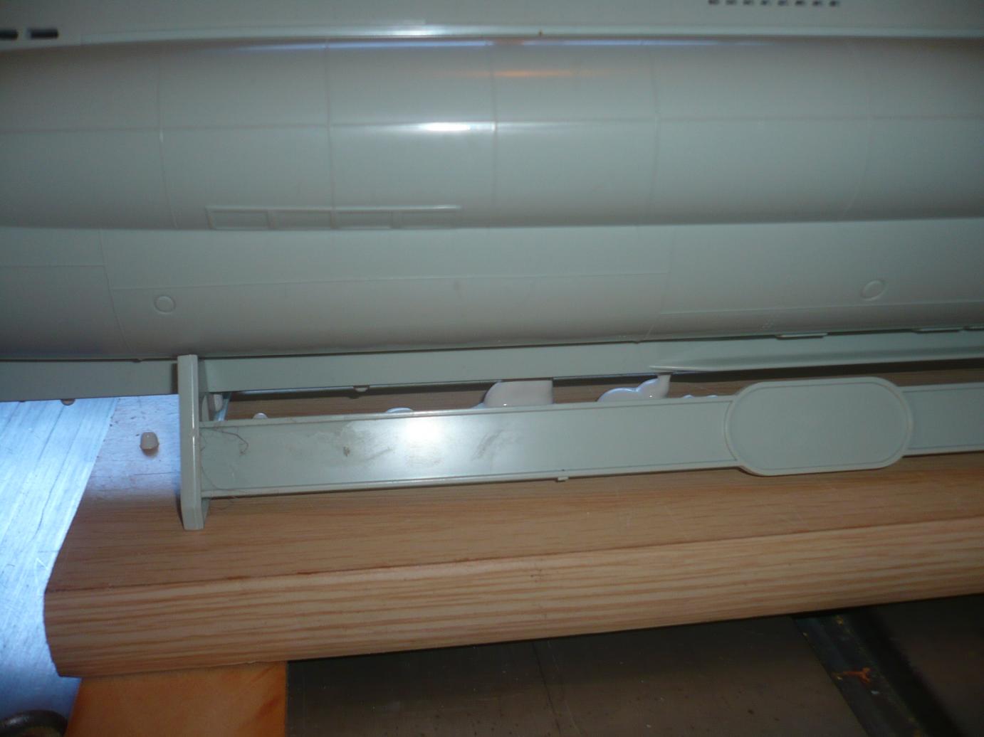

Yes, you've punched out enough flood-drain holes. The only holes you need in the deck are those six or eight round holes where the retractable bollards are. open those up and you will adiquatly vent the deck.
Don't make the lead weight fixed ballast any more complicated than you have to. Cut and hammer to shape enough lead to fit about 2/3 of the available space within the long longitudinal cavity formed by the submarines 'keel' at the bottom of the hull. It's not necessary to make it conformal or pretty. And tac-glue tje lead it in with a little RTV as during the trimming phase you're going to add/remove lead and move it fore and aft.
Again, don't make a big deal out the foam you're going to fill the 'bulges' in the sides of the hull. Some hunks of foam, worked with sandpaper and knife will do the job.
