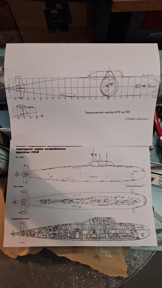

    Greetings!
    This is the continuation of my presentation of making an semiscale ALFA from an old Revell 1/230 SKIPJACK kit.
    I started posting about it here:
    https://forum.rc-sub.com/forum/build...to-1-350-akula

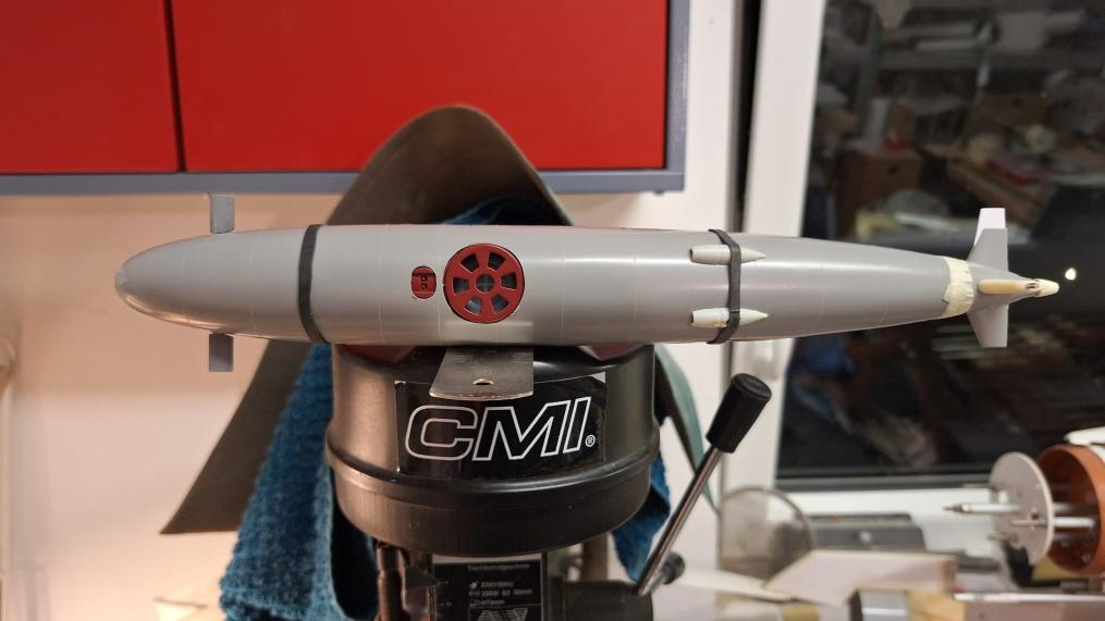

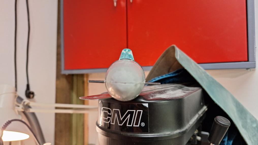

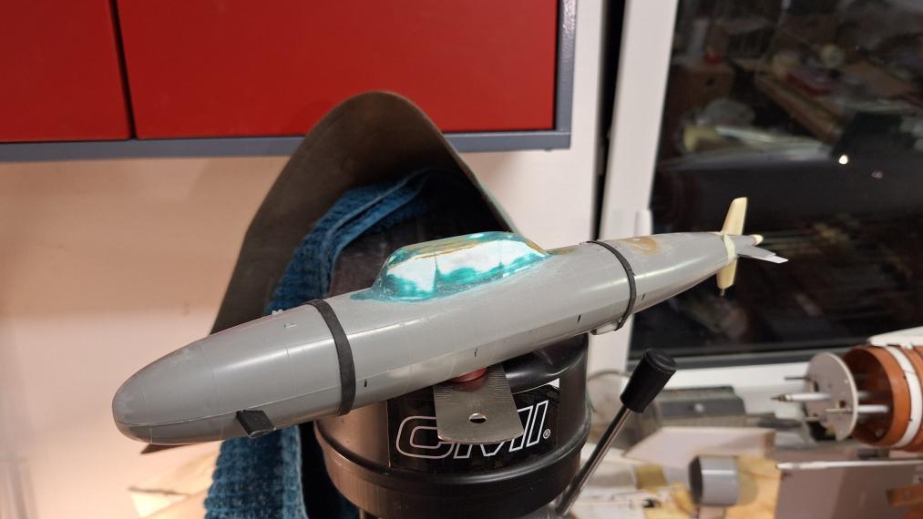

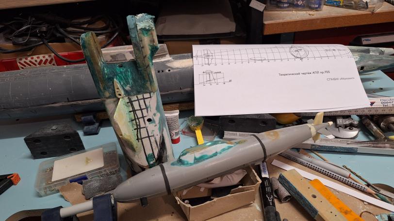

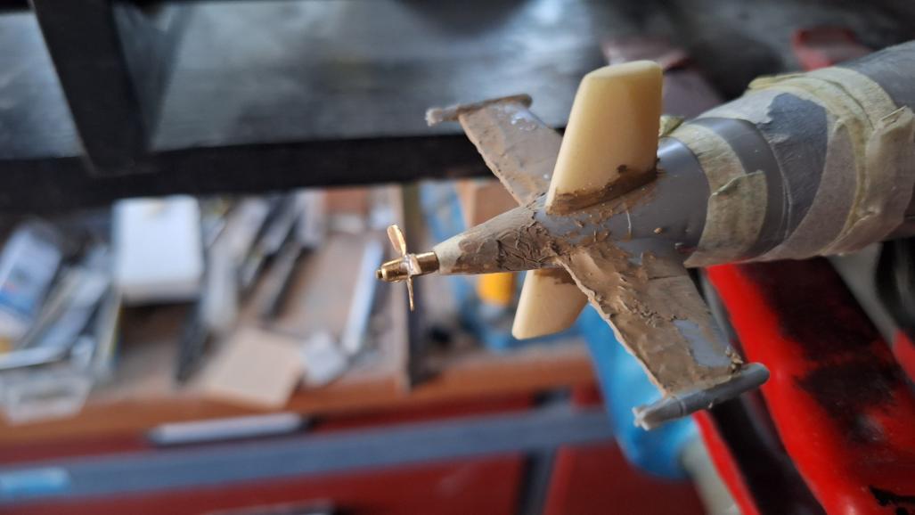

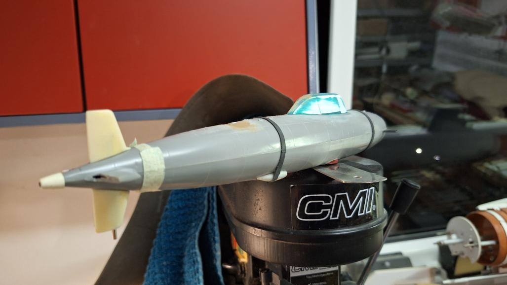

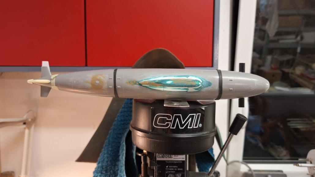

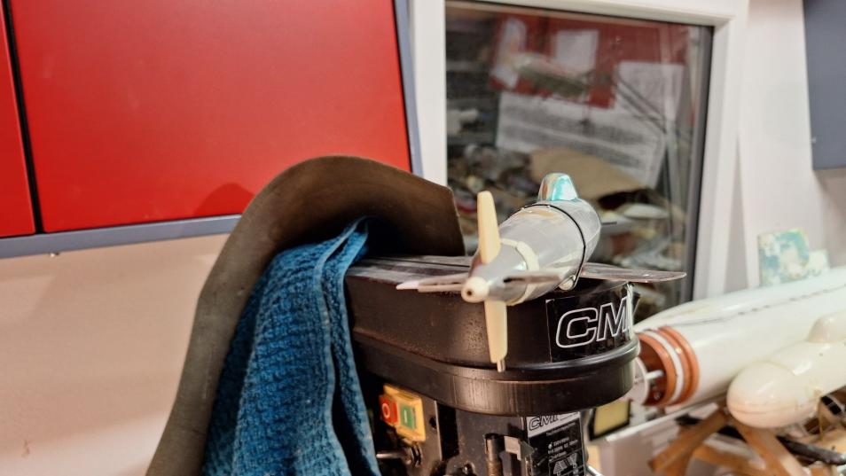

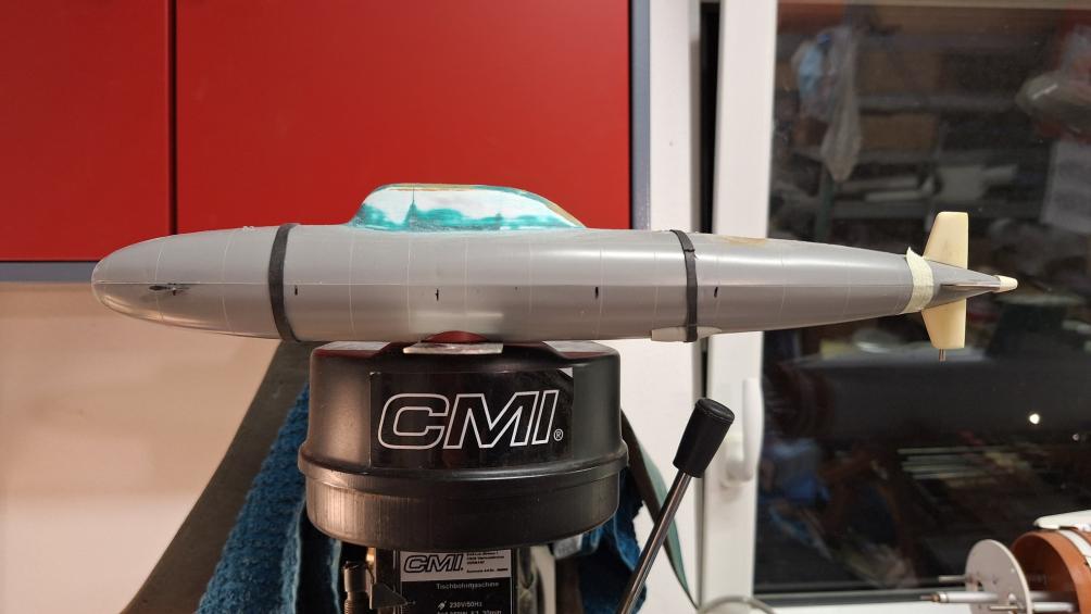

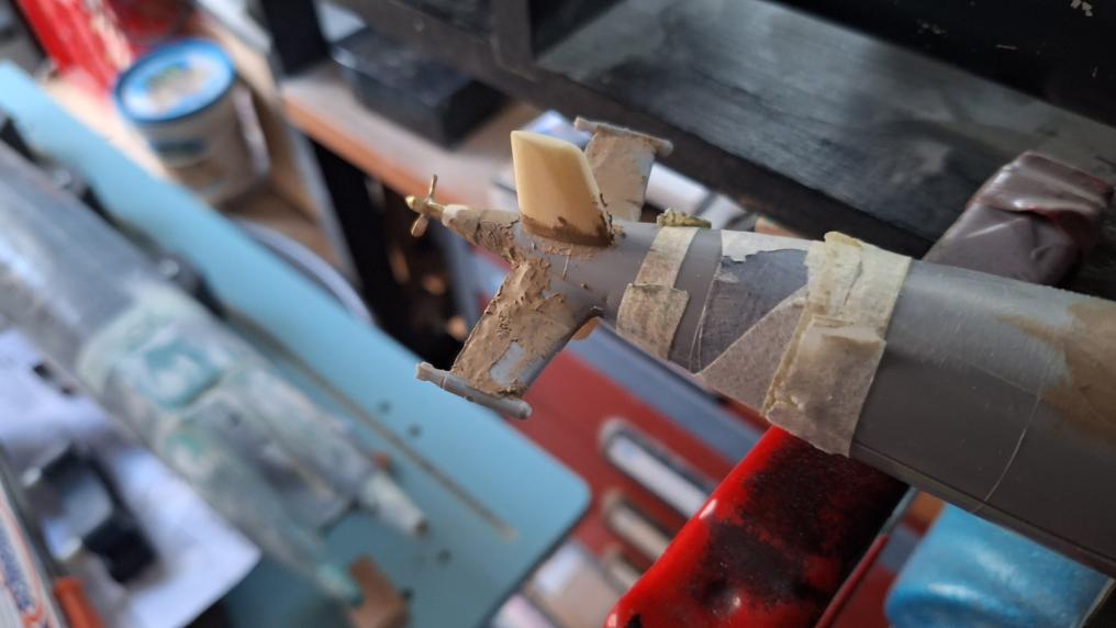

    I doubled the wall thickness of the sail by weld-glueing another layer of 1mm ABS sheet on it. I kept the wooden master inside and applied pressure from the outside so the shape of the sail wouldn't collapse during the process. This was necessary as there still was not enough space inside the sail to accomodate the toy submarine hull inside.
    This evening, i made an upper and lower rudder from surplus planes, a new stern cone and i installed the forward diveplanes. The bow was ground a bit rounder. The coolant intakes were made from an unused external fuel tank of an airplane kit.
    The last picture with the NOVEMBER's stern to the left showing the tiny dimensions of the model of about 30cm!

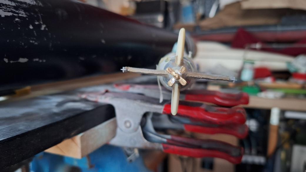

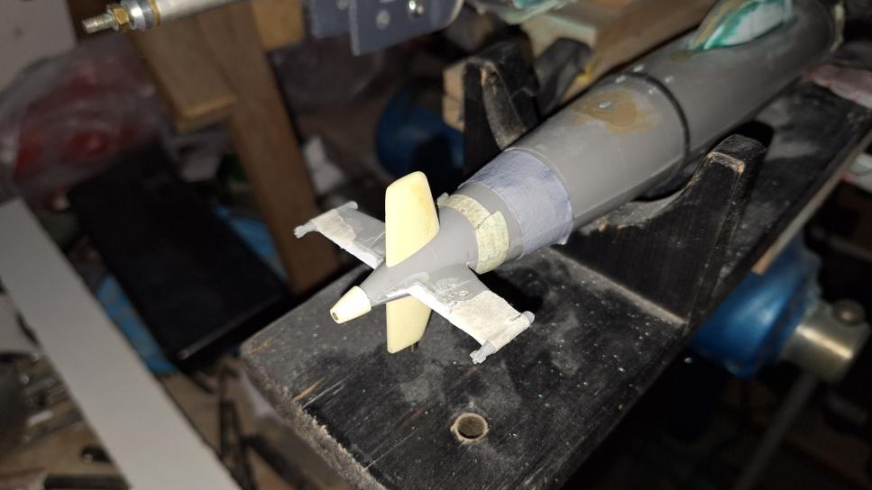

    Hi there! I continued completing the sternplanes that will only need sanding and sealing with resin. The auxilliary thrusters were added, the planes tips will come last. The sterncone with the shaft bushing was glued down. The hull was split using a z-cut. I made a small 4-blade prop from brass tubing. A 2mm tube for the core, 2 peices of 3mm tube were split halfways and the halves were bent to the sides and shaped. Put the 3 parts together forming a "+" and soldered it. Original prop had 5 blades.
