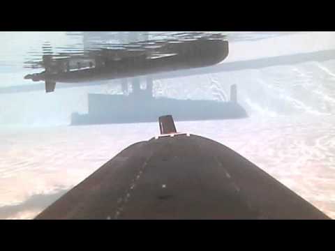

                            Video is up
                            sigpic
                              • 3757
                              #44
                              It is showing, This video is private.
                              you might need to go in and share this.
                              • Slats
                                • 1776
                                #45

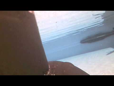

                                Sorry never played with Youtube before dammed thing seems to default to "Private"
                                Try the video again.
                                Pt 2 is here
