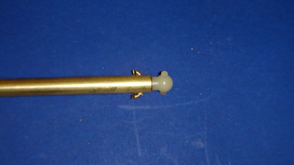

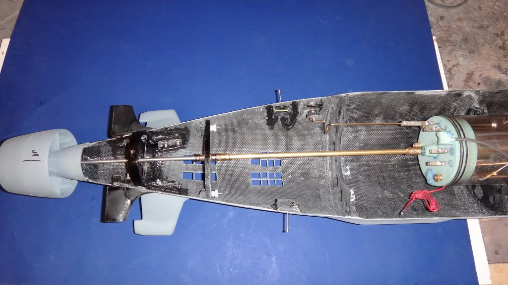

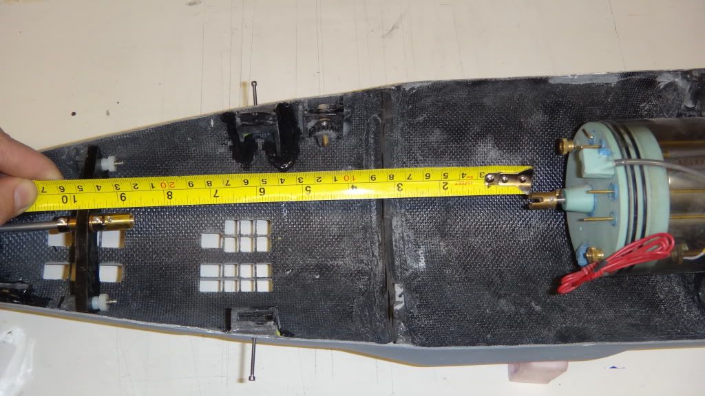

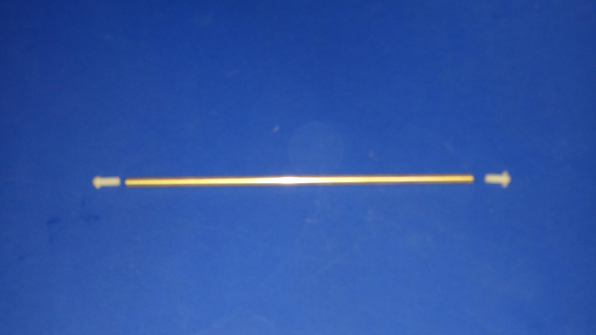

    Looks very good, man! I'm particularly pleased at the amount of ballast tank required (or lack thereof). That means success in my book! As for the shaft issue that you have addressed I actually designed the solid stainless shaft to end just forward of the bearing bulkhead leaving enough metal for a universal socket to attach to. The length that spans between this socket and the Sub driver drive socket is to be taken up by the 'cut-to-size' hollow 7/32" tube. The supplied nylon dog bone is cut in half, inserted on both ends of the shaft, drilled through and pinned in place with wire. This gives the Wolf and easy to remove and re-install intermediate drive shaft. To bolster the hollow tube further if required, a solid 3/16 rod can be cut to size and placed in between the dog bone ends.

      Have you done any in water tests Joel with running the boat up to high speed? I am just wondering about any vibration caused by in effect creating a 9" dogbone. I had prior to sourcing a long shaft an intermediate shaft with two universals either end. Admittedly that has more flex in the universals than the dogbone but high speed static test saw the whole thing let go quite dramatically.

        Regarding driveshafts and dogbones, my 1/96 Seawolf used the David Merriman design of a short steel shaft passing only thru the pumpjet portion with bearings on either end of the pumpjet, the forward end of the shaft extending far enough for a U-joint accepting a hollow aluminum dogbone longer than the 9" inches seen in Joel's photo. I relate this because this setup produced no significant vibration. Throttle commands were instantly translated and the jet was very thrusty. My guess is that Joel's setup will be similar.

          Excellent information Kerry. And an easy fix too should I decide to remove that extra bearing / support across the hull.

            First order of business was to set up the drive shaft as Joel intended. Here you see the long dog bone.
            In water tests reveal she works a treat.
