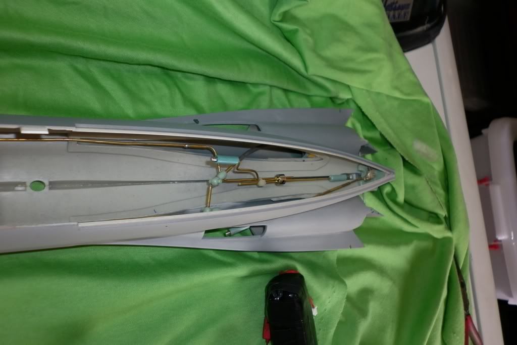

    I assume your using the same K&S 1/16" diameter brass rod I am. That stuff is made from Cartridge Brass. Indeed it can be annealed with heat (get to a red glow and let it cool naturally back to room temperature), but there is no need, the stuff will take a tight radius right-angle bend without fracture of significant weakening. However, if you have to bend it again at that bend point, anneal it, and you're good to go.
    The CA is preferred to make up the Kli-Con brass connector to the push-rod. It gives you the option to later break the CA bond with a bit of heat on the connector. Sure, use the CA there.

      Yes it is the K&S brass rod so I'll now bend away... I was sure the ca would be the go but my "common sense" has been out before, thanks for that.

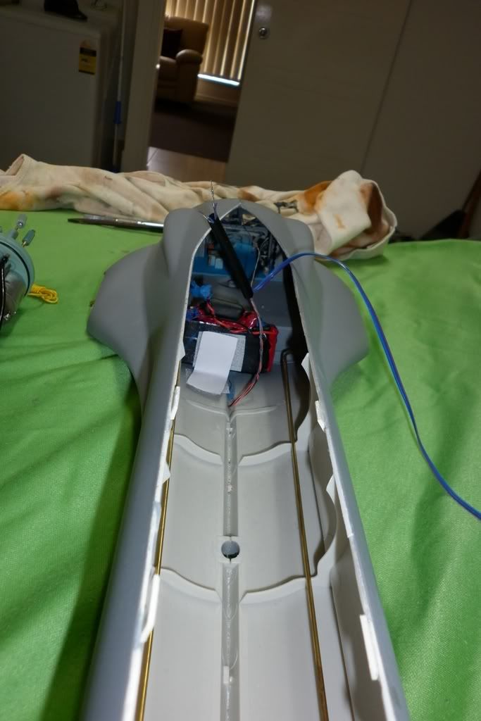

                      It's been an up n down couple of weeks but I reckon I have nailed it to a good start for the finish line. All the electronics are done n dusted and I've indexed the sub-driver. As I said I have installed the LPB system which I tried to mount the inlet through the bottom drain holes but I had issues getting the sd to sit level so I ended up running the inlet tube along the top and mounting it through the top of the ballast tank and then plugged it with copious amounts of rtv to stop any air leaks. I then ran more dry dock tests and testing getting the Tx tuned as best I can so I knew it all worked. I have also set and zeroed the ADF and I reckon I have now gone through more checks and rechecks than the crew of the shuttle before liftoff...
                      Last night I pulled a late one (actually early am) and glued in the lower bow assembly after I made and mounted all the push rods earlier in the evening.
                      I'm not sure it was entirely needed but I also drilled some small holes in the roof of the fs bay in the corners to help with freeing trapped air bubbles, I'm probably being overly anal about stuff like that.... Another thing I did was make a separate battery source for the leds. I took a 9v battery with a snap clip and inline switch wrapped the battery in electrical tape sealed the little push button switch in some heat shrink. But only heated the ends so the switch was sealed but free to operate. and then sealed it with liquid electrical tape and rtv silicon attached some Velcro to it and the back of the FS bay and bingo one removable power source. As it is only running 9 micro leds I reckon I'll get several god long missions before I need to slice of the tape and knock up a new one. I know it sounds crude but hey it works.

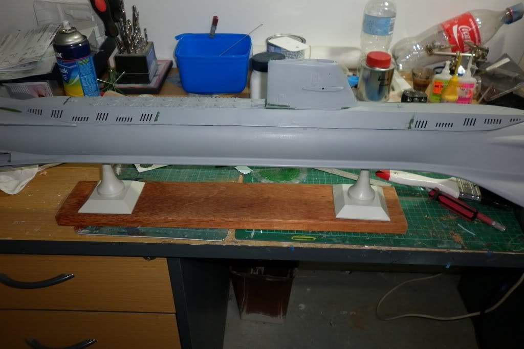

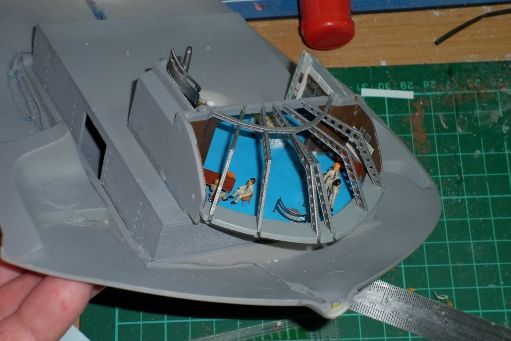

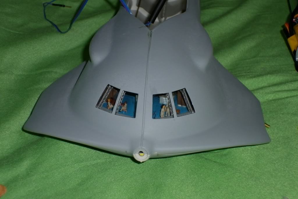

                      I also mounted the kit stands to a piece of Merbau decking which I will use as a stand on mission days as well as it will be a good display base when its painted & stained. For the observation lounge I used the decals that came with the pe set from Paragrafix. Normally would paint the detail but having used Paul's stuff before I had to use them now. I also used some of the pe furniture that came in the kit and they really do add the extra as well. After it was over coated with a clear I waited about a week and then gave it a good coat of dull-coat so now it should be nice and waterproof. I gotta say it looks good behind the windows.
                      I never get tired looking at bow shots of the Seaview...

                                Last night I dry fitted& tested the bow planes and also did the final filling on the seams etc before the final prime coat the final prime coat. I may have to rethink my lighting batterypack position. Though it's not interfering with the b/planes push rods it is just a bit close for my liking. So I will most likley mount it in the FS bay plus that will leave room for a lttle camera I have my eye on down here.
                                David I have yet another question for you... I am getting about ten degrees throw on the bow planes is that ok or do they need more? I'm also keeping in mind that I don't want to toss the aft around like a manic dolphin.
