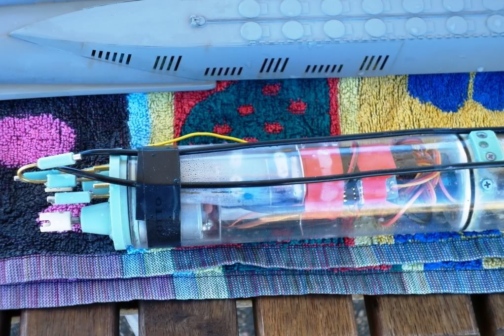

                  David regarding the receiver it's a corona 36mhz synthesized unit. The thing is though that the same thing happened with the JR receiver I have as well.
                  As the video shows the transmitter is on sitting there and the motors are at full throttle...
                  Here is what happens when I run a full lipo charged to capacity...
                  1/ the lipo guard light stays on rather than flash the No of cells
                  2/ the motors kick in and ramp up very quickly
                  3/ It only shows a very very brief reduction in the motors when try to use the transmitter
                  4 the motors will run independently of the transmitter.
                  As a double check, I recharged the lipo pack at full capacity and then using the charger discharged them down to 7.99v, plugged it into the sd and everything worked as it should. Also just to be sure I plugged in a 6pk of AA 1.2 Nimh 2450mah in each cell and every thing seemed ok. I know lipos are the new tech in batteries but I may yet fall back on the AA rechargeable pack and re trim the boat.
                  this a picture of the condensation and it's location. I checked over the sd at home on the bench and it all looked good. In fact the area I thought I would have issues with re leaks was as dry as a desert.

                    OK. Good summation. Stuff I can get my teeth into.
                    I suspect that your Corona receiver is not selective enough to reject motor noise and such and is getting into a regenerative noise response-build situation. It's that or the receiver is misbehaving in concert with the next likely problem:
                    Your ESC has to be re-set to your transmitter, channel-3 end-points. Go through the ESC set-up protocol again and see if that solves the motor over-speed problem.
                    I know you can't use the Sombra Lab's receivers -- too bad, the SD system was designed around the attributes of the Sombra receivers; they permit the tight packaging of all devices on and around the motor bulkhead. You may have to arrange things in there to put the receiver up against the after ballast bulkhead. As signal attenuation is a function of the inverse/square law, just a bit of distancing of the receiver from the motors and such will greatly reduce the 'noise' the receiver is subject too.
                    Now as to the fogging. The leak may be in the LPB pump casing or your internal plumbing. Take the external induction and discharge hoses off their respective nipples. Hook up a hose in the test port (after removing the core-valve), dunk the SD in water, blow into the hose, and see if any bubbles come out one or both of the nipple openings. If so, you have a leak somewhere in the LPB sub-system. Fix it.
                    You used that limber-hole acid-etched panel kit! Neat. And just enough weathering to lend credibility to the display. You're a bit of a model builder, aren't you, Alec!?

                      Now there is some things happening on the model front... I brushed some silicone dif oil on the inside of the limber holes & drilled in 2 additional holes at the aft end of the superstructre. Definatly not scale but I'll see how it goes next day out formoving out air. I also added some oil to the rubber as suggested. I'll repeat the process on the next outing. Not sure what "pam" is as a lubricant & I don't want to go spraying a mineral based lubricant on the lexan but I'll head off to one of the auto/engineering shops and check out hat they have.
                      Ok things I have done...
                      1: I reset the esc with no change...
                      2: I tested it with a new lipo gard... no change
                      3: took out the valve and added the hose then dunked the sd in the tub... the only air I saw coming out under pressure was from the motor shafts on the wet side ot the bulk head. Todayat the LHS I bought a tube of h/duty grease which I will squeeze around the motor shafts as an added measure. I don't really want to pull apart the motors etc from the bulkhead... but I may have to... I also redressed all the wiring so as lttle as possible is near the motors & power leads.
