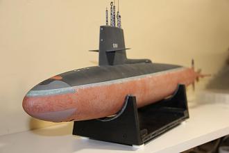

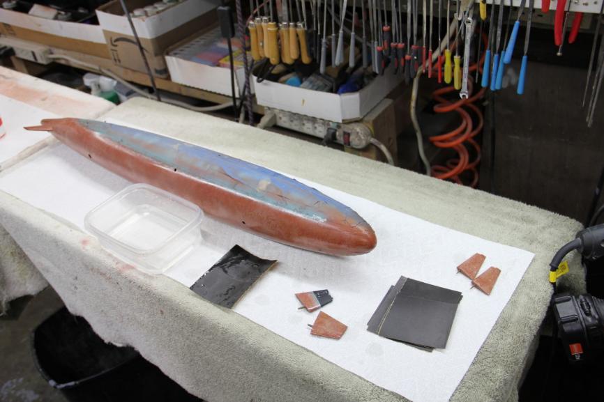

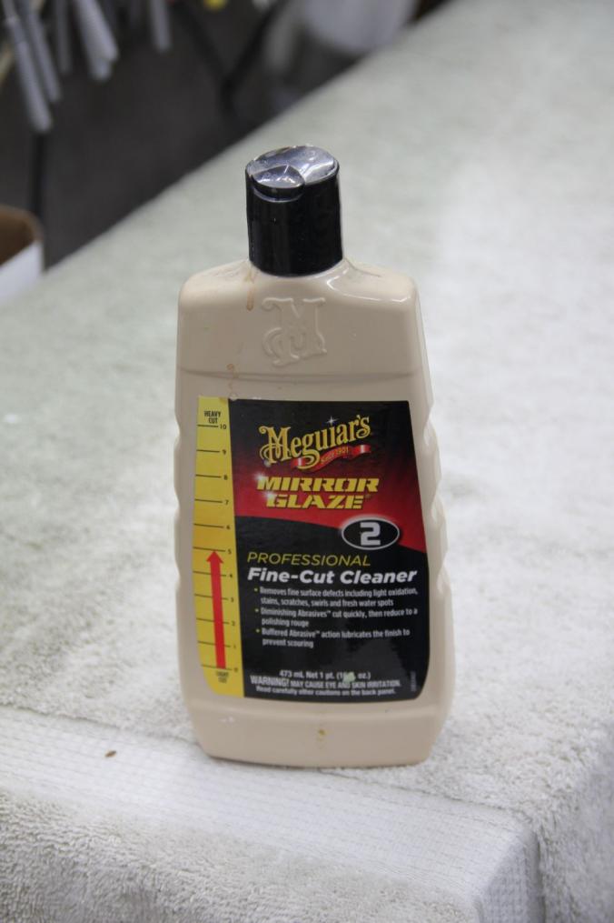

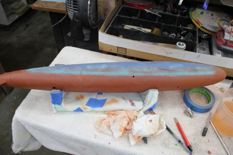

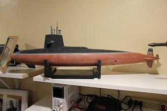

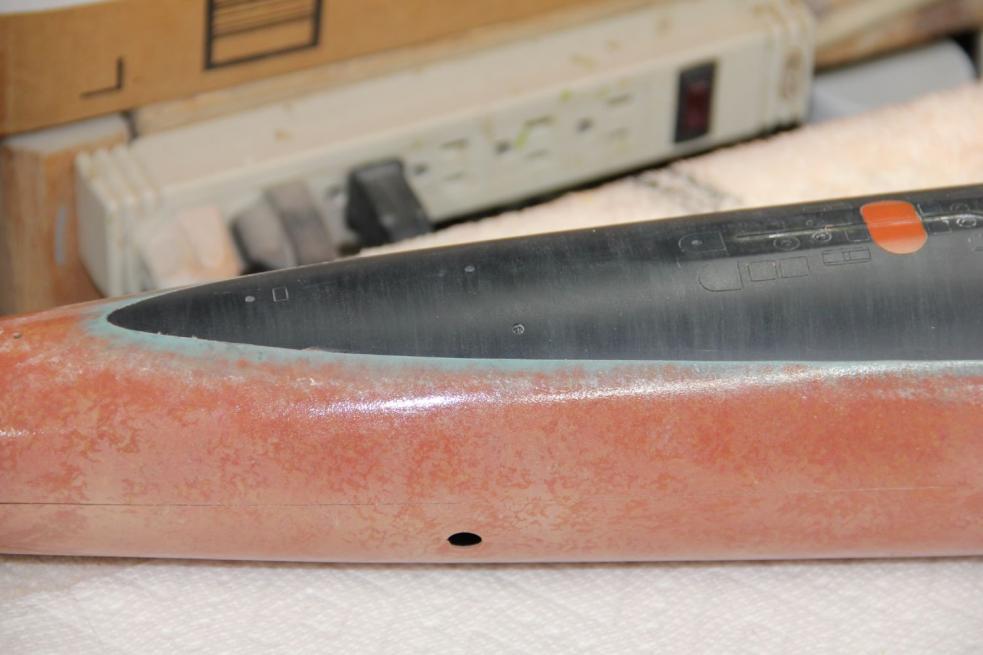

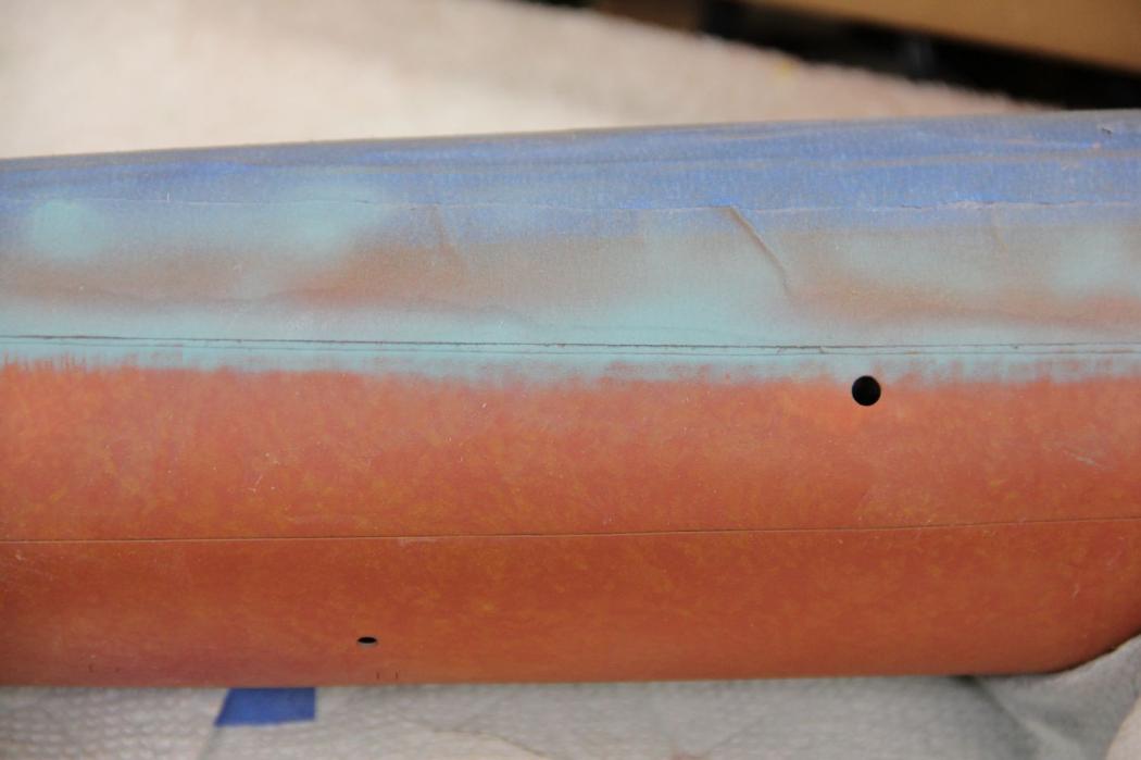

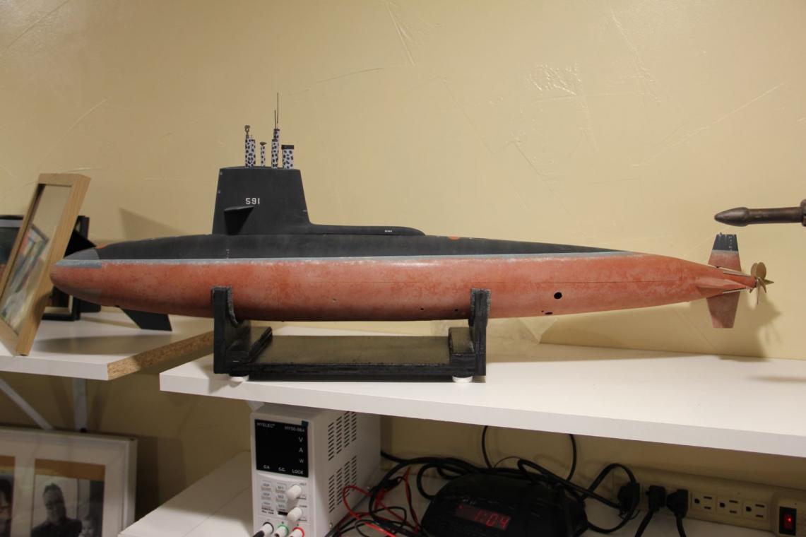

    Finishing prep-painting of the hull. Used a fiberglass brush along with McQuire's Fine Cut Cleaner which softens the applied paint in order to make a thick streaking effect. This was another of Dave's techniques that really worked out very well. Next a clear coat will be applied to save this stage of the work for the follow-on weathering to be applied.

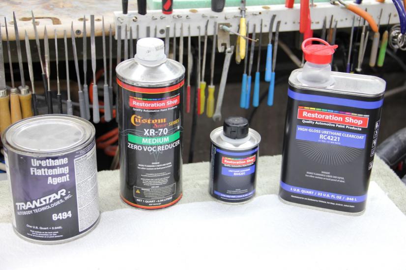

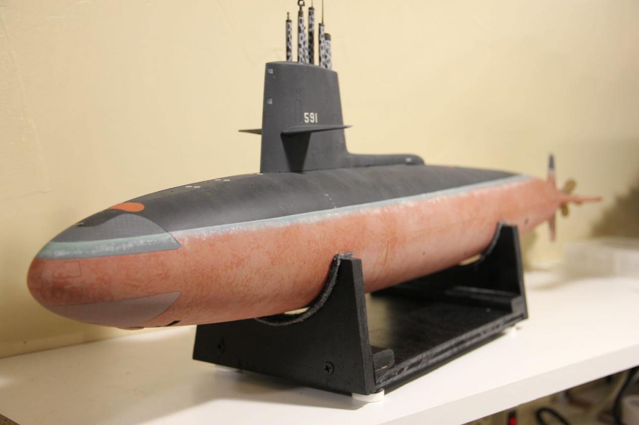

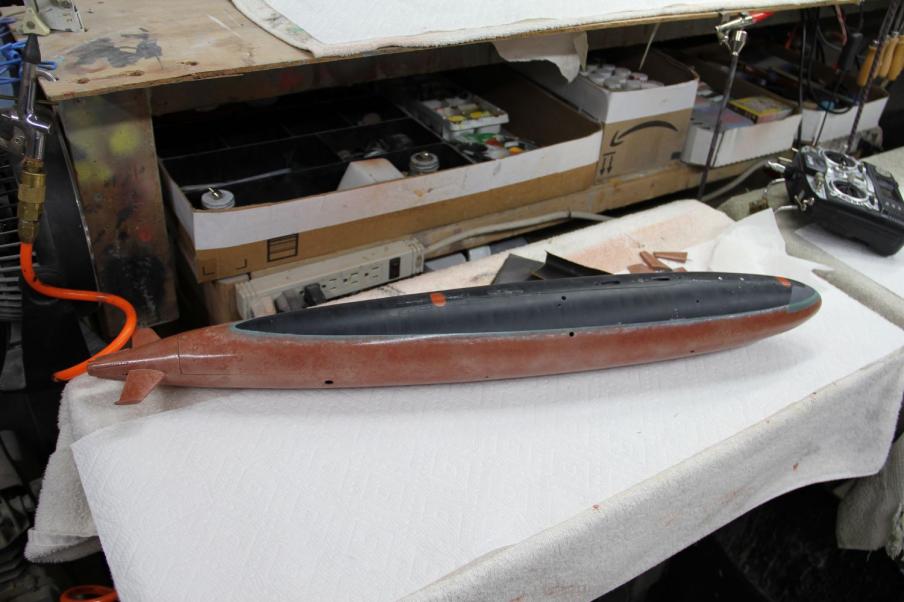

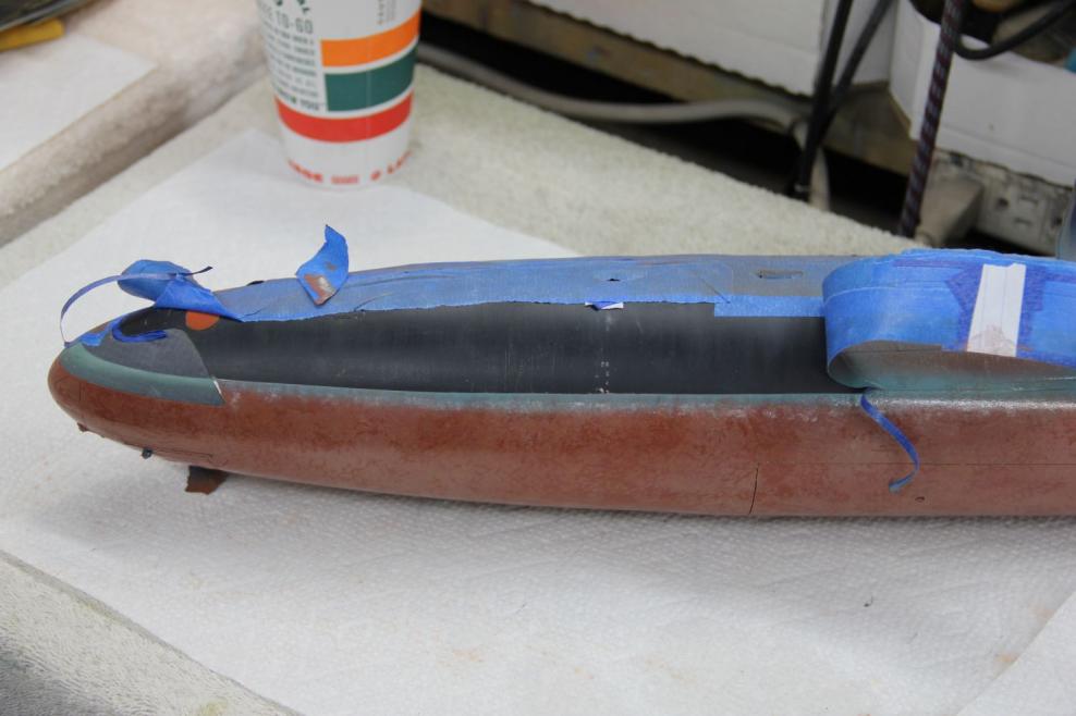

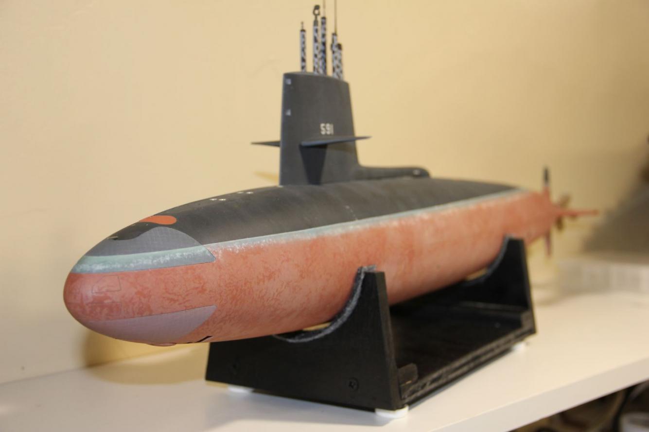

      Here the paint-work is being completed and unmasked. I also provided a photo of Dave's automotive clear coat kit. You can go gloss or add a flattening agent. Awesome stuff. Going to get some. Click image for larger version

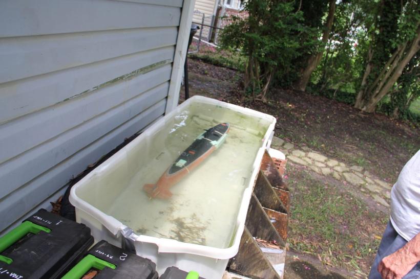

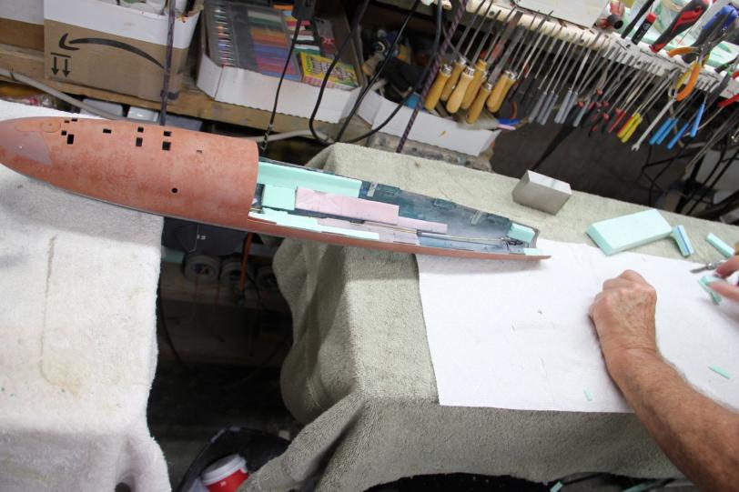

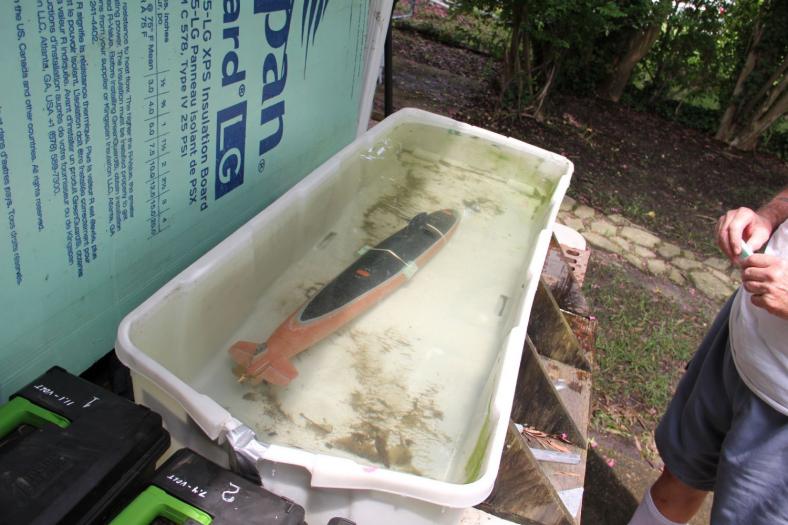

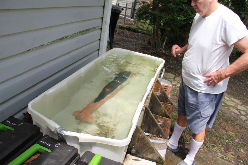

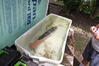

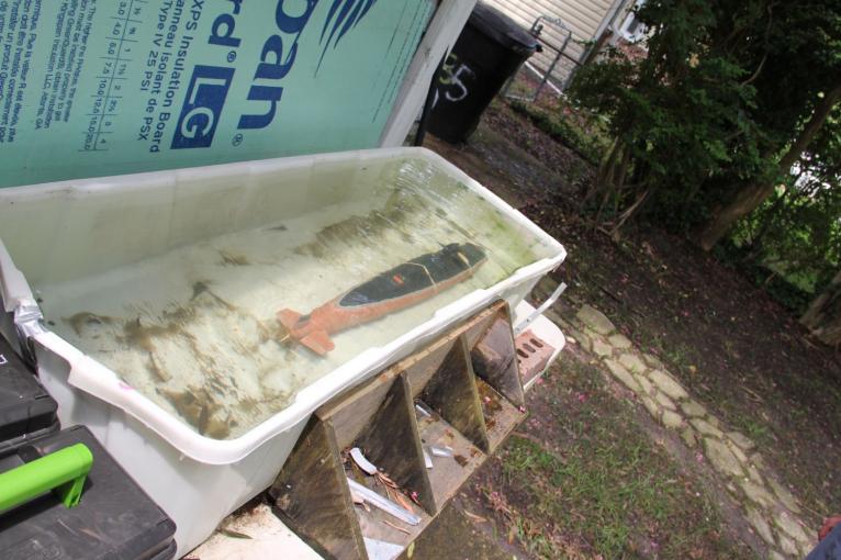

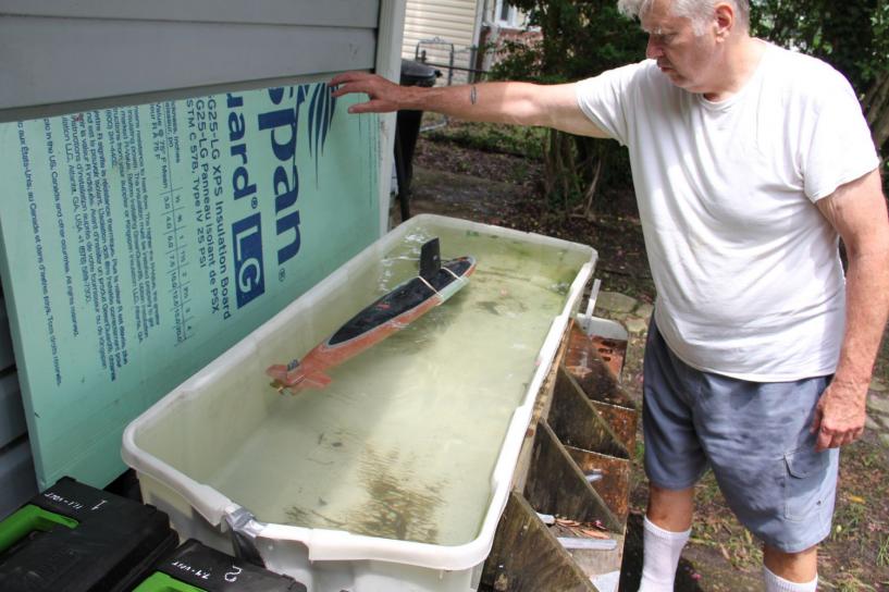

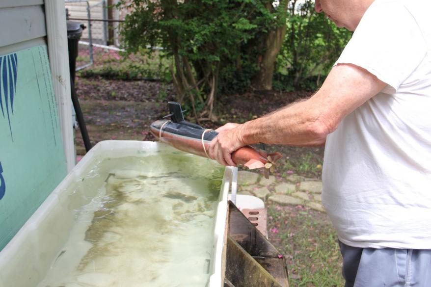

ID:	181733 Dave did some touch up work a few days later, then it was time to throw it in the water for surface/ submerged trimming. Now...the only thing coming out of this model prior to painting was some foam, and we went with a battery that wasn't even half the weight. So you figure you're going to be on the light side of things...we kept adding foam, more, more. Finally, Dave said something's up, we're getting water some where we don't want. Sub kept going to whatever version of Davy Jone's Locker is in that dunk tub. Sub came out, opened it up and it was dry as a bone. Perplexing, so we glued some in and tried it again and pretty much got it dialed in.

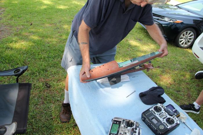

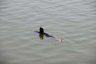

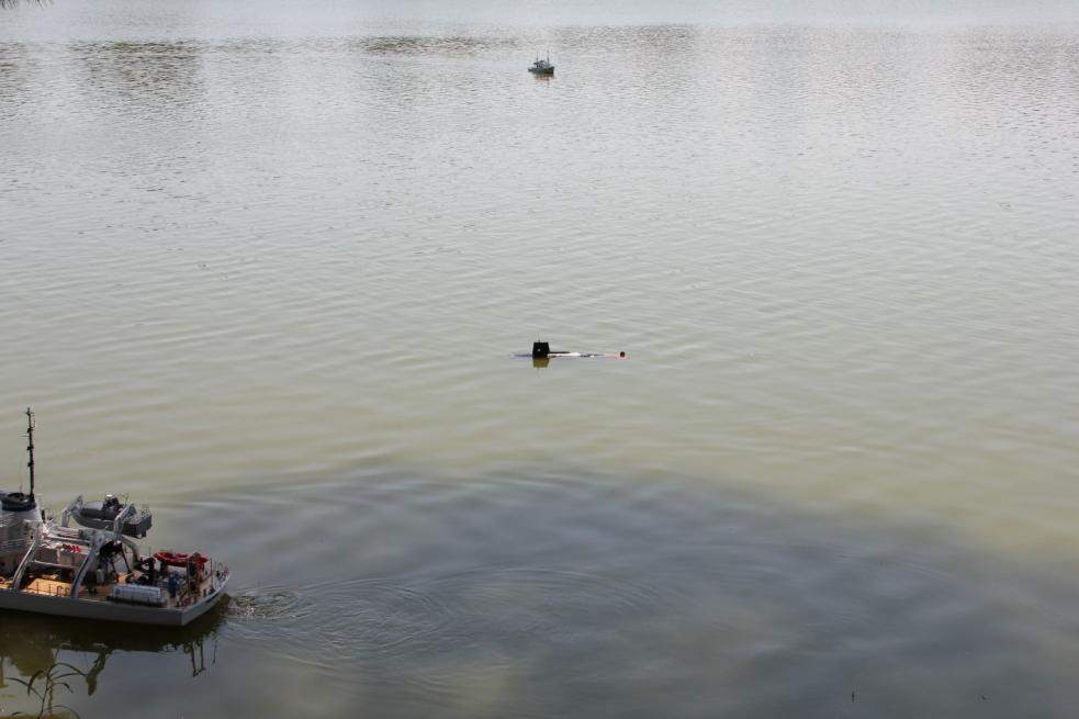

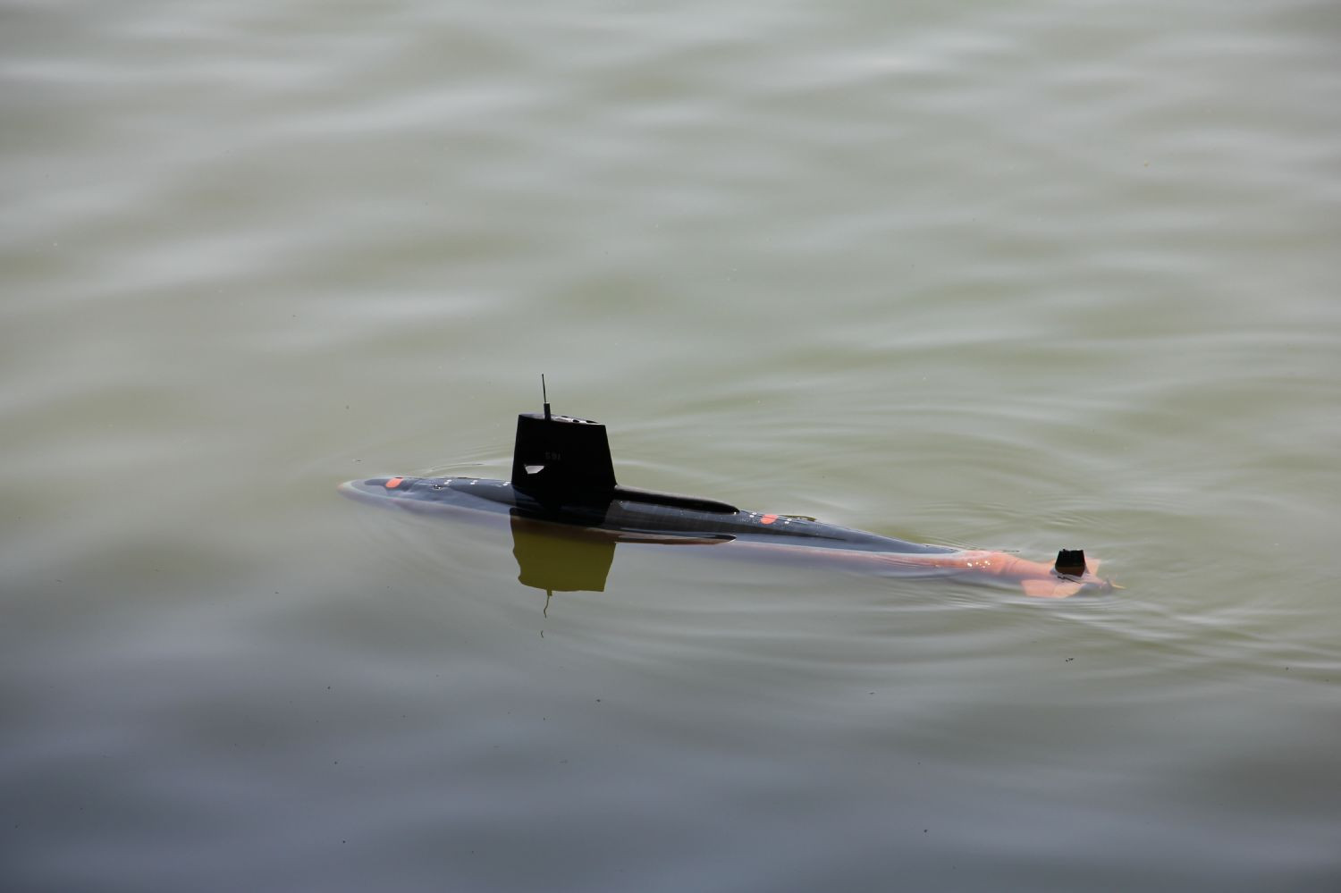

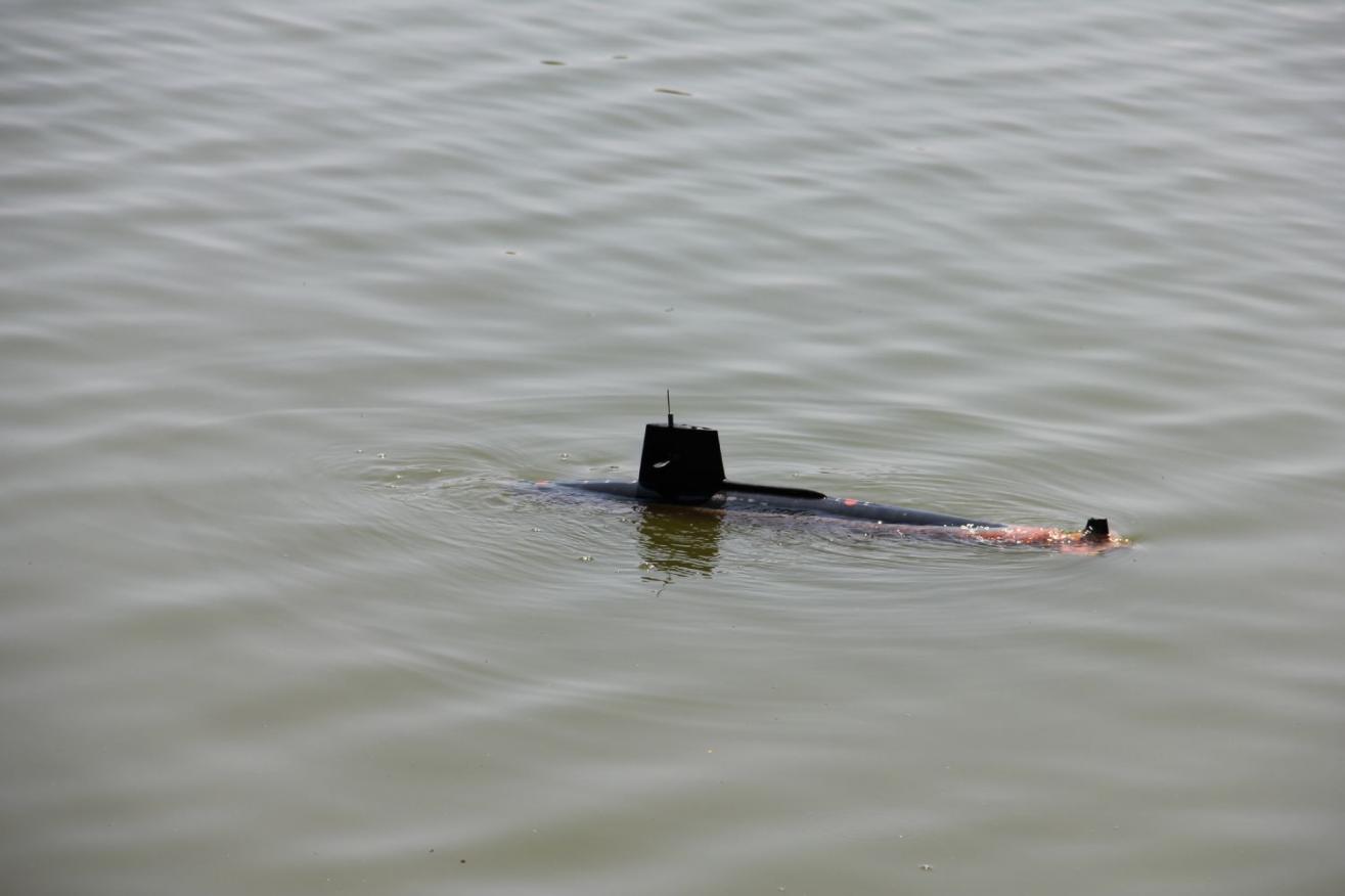

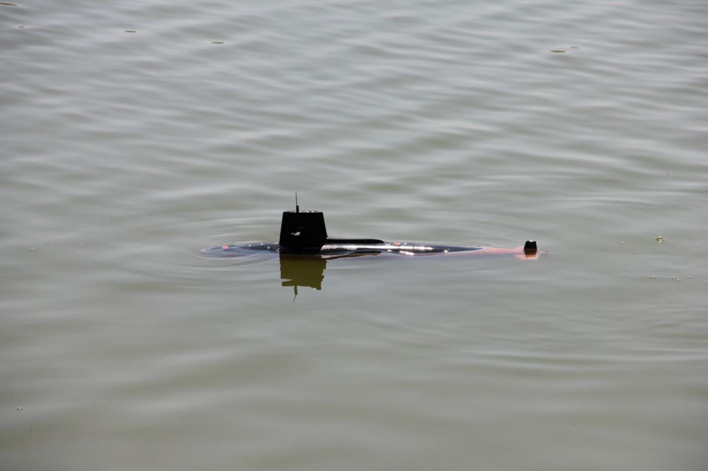

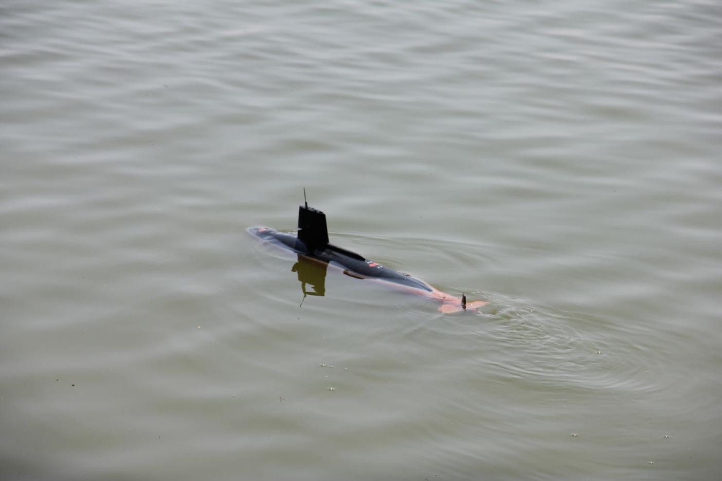

        After four months of hull re-work and re-painting, finally got to dunk the sub in the lake. Had very few surprises, and just a few tweaks. The fairwaters weren't behaving with any kind of useful range, but Dave got them pretty ironed out after a couple times in the water. The trim was overall SAT, but heavy forward, light aft. I'll shift some foam this week and that'll take care of that. As you probably noticed, the paint job is from a commissioning one where the hull red is at the waterline, vice an operational one where is down at the centerline. Sometimes running the boat early on, I'd lose it, but then the red would stand out in the green water magnificently. Now I ran a 7.2vdc NIMH battery in it for about 2 hours of run time. When I took the battery out and check it on the meter to see how much juice was left, it still at 7.6vdc. Click image for larger version

            Congratulations Captain! Nice looking and a sweet running sub to boot. I always get nervous when a sub is trimmed one moment and then the next time it is not. I start going through a mental checklist. Is it leaking?, Is there air trapped?, Is the battery shifted?, Did I lose a weight/float? Because, for me, I fix something and then the next time I run the sub, I have to undo what I did. Gotta love this hobby. It keeps you on your toes!
                          Tom, so many interfaces to have fun with and screw up right? ha ha It's the on-going science project. It's amazing at how something can get out of whack just sitting there.
