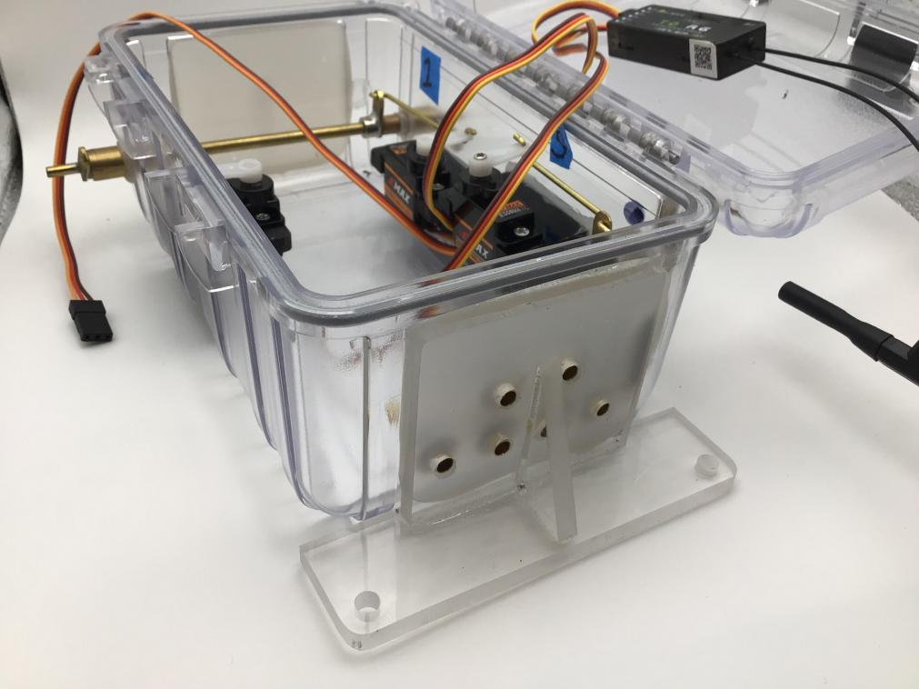

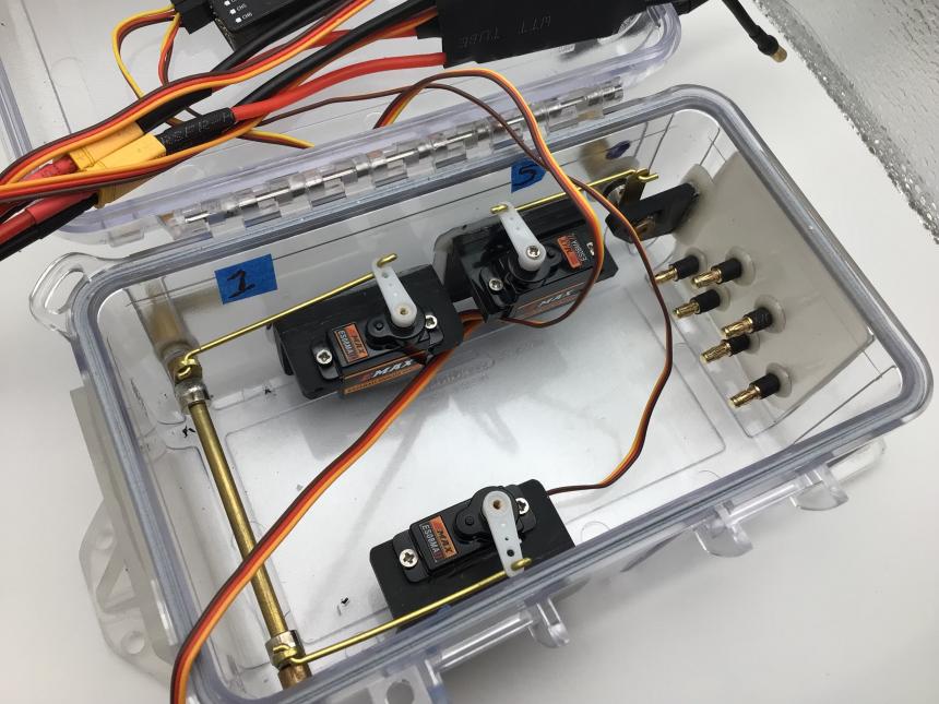

  • ffr2608
    replied
    That was my dislike.
    Wet servos have more than 1 water entry point. Silicone can break down around the wires and ruin the seal.
    The vintage SBS seal I use have been 100% reliable for over 25 years. They are turned brass with the cup seal inside.

  • tifosi12
    replied
    Originally posted by tifosi12
    Interesting. I would have used wet servos and put them outside the box to eliminate the need to seal those servo linkages.
    Alright, I got an anonymous dislike. Fine. Care to elaborate?
    My motto is to keep it as simple as possible and sealing the feed lines for the servos through the box is a lot easier than dealing with mechanical seals for the linkages.

    Some final work on the linkages. I am trying an elevon system on the bow planes first. If you look at the output shafts, they are extra long to link to the stern planes. Lots of possibilities and room for a third output. The box is all mounted up and ready for electronics install. I am also experimenting with some smaller props and they fit great inside the nozzles. Good to have options and will see the results in the tub first.

  • ffr2608
    replied

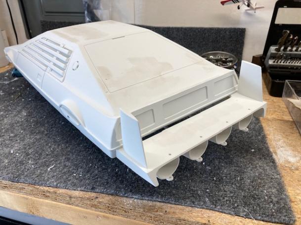

    Originally posted by ffr2608
    Motors mounted up and bonded to the hull. Decided to go analog from this point forward. Acrylic, brass, stainless and styrene. I did find some old Subtech SBS seals so I will be mounting the pressure box tomorrow.
    This is looking solid. I'm still amazed about how small these motors are. Didn't know that existed. Very cool and keep it going please.
    Leave a comment:
  • ffr2608
    replied
