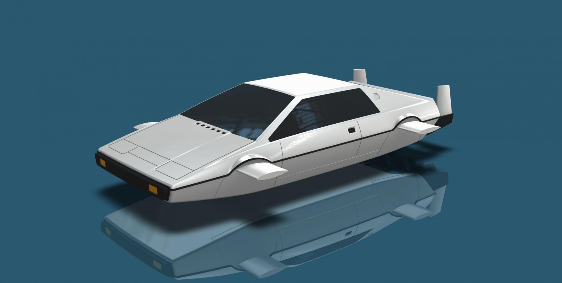

    The James Bond “Wet Nellie” is here! Bob sent me the prototype print this week and it is pretty much flawless. This project started several years ago with a CAD modeling project I took on for some training. Not many understand the differences between a real Lotus Esprit and the submarine movie prop. I spent many hours collecting photos to create a model that is true to the movie prop and not just an adjusted car model. Built as a wet boat with scuba divers inside, the hull was split horizontally along the cars signature character line. A perfect subject for a 2 piece fiberglass mold.
    On to the model….
    Printed in a high strength resin, the model is 22.5” x 9.5” and a perfect match for one of the available watertight boxes from S3. Bow and stern planes, rudders, antenna and 4 pump jet propellers finish up the package. Finish is amazing and will only require a couple rounds of primer for a nice surface. I think the biggest job will be masking for all the black trim and details….
