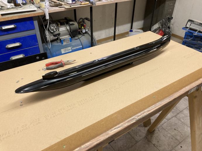

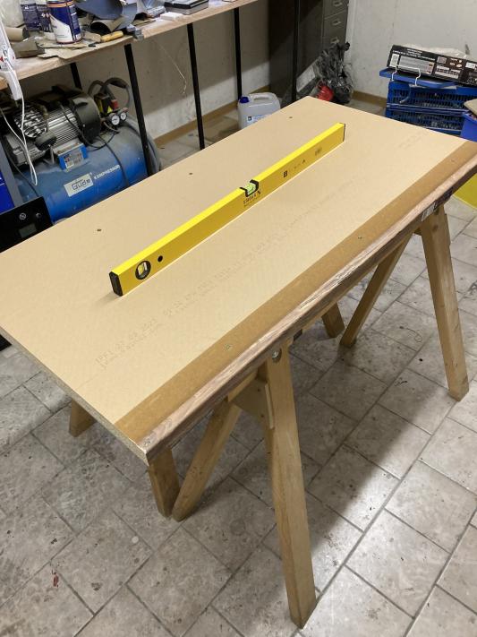

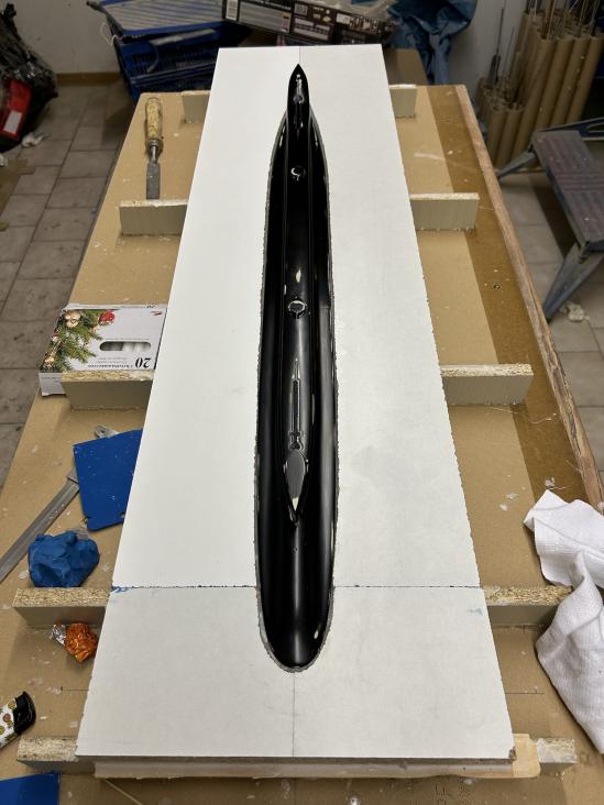

            After allot of painting, grindig and polishing. I finally have a good master. Now it's time to set it up for making a mold. The master is screwed onto a plane, stiff, and level board.

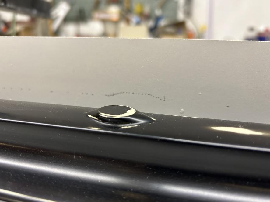

            Then I set up the parting plane and filled the gap between board an boat with camdle wax...

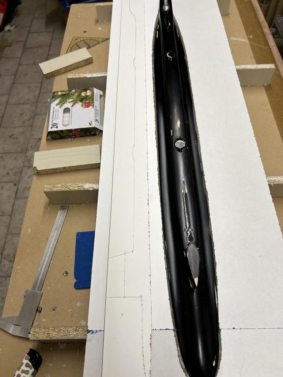

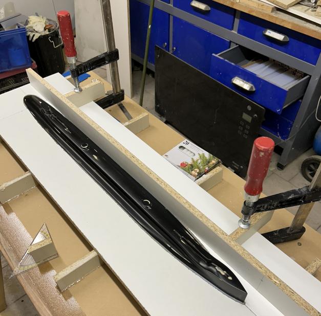

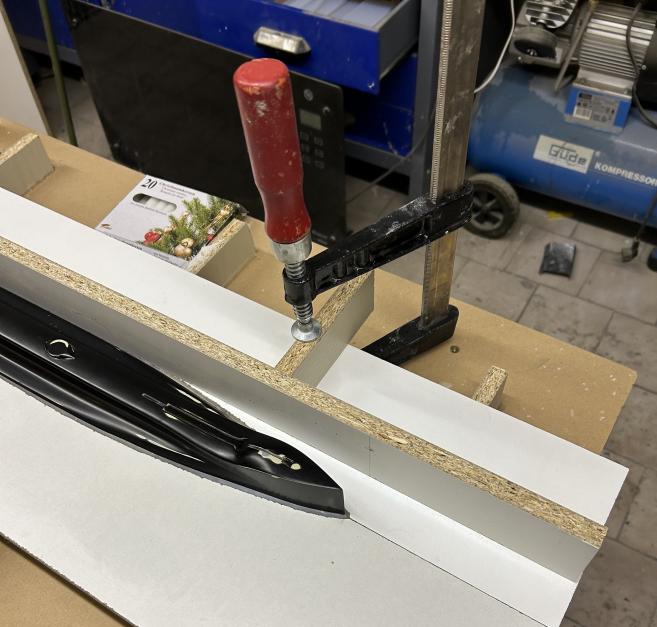

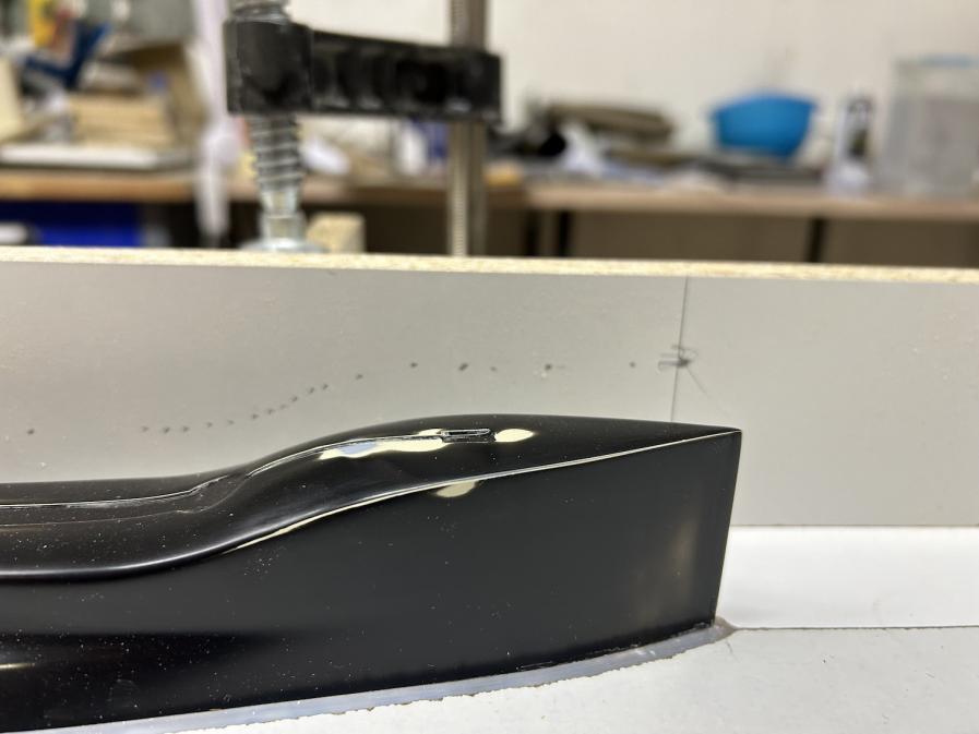

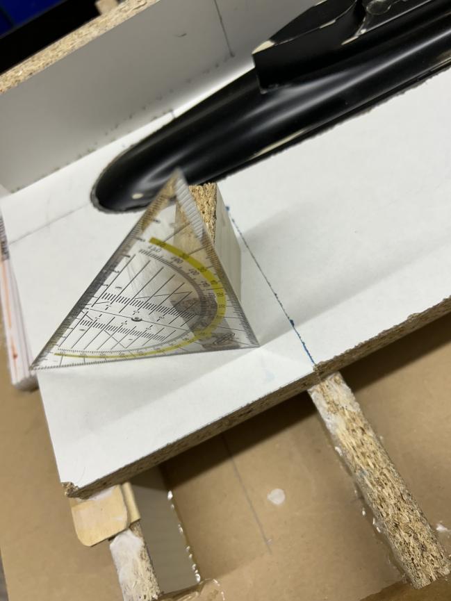

                    The complicated thing about the U-1 is that I have to make a mold that is made of four quarters, mostly because the bow line is vertical, whereas the stern line is horizontal. So in addition to the horizontal parting plane I have to make a vertical one, too. I use 16 mm coated chipboard that I glued to two supports using hot glue and then I clamped it down to the horizontal plane so that it cannot move anymore. I glued a square wood block to a set square and use this tool to trace out the outline. I slowly move along the contour of the boat and mark little dots at the tip of the set square. finally I connect the dots to get the outline of the boat. Next is the padsaw....

                      Cut out the contour and made some fine adjustments. Worked out well...

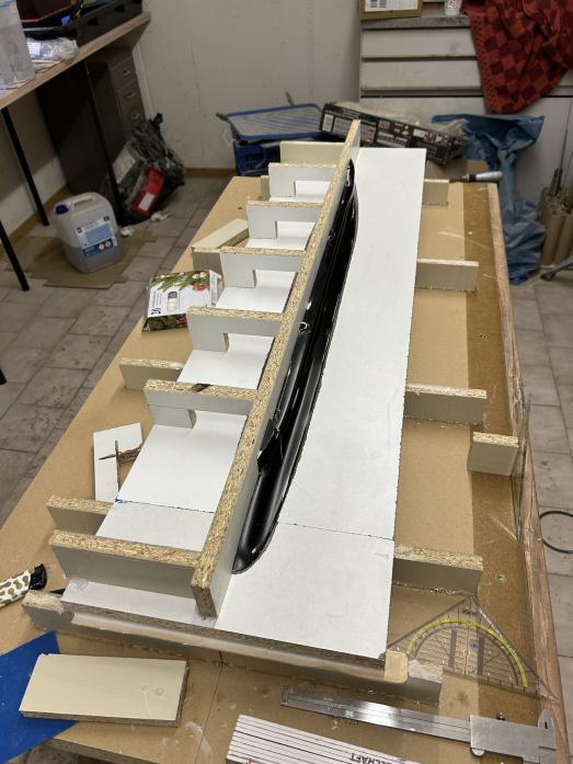

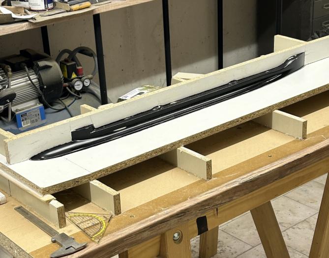

                            To reinforce the vertical parting plane, I installed some brackets made of chop board.......next are some holes for the indexing pins and then I'll have to seal the gap between hull and board.
