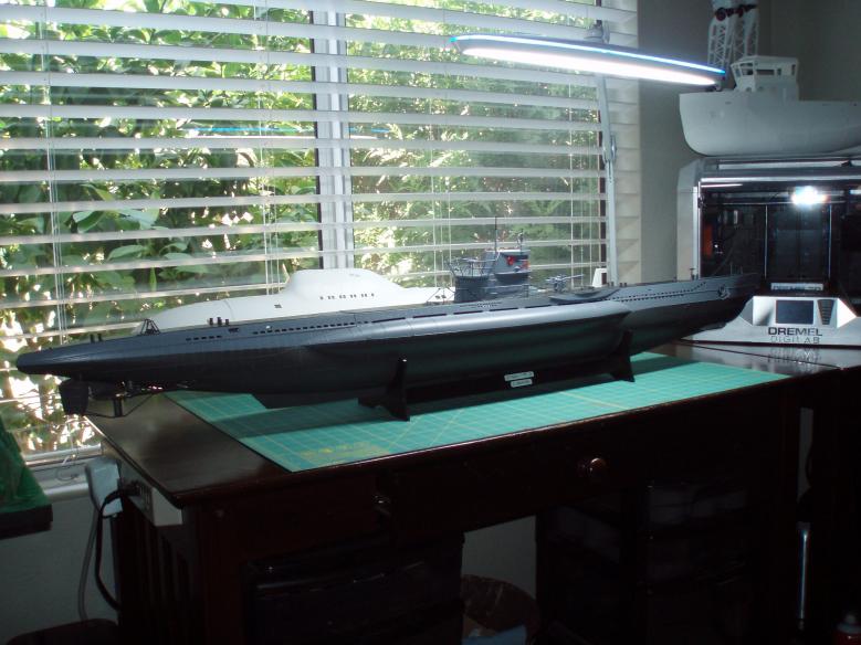

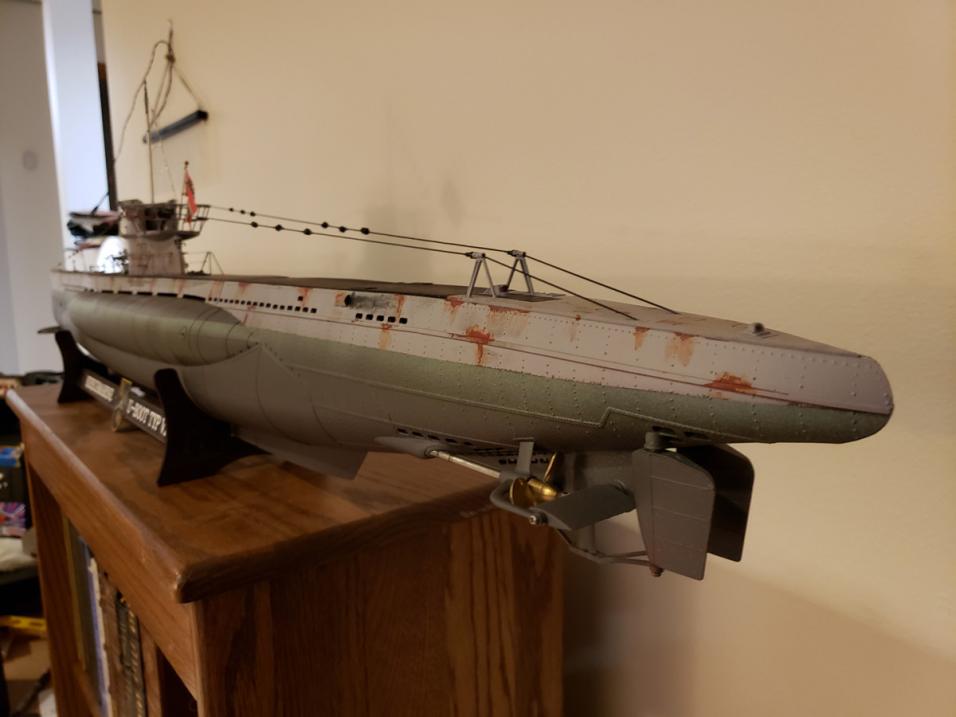

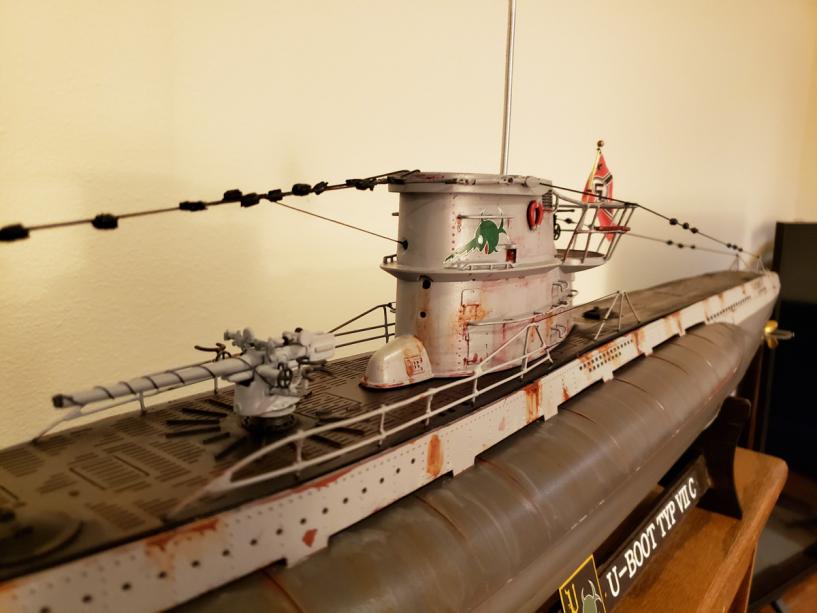

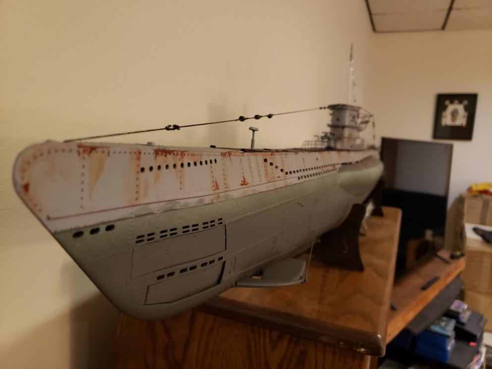

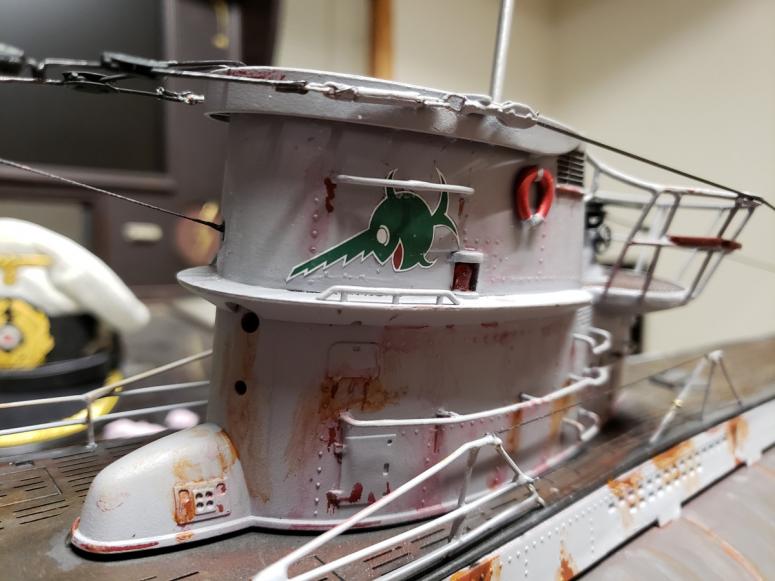

    I recently finished most of the work on my Arkmodel Type VII C build. All that's really left now is trimming. Here are some photos of my sub. The decks are attached with magnets for easy removal. I replaced all the kit-supplied railings on the deck and the conning tower with soldered brass railings I made. I made my own attack periscope (which also serves as the air intake for the ballast system) from aluminum tubing and an aluminum rod I turned to the shape of the head of the periscope. I also made my own Kriegsmarine flag by printing it on some fine cotton fabric with my inkjet printer. I'm still debating whether I went a little too heavy on the rust or not...

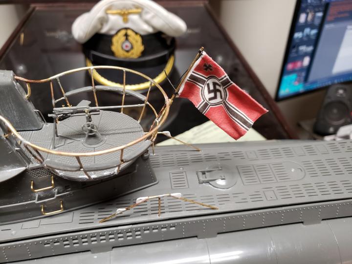

    Here's a photo of the brass wintergarten railing before paint, as well as the flag I made. Also a photo showing the turnbuckles I built for the conning tower antenna rigging.

      Great model! Rust is nice, id add a scum line to do something about the "clean" look. Show us the inerts!

          Fantastic work. For the rust, if it bothers you, I'd put some areas of dark and medium brown within the areas (old rust vs newer rust) and it will pop out. Having it on is just fine, it's just shows that it's either on patrol or at the end.
          With your flag, it looks great. I use very fine cotton like that's found with pillow cases. Often people use a much coarser cotton (like for uniforms, etc) and it just doesn't look scale. My principle hobby are 1/16 scale tanks, and doing stuff like canvas mantlet covers with cloth, a pillow case is always my go-to. In 1/48 its even tougher. To see if somethings going to bother me, I set it across the room and look at it for a few weeks. You gain perspective to yourself which is more important than people's opions (which are many). Then you either take out the chainsaw and go to town, or you feel okay with it. Again, really superb work.

            Thanks for the positive feedback guys! For my first RC sub build I am pretty pleased with my results.
            I did add a pretty obvious scum line. You can see it in a couple of the photos I posted, including the side view at the very top and the third one down. Some were shot before I added it. Oh, and yes, I play SHIII and a number of other sub sims. These days I mostly play Wolfpack.
            You can see my complete build log on the forums at https://www.subsim.com/radioroom/sho...d.php?t=253849
            Lastly, when I look at the sub from a distance I think the rust looks great. So I'll keep it as it is and maybe add a few other colors to it. =)

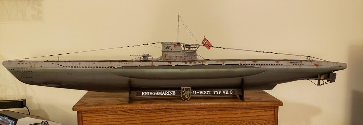

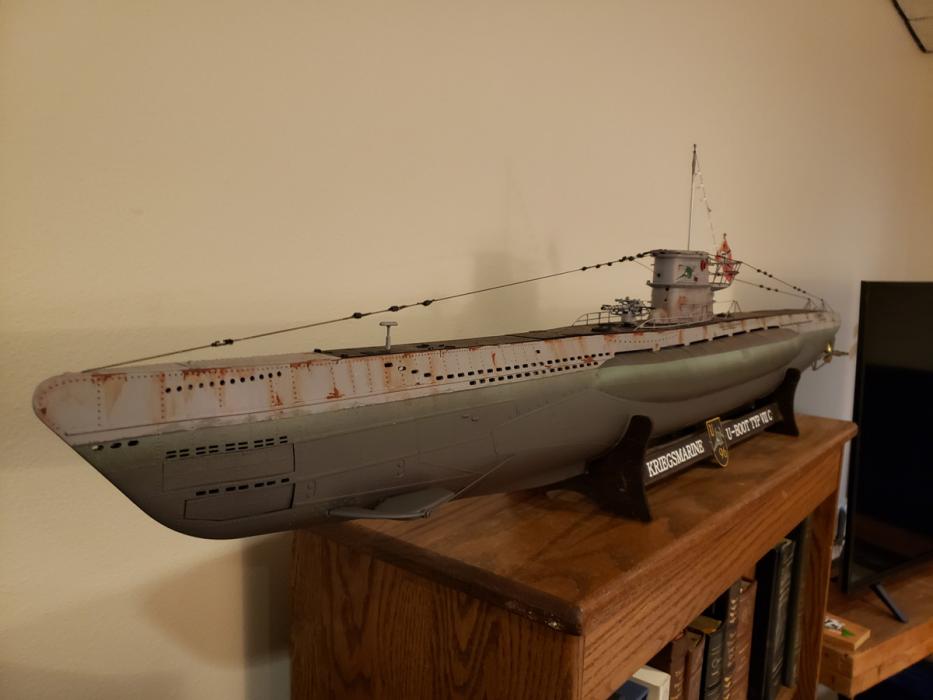

                    A few more photos of my finished U-96

                      It looks like you may have lightened up the rust and added some light touches of rust on the rivets! Nice looking boat!!:-))

                        Thanks again Rob, I'm really happy with the way it looks. I just did the initial addition of ballast weight and foam. Next I'm going to stack bricks to form a 1'x1'x6' tank space and line it with plastic sheet so I can fill it with water and trim the boat.
