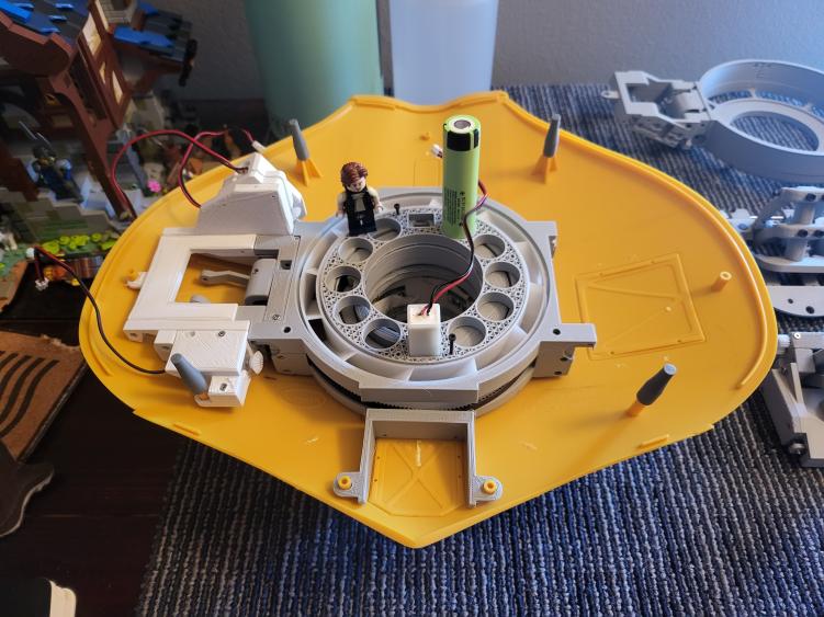

    1. Here is a top view of bottom shell of the model, we can see the right side landing bay door structure, with a flap to open and close 1/3 of the landing bay doors. The middle structure is my pride and joy. The 6DoF maneuvering system. That white printed part is a circular pump will spin clockwise on the bottom, another will spin counter clockwise on top (to counter act the centrifugal forces), and will push water up into a centrol donut shaped area with different output channels that will be opened and closed with smaller servos.
    2. Same as before, but with the door as closed as possible. The opening is fine considering this area will be open to the water anyway.
    3. There is another shell with practice cuts and the remaining 2/3 of the door flap thingies. Little preview of the legs as well.​

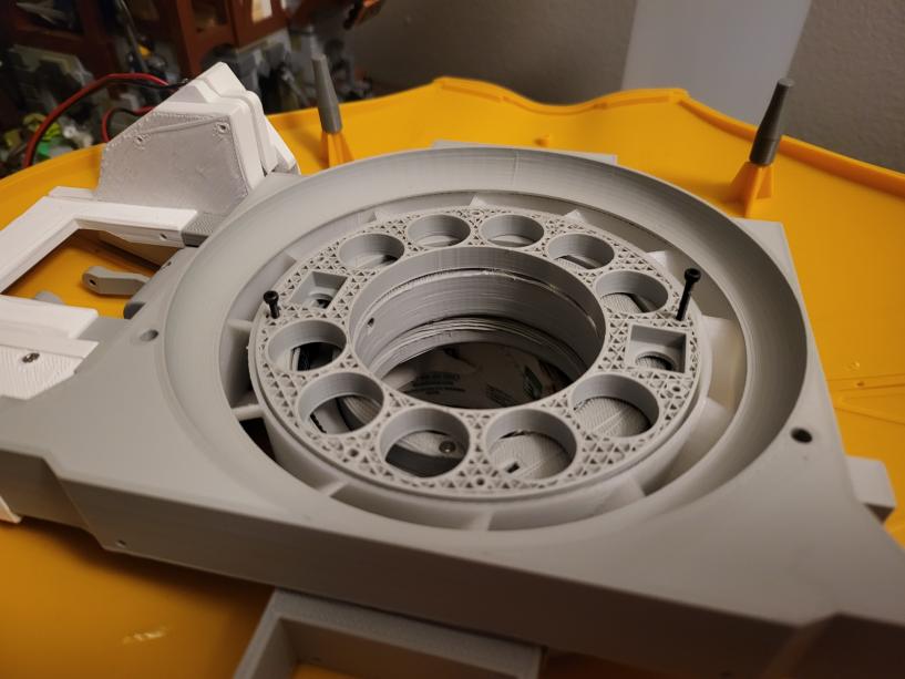

    4. Inside tests from a while ago. That is a 16 channel servo controller IC2 board that will be used to control most of the servos needed. The electronics for this will be incredible, and I'm excited to share that when they're further along.

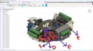

    5. Even tho I'm managed to designed everything small enough to fit inside without needing the extra height, I've got a few more tricks up my sleeve.

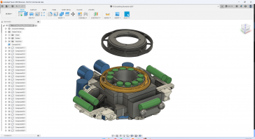

    6. A previous version, the water pump has significantly changed since then. With the added height, and buoyantcy of PP filament, I'll be able to add many more 18650 cells, and a lot more nonsense.

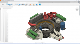

                A little clarification on how it'll move water around

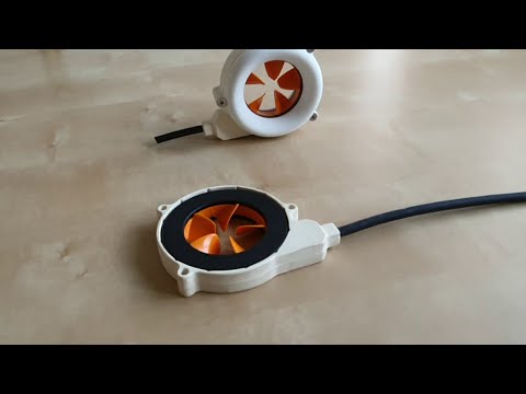

                  No being a skeptic but do you have proof of concept or technology demonstrator for this?
                    Loose the iris and make/use something like this
                      Ultra-thin hubless DISKDRIVE™ thrusters. Maximize efficiency, reduce space and optimize performance of aquatic vehicles.

                        The iris door won't be used to move water around, it'll just open and close for a fun addition. There are two large pumps that spin counter-clockwise to push water from the top and bottom into a central chamber that isn't visible. From there, water will go out tubes that I will be able to open and close with servos, thus giving me maneuvering capabilities. There will be a little room left over, and I'm thinking about adding some more motors to give me quicker forward movement, but I'll only add those when the rest of the stuff is modeled out.
