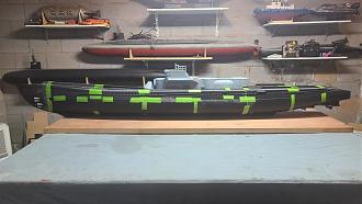

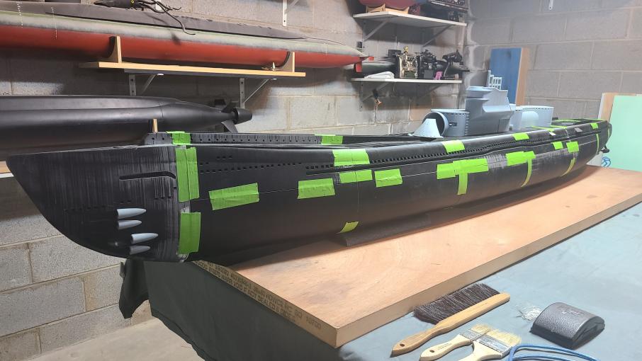

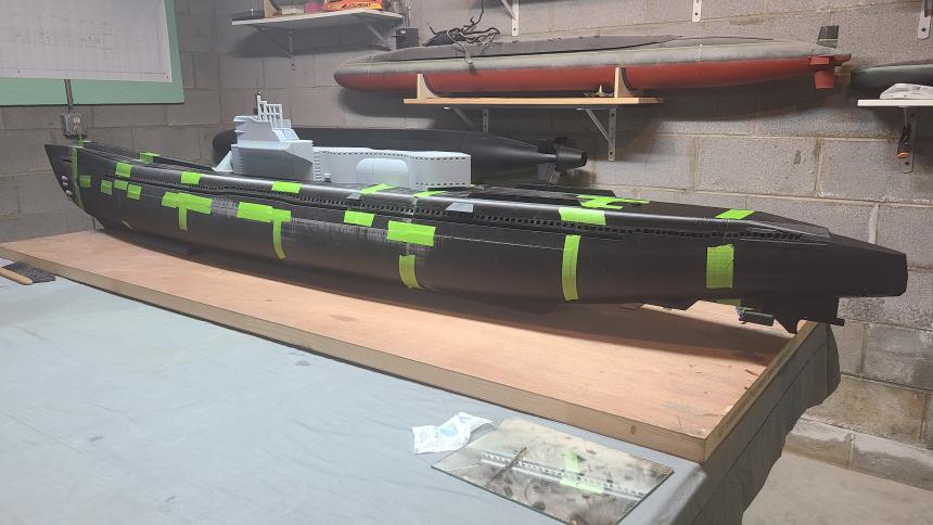

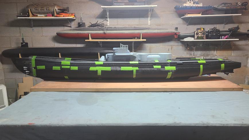

    I have been printing a large I-400 for one of my sons. He has been fascinated with the I-400 since seeing a YouTube video about them. At 1/48 scale this one chimes in as the second largest sub I have printed at 100" long with about a 12" beam. Hull is printed in ABS on my trusty Ender 5+ while the sail is resin printed. I will post up some additional stats later. I am leaving the bulk of the cleanup, sanding, filling, detailing, priming, painting and outfitting up to him so he can learn the process.
