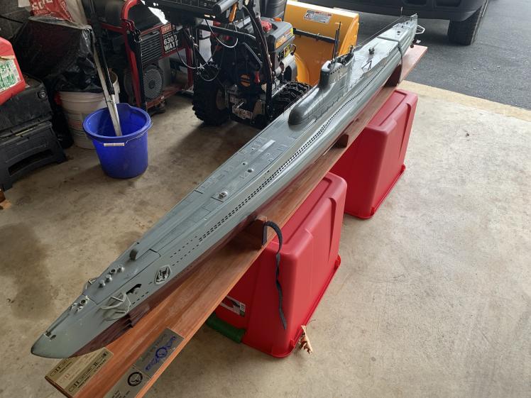

        Yea no one can ever say Steve's subs are to small. But saying that, I can wait to sail my huge 1/48 Japanese I-19 beside that 1/48 japanese I-400 at SubFest. I only tested my I-19 once and found out I have some weight issues I had to fix. Click image for larger version
