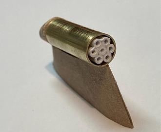

    I did not get a tight fit (red arrow 1st shot below) and thought it needed fixing, Caulking on the end of the dowel rod pushed out through the brass tube and smoothed off seemed to fix the problem. Hope it holds up for the mold. Still more work to do on countermeasures.

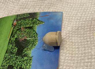

    The master for Tucson's countermeasures is probably the most difficult piece of work I've ever done - this is my third attempt and I'm still working on it. Eventually I will get right.

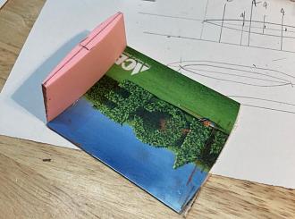

    Still working on countermeasures. Turned my drill press into a milling machine and using my Dremel tool on the pink stuff machined the following,

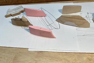

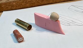

    I'm still trying to get the countermeasures right. Recall my first attempt in the first picture below. It was nowhere near what it should be so back to work. After trying several different materials I'm on attempt number 6 now using a pink material I found that is similar to Reshape and easy to sand. Picture 2 shows several throwaways. Each attempt is glued to my plastic Ace card for shaping on the sander. When one side is finished I reverse the piece on the card to shape the other side. When I finally get a piece I'm satisfied with it will become the master to mold 2 identical pieces. More to come.
