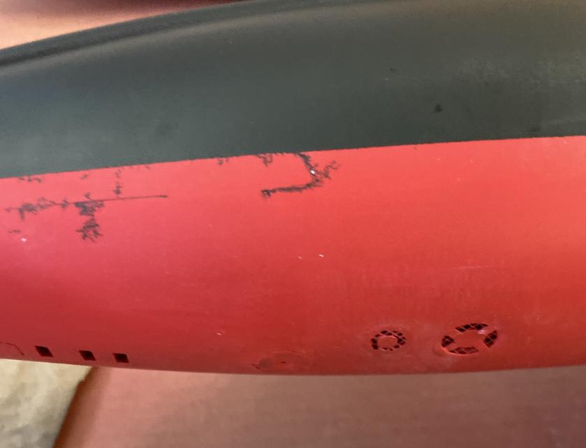

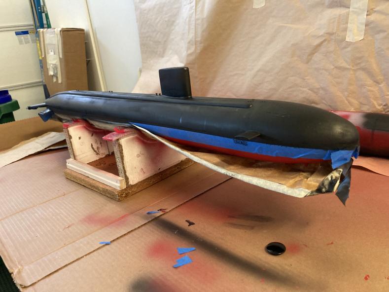

    Finally got the first coats of red and black on Tucson. Took some practice to improve my airbrushing since it's been years since I've used one.
    After peeling back some tape I realized I should have primed the tape edge with red before painting the black. That old painter's tip would have prevented the black from bleeding though.

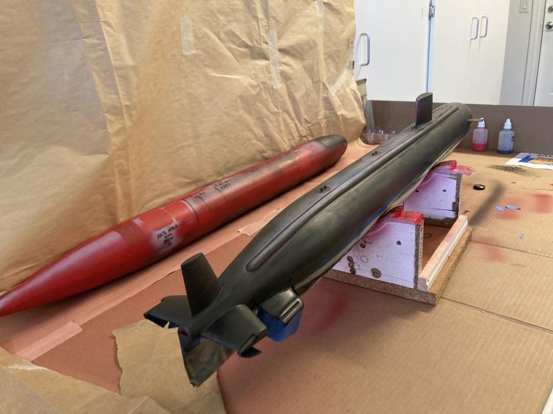

    Now I really have some work to do in masking and priming for the next coat of paint.

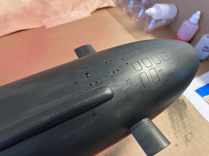

    Looks like I need to do some more fine sanding before the next painting. I also did a dry fit of some attachments on the sail. More to come on this later.

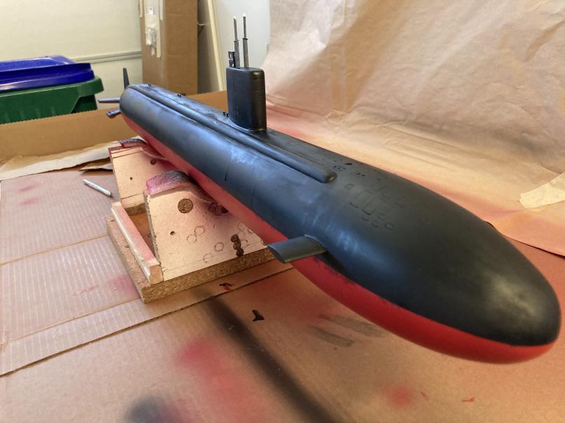

    The final touch will be adding the retractable capstan and the hinged cleats
    Still lots of work to do on the model including the prop, a stand and a display case. At least that's the plan.
