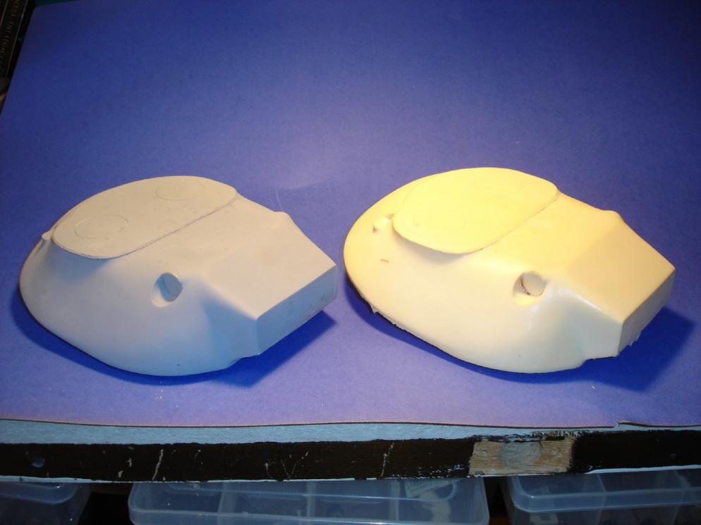

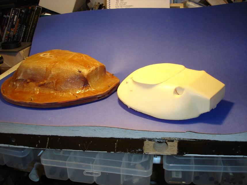

    Originally posted by Davjacva
    ***WARNING-NOT A SUB*** You have a few choices once you've made that master, which is looking awesome. I love working in foam, as it's so fast to work up a form. I use autobody fillers, which partially dissolves your master while you go, but it builds back pretty fast, as enough of it is left to move forward. I use styrene as rough templates, then keep drawing grid work on it and fill and sand to shape. Dave talked me into casting this work, and roto-cast some in Alumulite, then we laid up one in GRP which I used that one. Did the mantlet the same way, but just cast that piece conventionally. The gun was machined in three parts, then cast. Sorry, I don't have photos of the casting process. This work actually made it into some Cabal reports back in '06-07. The ones on here only go back to about 2008. Your sail work looks great, that's a showcase by itself for detail.
    This is just some of the work Dave and I got into to produce a stout, yet light weight gun barrel part for his tracked bang-bang machine.
    Leave a comment:
  • Davjacva
    replied
