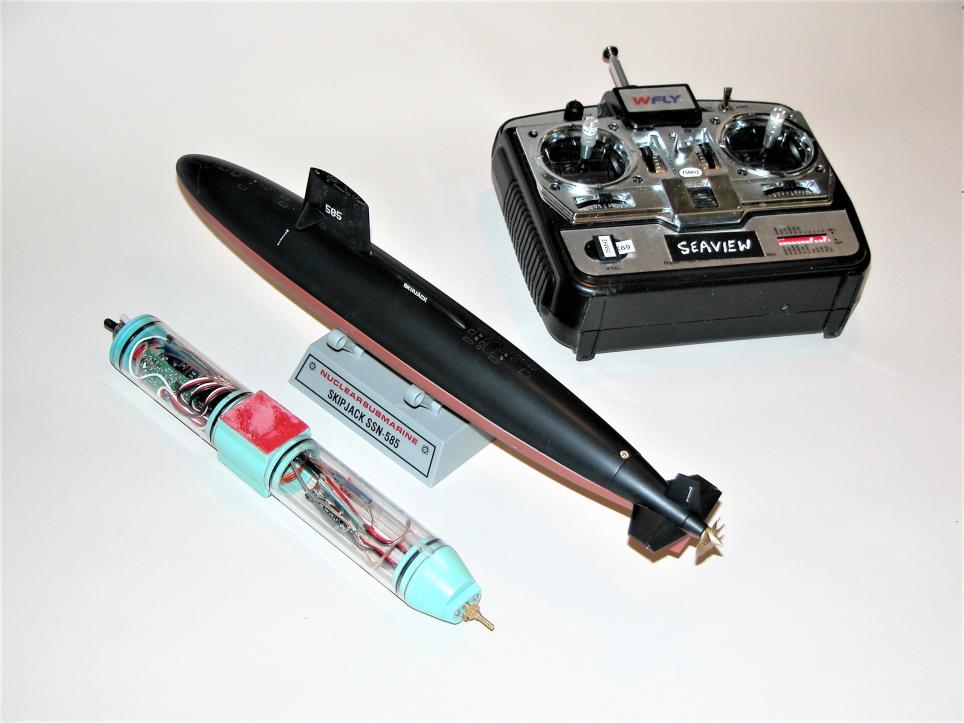

                            On a second subject, I also picked up the little skipjack conversion. I had a plastic kit of it so why not make it go? Dave, did you make yours a static diving sub? I read a lot of the older forum stuff on your small WTC and efforts to make it static diving compatible but I may go KISS method and just make it dynamic diving. Small 4 ch receivers are becoming a problem too.
                              • 13973
                              The little SKIPJACK propeller was glued to the shaft. The slightly fatter hub of the 1/144 KILO permitted use of a setscrew to secure that propeller to the propeller shaft.
                              The little SKIPJACK WTC was of the dynamic diving type.
