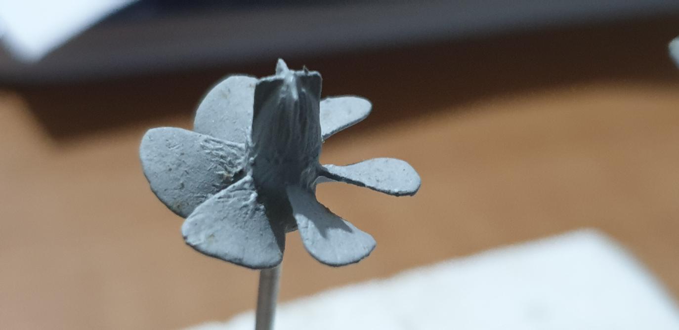

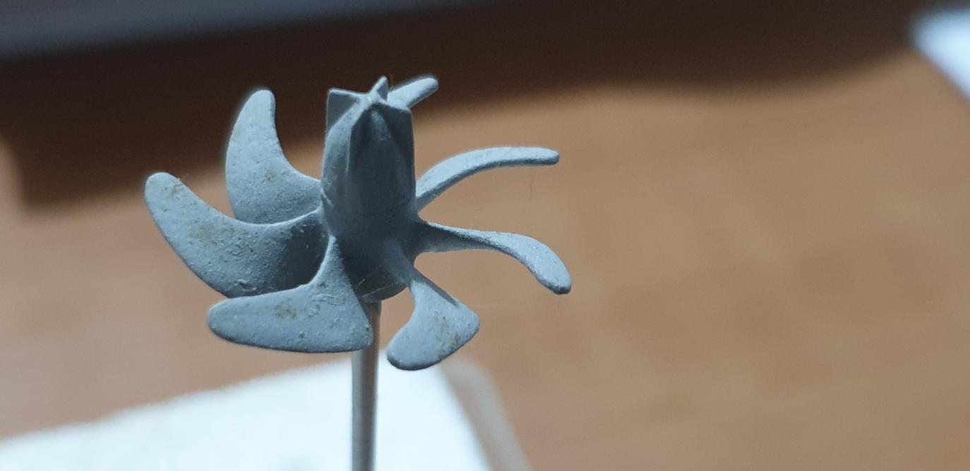

        Set screw? I just CAed mine together. First attached the vortex attenuator to the end of the 1/16 shaft followed by the main propeller hub.
        Prop coated with epoxy primer. Will be sanded smooth. Click image for larger version
