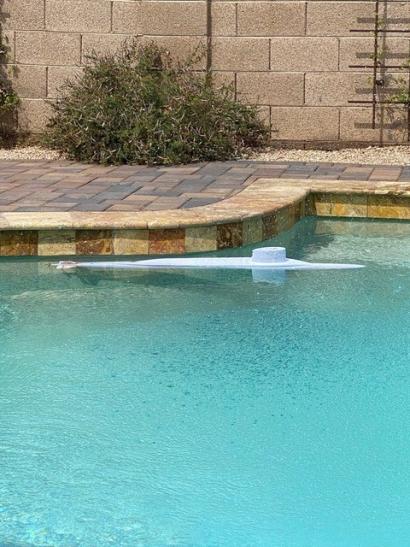

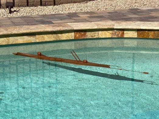

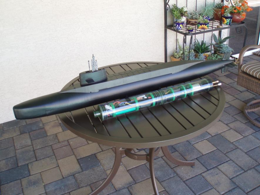

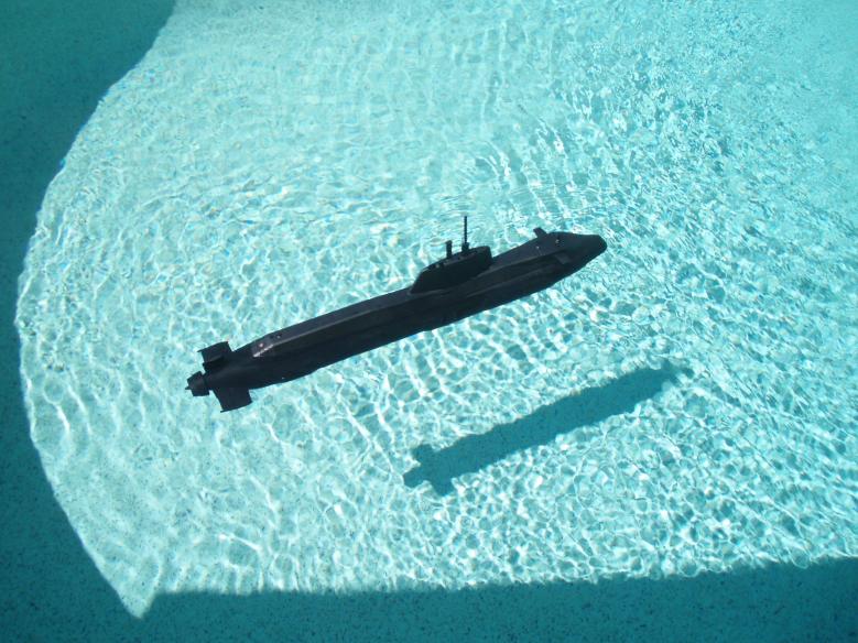

            Our pool is roughly the same size as yours and oval in shape! I currently have 6 boats that I can run! 4 of those boats are 3D Printed. The Astute, the Redoutable, and the HL Hunley! These are the boats from Nautilus Drydocks 3D Files!

            I also have the 1:72 scale Skipjack, 1:72 scale Abacore, and the Thunder Tiger Neptune! I also have four new boats in the works! 1:72 scale Disney Nautilus, The Russian Borei (3D printed) The German Type XXl, (3D printed) and last but not least the 3D printed Captain America Hydra Sub! All my 3D printed boats are from Nautilus Drydocks! That's my current water bound fleet right now!
            I custom built my own WTC for all my 3D printed boats! The Nautilus and the Skipjack use custom built MSD that I purchased from Nautilus Drydocks!
            I have to mention that the HL Hunley boat has a SD that was given to me by David Merriman III!
            As you can see, I love this hobby!!

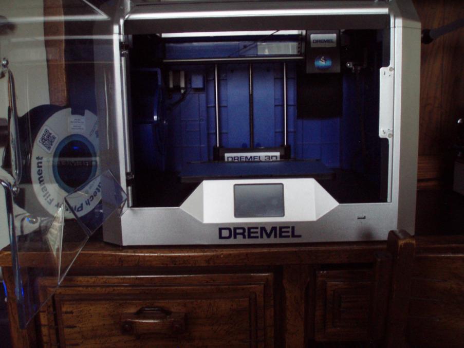

                    I am using a DREMEL DIGILAB 3D40 Printer! My question is: Are any of you using the Dremel line of printers (specifically 3D40) and are you using the DREMEL PLA filament or are you using one of the other brands that are available I prefer to USA manufacture only for PLA, But i just found out Dremel PLA is being manufactured in China!
                    With that being said, does anyone have a good QUALITY PLA (made in the USA) they might recommend for the DREME 3D40 Printer?

                      Rob,
                      I have two Dremel 3D45s. You can run other print filament, but you need to hack the unit by leaving a roll of filament in it and drilling an access hole in the side of the printer case to feed the new filament through. The Dremel filament uses RFID to identify the spool. No RFID, no filament detected and it won't fire up for you.
                      Not sure about a non-Chinese filament supplier. Seems like it all comes from there...
                        Bob
                        Thank you Bob for chiming in!
                        Your correct about the RFID! There are a few USA PLA manufactures out there, I will just have to do some research on that and decide if I want to hack the machine to get it to work. Thanks again Bob, I appreciate the information..
