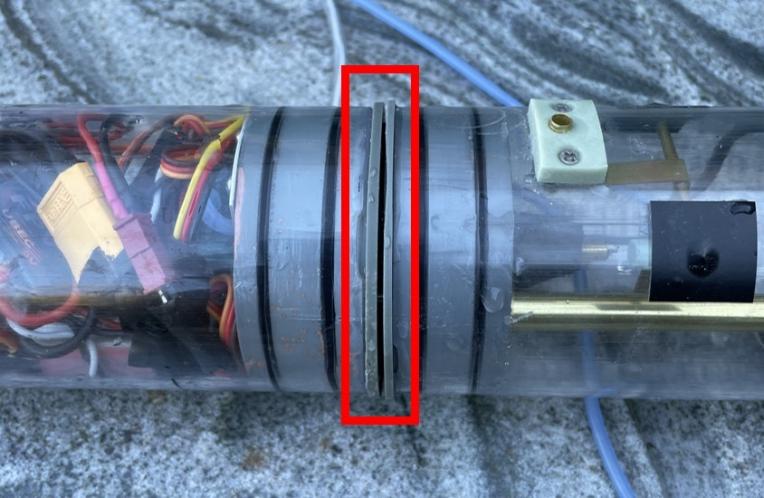

    I have the 2.5" MSD from Bob and I put it in the water today to do a pressure test. I didn't get any bubbles from any of the seals but I did get bubbles in the seam in the MSD fitting. I have attached a picture that shows the seam in the red box. It was a pretty good volume of bubbles, any thoughts?
    Click image for larger version  Name:	MSD help.jpg Views:	0 Size:	58.5 KB ID:	147914
    Cory,
    Inside that joint is an o-ring. That bulkhead is in two parts to make the modular assembly of a cylinder possible. Now that they're joined, they'll never have to come apart. Grind out the seam a bit and slather in some epoxy. That will take care of the issue once and for all!
    Bob
    • coryhenry
      • Jul 2020
      • 156
      Perfect, I thought that was the answer just didn't know if it would affect the mechanics.
        Take it apart and check the O-ring.
          If the O-ring leaks, the water will migrate through the slight gap in the bulkhead faces, into the over-size holes of the securing bolts, conduit bore, and ballast servo pushrod bore -- you will flood the after dry space. If you just slap glue to the outside gap you will negate your ability to fix this thing!

              That would work. But before resorting to that examine, examine the situation: Was the O-ring out of its groove? Was there some crap in the groove to prevent sealing? Is there a tear in the O-ring? Did some ****ing moron forget to install the O-ring during assembly?...

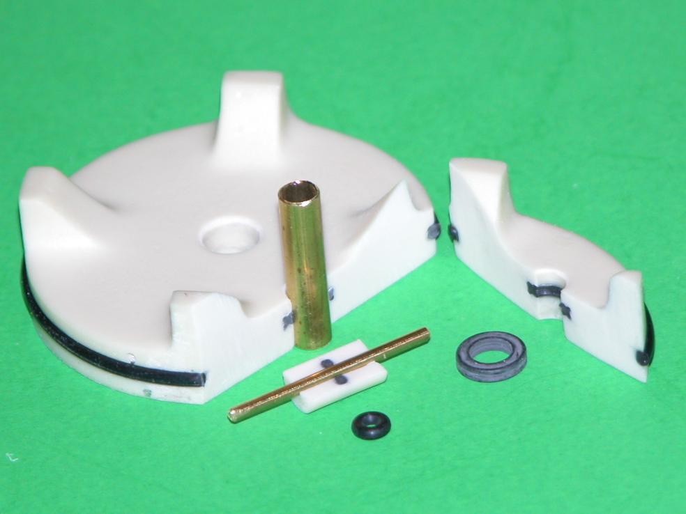

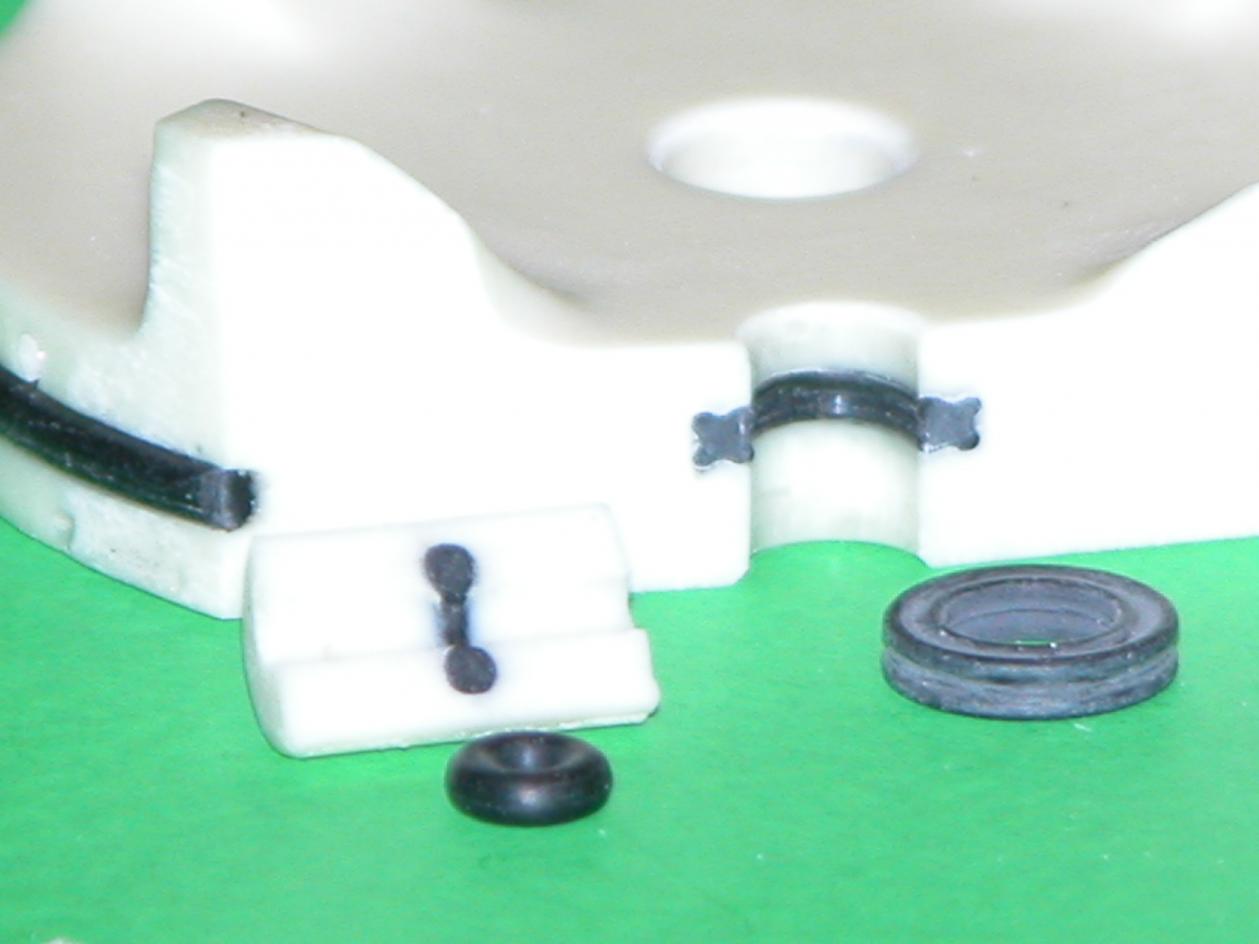

                  An encapsulated O-ring.
ID:	148138Click image for larger version
                    I find that gluing one end of the conduit permanently to a ballast bulkhead is a good idea. If you constantly push/pull the cables in and out, it's likely that the conduit can snag and get pulled in one direction or another, parting ways with the seal and causing a leak. If you glue one side permanently, you can still disassemble in case of massive internal repair/refit, but the conduit won't shift on you.
