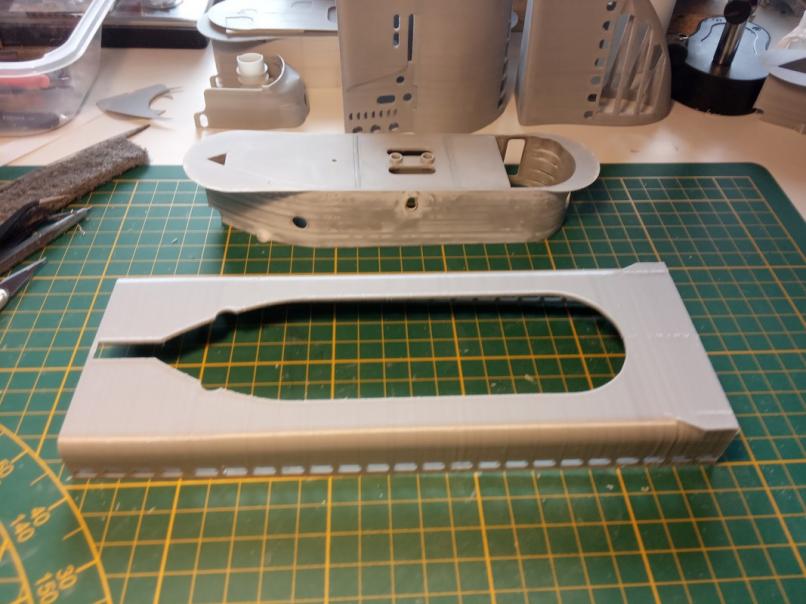

    This week I printed two more pieces of the upper deck.
    With the planking problem solved this took not as much time to print.
    First the piece where the fairwater will be mounted, I consider the make the fairwater removable.
    Click image for larger version  Name:	IMG-20210325-094002.jpg Views:	0 Size:	64.0 KB ID:	148743
    And here with the front deck piece and fairwater in place to check fitting.
    Click image for larger version  Name:	IMG-20210325-094212.jpg Views:	0 Size:	65.7 KB ID:	148744

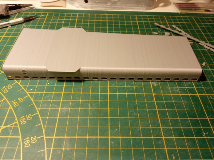

    And the third piece.
    At the end of the war the new deck gun was located here, however my model will represent the Bowfin in november 1944 where it still had the old deck gun in front of the fairwater.

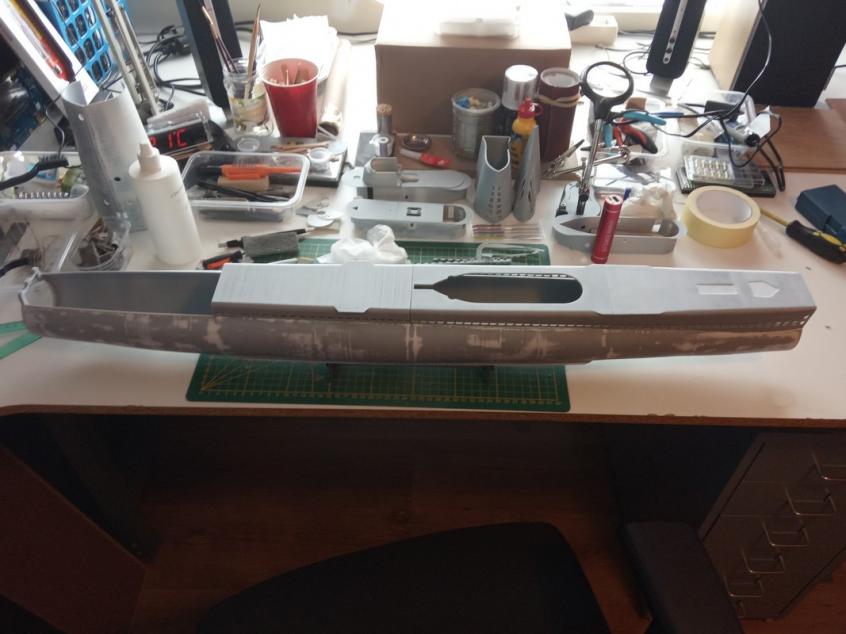

    And the progress so far, partialy kept together with tape.
    just to get a impression how the model gets along.
    Click image for larger version  Name:	IMG-20210326-111750.jpg Views:	0 Size:	57.7 KB ID:	148747
    It actually starts to look like a submarine :)
    Click image for larger version  Name:	IMG-20210326-111820.jpg Views:	0 Size:	52.8 KB ID:	148748

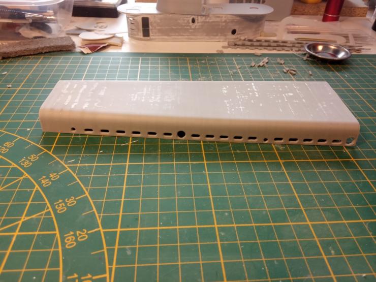

              Deck piece after some rouch sanding.
              And after treatment with resin and sanding.
              And the last deck piece, fresh from the printer.
              The hole in the top is where the capstand will be, I plan to use this part to screw the deck to the hull for easy acces.

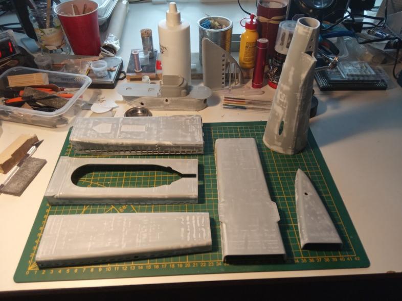

              And all of the deck done and ready for final assembly and finishing.

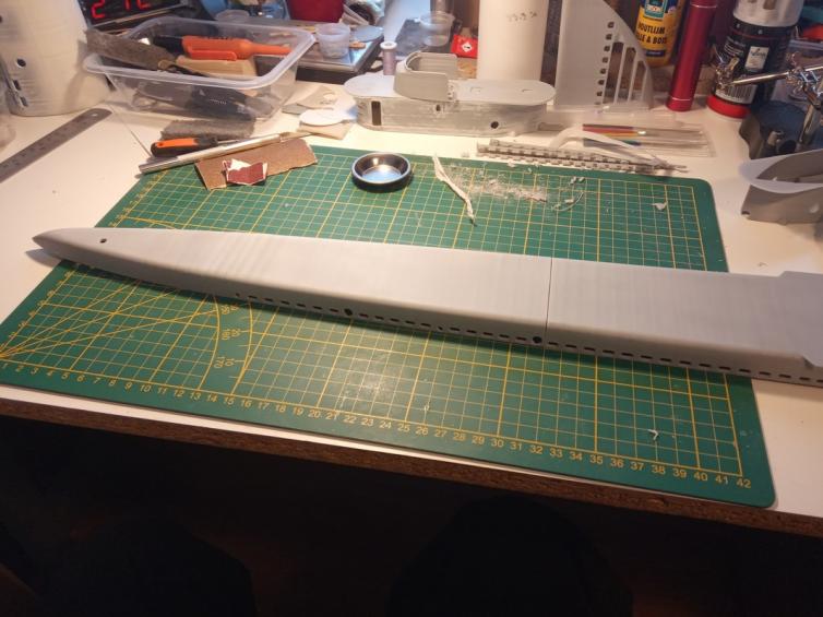

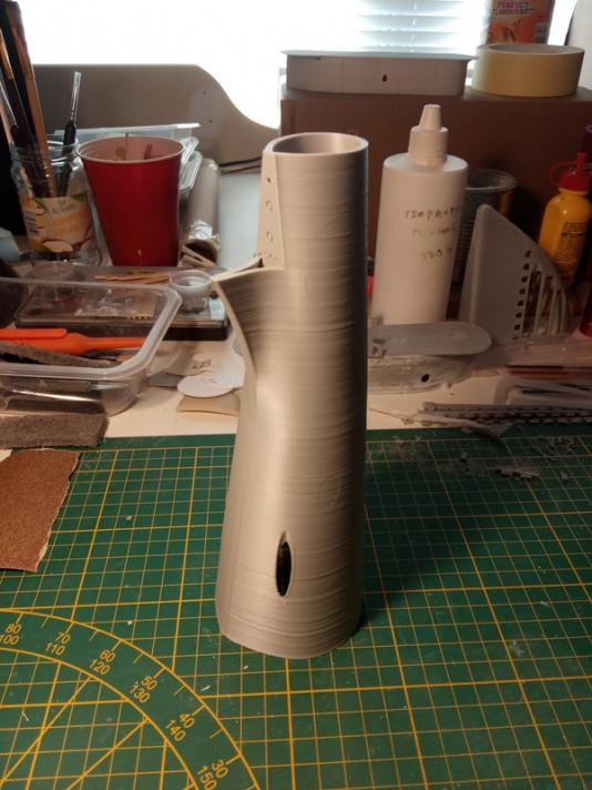

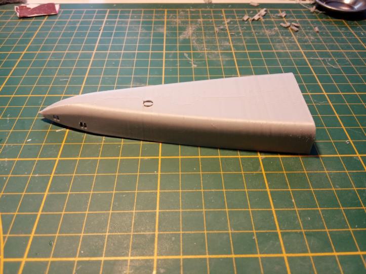

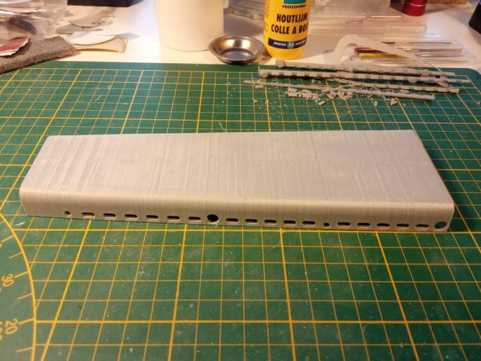

                Here the last big hull part, fresh from the printer.

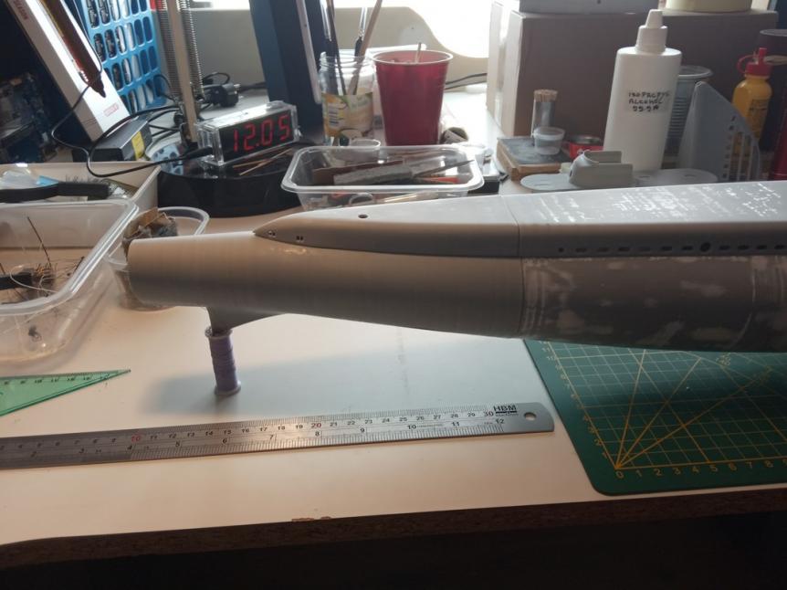

                The hull part finished with resin and added to the rest of the hull with chewing gum to give a idea.

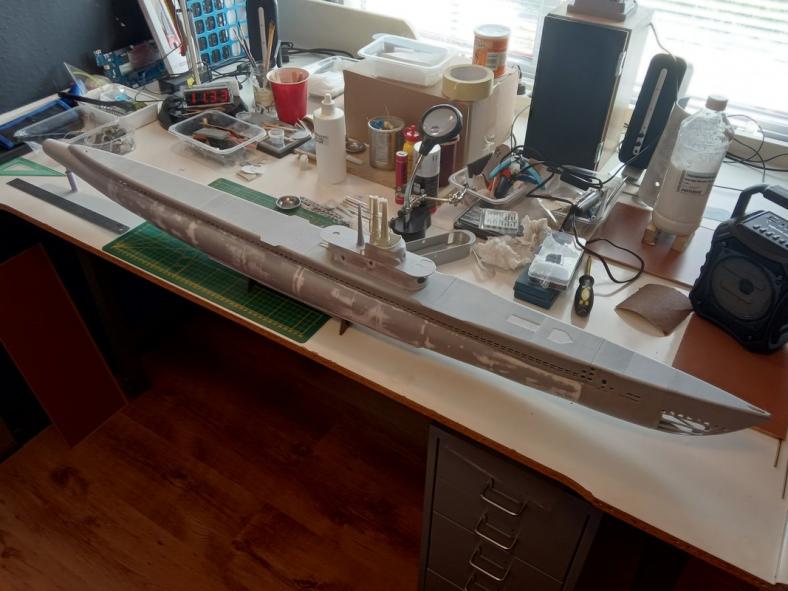

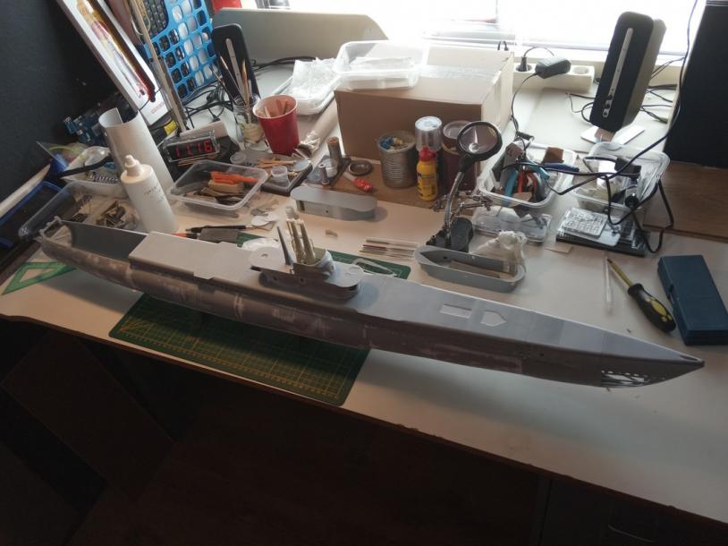

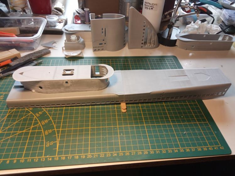

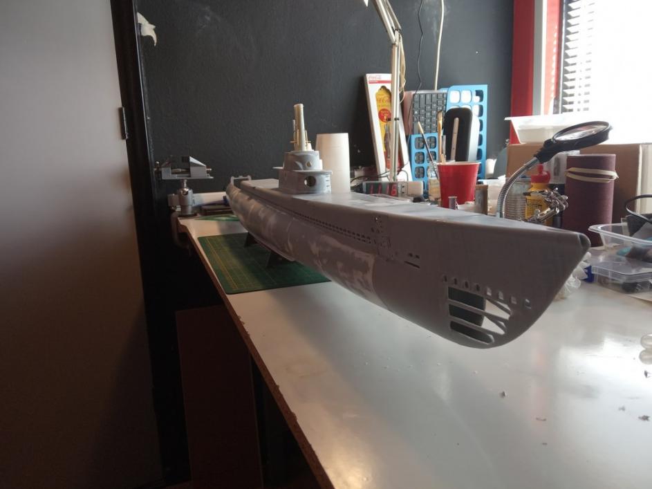

                And a mockup overview of the progress so far.

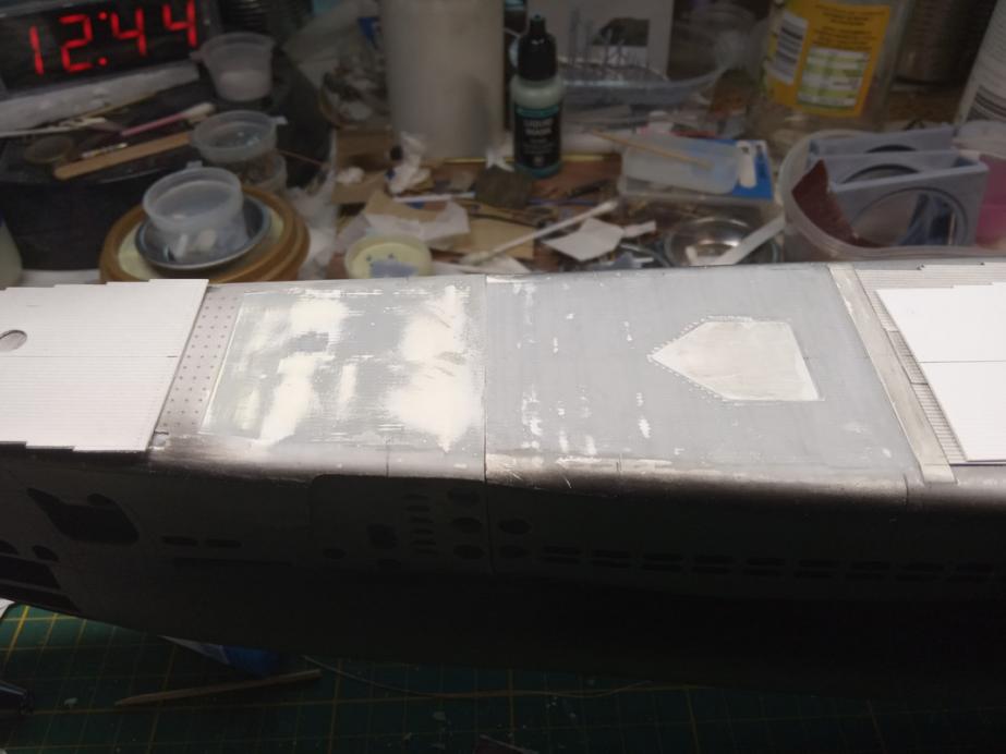

                The deck parts treated with filler and sanded, ready for use.

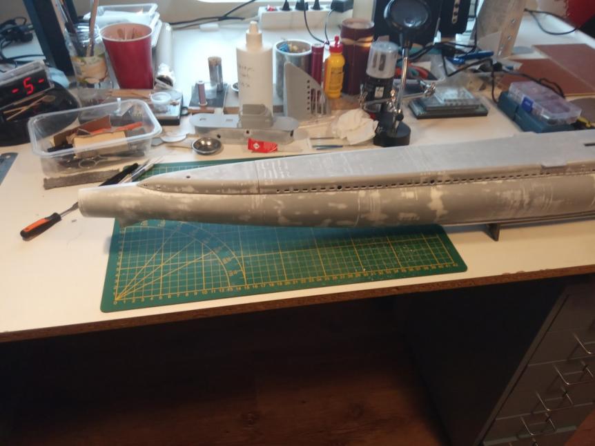

                And the hull part fixed in place.

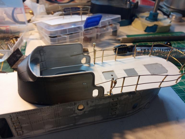

                      Work on the fairwater railing.

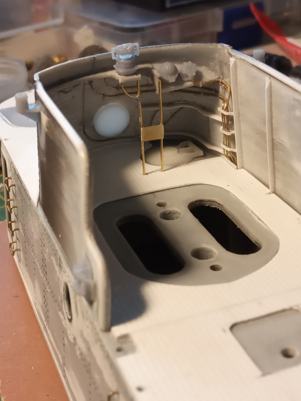

                      Bridge details added.

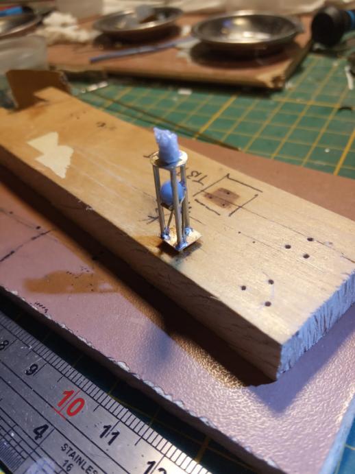

                      The rear TBT, stand made out of brass wire.

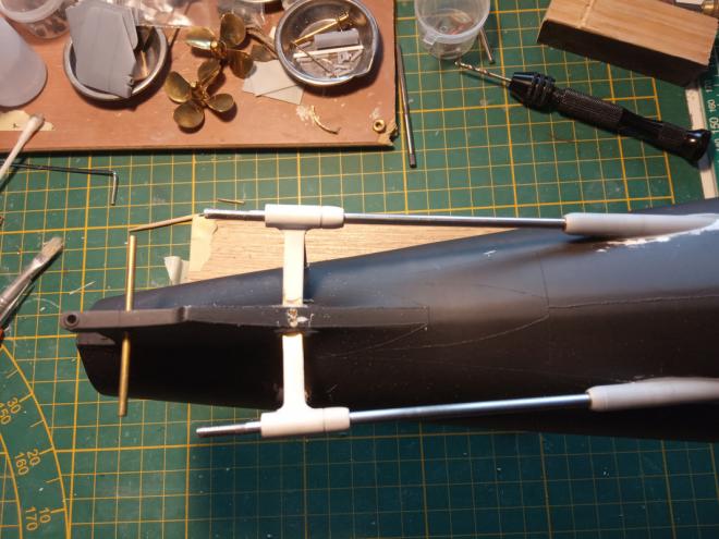

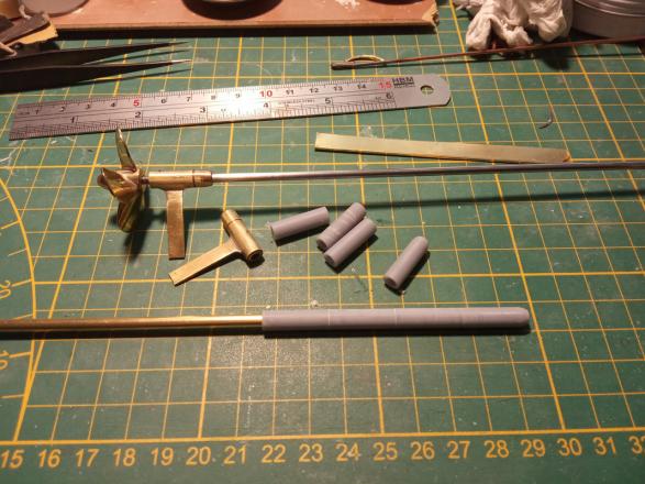

                      Making of the proppelor struds.

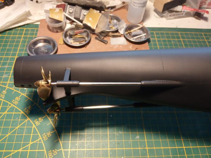

                      And finished, only need to make some nuts to lock the proppelors.

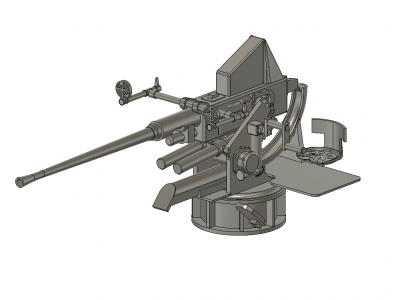

                      Design of the 40 mm Bofors.

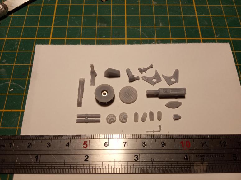

                      The printed parts, ready for assembly.

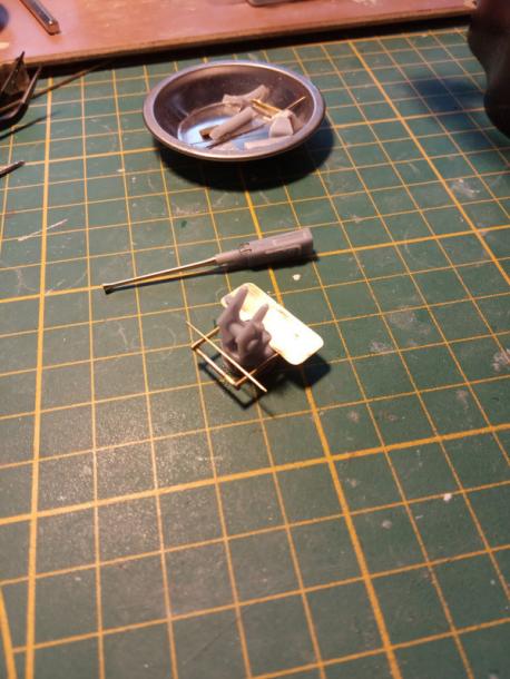

                      The barrel and frame are made out of brass.

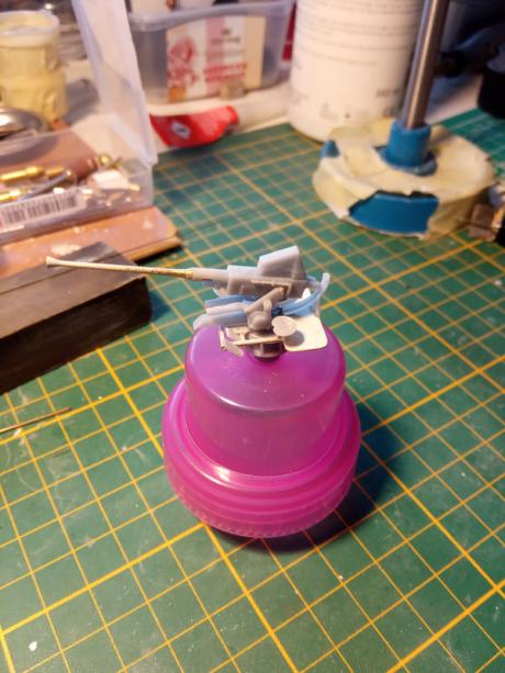

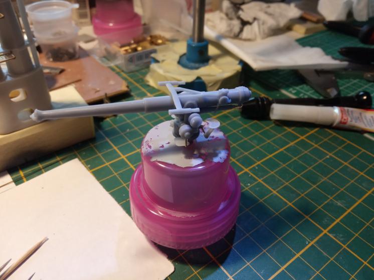

                      And the finished model ready for painting.

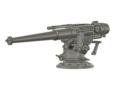

                      Design of the 4" / 50 Cal deck gun.

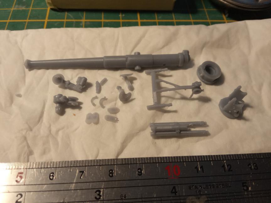

                      Printed parts ready for assembly.

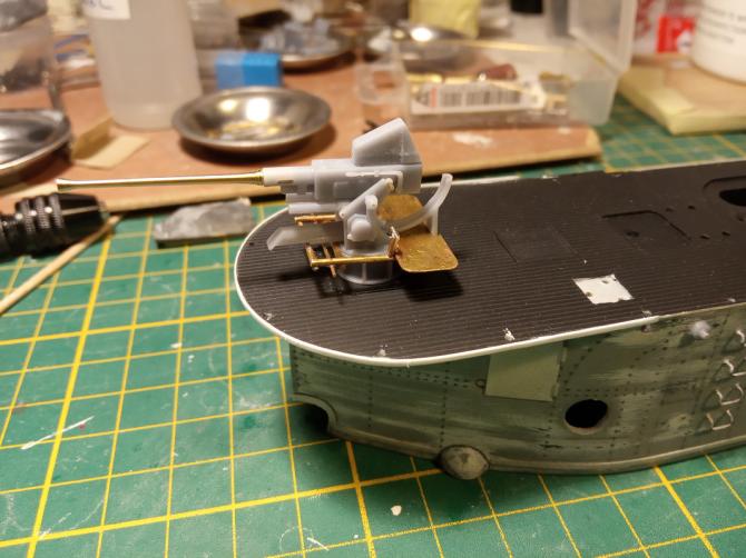

                      And the finished gun ready to receive paint.

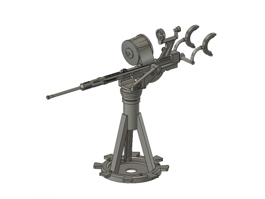

                      And onward to the 20 mm Oerlikon design.

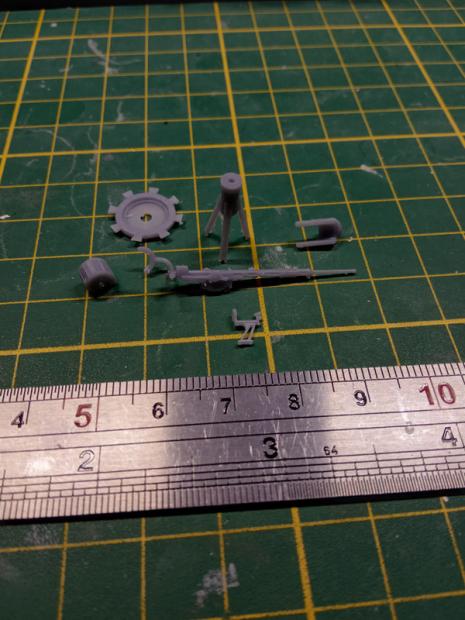

                      Printed.

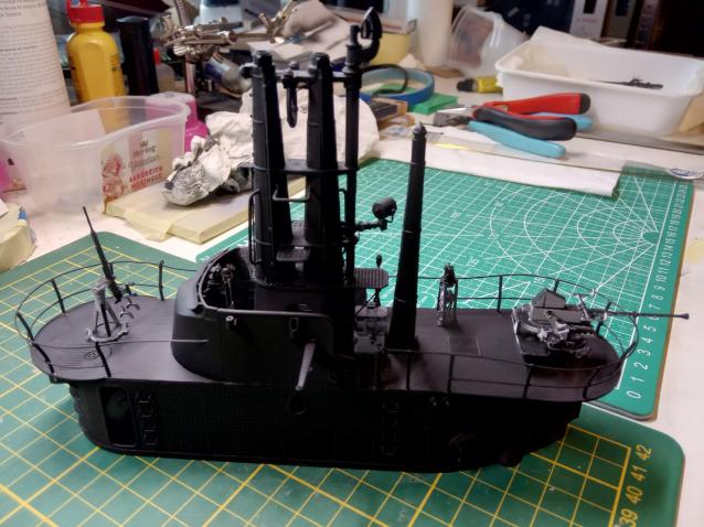

                      And the build up of the Fairwater with the basic layer of paint.

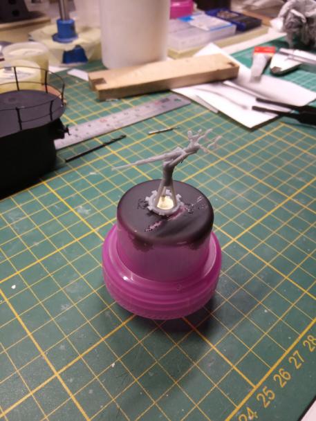

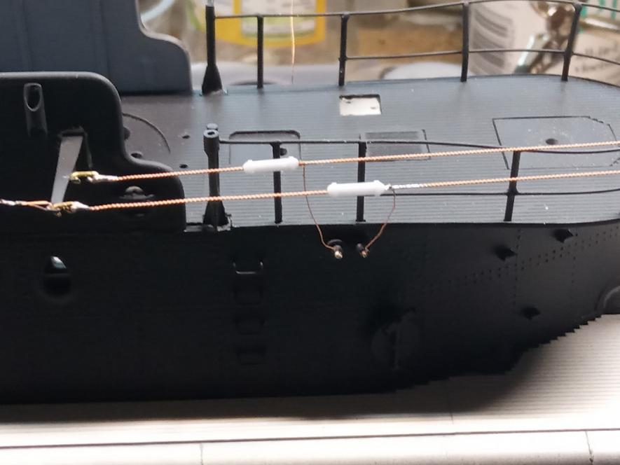

                      Adding the antenna's

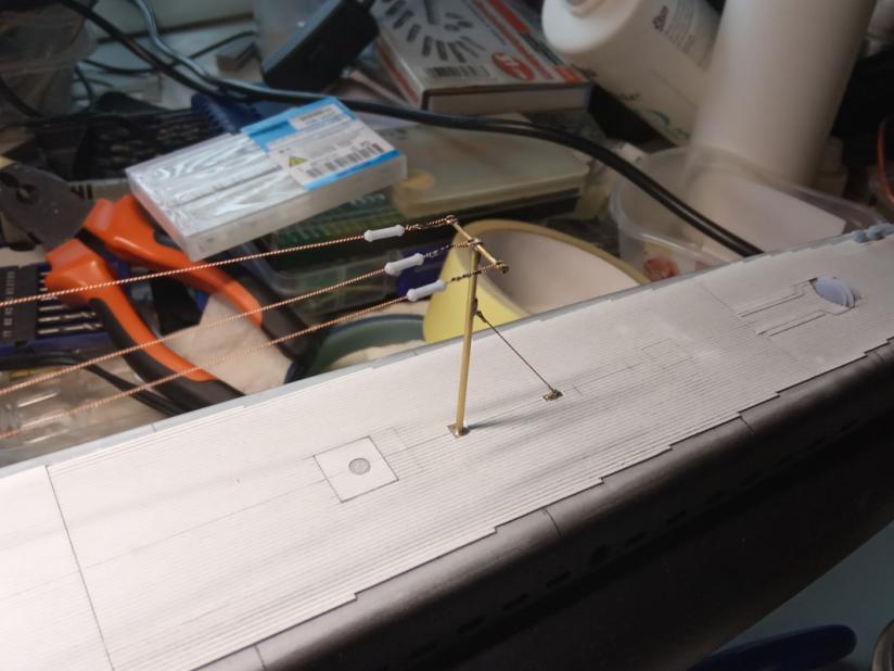

                      And the rear antenna post.

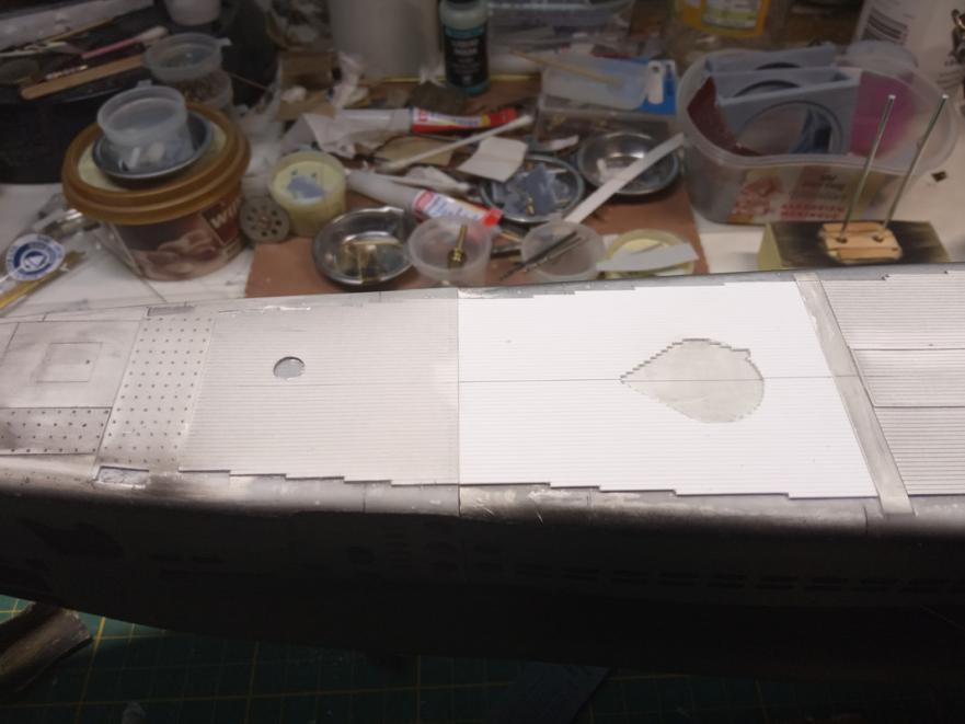

                      I was confinced the the opening in the wooden deck around the hatch was wrong, as it is now it is from after the war.
                      So I replaced the deck with the correct opening.

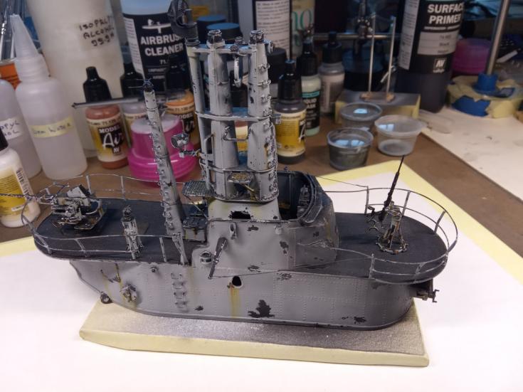

                        And the parts that are now finished.
                        The complete Fairwater is now painted and weathered and ready to receive the last layer of farnish to protect it.
                        I did a lot of picture study to keep the weathering as real as possible and not overdo it.

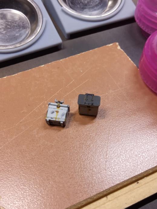

                        The 40 mm ammo lockers from the bridge.

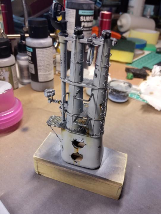

                        The periscope masts.

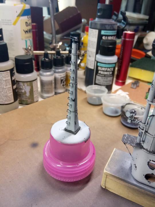

                        The SD antenna mast.

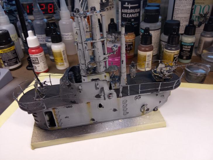

                        And the complete Fairwater.

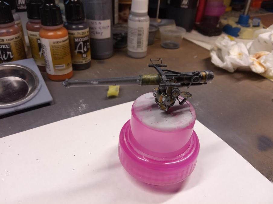

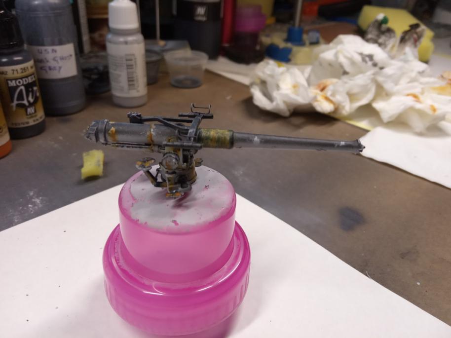

                        The 4"/50Cal deck gun.

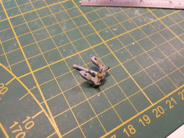

                        The Anchor.

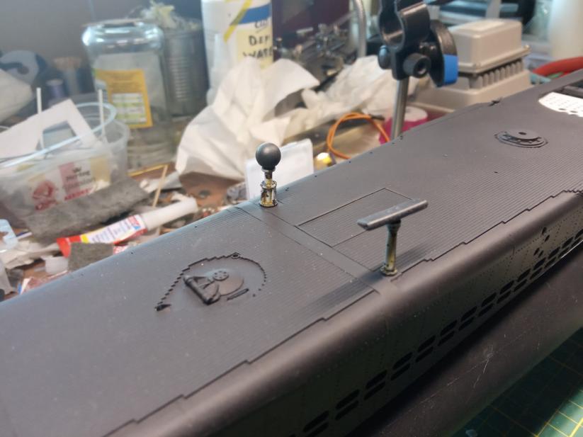

                        The Sonar and Hydrophone.
                        The deck and hull are now in the first black layer, ready for painting and weathering.

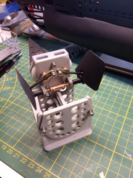

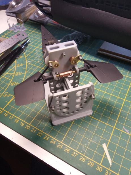

                        The deck will be finished as soon as the railing is in place.
                        In the mean time I started on the mechanism to fold up the bow dive planes.
