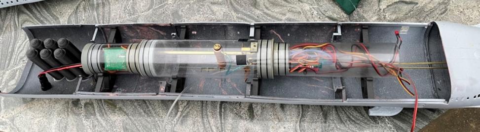

                    Got some more work done on the FDM hull. The MSD is just about the right size. I thought I was going to have tons of room in this cylinder but the missiles cut that prospect short! The battery will be in the bow and two servos will also be run wet in the bow. The FDM hull is proving easier to work on and less brittle. For scale the ballast tank is 10inches long.

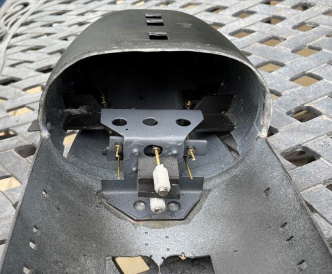

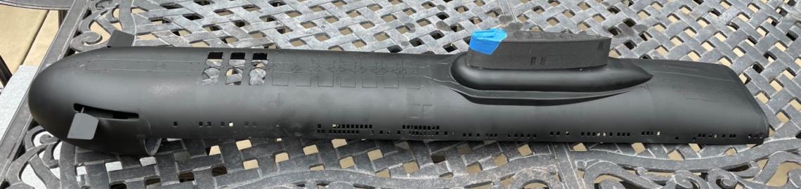

                      Got another chunk of work done on the FDM hull. The upper is almost complete with the retract mechanism custom made in Bob's design. I also got the connection complete around the missile tubes and the drive train is almost complete.
Name:	upper progess small.jpg
                      The retract mechanism was a bear to design and create but it works!
