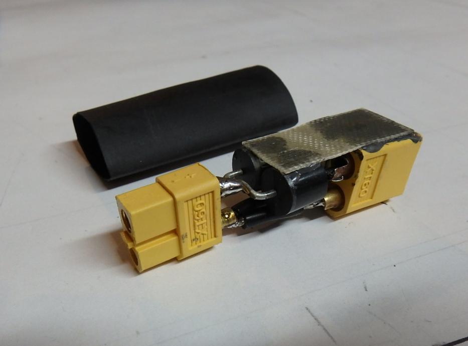

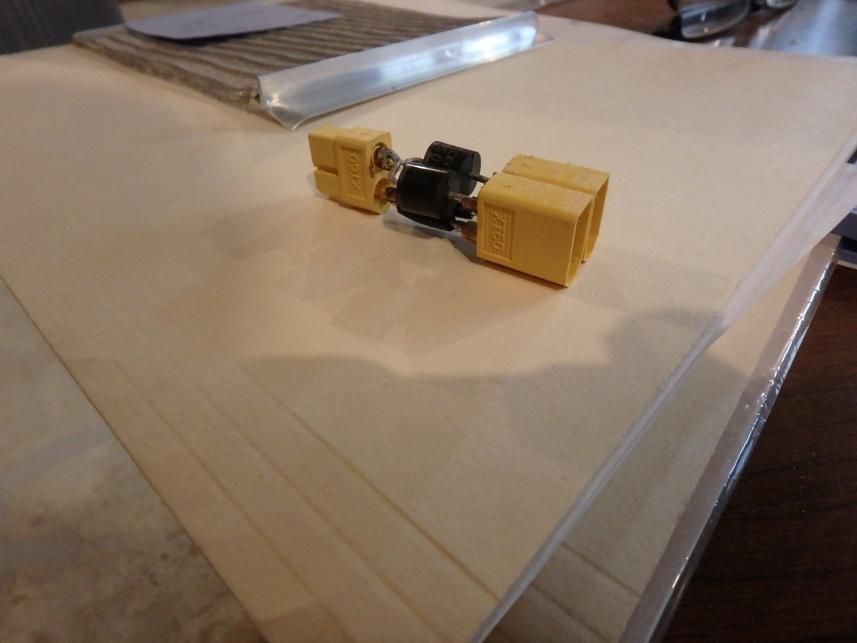

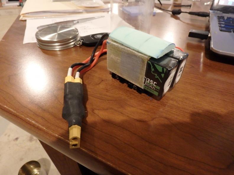

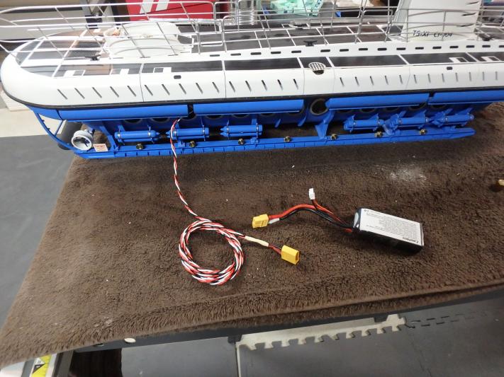

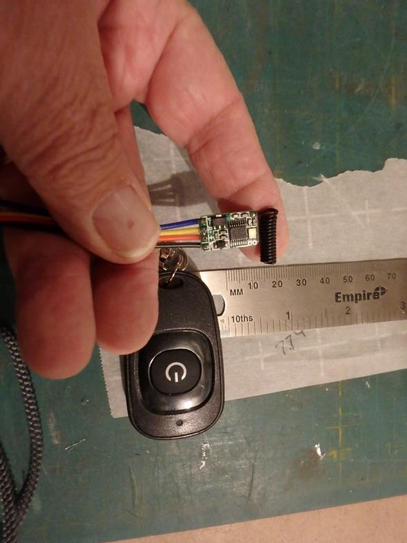

          The self contained parallel second battery with its fiberglass interference fit box, the paralleling connector with integral diodes, 433MHz switched on and off battery monitors:
          Click image for larger version  Name:	PB160008.jpg Views:	0 Size:	38.0 KB ID:	167148Click image for larger version  Name:	PB170001.jpg Views:	0 Size:	40.0 KB ID:	167147Click image for larger version  Name:	PB230031.jpg Views:	0 Size:	53.6 KB ID:	167149
          Click image for larger version  Name:	PB210002.jpg Views:	0 Size:	47.9 KB ID:	167150Click image for larger version  Name:	PB230032.jpg Views:	0 Size:	47.7 KB ID:	167151
          The paralleling connector allows easy battery disconnect and removal for recharge...
          The foam half circles keeps the assy. straight in its container and allows the P.E.T. jar to easily screw into its lid without twisting the wires...
          That 433 MHz switch only draws .1 milliamp in standby (not a typo) 1/10000amp!-allows shutdown of Low Voltage alarms without opening the sub.

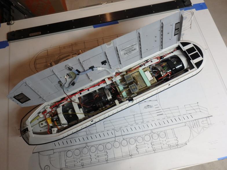

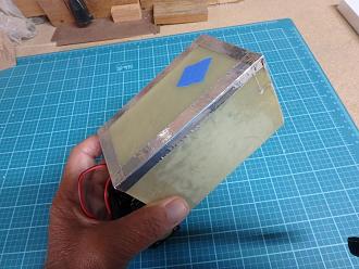

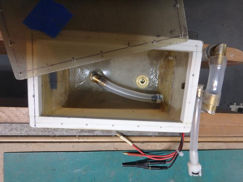

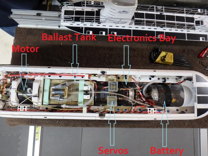

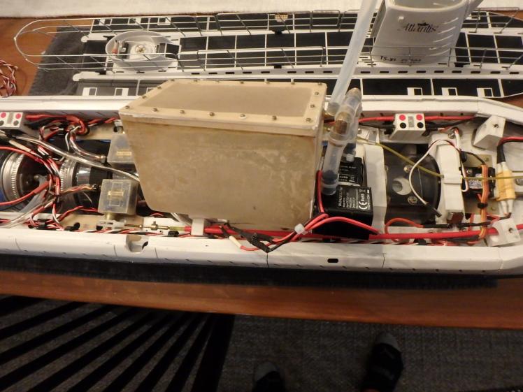

                Latest upgrade is to swap the position of the ballast tank and the electronics bay-this should bring the center of float closer to the center of gravity. I am trying to dispense with much of the foam and lead- tub test will tell-BG
                Click image for larger version  Name:	PA210033.jpg Views:	0 Size:	65.8 KB ID:	168557 Click image for larger version  Name:	P1120005.jpg Views:	0 Size:	74.5 KB ID:	168558 ​

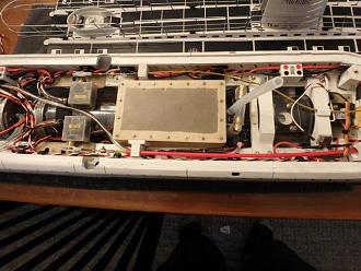

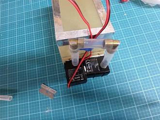

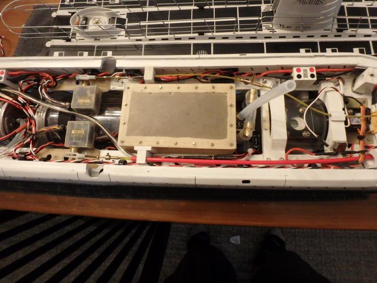

                    I hadn't touched the Atlantis throughout the entire Regulator build (also going to Groton ) I wanted to remove the pumps from inside the ballast tank and move the tank further fwd . I built a new ballast tank which allowed for 4 ounces more of displacement. Pictures to follow...
                    Also I needed a way to bench and tub run the boat while working the systems. So in keeping all the weights the same without actually having the batteries on board-I made a shore power cable that plugs into the power system. It will run the boat on the bench or in the water. This model has junction blocks that accept those 3mm gold plated banana plugs. I am up to the final checks where the batteries are sealed in their WTC but just not plugged in. If the final leak checks and trimming works out-I will charge them up the night before and plug them in at North Lake.
                    Click image for larger version  Name:	P8250003.jpg Views:	0 Size:	72.7 KB ID:	182422

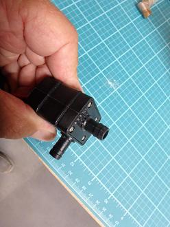

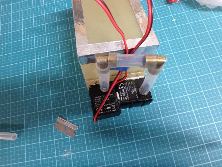

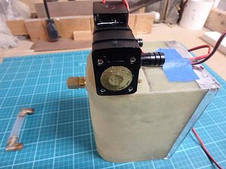

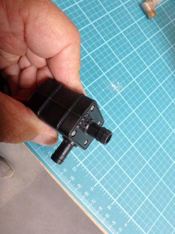

                        Yes two brushless underwater fountain centrifugal pumps that push water through each other to provide reversibility of flow-
                        There is a lot of components to fit in a 33 inch model but Its all modular...the ballast tank lifts out, the radio bay slides back and the battery WTC slides back and up
                        That loop of tubing and brass from one pump to another is a siphon break to stop water from siphoning back into the tank keeping the boat surfaced statically--BG
                        Oh and a special shout out to all those stoners out there that keep those brass pipe and bong screens available they are the best for keeping all those bugs out of the plumbing...

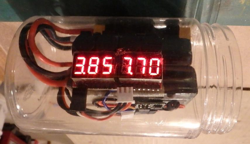

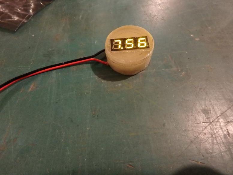

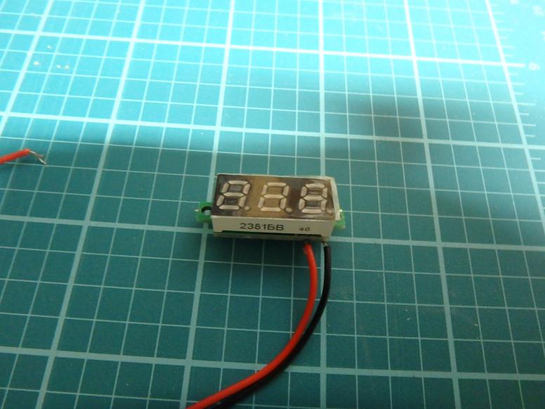

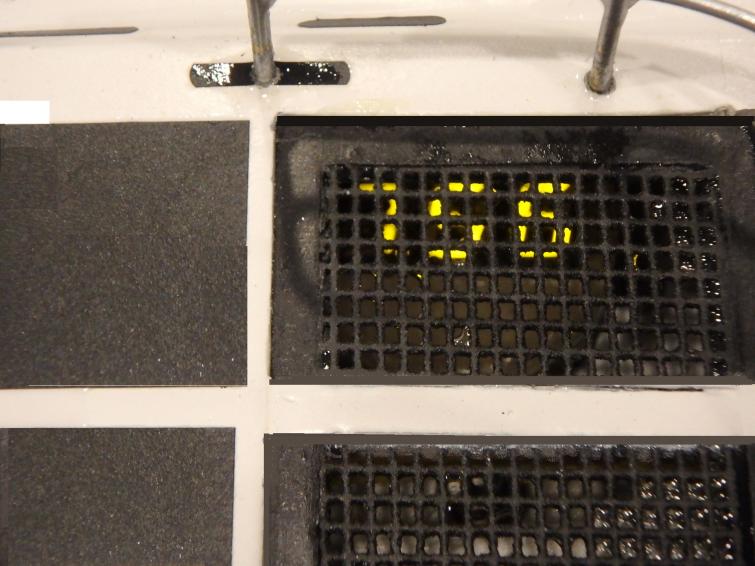

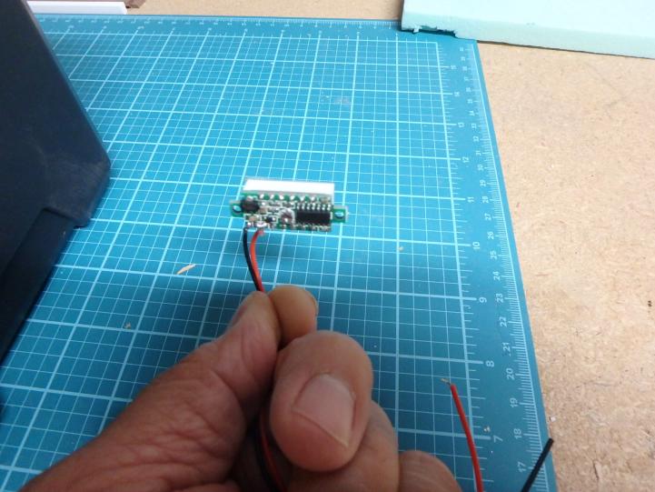

                          I realized that this little gadget would be an easy, simple, and useful addition to the Atlantis. I took a cheap voltage readout module and encapsulated it 1/2 in epoxy and 1/2 in clear casting resin. It was an easy plug in to those junction blocks that I built into the boat. I mounted the waterproof capsule under an aft grating on the deck-now battery voltage is an easy readout ...I was able to eliminate the switchable battery readout in post 34-
                          prime directive: Simplify...
