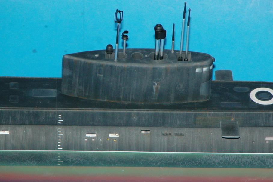

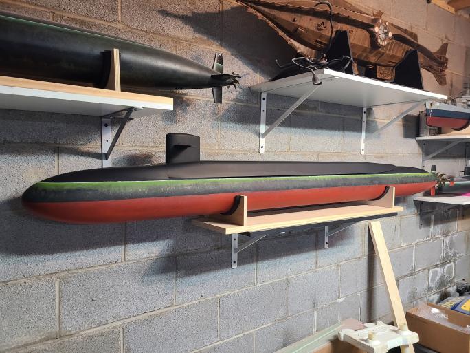

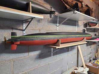

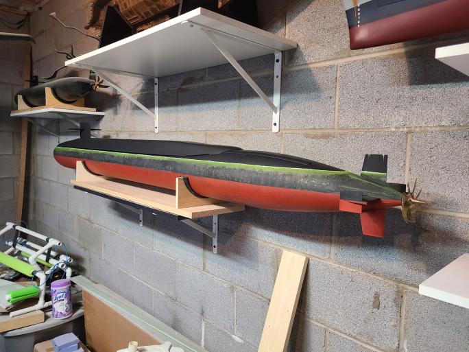

        Scum line on it. Will be adding some weathering details to the deck next.

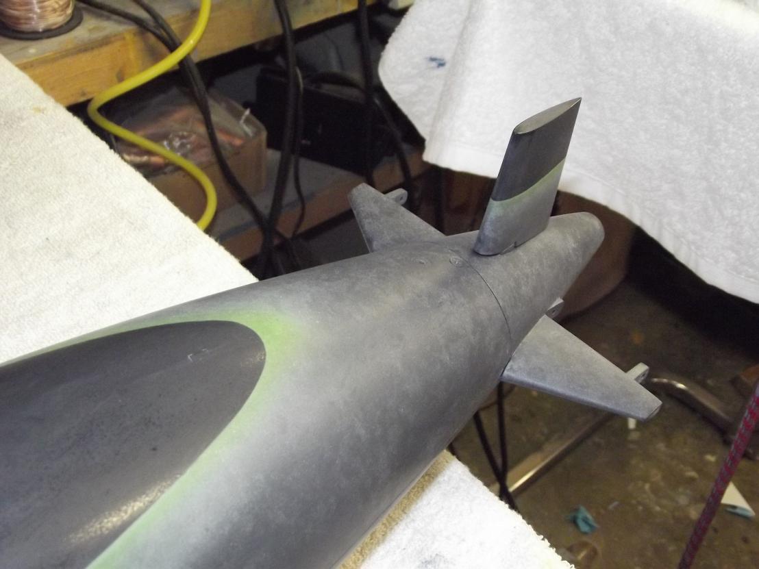

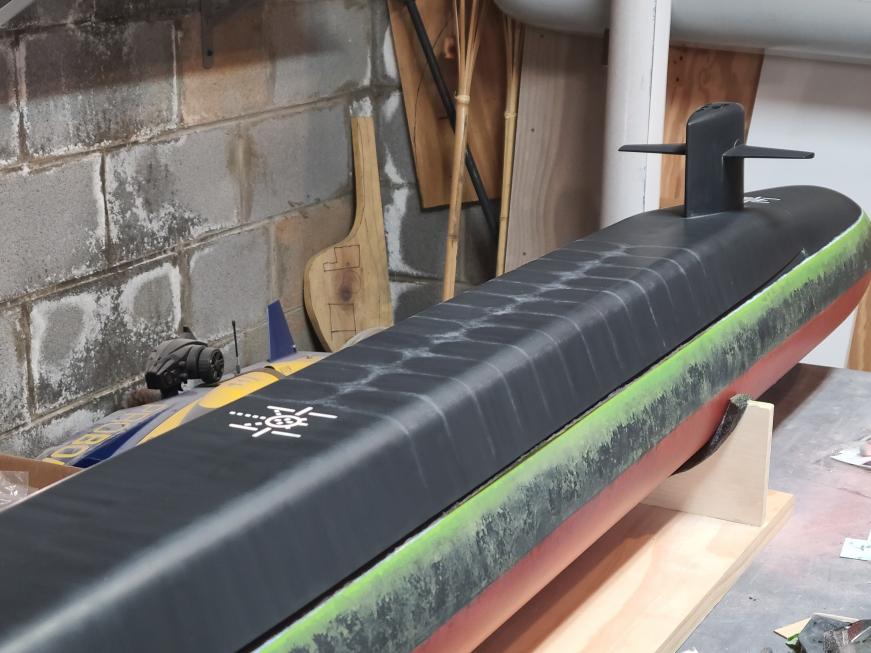

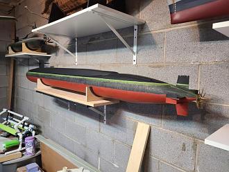

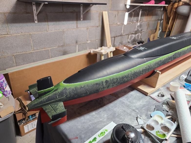

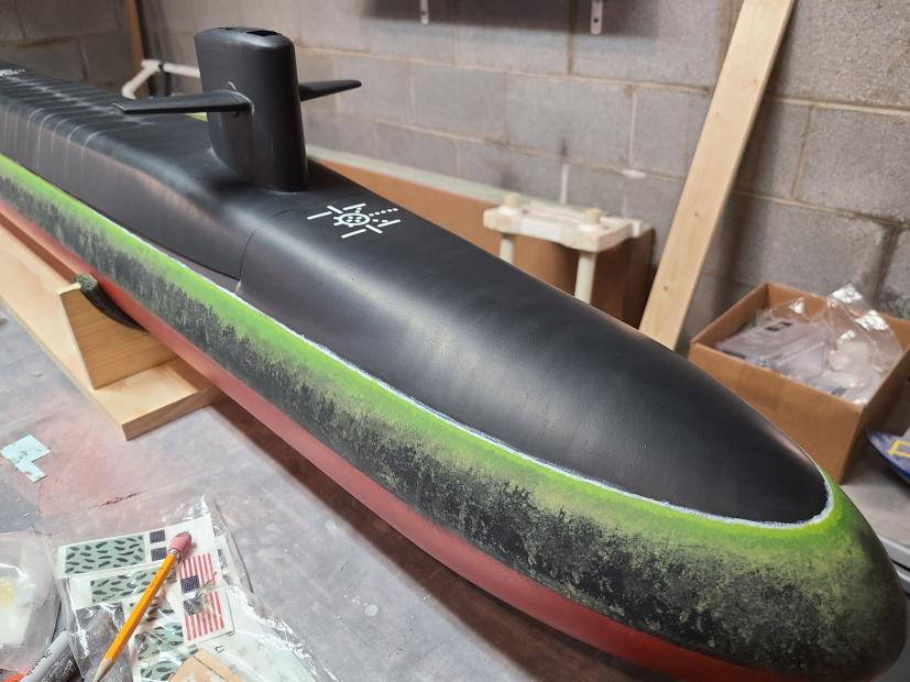

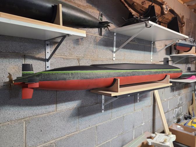

          Weathering on the deck/hull done. Just needs a few more graphics and some masts. She's not even gotten wet yet and already needs a good scrubbing. Lol.

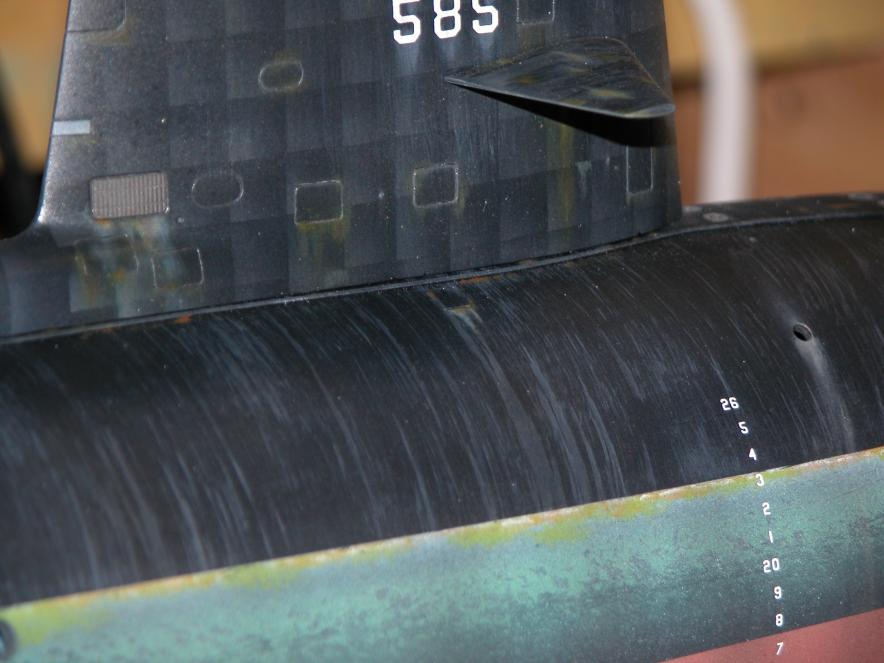

              The transition from splotchy bleaching to green slim is too stark. Blend the two with oils. Reduce the height of the green. More 'dirty water' run-off from deck down to waterline. NO VERTICAL STREAKING FROM WATERLINE DOWN!
              What a magnificent beast you have there! Looking forward to the day you can provide me target services with that thing.

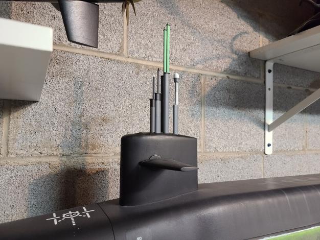

                Spent some time working on the masts. They are made but not yet secured.
