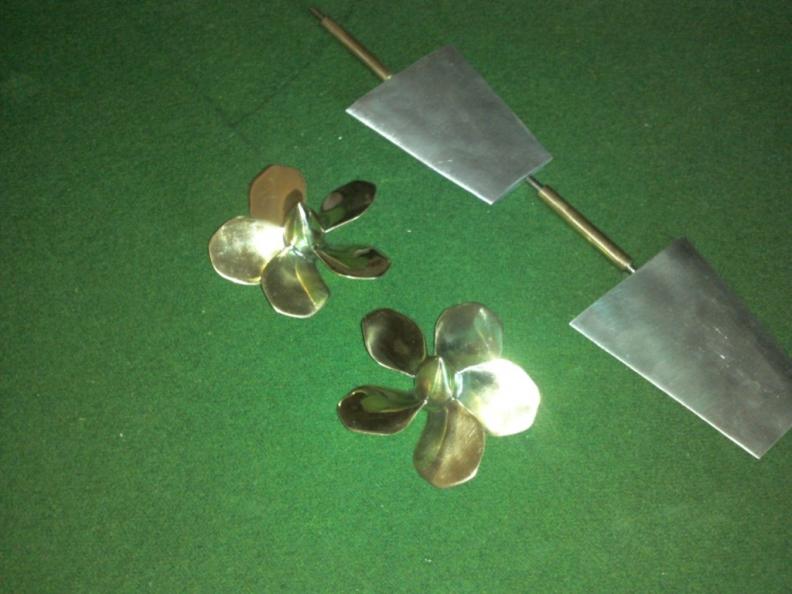

        I would suggest giving George Sitek a email at GT Sitek props in UK give him your specs (Prop dia, Boss shape, no of blades (7),shaft Thread size you want eg M5, etc) he does superb Brass work at a reasonable price. I got the props (and Aluminum rudders) for my USS California CGN36 made by him from a photo...
        Click image for larger version  Name:	cgn36props1.jpg Views:	0 Size:	54.1 KB ID:	142744
        Click image for larger version  Name:	cgn36dd.jpg Views:	0 Size:	86.2 KB ID:	142745
        Click image for larger version  Name:	PnR1.jpg Views:	0 Size:	64.3 KB ID:	142746

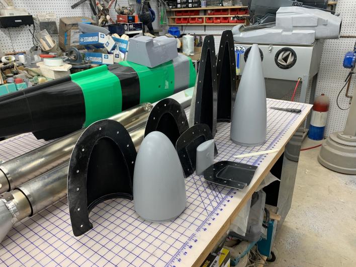

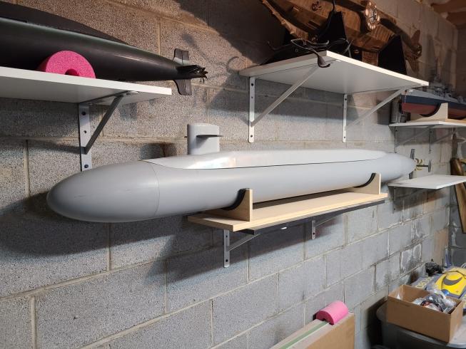

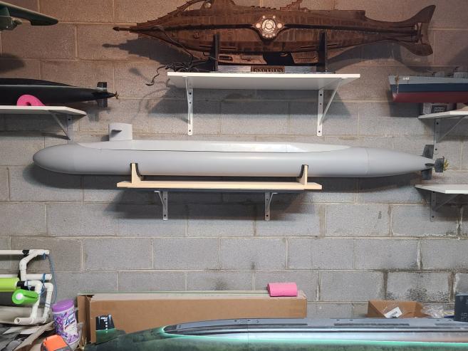

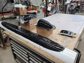

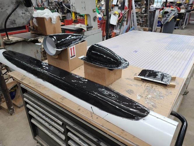

                    Back on this. The fiberglass parts are done. I had to make some slight changes to the missile deck to make it narrower and ride higher but it worked out well. I also got the stern surfaces and fairwater planes installed. Next up I need to design and 3D print some spacer rings for the hull. So far it is lookingpretty decent.

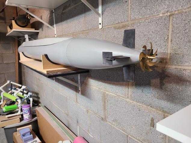

                          OK Dave, are you happier now. ;o)

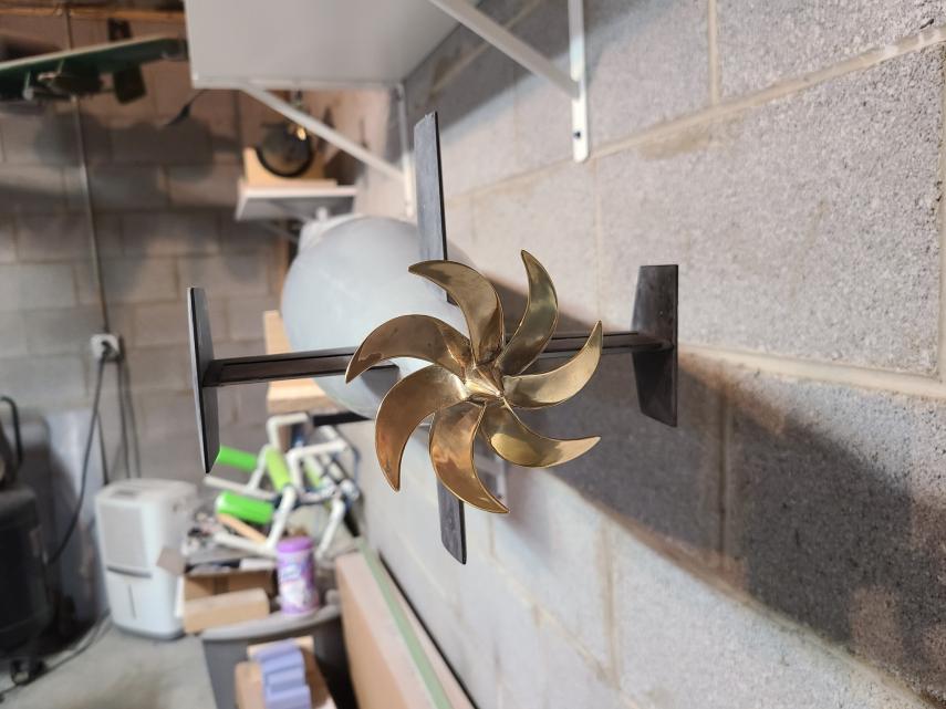

                          From the Prop Shop in the UK. Very nice propeller.
                          I have the stern control surfaces installed. I will work on the fairwater planes next while I wait for parts to fix my 3D printer.

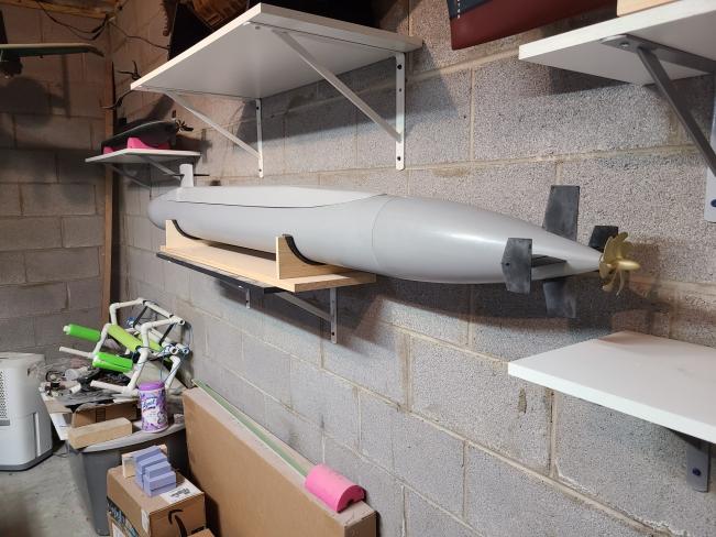

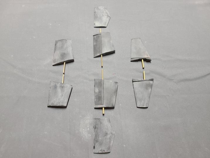

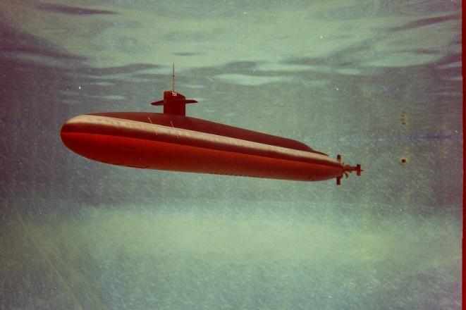

                            Wheel looks great. Now, fix the two vertical stabilizers that hang off the outboard ends of the horizontal stabilizers -- the leading edge is a true vertical, not swept.

                                I find it amazing that I have never met David in person but he sure has an influence on me... No more swept verticals on the horizontal stern planes it is then.
