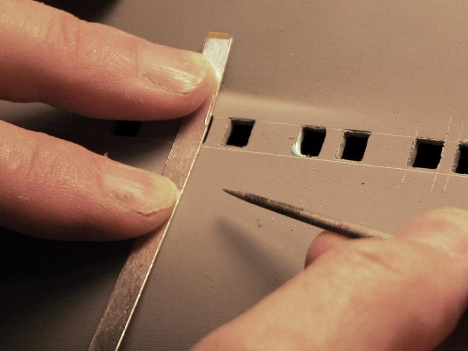

        One of mine - when it comes to model building - is that I have absolutely NO skill at filing out limber holes. None I tell you - absolutely none. My attempts come out as trapezoids, at best, but mostly look like Rorschach test ink blots. I've tried all kinds of files; used many different tricks to outline the holes - all to no avail. I'm always on the lookout for yet another brilliant idea to lift my modelling skills. To that end I'm asking - what are you doing in this photo?

          In almost all forms of fabrication, be it earth-moving (site survey); sheet-metal work (blue dye and scratch-awl); machining (plan reading and tool set-up); or sculpting (model analysis and lofting) there is the first step: lay-out. Or, if you will, mark-off, or lofting. The process of identifying the shape of the thing to be added to or subtracted from. Measurement plotted between established datum points, lines or planes. Sometimes the job requires creation of an intermediate model, a 'mock-up' (stiff paper, cardboard, clay, etc.), to understand the eventual fabrication process and materials selection -- the mock-up built from an easier/cheaper/quicker medium.
          Creation and use of stencils and templates is a must if the shape of the item you wish to create is to be accurate of form.
          (they don't teach this stuff in school anymore, do they? Just CAD and how to press the 'enter' key).
          So, here are various forms of lay-out and mock-up work:
            • 13399
              • 13399
                • 13399
                limber and flood-hole punching is no different. What you see there, scribed onto the surface of the model are the artifacts of a proper lay-out job; the identification of the vertical and horizontal demarcation lines that define the size and shape of the holes to be punched out. Just stay within the lines, and you're good.
