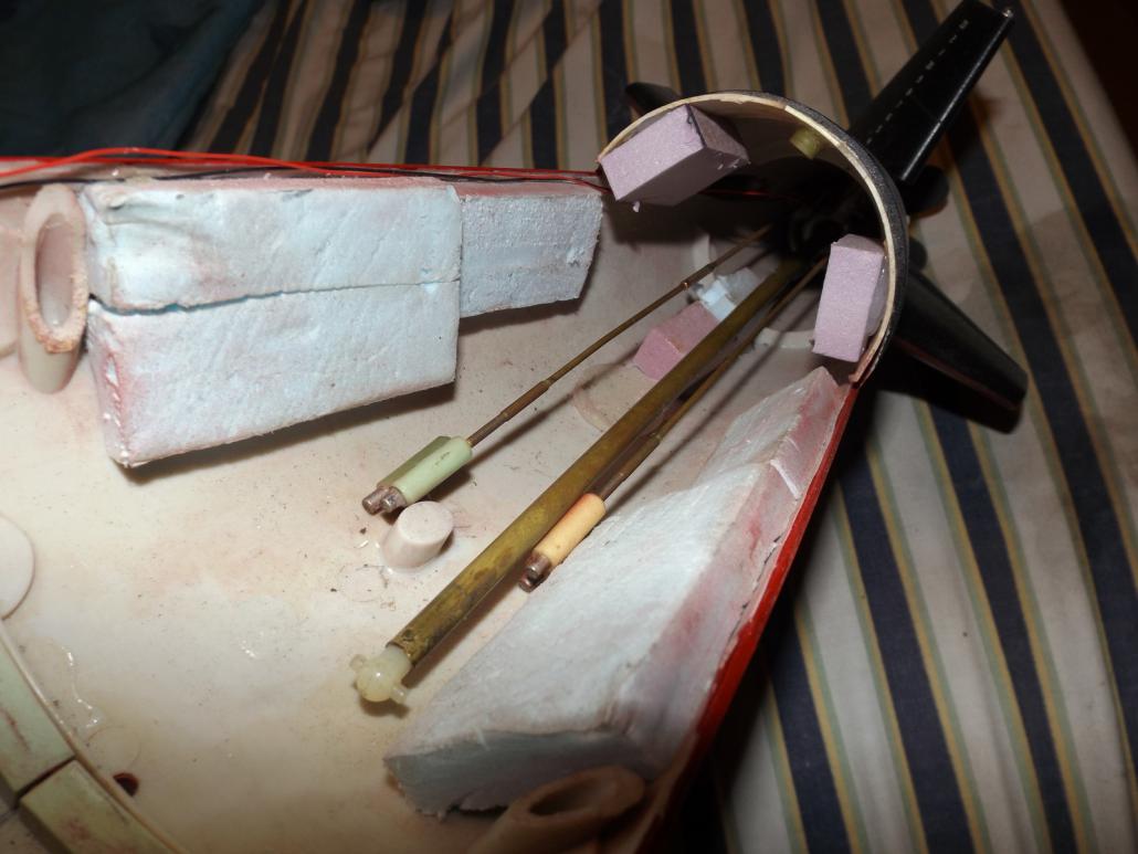

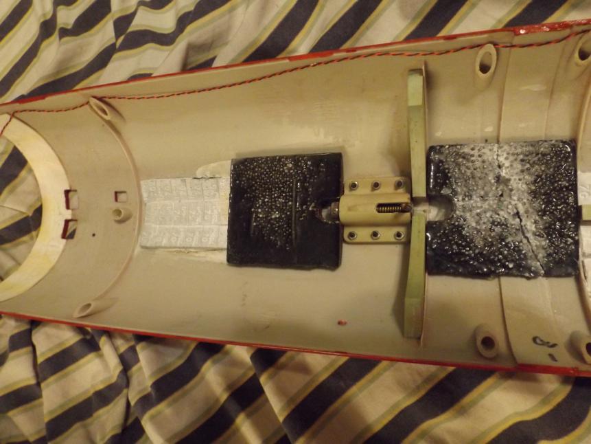

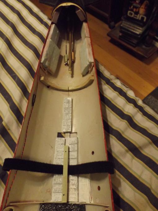

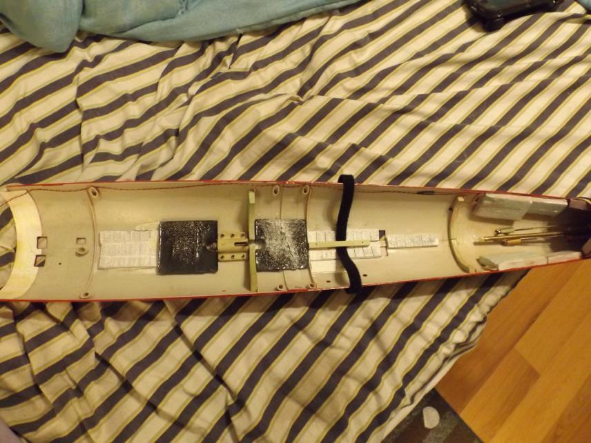

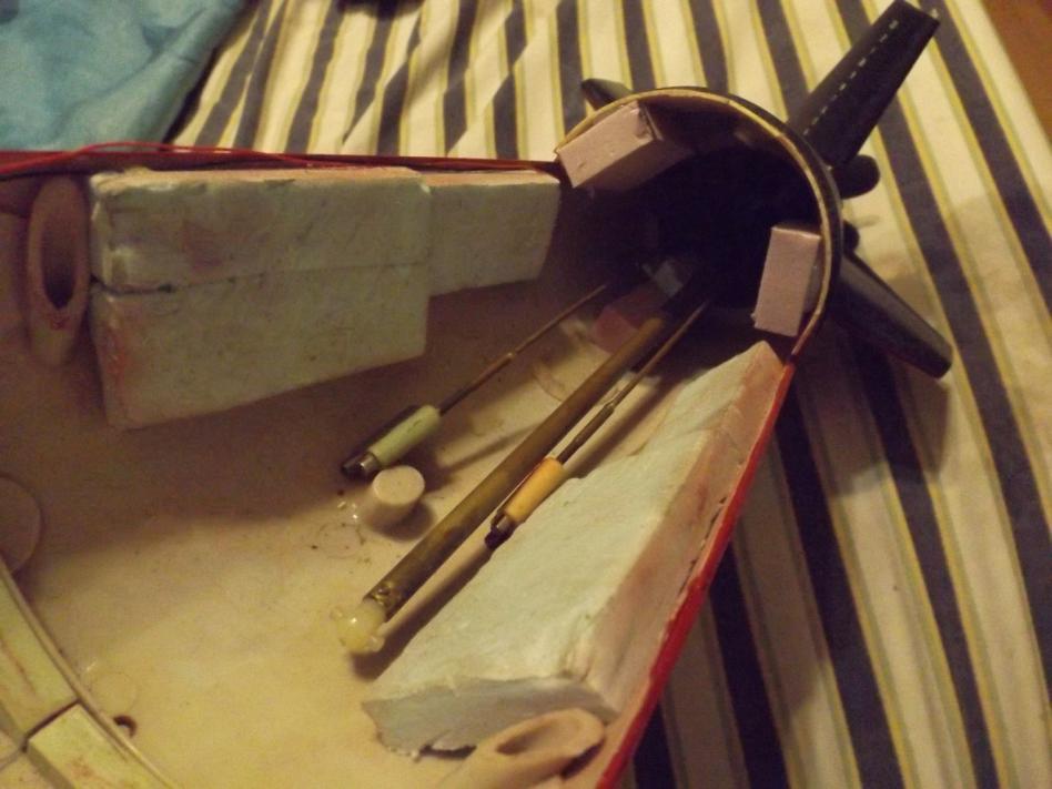

          As Good as my Word. Here is some more info on my Skipjack build. Not shown in a picture is the 4 ounces of weight I have in the nose, in the torpedo nest frame area. Shown in the pictures are two weights made by Caswell. They appear to be made from lead shot and some kind of epoxy. They are 2&5/8" x 2&5/8" square shaped to follow the contour of the hull. Its maximum thickness appears to be about a 1/2" or so. Forgive me as I don't want to try to pry them loose to weigh them. They were heavy on the shot and sparce on the epoxy as you can see one broke apart. Besides those two there is 11 ounces of weight distributed in the bottom as well as the 4 ounces up front. Forgive please the fact that I don't have an accurate scale to weigh the lower hull as is. You can see the foam as it is as well as the two little pieces up inside the tailcone.
          This was arrived at by trial and error while the boat was floating in the kiddie pool.

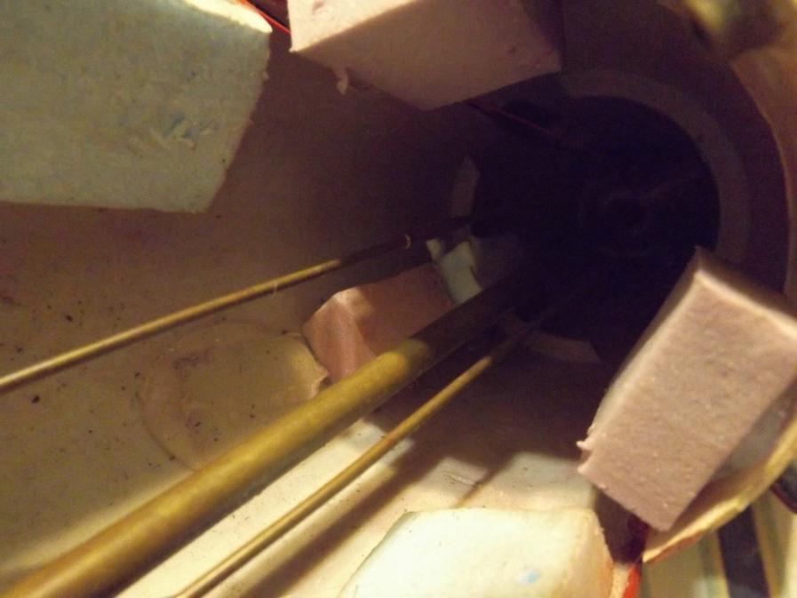

            As you can probably see from the pictures, after you get your foam siliconed in, sometimes you find areas where the foam is too proud and is obstructing something. Sometimes I just take my thumb and smoosh it down a little bit to reduce its thickness in that area. When you go to put the top hull in place and close it up, the areas that rub the subdriver can be identified by carefull examination of the foam and the marks or creases that appear on the surface of the foam. Those are the contact areas that by some means have to be reduced in some way. Easy does it. A little at a time.
