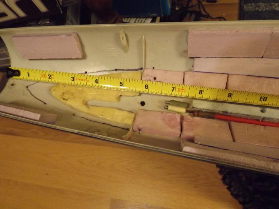

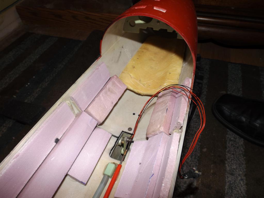

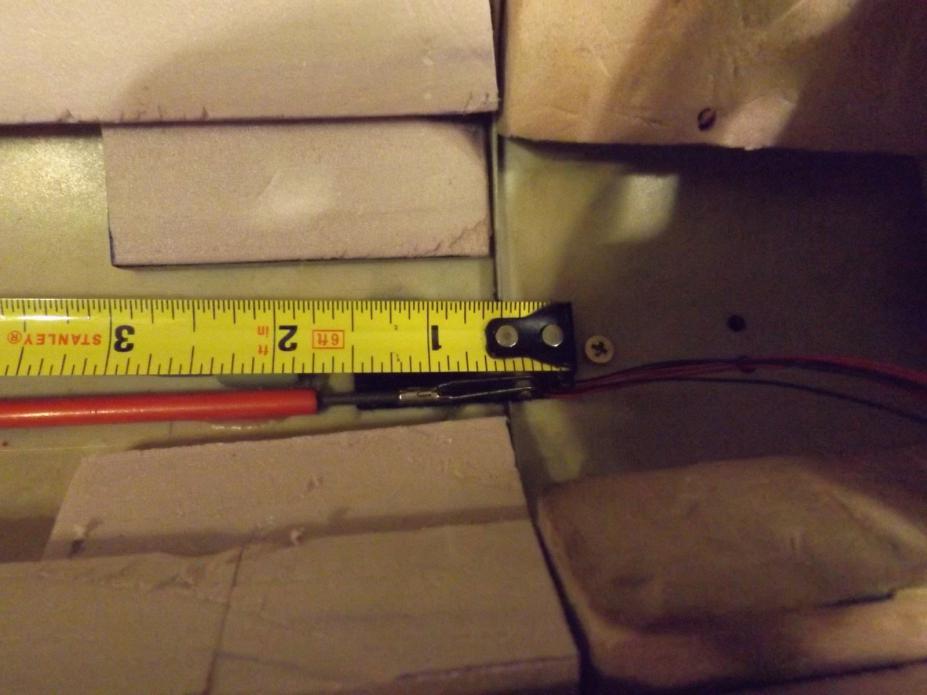

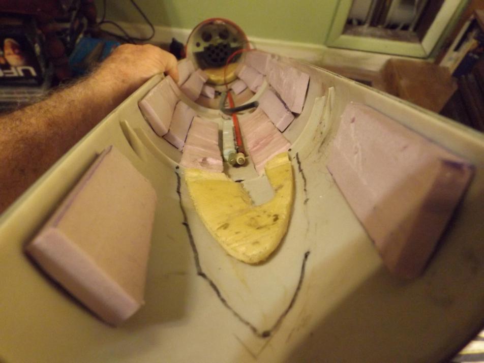

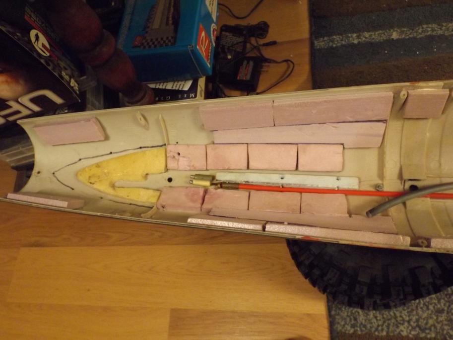

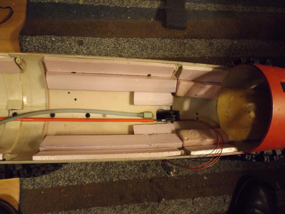

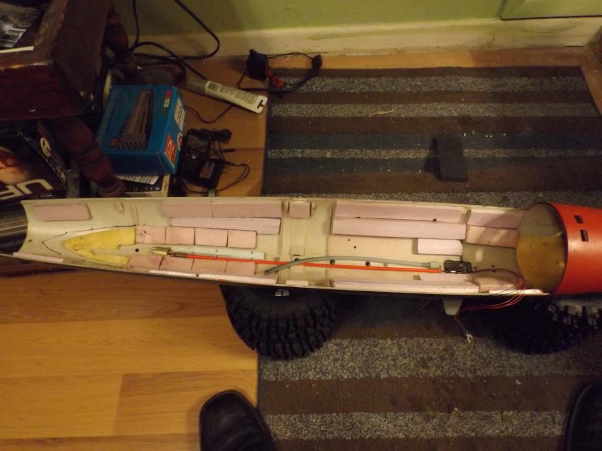

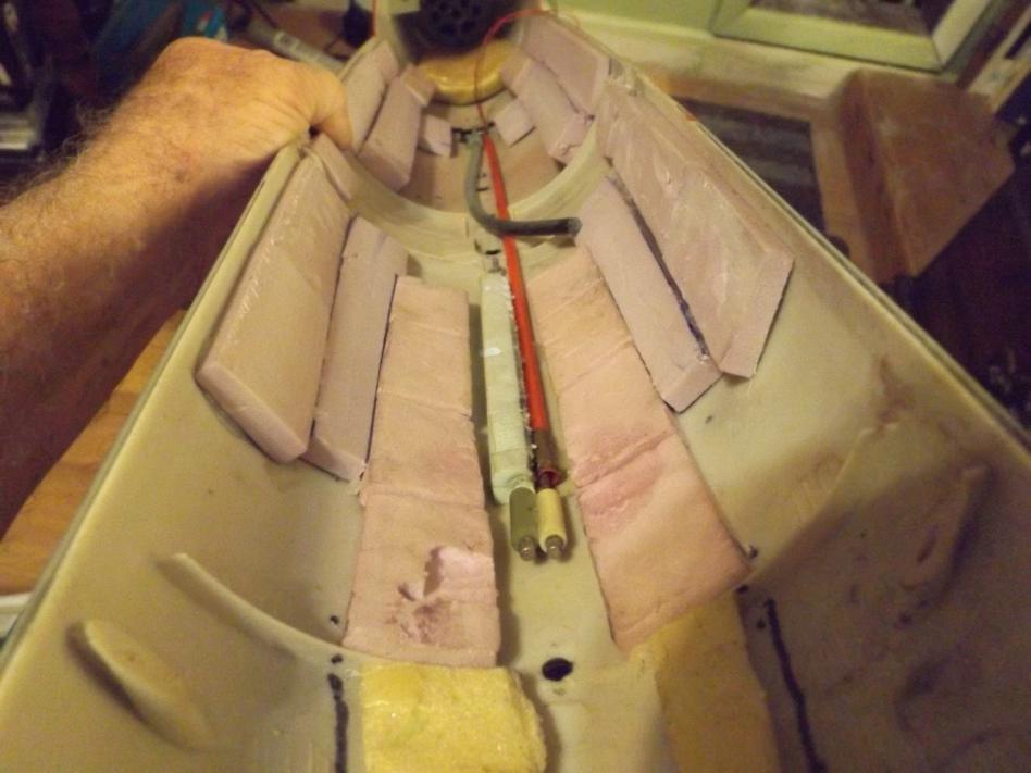

                    OK Mr. Greevesman, Because of a tight schedule I thought tonight I would concentrate on the linkage for the fairwater planes and the foam in the upper hull section. Take note of these 10 pictures.

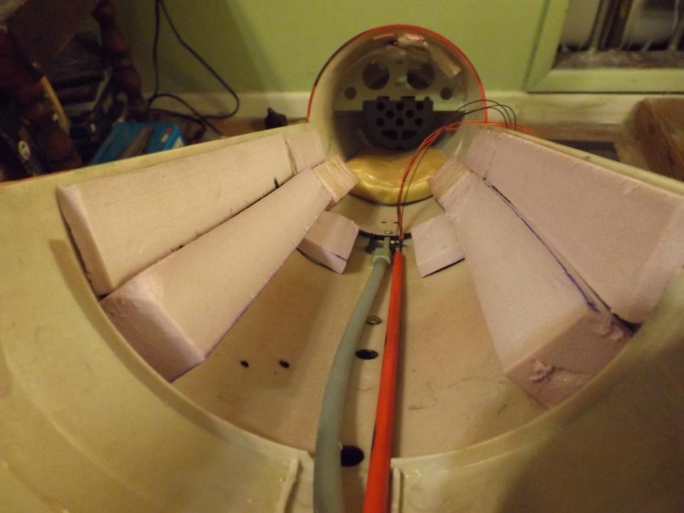

                      The other 5:

                        So as you can see in the seventh picture the sleeve for the linkage stops about 7&3/4" from the edge of the rear of the upper hull or frontmost edge of the tail cone. The front of the sleeve stops at 1&3/4" measured from the frontmost edge of the rectangular opening in the upper deck for access to the fairwater planes mechanism. As far as the foam in the upper hull, Ive crammed and filled most of the area with foam. Because of the limited clearance between the subdriver and the hull I had to vary the thickness of the foam. For example as these pictures were taken with the upper hull upside down, the foam along the edge of the joint between upper and lower hulls, those pieces had to be limited to 1/4" in thickness.
                          #72
                          Under the fairwater the edge pieces are 1/4" thick, the next row going up from there I could get 7/16" in there. But farther back only 3/8" would fit. Now once again, keep in mind, this is the "Heavyweight Modification" for Maximum stability for High speed running and Fooling around. You wont need that much foam and corresponding weight, but it also wont hurt anything either to have it.
                          As Dave has explained before, the foam simply keeps water from accessing that space, so therefore, since the foam is Much lighter than water, you are making it lighter up High in the hull. The weight is down low on the keel to help the boat stay self-righting in turns and resistance to torque induced hull rotations.
