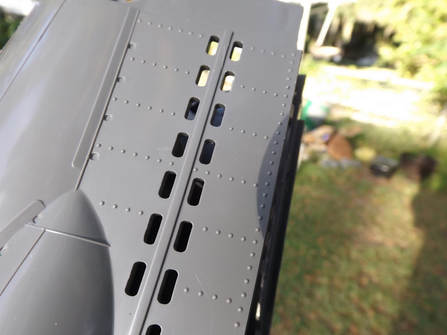

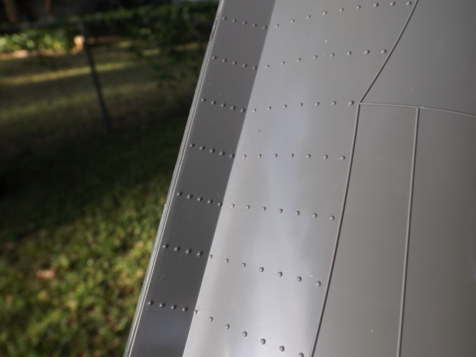

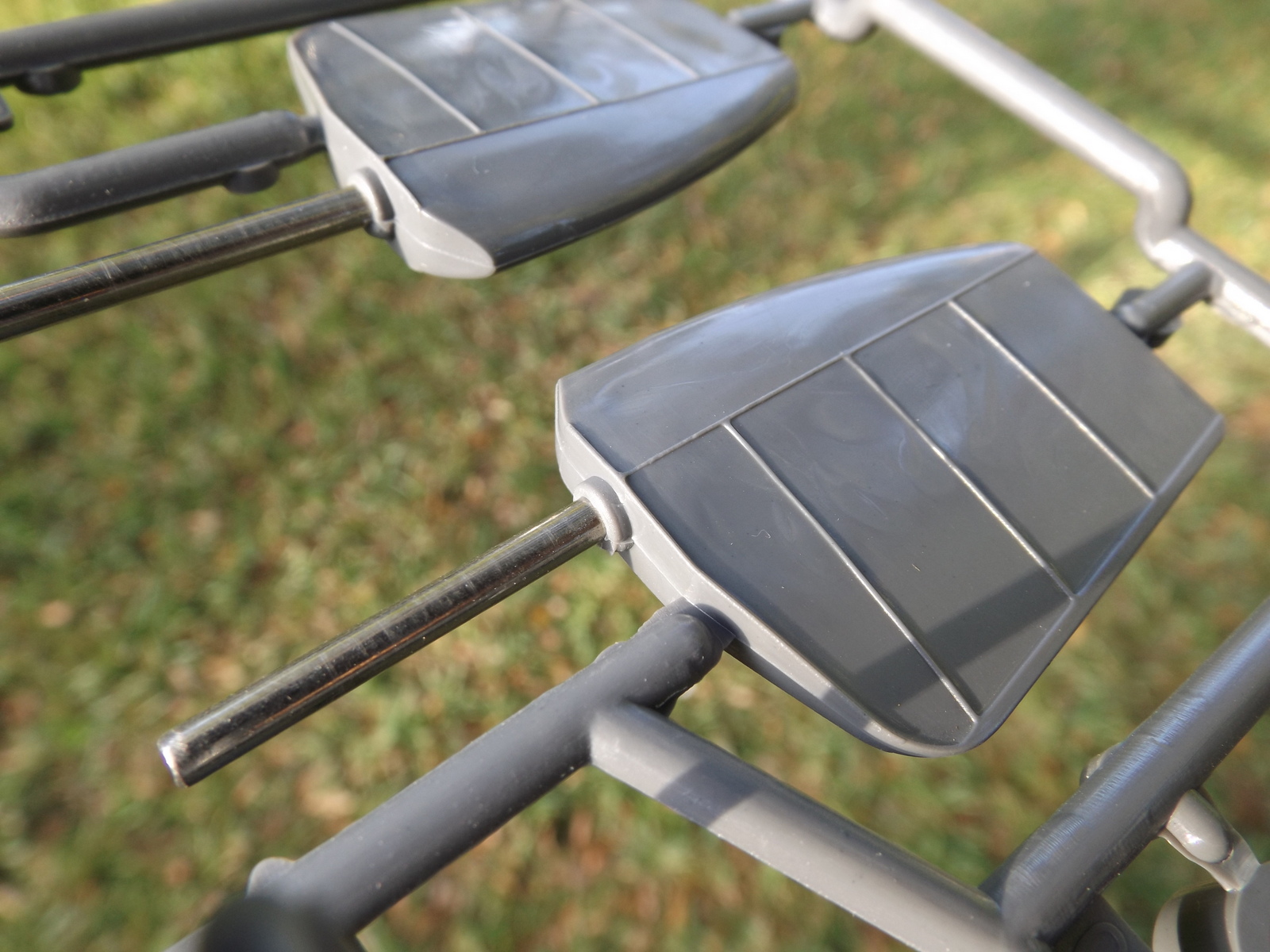

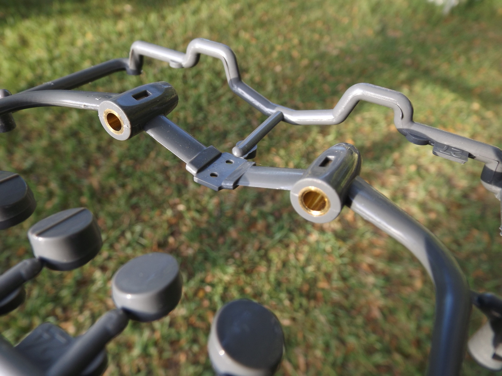

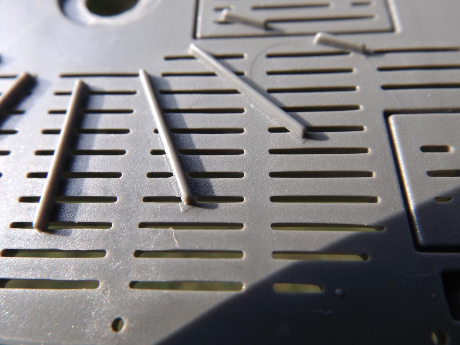

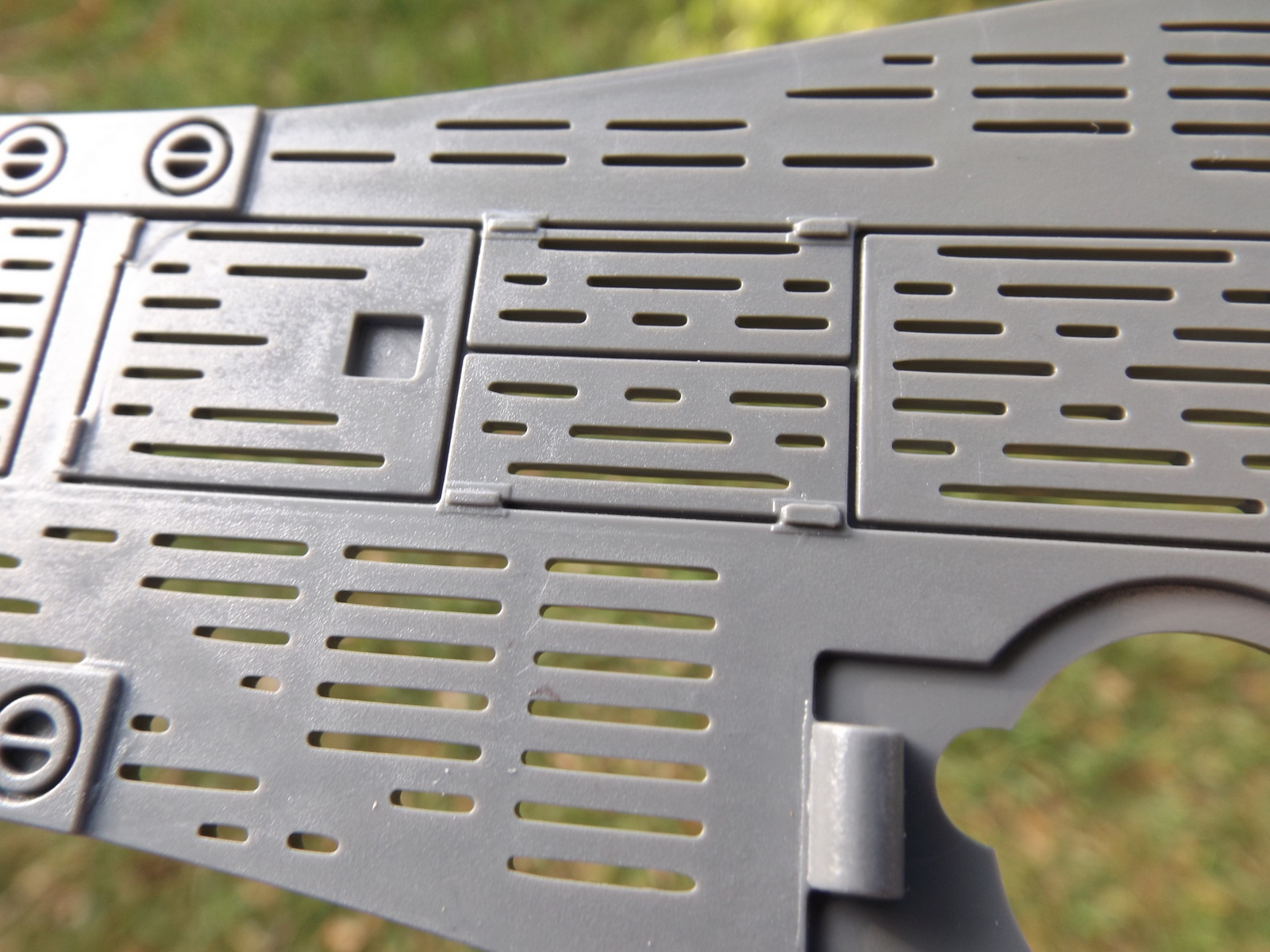

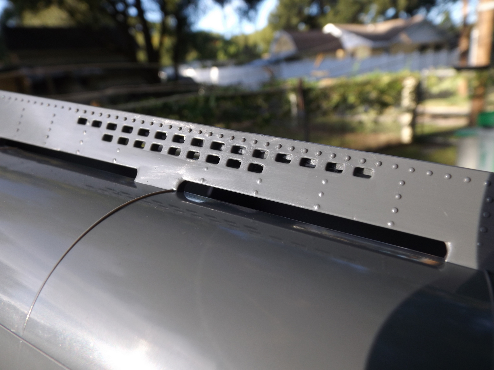

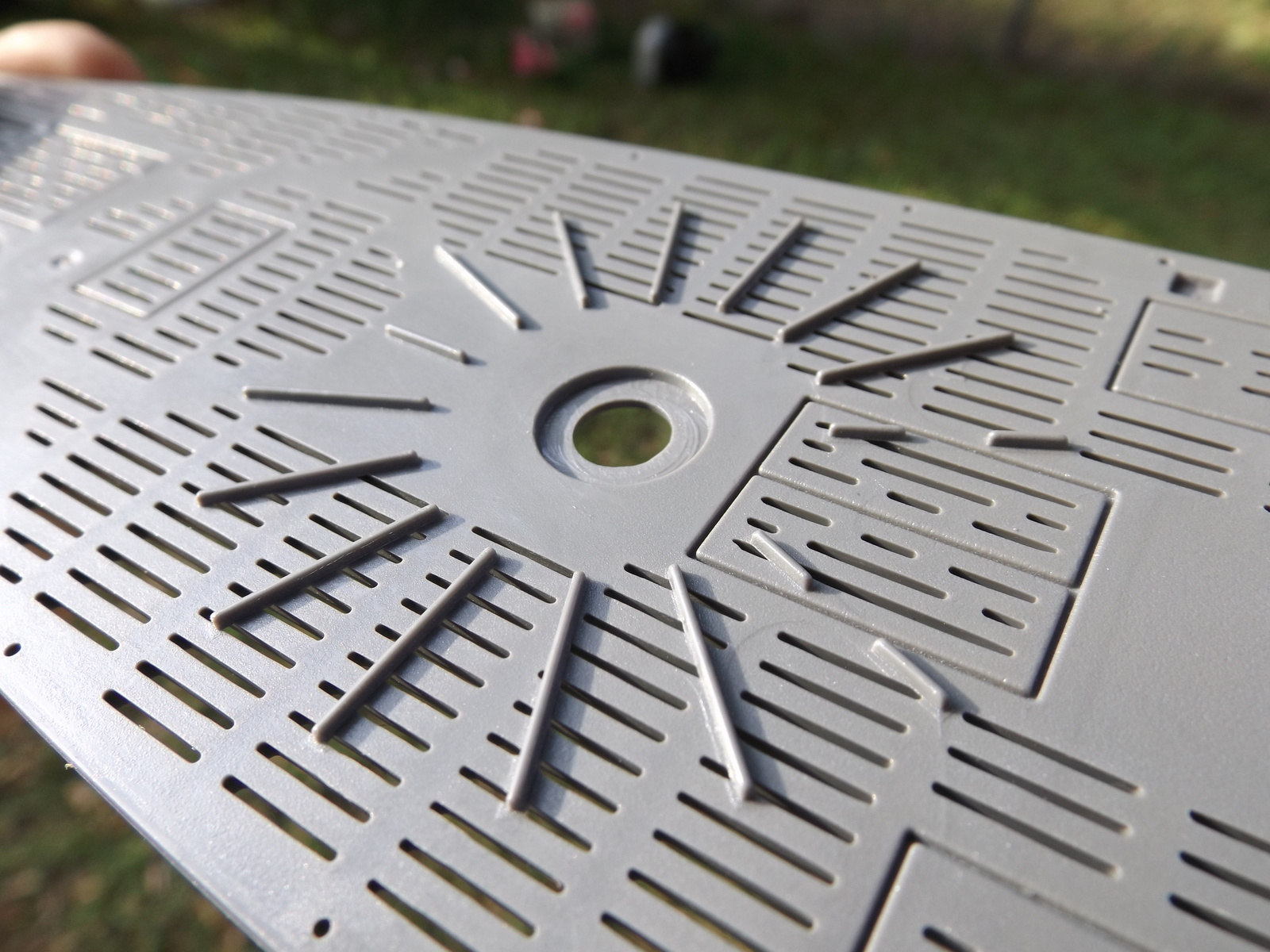

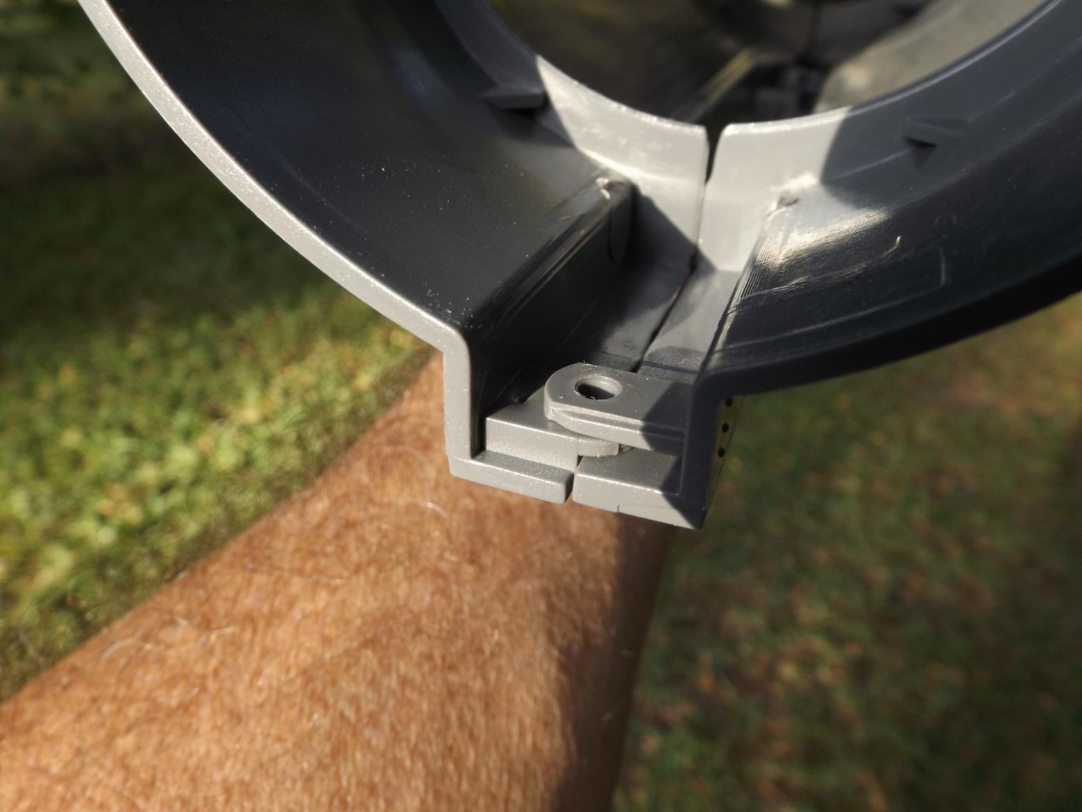

                  Ill give you three(3) guesses.......and the first two dont count. About what Fedex brought me today. Yes, the ARKMODEL U-Boat is here. And In all Honesty, I am very impressed! The Details are Stupendous, nice crisp, well formed lines and rivets. As Silentrunner777 has already mentioned in his thread, and Bob Martin in his videos, that this was made from the outset for RC. Look at the pictures that I am posting below. Youll notice the prop shaft support bracket has brass sleeves installed already. Rudders also have pre-installed shafts. Comes with some photo-etch stuff but the details are so good already, I dont know if you will need them.
                  I mentioned before that this thing was about the same size as the 1/72 Gato. Well, sitting them side by side, the Arkmodel is four(4) inches longer, at least an inch wider and at least an inch deeper, which makes its presence all the more impressive. Knowing that I have this kit in my procession, its going to keep gnawing on me while Im working on other stuff, including the Oscar. Oh, and one other thing. You dont put the hull together with glue. Its screwed together. How cool is that ?
