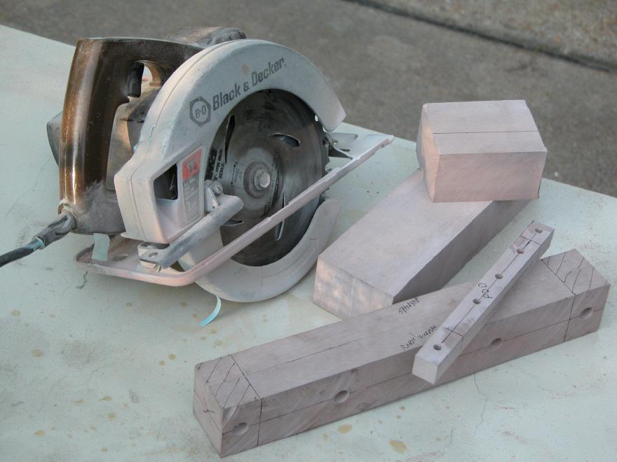

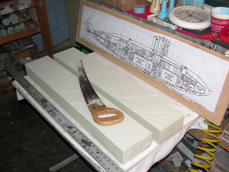

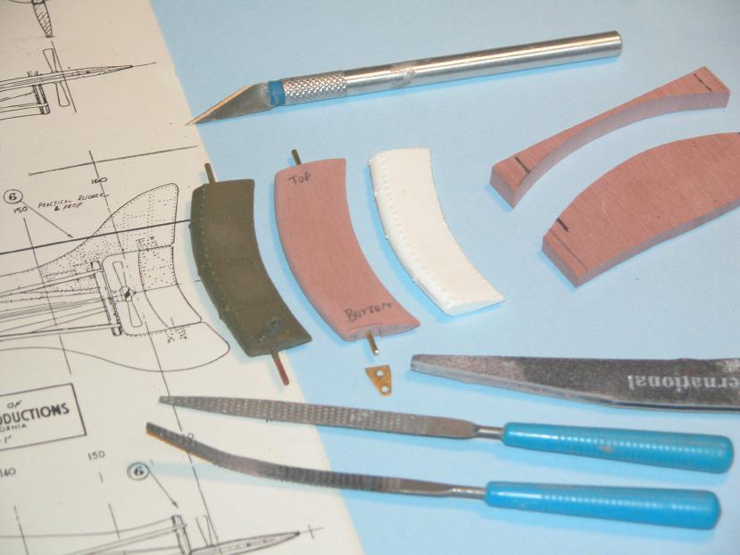

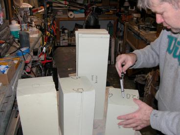

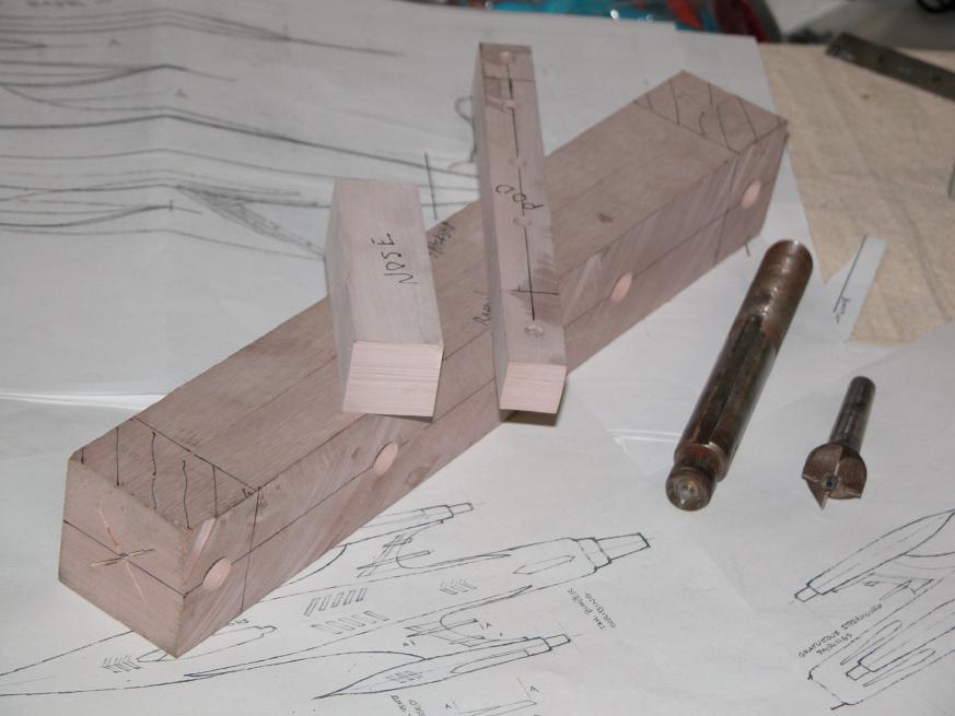

              David, can one scribe in Renshape 450?
              I know it cost a buck but I need good production time on this sucker, the use of tooling board as a material is in my opinion a timesaver……......4 years like on the AKULA is not an option........I have a pretty cramped wishlist that I want to empty.

                It's the ideal model making medium, the very dense expanded polyurethane board is expensive, but it's perfect as a model building raw material: Consistent density and other properties throughout the log; takes to primer and adhesives aggressively; is easy to machine and scribe; and not at all responsive to normal temperature and humidity changes.
                I use the large-cell dense Renshape (20 lbs. per cubic foot) for basic hull fabrication. Turns and cuts like butter. However, it has a rough, soft surface which must be filled before it will take primer and produce a smooth surface:

                The small-cell type of RenShape (40 lbs per cubic foot) I use for small parts and masters. After sanding it ready to take primer without any filler or putty, the bubbles are that tightly packed. This is what the dense Renshape looks like:
