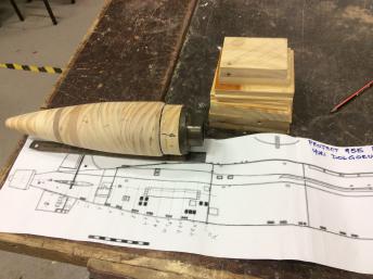

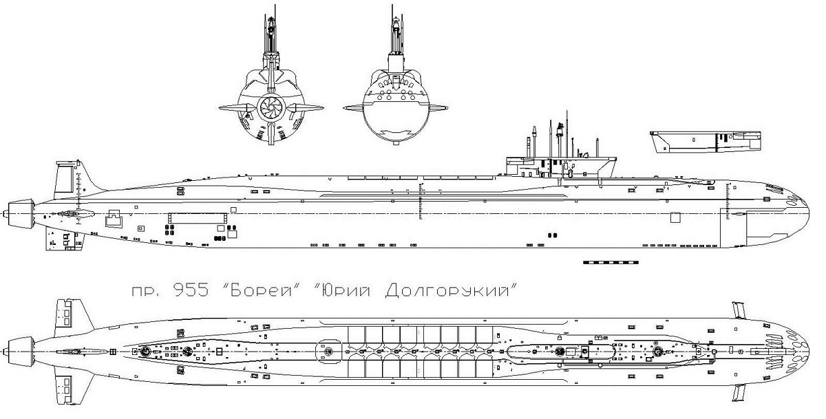

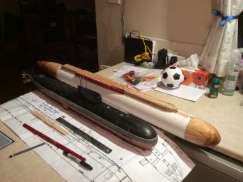

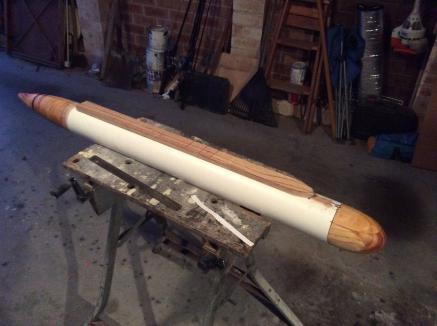

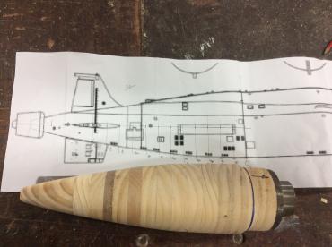

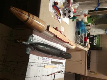

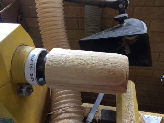

    Once again I have gone with the turned ends and the PVC Pipe mid section. At 1/140 scale however the beam is slightly greater than the beam of both Resolution and mike so using the standard 90mm wide pipe would be not quite scale like. I have found that the 100mm pipe was a little too big for the scale so have decided to go in between. I have bought two lengths of 90mm pipe and split one down the middle. I then slide the other one inside and glued it. There is a gap of about 10 mm running along the top but now the diameter is 95mm.
    I then glued up several blocks of wood at school and mounted them on a face plate and screwed it to the lathe in order to turn it. I then turned it down to the right profile for the rear section of the hull and once sanded back to the right profile I gave a coating of polyester resin. I have not resin coated the rear hull section before whilst at such an early stage but I decided that much more early Click image for larger version
ID:	115961 on it would give a much smoother surface much more quickly and accurately. After sanding back with wet and dry it hase given a beautifully smooth surface.

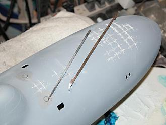

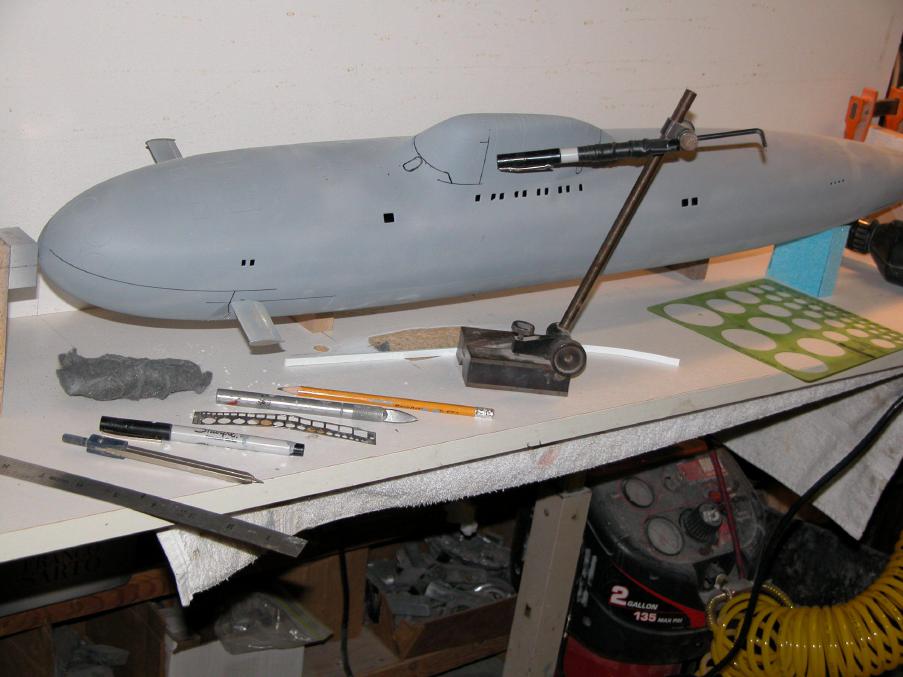

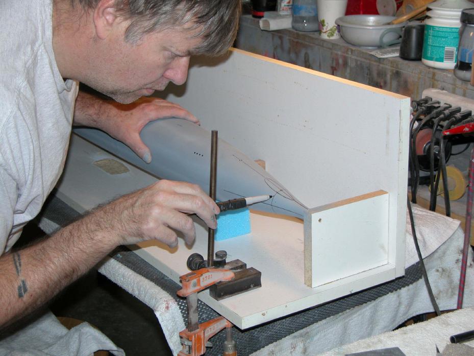

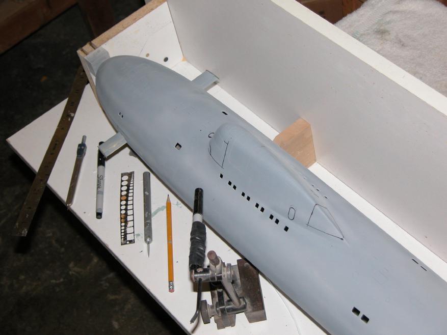

    No problem with the sewer pipe and turned wood ends -- any port in a storm. Just as long as they are stable, strong, and will take to primer. You must work to improve your scribing. At this point you've advanced from terrible, to not-so-terrible. When I'm done with you, you're going to be great at it!
    Once the three pieces of your hull master are assembled, build up a scribing substrate from a two-part primer-sealer. Build it up to a thickness of about .050 inches. Scribing into that substrate will be much easier than ripping into wood and PVC.
    This is pretty much a round-hull. Make a holding-scribing fixture as illustrated below.

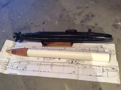

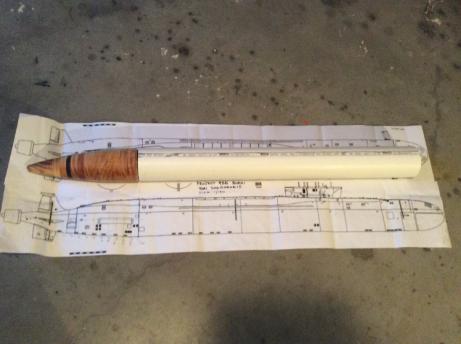

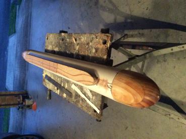

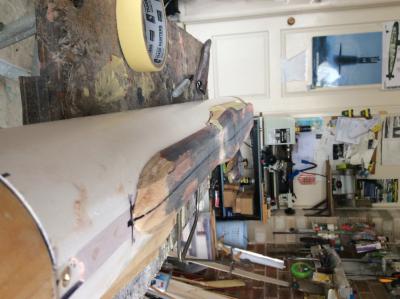

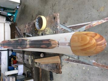

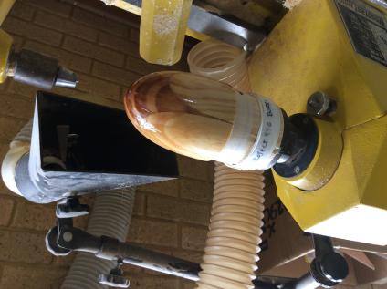

        I thought long and hard about the scale. As mentioned when I originally considered the scale of this boat 1/120 would make this boat an absolute screamer. It would require the back of my corolla to be lowered to get this sucker in. Making it 1/140 scale means that it would just fit lengthwise on the back seat. Recently I've had a couple of people order the Resolution class boat. Taking the bubble wrapped up boat to Australia post resulted In me being told that the hull was 5 cm too long and they wouldn't ship it. I had to find some couriers to do it. This got me thinking that I should really consider making this hull a split hull with a cut somewhere around the middle. So the hull will come in four pieces, this will allow for a more convenient box. I need to think about a way to design the break in such as way that its easy to glue straight and true.
        I drilled two small hole and counter sunked then at the bottom and the top and the rear end of the PVC pipe in order to put two small screws in and secure the stern section to the pipe. Once this was done I simply added some filler into the groove between the two.

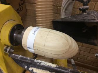

        The next big job would be turning up the bow section. Like the back end this would involve turning a block of wood into a dome shaped section that would be consistent with the bow outline of an obscenely big Russian boat. So I started turning the block of wood with intermittent questions from year 9 students during lunch break either asking what I was making or saying some thing like " so this submarine will sink?" I made a small ring of PVA the same way that I built the hull, a split 90mm tube inside another to give a diameter of 95mm. I have then placed this around the live centre so I can then slip it over the turned piece to check for accuracy of diameter.
        Soon enough It came to my attention that the diameter was under what it should be. Bugger... I chucked that half turned piece of bow into the scrap bin. I found it later with a face drawn on it and looking suspiciously like a doll from playschool....Glued up some more blocks of wood and waited a day before mounting again on the lathe. Turning this one up I gave it more attention and finally got the shape I wanted.
        Like the rear end I gave it a generous coating of polyester resin. This stuff is great, it get year 9 students complaining about the smell. Then they want to leave, win-win!
        once dried some sandpaper with attitude and then smoother paper and wet and dry. then another coat. Year 10s complaining now.. Two more coats later and lots of sanding and as smooth as a baby's ..
        Get home and slip that baby into the front end of the pvc pipe. Nice fit.
        Once after this I could start cutting out the block of wood that would make up the raised missile deck, forward and rear deck structure. Anyway, enough for now.
        (I saved these pics up the right way. I don't know why they are on their side..)

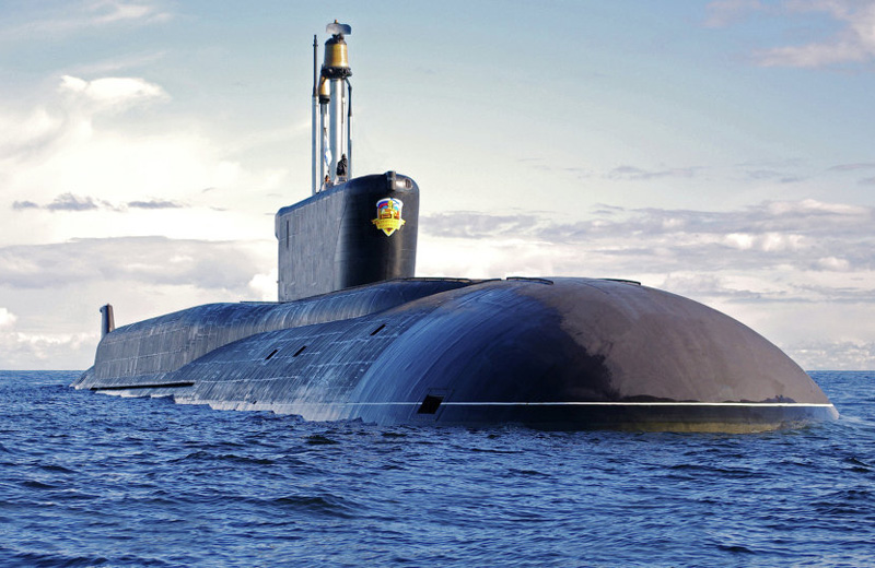

            Gantu,
            Do you have any good close up stern pics there the missile deck fillets into the main hull just forward of the upper rudder? Also any dry dock pics close up of the forward hull beneath water line?
            thanks
            david h

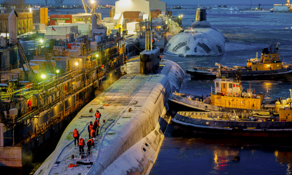

              Perhaps these two will suffice:Click image for larger version
Name:	Borei Behind.jpg
ID:	116149Click image for larger version

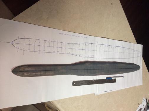

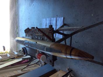

                  After the front and back ends tapered sections had been turned up and glassed and fitted into place, it would be time to look at the missile deck section that runs most of the length of the boat. I am fortunate in that this missile deck has reasonably straight forward transitions. There are none of the really subtle transitions that were nothing but headache for weeks on end when I was trying to interpret the front end of the Resolution class. For most of the length of the missile deck there is a really predictable and constant radius that transitions the flat deck to the almost vertical sides.
                  The missile deck features a flat section just aft of the last missile that gradually slopes down and tapers till it becomes level with the stern of the hull just meters in front of the Vertical fin. Forward of the missile deck the hull gradually slopes forward. It coincides with the positioning of the fin/Sail. As it does so it narrows and remains flat but barely raised above the rest of the hull.
                  To make this I cut out a section of scrap timber to the overall profile from a top view. Cut it to the basic shape and after calculating the thickness of the piece to make sure that it would simply rest on the top of the PVC pipe, eventually this deck would be screwed down with countersunk screws into the PVC. I marked the sloping transition section forward of the missile deck and applied a chisel to gradually reduce the material. On this model the reduction in the height of the deck from behind the sail to in front of it is only about 5mm. I made the piece intentionally narrow after thinking about how to round the sides. Initially I though of just cutting it to the correct width and simply sanding the radius all around. This would work but I would then spend a large amount of time just trying to the get the profile absolutely consistent. Then I saw a broomstick...
                  I took the broom stick handle (found in the scrap bin at school). We have a saying in the Industrial Arts department at my school and that is that "the F3 shall provide". The F3 being the freeway that me and a colleague take every day to school. The amount of scrap timber that we find on the side of it every so often broom handle included is amazing. I cut a 400mm section of broom handle and then cut it into quarters length wise to make nice corner strips to glue along the length of the missile section. This would guarantee a consistent rounded profile on both sides... genius.... This would mean that all the way around the profiles would generally be round. The breaks occurring with the dip towards the front and a gradual curving reduction at the back. The width with the flat middle section and the two quarter radius' on either side mean that the overall width had to carefully match up with an accurate height of the sides of the missile deck above the centreline. As the missile deck widens then the height of the sides increases with the curve downward of the hull.
                  As you are all probably aware, you learn from each previous project and getting symmetry right is one of those subtle things that you have to get right. I'm getting better at and will take the time. So at the moment I am not working on the sides of the missile deck until the flat top section is symmetrical and how I like it. Once the top profile is as good as I can get it I can cut out identical sides and glue in place. I will also not screw the missile deck down until it is almost complete from an assembly symmetry point of view. It is easier to work on it off the PVC pipe than on it.

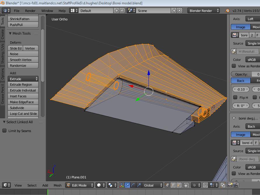

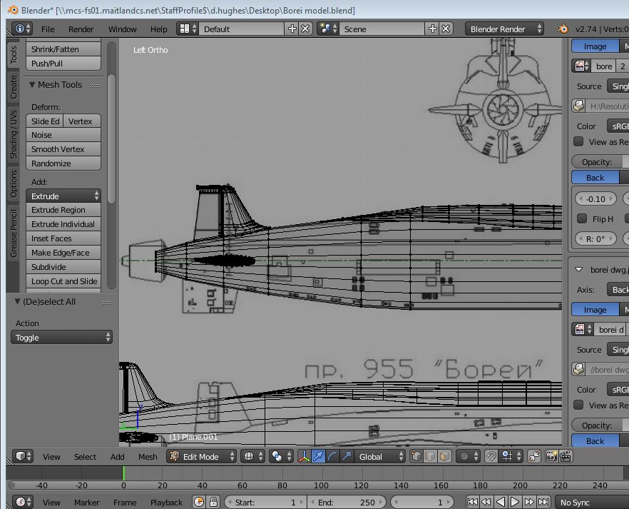

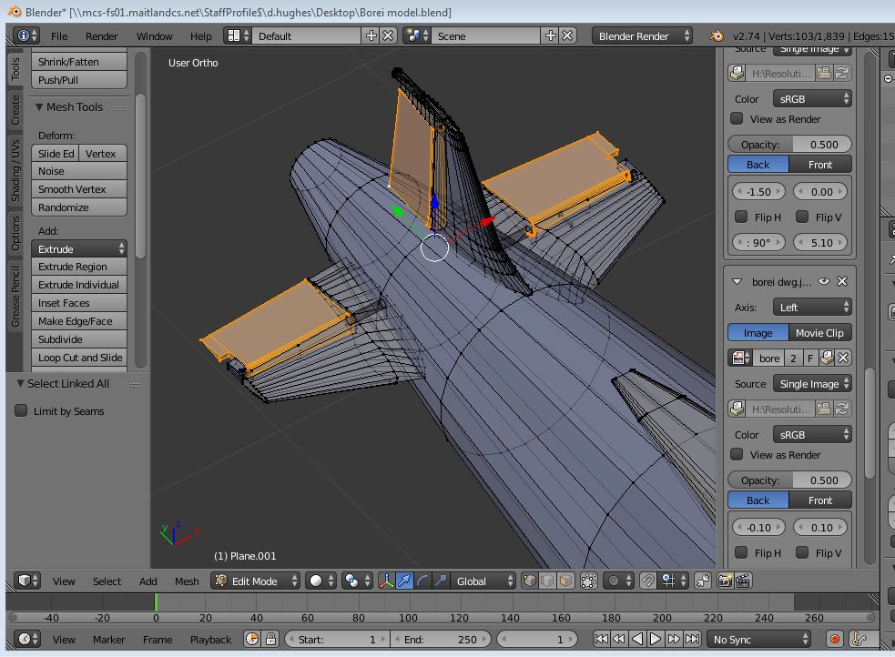

                        Being a computing teacher has meant that I have been on the steady road of learning some cool software over the years to teach to my year 9-10 Computing students. One of may favourite programs has been Blender. For years I have been able to produce very convincing Zeppelin airships (one of the easiest things to build) amongst other things whiles some of my talented kids have been colliding planets and building HumVees. At night after all the soccer-ing is done and the goalee in bed I have been creating a "digital Dolgoruki."
                        Our school just invested in two 3D printers and one of my colleagues has been looking for us to supply subject material. Blender lends itself pretty well to 3D print files and so I thought this might be a great way to potentially fast track some appendage parts for this new boat. Get the three view drawing, place it as a background and work the mesh over the top. Create the sterns planes, they are as I can see identical just mirrored and symmetrical top and bottom. then hit Shift-D and R-180 degrees and hey presto you have two sets of stern planes. Email the 3D print file to my colleague and wait a week.
                        It will be interesting to see how they turn out. I envisage making several copies to get scale right and minor details here and there but it's cool to think that some machine somewhere is working hard overnight to make me happy in the morning. I have never printed out objects for any project before, but if it saves time and gives accurate repeatable parts then It must be a good thing. Anyone who has seen 3D printed objects knows that the there are tiny layer patterns across the surface and this is something that I am going to have to address. I am wondering if coating the whole piece in super glue and letting that harden.
                        Blender is a fantastic program. Although it is not a CAD program as such, It is really a 3D modelling and animation/ simulation program, it is a phenomenal program, and its free to download from www.Blender.org It will produce magnificent models and converting these files to 3D print format is extremely easy.
                        David H

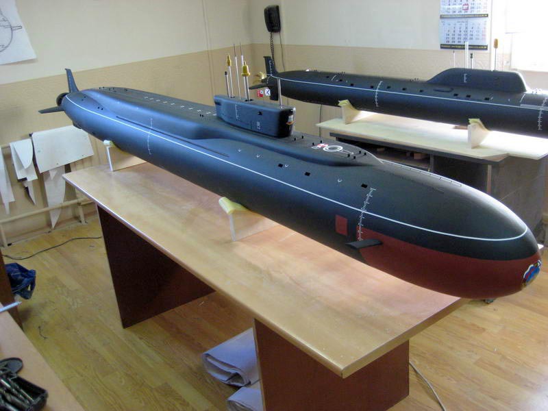

                          Looks like you can now also build as the INS version

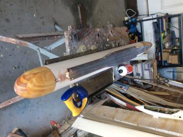

                            After being away for a week and "soccered out"
                            I am now back and spending the rest of the Holiday packing the house up, oh joy... However I have managed in the evening for an hour or two to do a little work here and there on the missile deck section. As mentioned in the previous post, I have sent some Blender files to a colleague who has the rule of the schools two 3D printers, of the stern planes of the Borei class, simply to see how they will turn out. I will probably need to scale up or down and work on the surface texture but being able to make consistent parts that are accurate will be a great step forward.

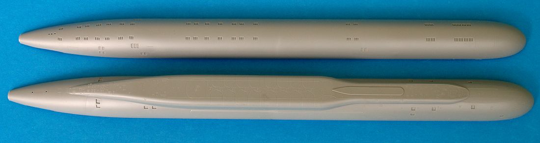

                            The missile deck has undergone somewhat of a transformation. I have once again gone through the cycle of sanding and filling then sanding and a resin coat, then more sanding and filling and then a resin coat. I quick coat of primer just to see the surface and where it is heading. looking down the length of the missile deck from the lower section at the front towards the transition where it angles up and widens toward the missile deck proper, I realised that there's too much curve in the centre and the slop bulges outwards, as a result I sanded this flat to get the transition flat and smooth.
                            I created a curved cut out profile to run along the length of the missile section of the missile deck. moving this profile piece up and down the length of the missile deck, it was clear that using the quarter dowel profile is certainly the way to get a consistent radius on the sides of the deck. Using a ruler all along the length of the hull checking for flatness showed that it is pretty true.
                            Placing the ruler along the front section has shown that the very front of the deck is raised and it lifts the ruler off the deck further down towards the upward transition. So I am in the process of sanding and filling down the front end to get it absolutely flat and consistent.
                            The plastic kit featured up the top give a really good indication of what I am after.
