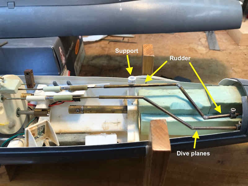

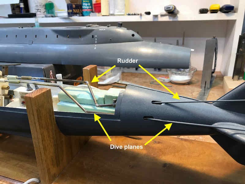

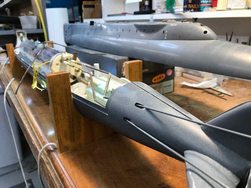

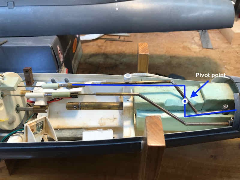

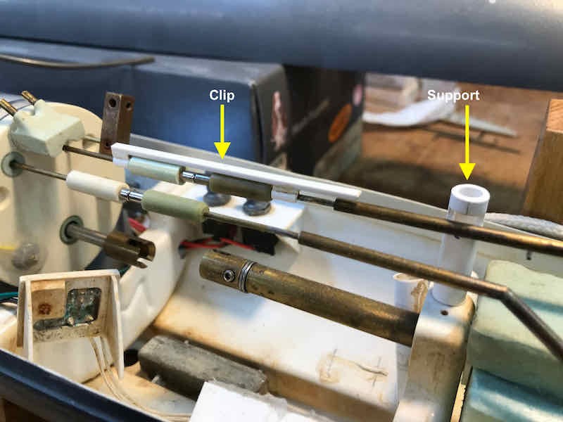

          Long time since I posted on the Marlin. I'm in the process of some upgrades at the same time working on the Skipjack. One problem I always had was the rudder. PRETTY OBVIOUS WHY THAT IS. Because of the oddball angle between the pushrods, the rudder does not do an graceful swing. It tends to get stuck especially turning to port. And the interior pushrod does a crazy dance when moving. A few years ago I added a support to combat this. And the kwik links tend to separate a lot so I added a clip to keep them together. Before I start *******izing this I thought I'd ask here to see what ideas can be come up with. I was thinking of a swing arm with a pivot point between the two rods. But have nothing to anchor the pivot point to except foam. The dive planes work OK as the angle is not as bad.
          Any bright ideas?
