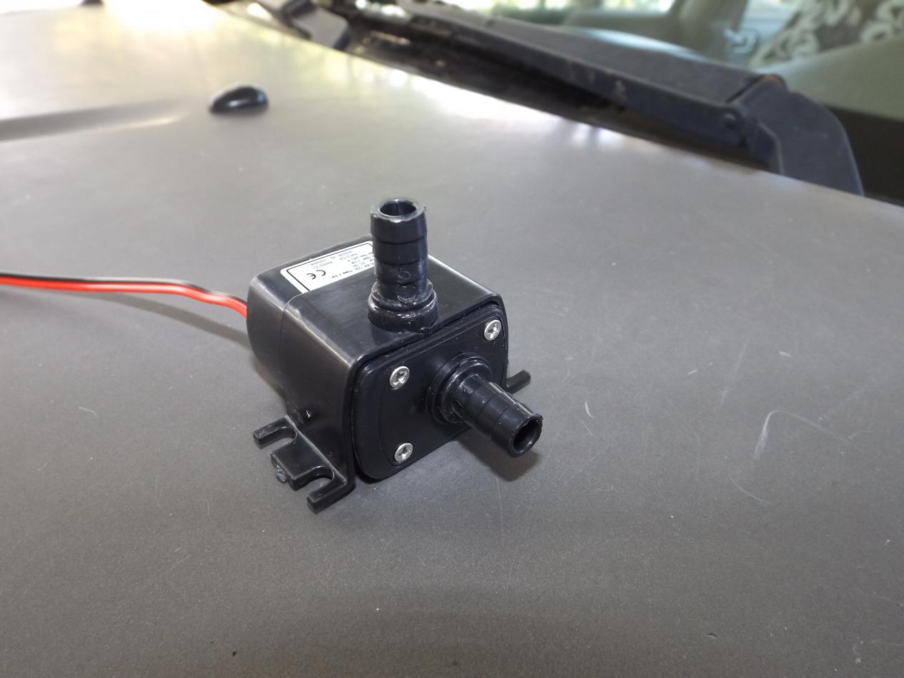

                      So here we are with a waterproff submersible pump. My plan is to buy two of these and use them to steer the stern. That along with differential steering. Im still waiting for the drives to come in. I guess Ill place a phone call tomorrow.Click image for larger version

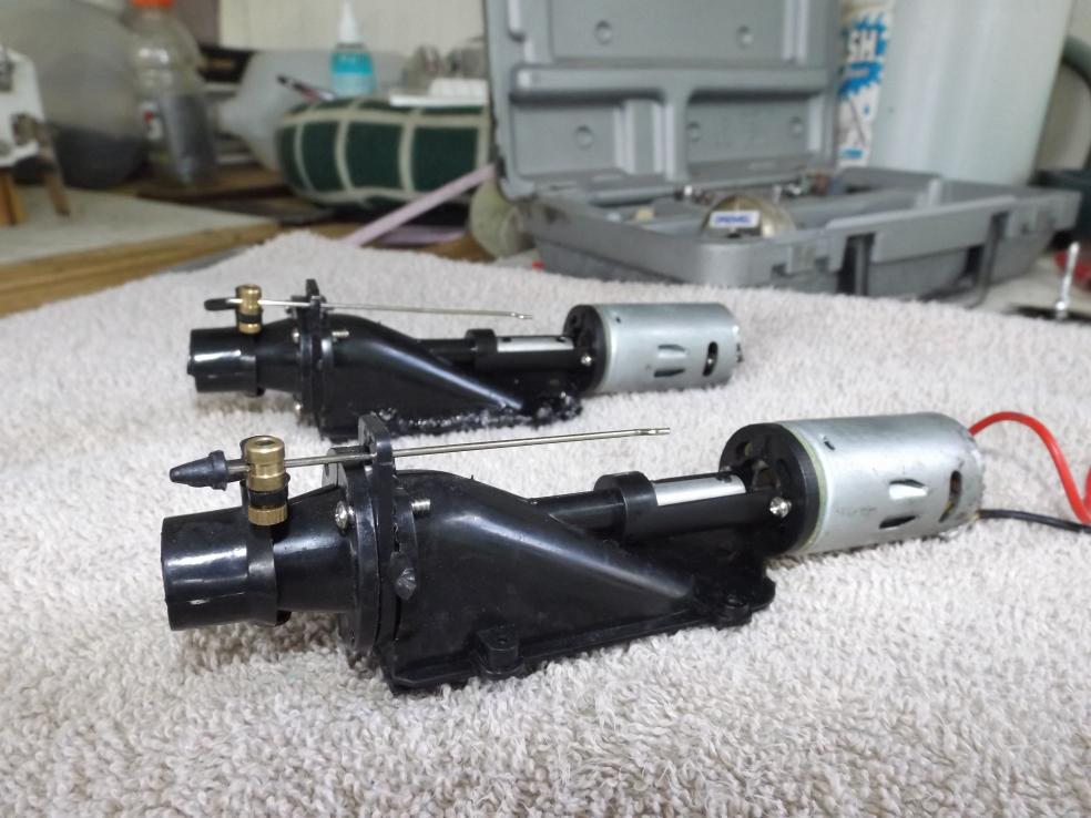

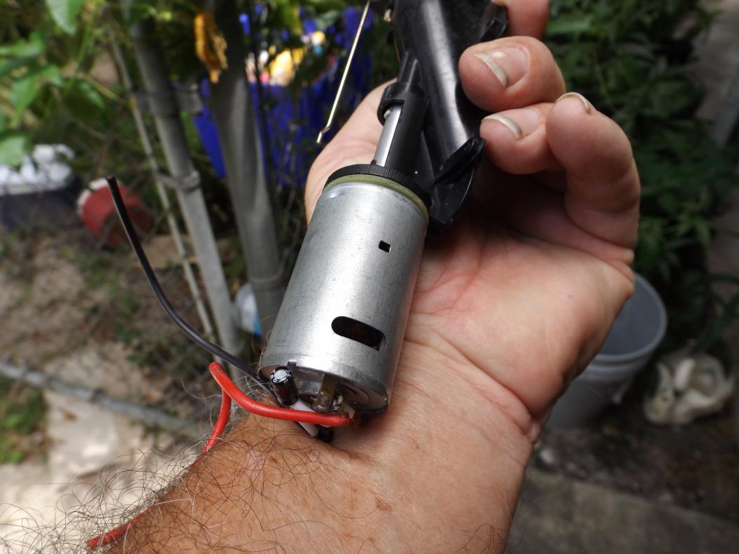

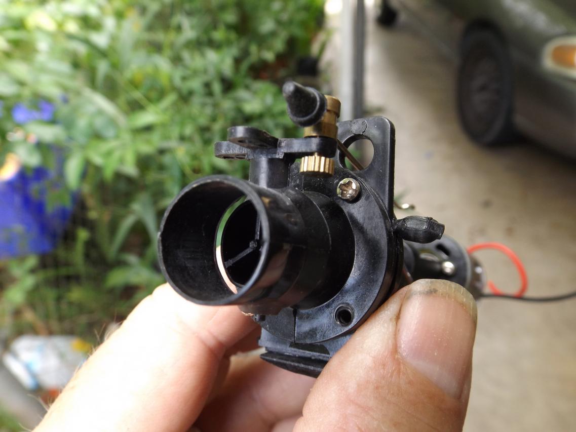

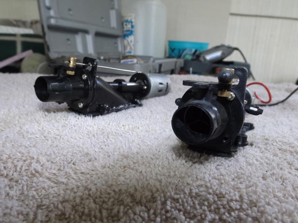

                            The aformentioned drives stolen from two jet boats are here. I was amazed at how much thrust these little things put out on 7.2 volts. They are designed for 9.6 volts. Ill have to seal up the motors and put a shaft seal on. More on that later. Excuse please the dirty fingernails. This aint no White House Press Conference ya know.

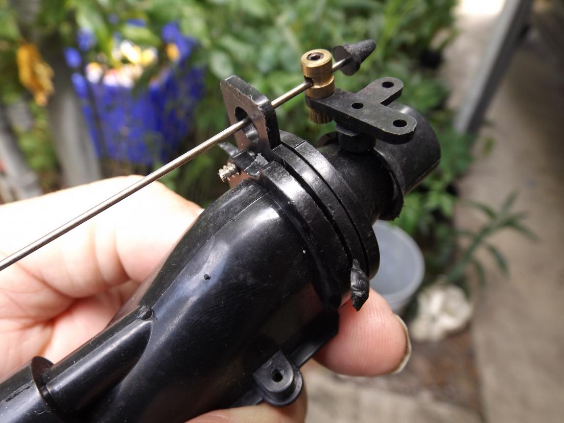

                              #149

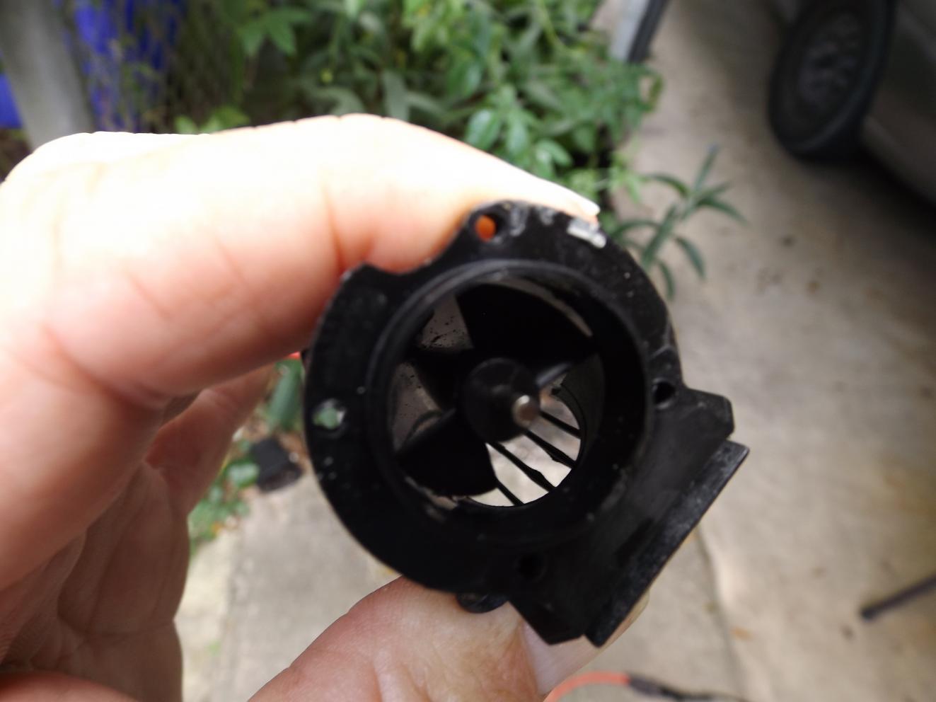

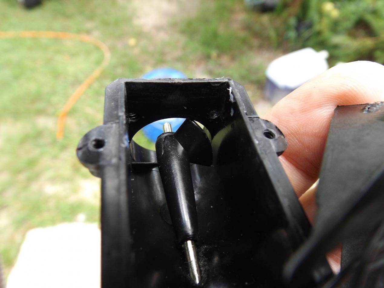

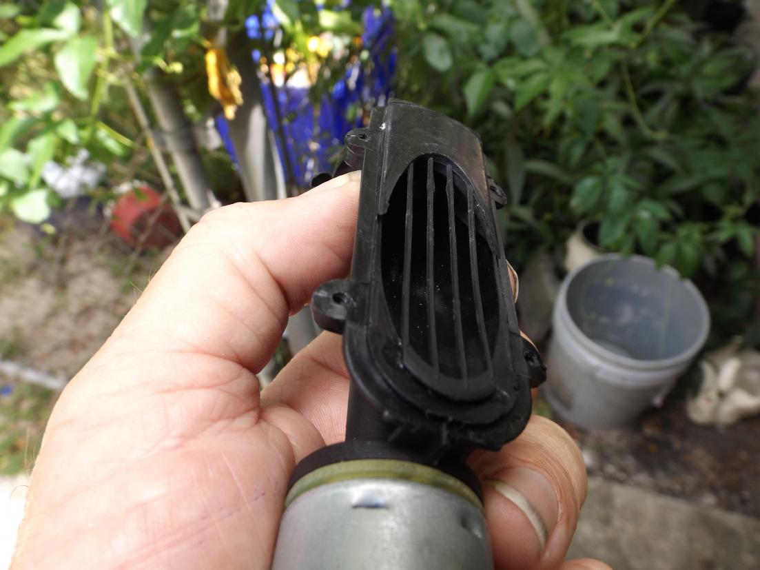

                              So the plan is that these thruster units will provide forward and reverse thrust, but all on one channel. So there will be know differential steering. The steering will be acomplished with the aformentioned brushless thrusters, whose outlet will be one on each side in the rear to push the back end around. The up and down pitch control will be accomplished by the nozzle that you can see in the previous set of pictures. Ill take the screws out that hold it on and rotate it 90 degrees to convert the previous rudder control into a pitch control.Click image for larger version
