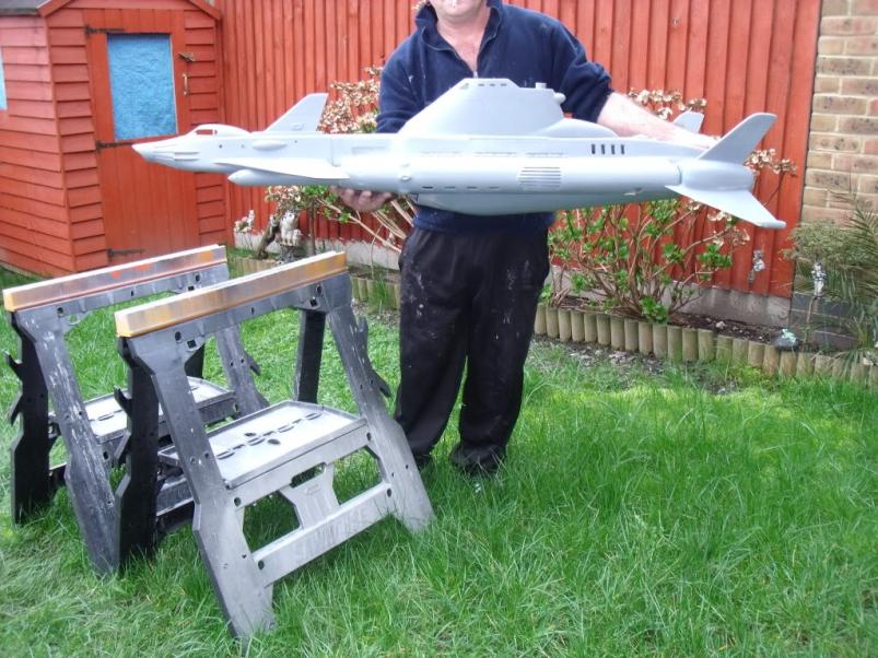

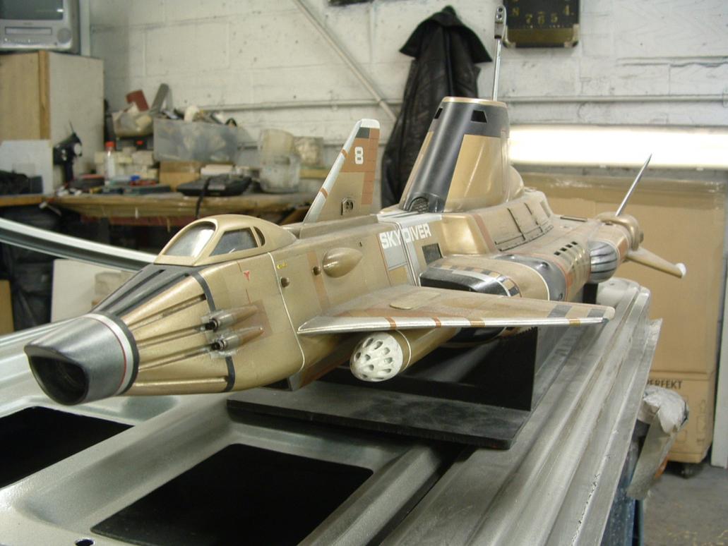

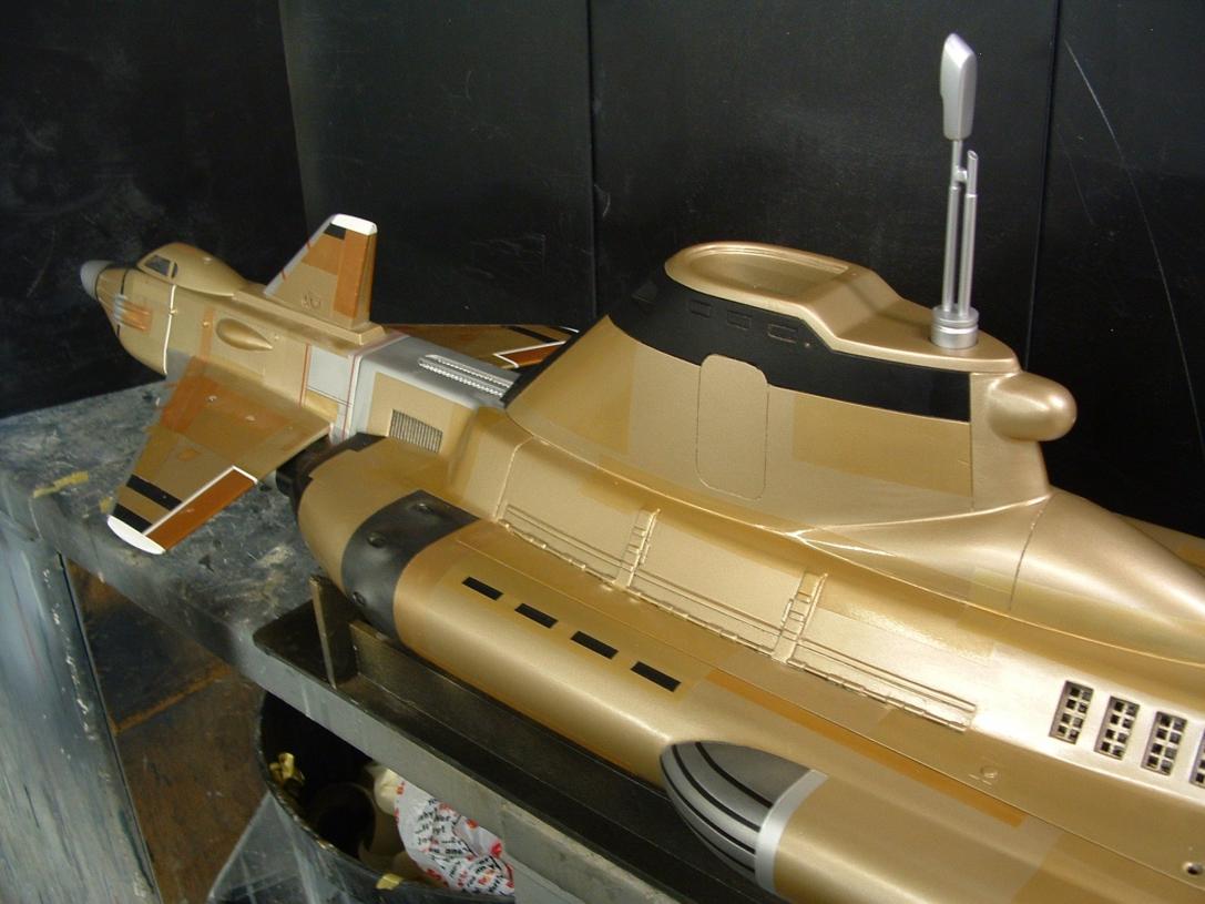

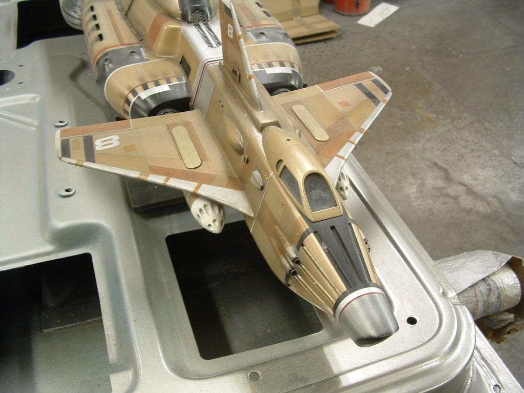

ID:	100104 I recently purchased a UFO SKYDIVER thats 3 ft long from Mamas Pitsillis in the UK. Here is his website showing all his fine modelsClick image for larger version
ID:	100103 and hulls available.http://studio2models.webs.com/ There is also a five foot long one available as well.Here are some pictures thatClick image for larger version
ID:	100102 I have collected over time. Now that I have one I will be needing your help(YES YOU) to make it into a fully functional rc submarine. AnyClick image for larger version
ID:	100101 suggestions or observations that you may have please post them. Tomorrow I will post pictures of the raw GRP pieces before they are cleaned up.Click image for larger version

ID:	59183 pictures of his completed 5 ft. Skydiver.:biggrin:

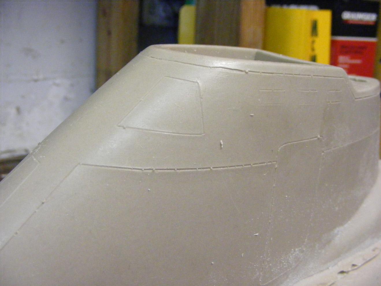

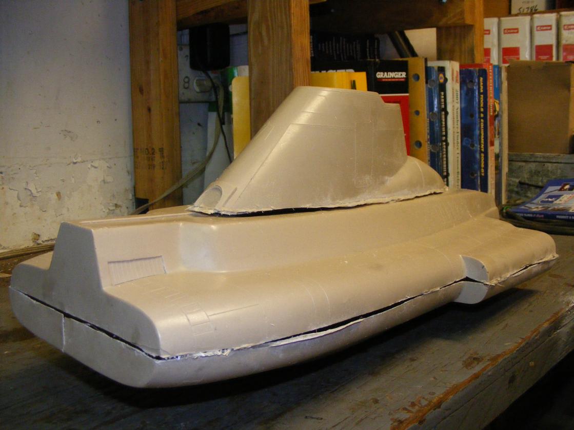

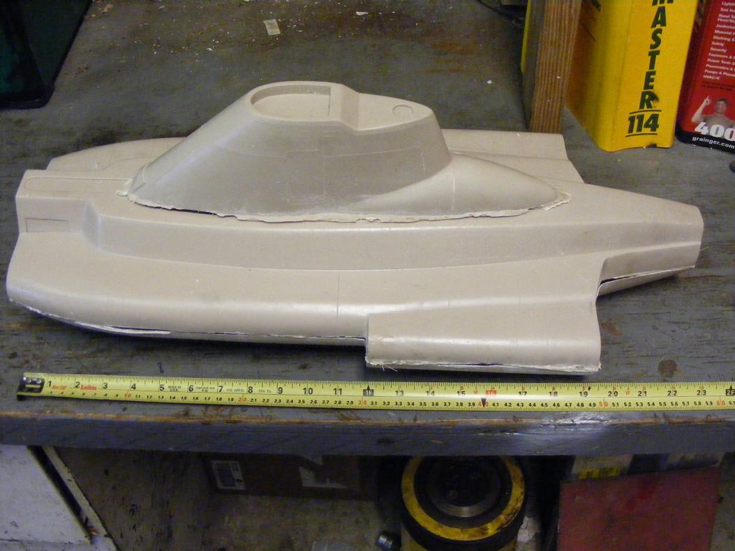

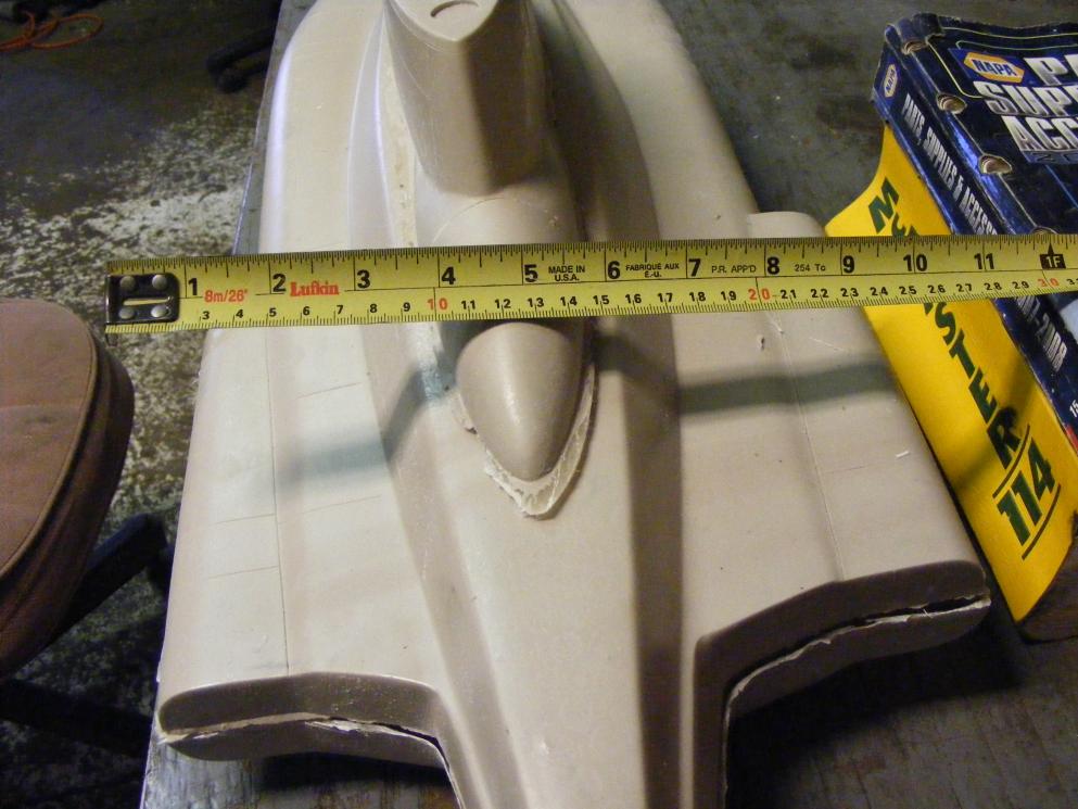

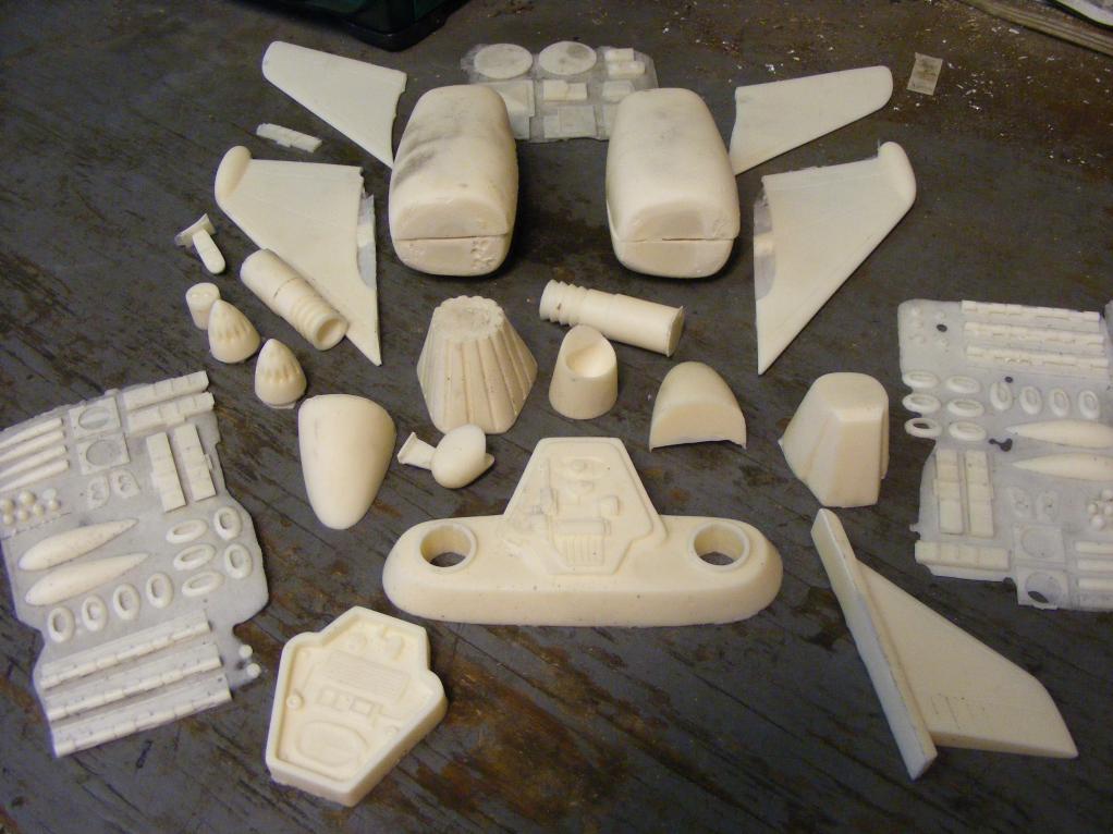

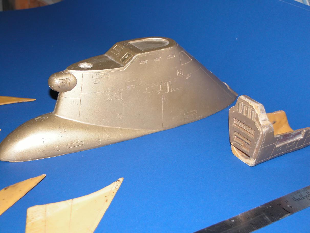

ID:	59189 The hull is GRP and in these pictures has yet to be cleaned up. Once it has Ill need to bond the upper hull to the lower. Then Ill need to select the best possible way to cut an opening to access the interior for placement of goodies. Its roughly 10" wide at the stern.

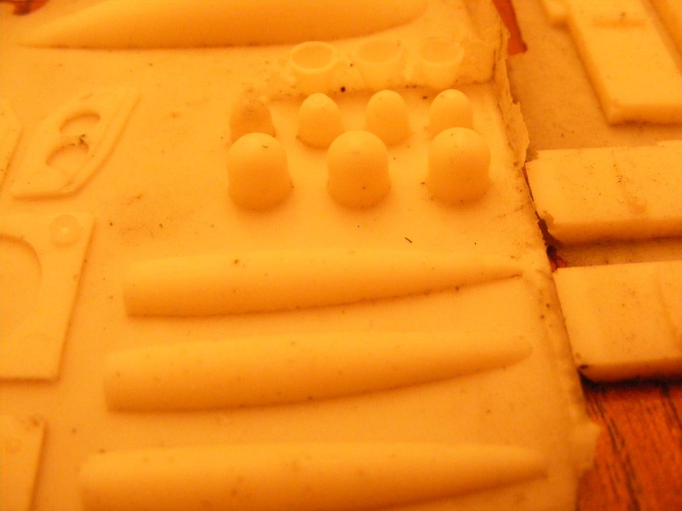

ID:	59196Click image for larger version

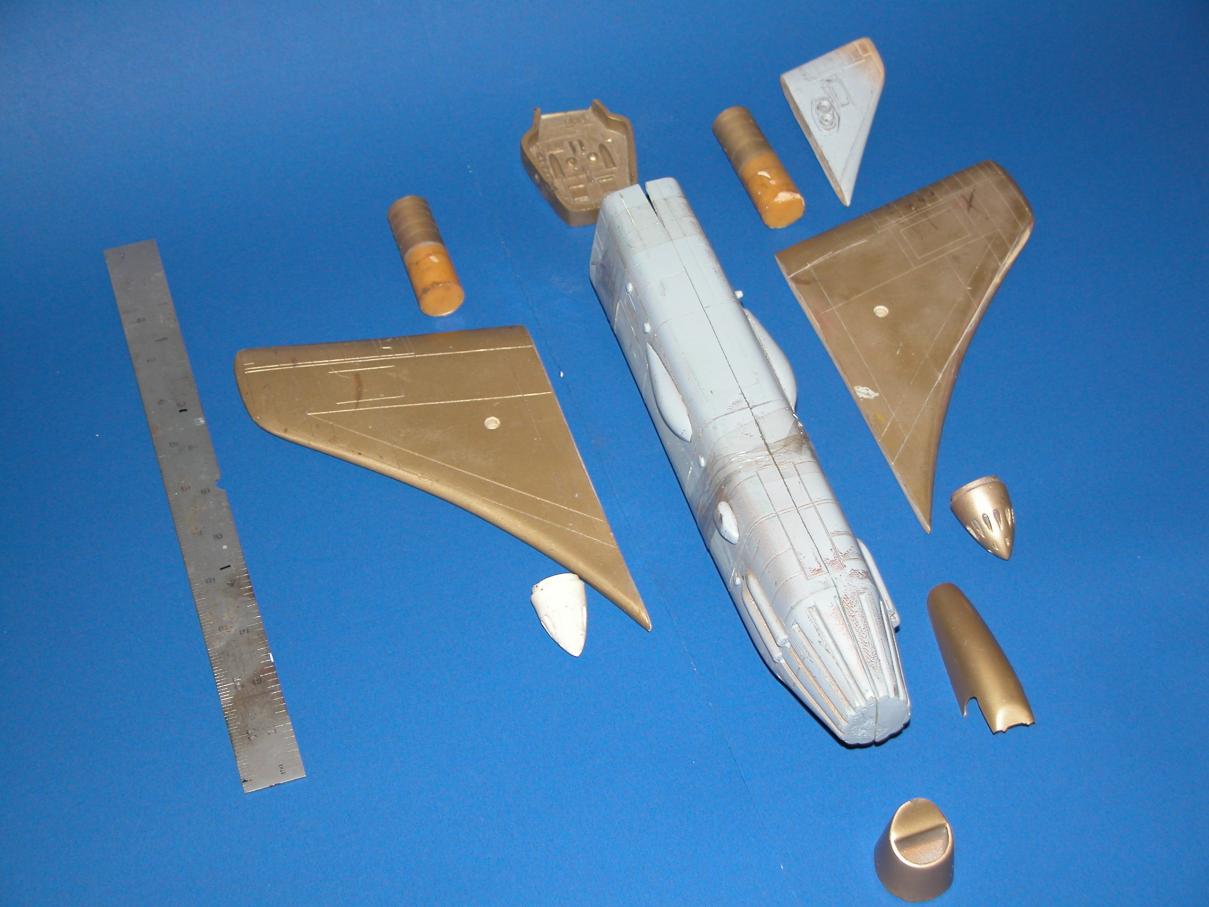

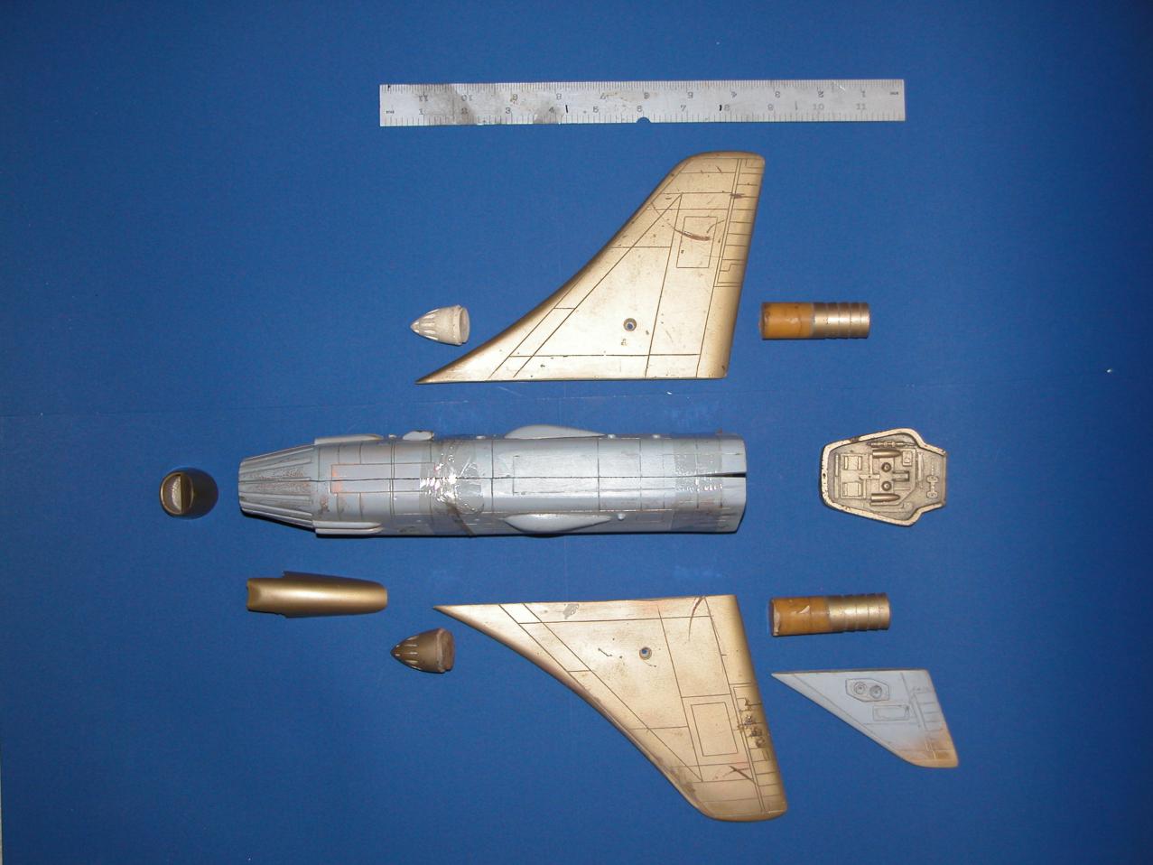

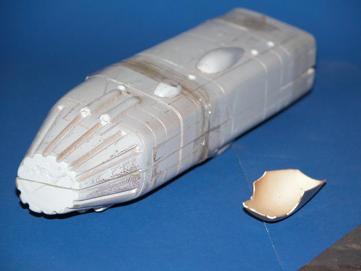

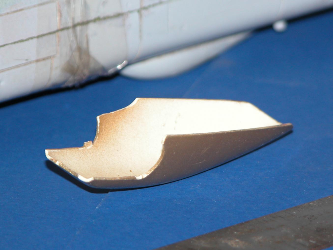

ID:	59195 Sky one is 12 1/2" long and the fuselage is about 2 1/2" wide. You can see here all the resin parts. The only thing that is missing is the canopy. Oh and also the main engine exhaust or thrust nozzles. He didnt make any because of the shape of the nozzles on the jet drives that he uses.

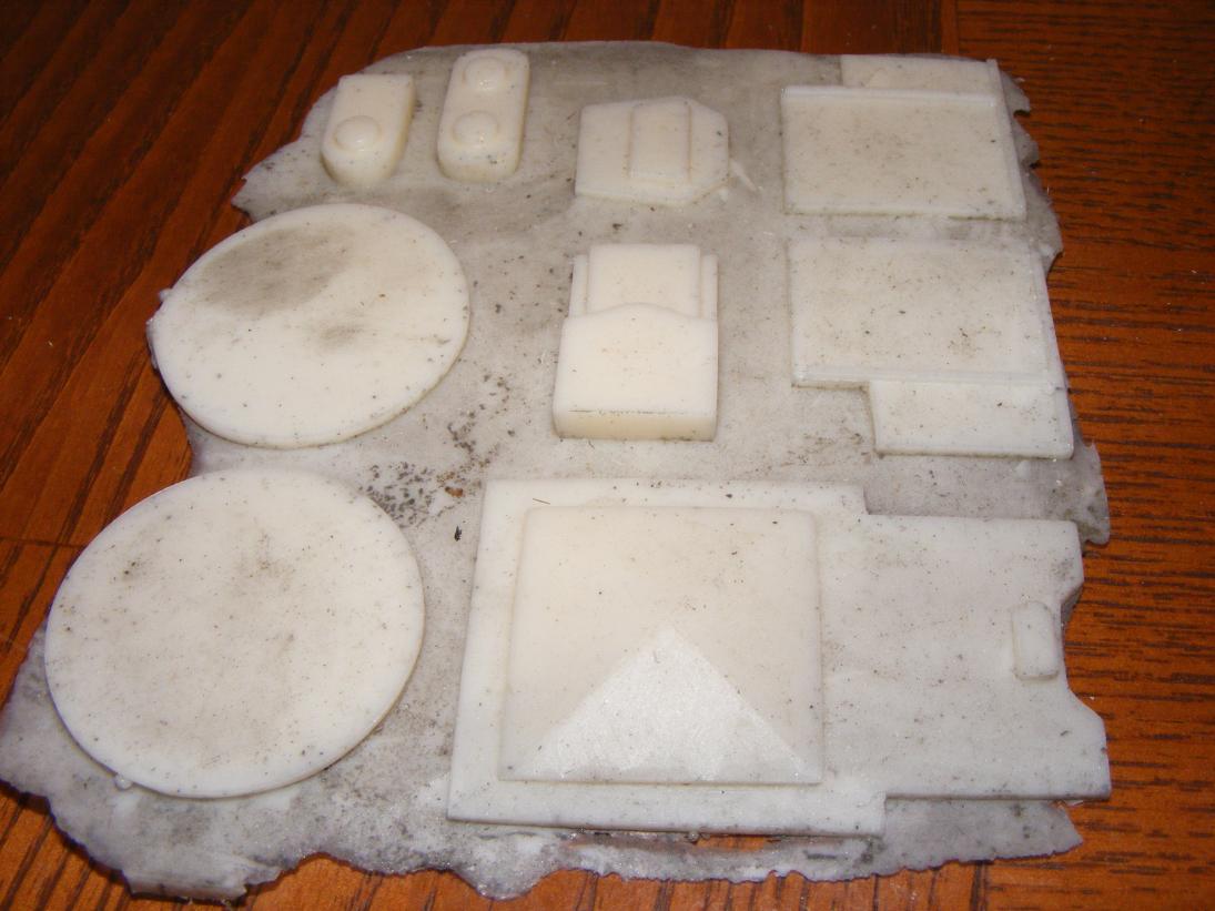

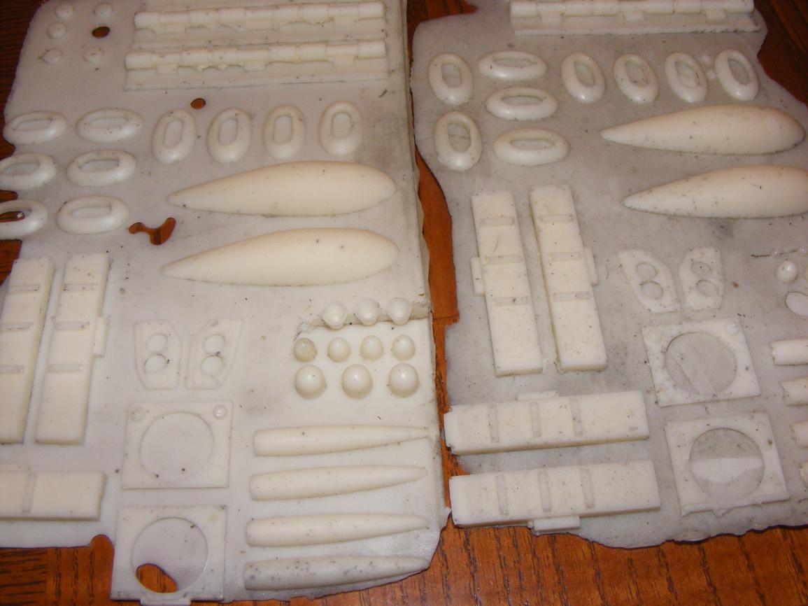

          Something that just arrived from the UK -- pulled off the Century-21 tooling:
ID:	59197Click image for larger version
ID:	59198Click image for larger version
ID:	59199Click image for larger version
ID:	59200Click image for larger version
ID:	59201Click image for larger version
          John Goode will loft off these parts to produce a proper set of drawings from which I can make patterns, tools and eventual parts. I'm thinking of a steam-propelled, flyable SKY-1 (think, Bell rocket-pack).

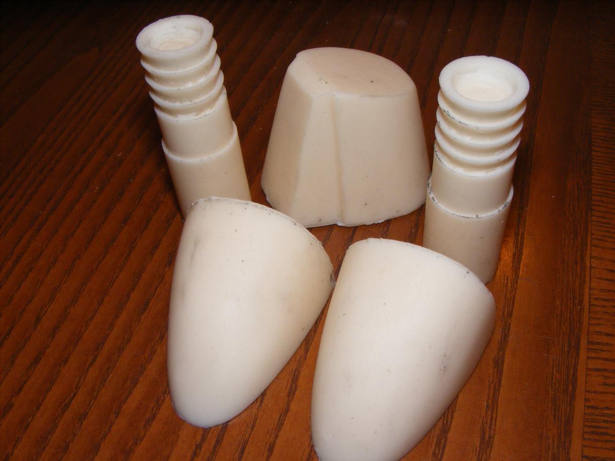

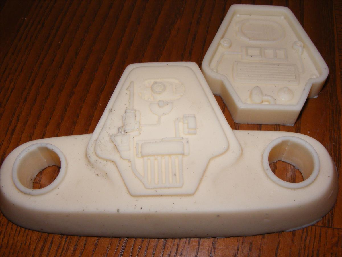

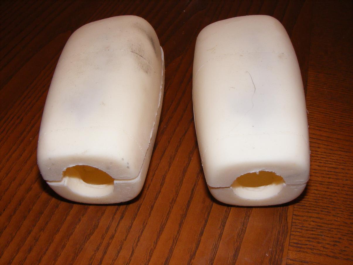

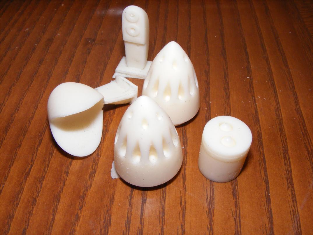

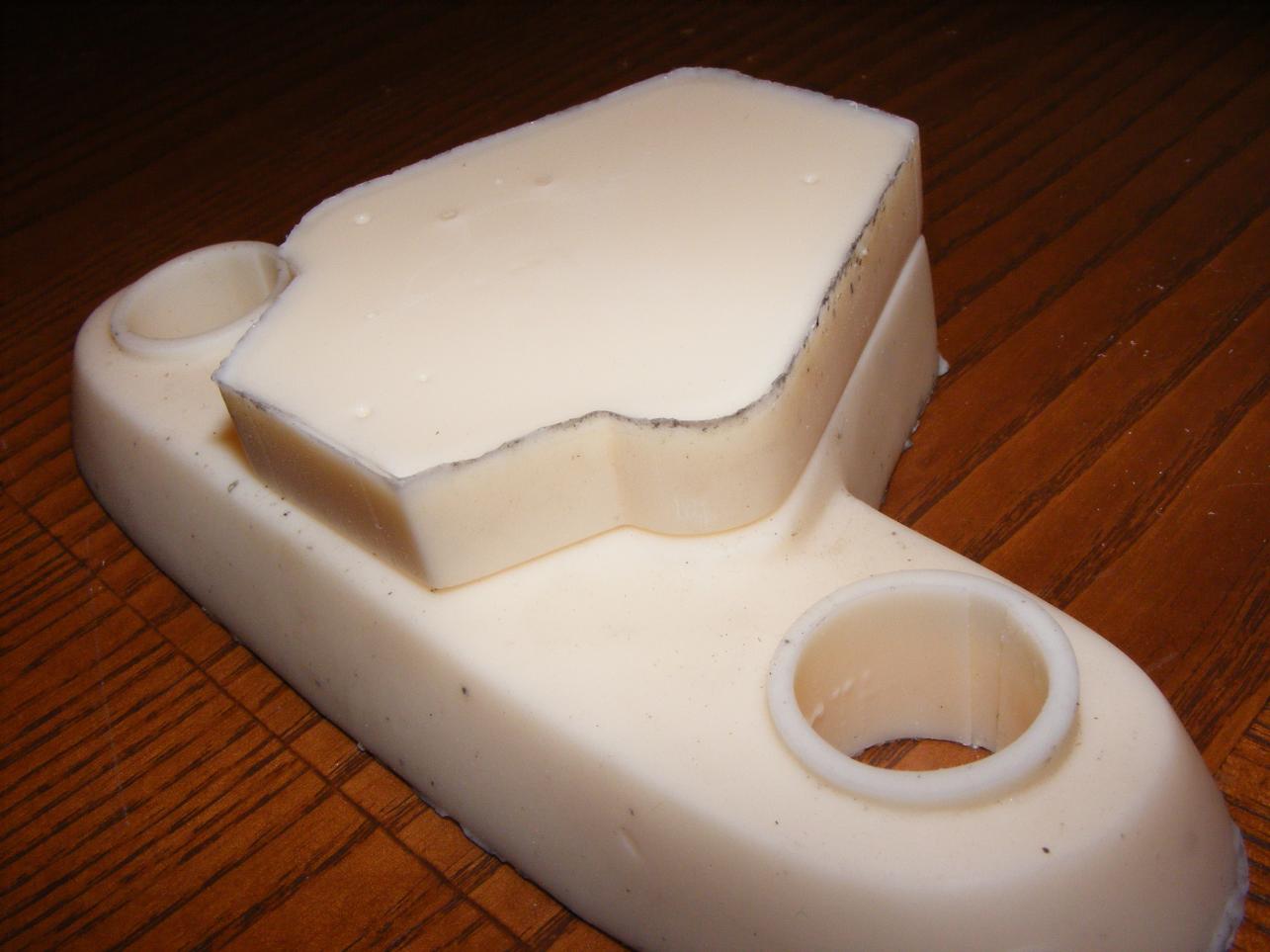

                          I have been asked to post more pictures of the resin parts.
ID:	59215Click image for larger version
ID:	59212Click image for larger version
ID:	59214Click image for larger version
ID:	59216Click image for larger version
ID:	59213 In the upper two shots you see the front of the diver and the rear of Sky. They interloc together quite well. I will put a screw thru here to keep the two together. But I will put it thru the diver part so I can at anytime remove it with a screwdriver from inside. The Sky portion is hollow so as suggested I will make it free flooding like the rest of the sub. The interior space allotment will allow for a 3" Cylinder about 16" long. The forward part of the cylinder will be needed for ballast and will need to go as far forward as I can get it to aproach the center of the sub. Some how I need to determine how much of the cyl. to use for ballast and then the remainder for electronics. Any suggestions?

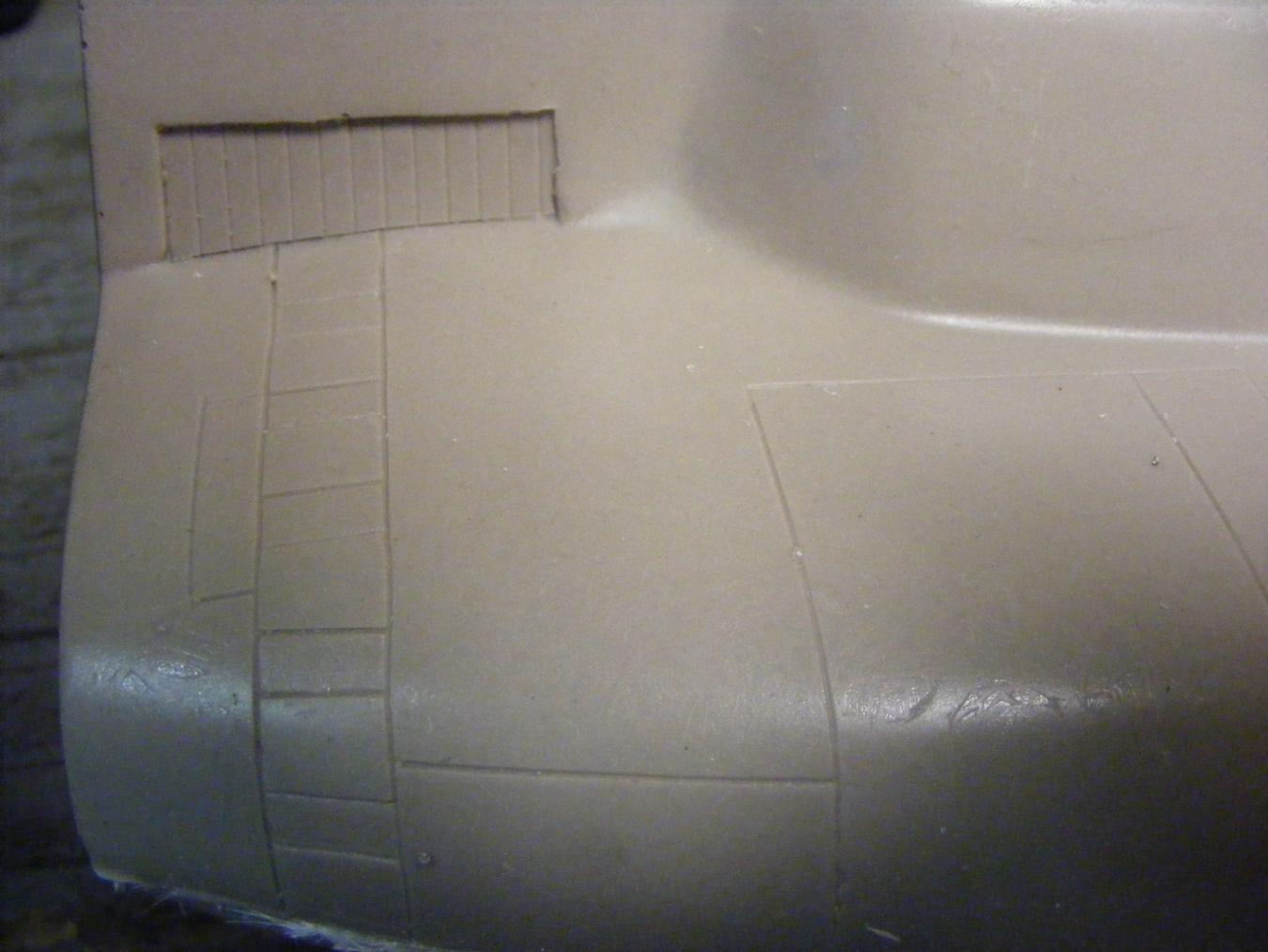

ID:	59230 This is the latest picture of " Mamas's build. If you look closely you can make out the opening in the hull on the flat deck area. You as the builder will have to cut this in yourself. Im going to do it with a large Dremel diamond blade on a right angle attachment. Any errors I will try to keep to the inside. To replace material removed by the saw blade im going to first use plastic strips epoxied under the deck on the hull so that it forms a shelf. Im going to do the same on the cutout except it will stick out past the cut line to take up the space lost in the cut. This will take some precision. Then using auto body filler I will fill in the notch that was formed by adding the strips to the cutout and letting it stick out past the cut line. Keep in mind that when adding a strip to the cutout you effectively add to the edges thickness. Therefore when putting the strips on the inside of the hull youll have to add a spacer to make up this difference so that the end result is that the surfaces of the upper deck where they meet will be flush. Also of note is the radiused corner pictured in the foreground. It has horizontal slots in it. This too youll have to do yourself. A daunting task to make it look good. Various hull openings will need to be cut out and backed up with various types of screen material. The hull openings in the bottom of the hull to allow water in and out so that you can sink it are not marked so you have the chance to be inventive here.
