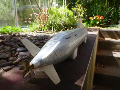

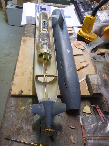

    In a kind of innocent, disconnected way I started to play with fitting the hull halves of the Soryu. Just dry fitting - you know the deal. Anyway before I knew it I had drilled and fitted the rear planes, drilled and fitted the prop shaft, attached the prop, fitted the linkages, trial fit the SD and made a drive shaft! If I keep on like this the boat will be in the water by tomorrow.

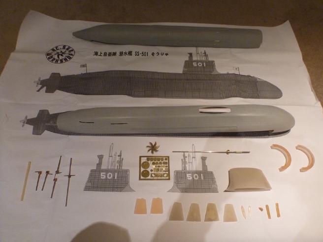

    The kit. Basic but good.

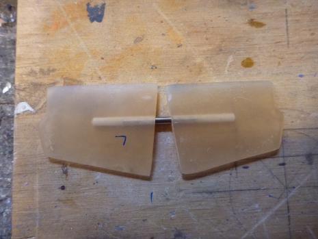

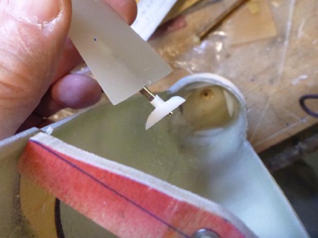

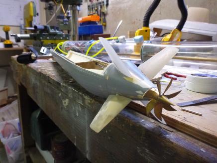

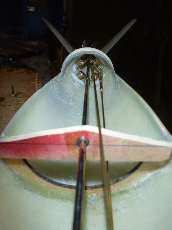

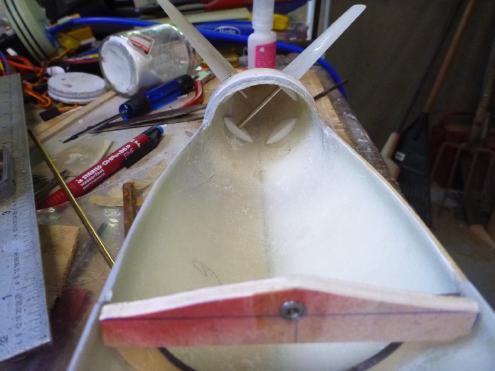

    The hull is only about 2mm thick so I made some bearings to support the X-tail shafts and eliminate slop in the control surfaces.
    Control surface bearings in place, crossmember and prop shaft bearing fitted as well.
    X-tail fitted and prop attached.

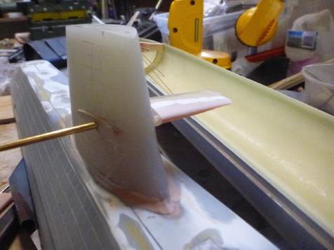

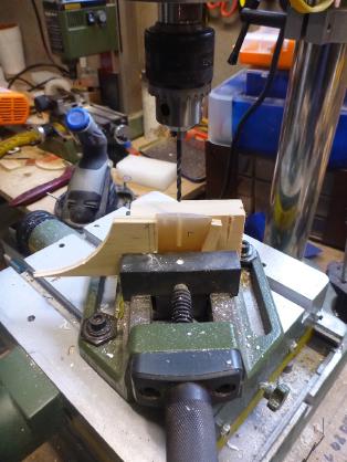

ID:	110711The jig used to get the drill hole in the right place in the fairwater plane.

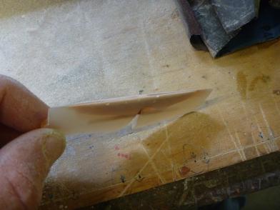

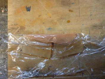

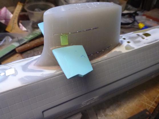

ID:	110712After the drilling it became obvious that the planes were slightly DIFFERENT! Also a bit thin at the root leading edge when compared to the photographs, thus
            The fix. Some cling wrap and filler.Click image for larger version

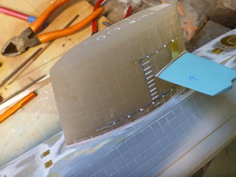

                Getting on with the railings.

ID:	110721And the sail ladder.

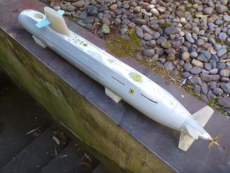

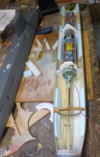

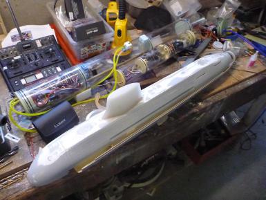

                        Fitting the SD today. Should be in the water on the weekend.Click image for larger version

                          Change of plan. Click image for larger version

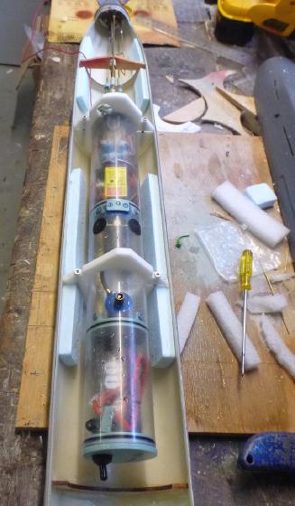

ID:	110803 I fitted the 2.5" SD that usually drives my Alpha. The intention was to use the "V" mix function in my transmitter to run the X tail of this boat. Not so great as it turned out. I can get it to work but the servo throws are tiny; the end points can't be adjusted correctly; the rudder servo workes fine but the (slave) rear planes servo is all over the place. After an interesting few hours I gave up and fitted the 2" SD from my 212 which has a seperate X tail mixer already fitted.
                          I'm not going to get scale water line with this set up - the sail is too heavy but I will get to decks awash and that's good enough for now. I did have to put A LOT of lead in the keel to keep her upright. That damn sail is almost 5mm thick and its solid fiber glass. That said, everything went in fine and it all works. More trimming tomorrow and then the paint job. Hurrah.
