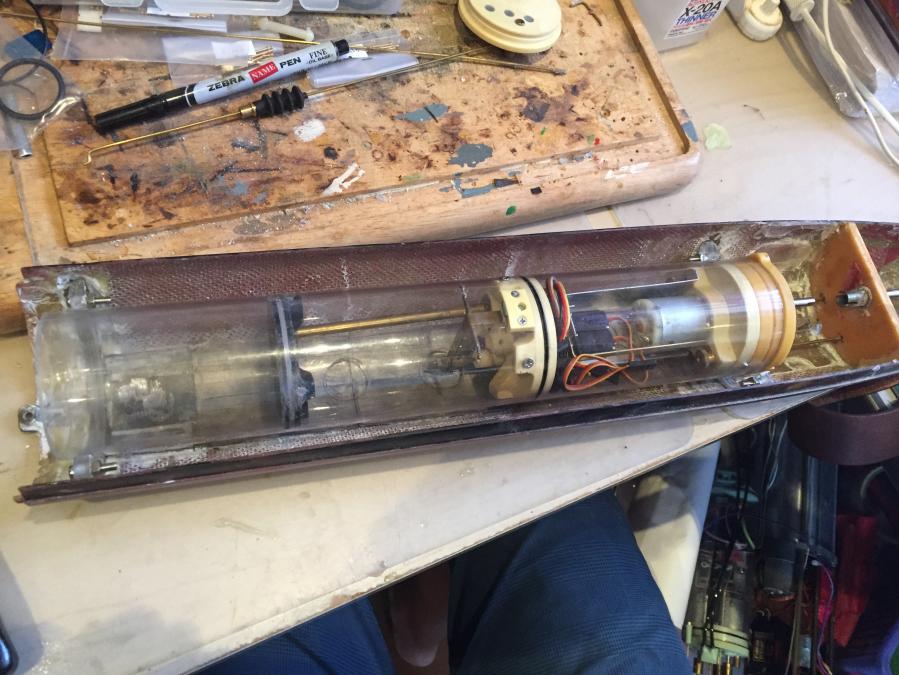

            Slow work over weekend , but got the wtc cradles fixed in place. Also made new snort pipe which is hidden in mast. Lastly fired up the Rx and started checking servos. Annoyingly the vent servo which is now tucked inside the tube is NFG. Need to see if I can install a new one without disturbing the bulk head. Grrrr
              You can swap out that servo without need of pulling the after ballast bulkhead. You'll need a very long hemostat. remove the two wheel-collars on the wet side of the pushrod; remove the dry-side servo bracket; grasp the servo with the hemostat and yank the entire unit out; replace.
                #37
                Managed to get it out without disturbing pushrods. New one installed and working. I must have been a ginocologyst in a past life. Next job is soldering the wiring loom, air pump controller etc etc.
