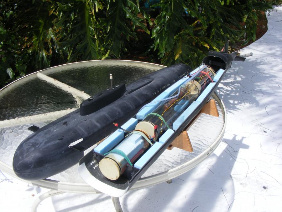

    Here we have the large Caswell snort system pump siliconed into the 3.5 Subdriver. One of the masts that comes with the sub is made of a hollow aluminum tube. It will serve as the snort mast.Click image for larger version

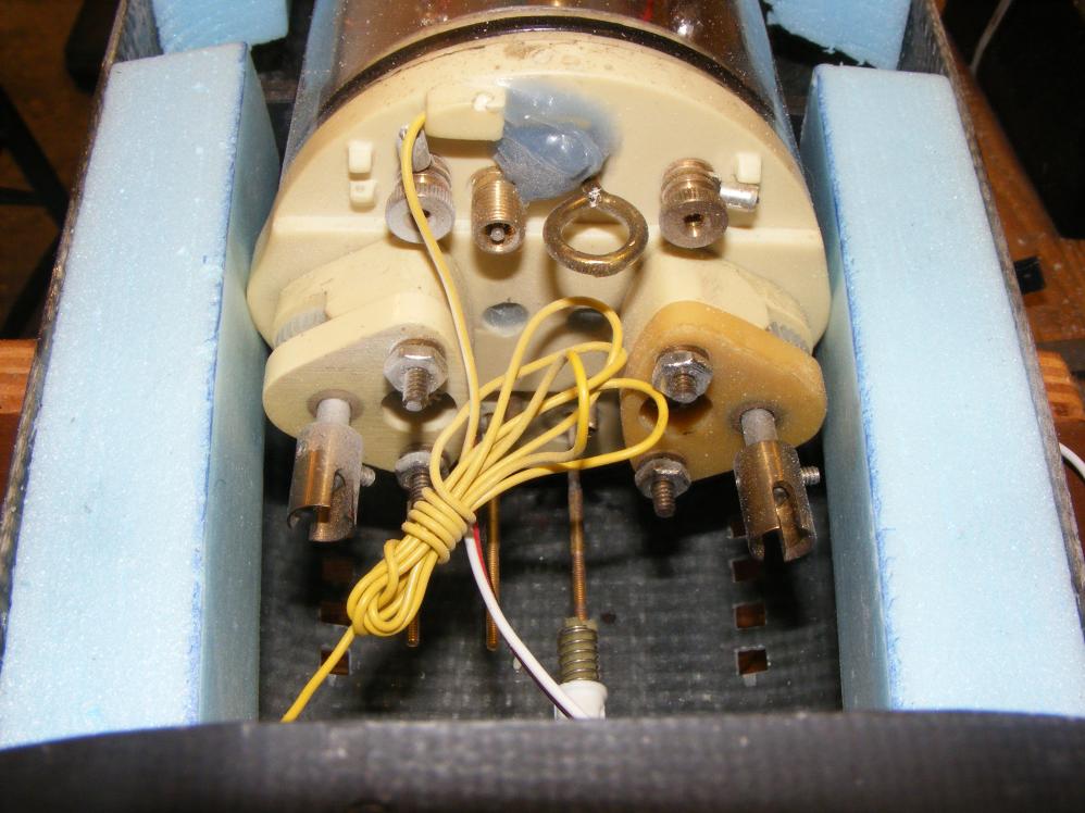

      [ATTACH=CONFIG]3961[/ATTACH][ATTACH=CONFIG]3960[/ATTACH] Here you can see the intermediate shafts that hook up to the quick disconnects on the subdriver pushrods. They allow for adjustment.[ATTACH=CONFIG]3962[/ATTACH]

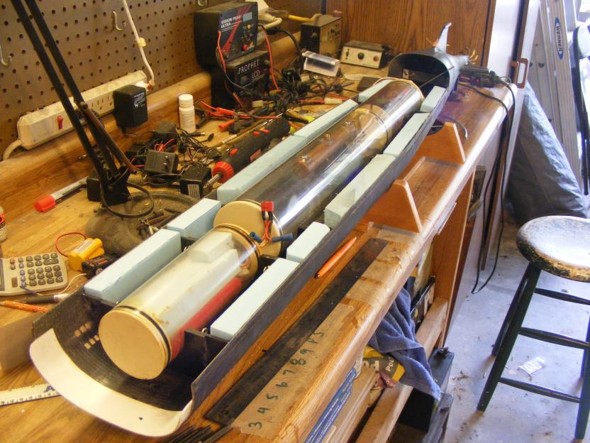

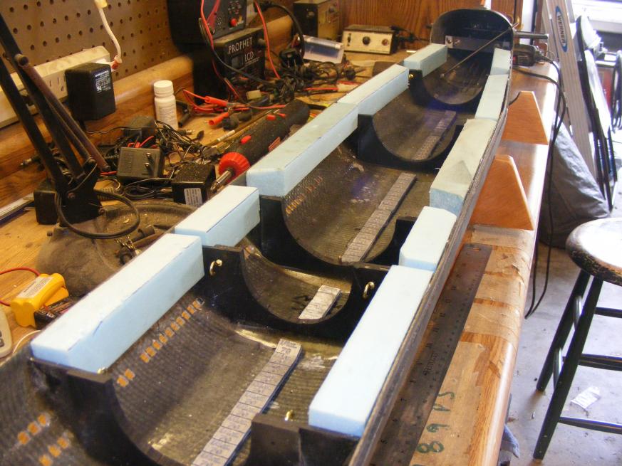

ID:	58679 Here we are with the lead weight and foam installed along with the Subdriver in its place. We are getting closer to getting this thing into the water.

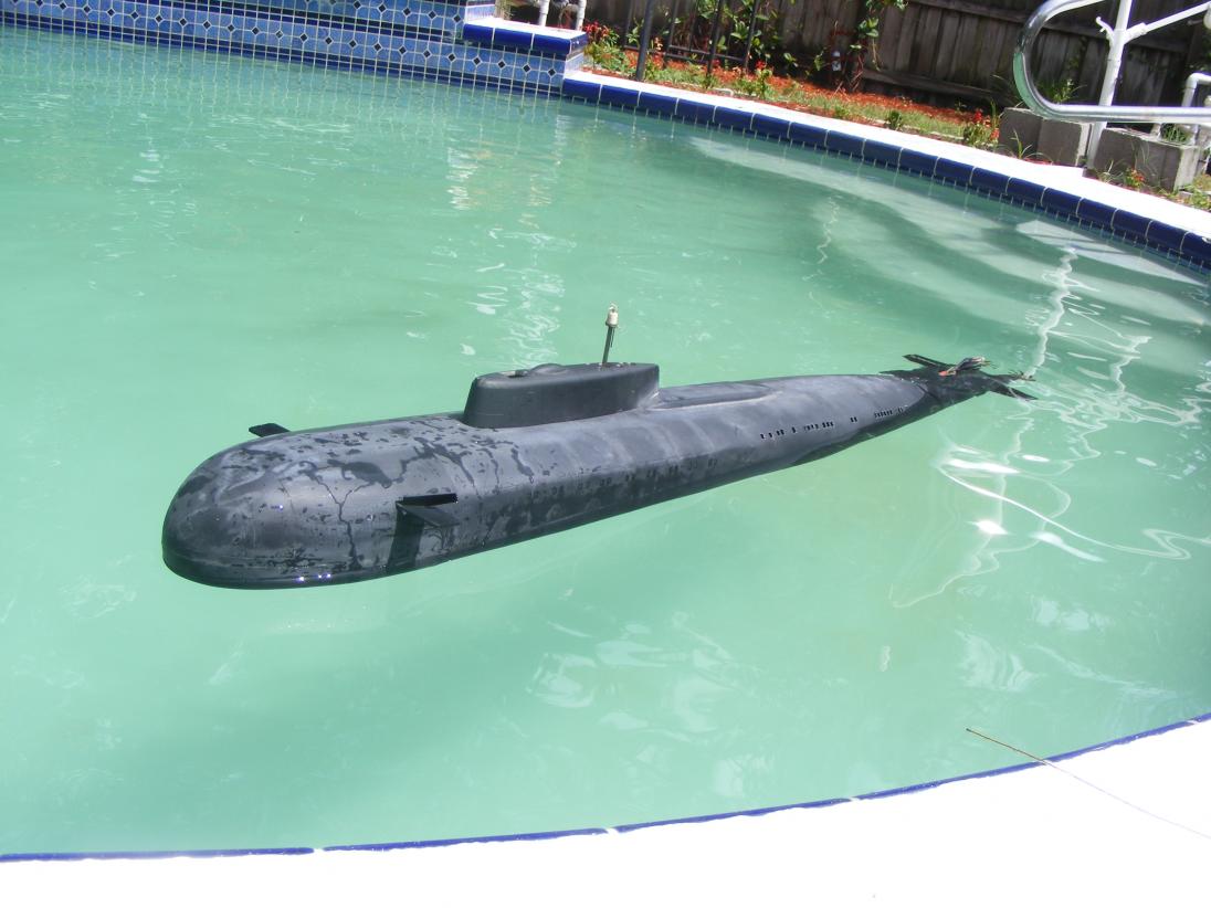

            This thing will hit the water for trim testing this saturday 5-15-2010 @ 8:30 AM sharp. In this session I will determine if I need to adjust the weight and foam(its a given) to achieve good submerged trim. At that point we will have to live with the surfaced waterline, whatever it may be, I beleive. We will also time the Snort system to see how long it takes to empty the ballast tank of water.

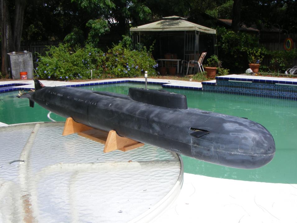

ID:	58753 As promised , into Click image for larger version
Name:	4-26-10 boats, oscar 107.jpg
ID:	58751Click image for larger version
Name:	4-26-10 boats, oscar 109.jpg
ID:	58752the water she went. AS you can see shes floating way too high in the front and too low in the back. At this point I realized that I had made the same mistake with the Seaview. I had installed the foam in the lower half of the hull when I should have put it in the lower half of the upper hull. So I will make that change and adjust further.
                    • 13982
                    Hey, you're going to hit the designed waterline with freeboard to spare. Just move the forward foam up higher than the designed water line -- that will lower the bow and raise the ass-end. You're almost there, Mark.

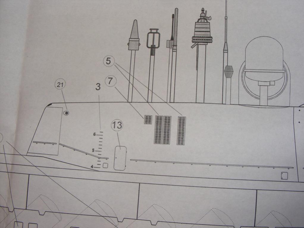

ID:	58756 All of the various masts are shown in detail and are given names that are not descriptive as I had hoped but were more like pet names, such as Bark, Radian , and Lightning.

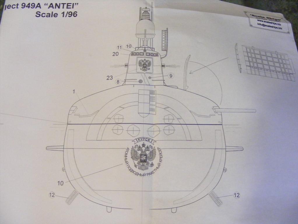

                            Im going to assume that these drawings are accurate. I noticed in this drawing of a bow view headon that the hull at the waterline which is between the two rows of torp tubes Narrows significantly and then widens back out. The hull that I have certainly does not have this hull condition. Just a minor detail.

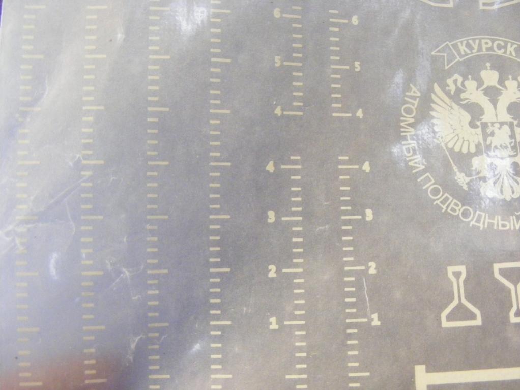

ID:	58760 I am very concerned about these dry transfer decals. They look great but I am concerned that they are made to go on a flat surface. The large one goes on the bow below the torp tubes and is in an area of compound curves. I am afraid that it will wrinkle if you try to put it on. Also does the paint need to be flat or gloss when you apply them or does it matter?

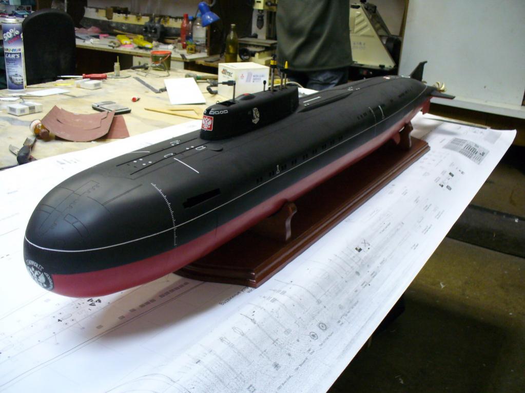

                                In this picture you can clearly see that the bow decal is on there. How did he do it?Click image for larger version

ID:	58762 This picture was sent to me by Scaleships.
