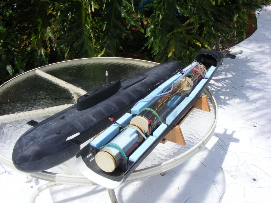

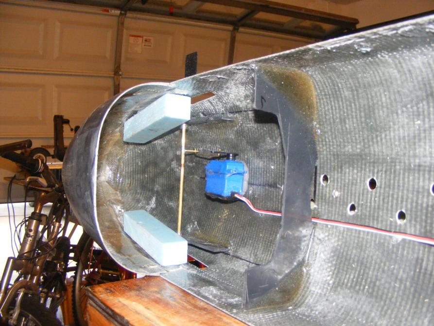

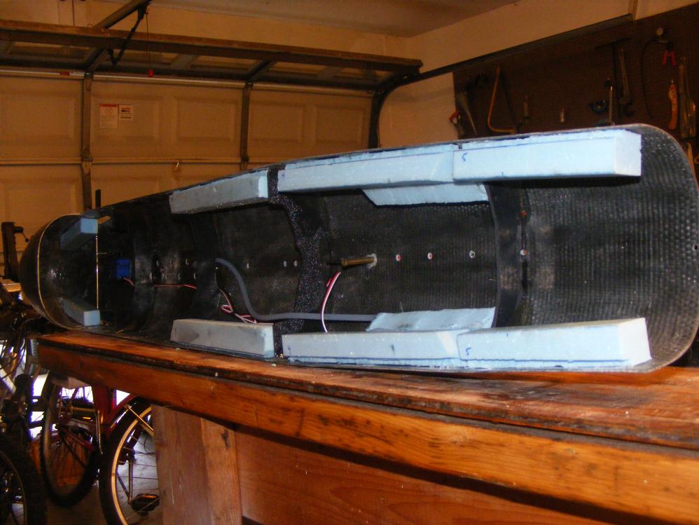

          Dave Meriman, several years ago, supplied me with a guide to ballasting and installing foam in a sub to acheive good balance and surface/submerged trim. So seeing that the foam was in the wrong place vertically to start with I pulled it all out, reinstalled it and set out again to trim it. I got it pretty close with further refinements to come. So I took it out Saturday morning to the pond and launched it. After about 15 mins. I noticed a few items that needed attention so I headed back to the dock. It was then that I saw the port propellor part company with the sub. Try as I might I cant locate it. Scaleships is talking about a late July del. date. I am in contact with Kevin McCleod to see if he can help me aquire a new set. In the mean time One prop will still provide enough propulsion to continue testing.Click image for larger version

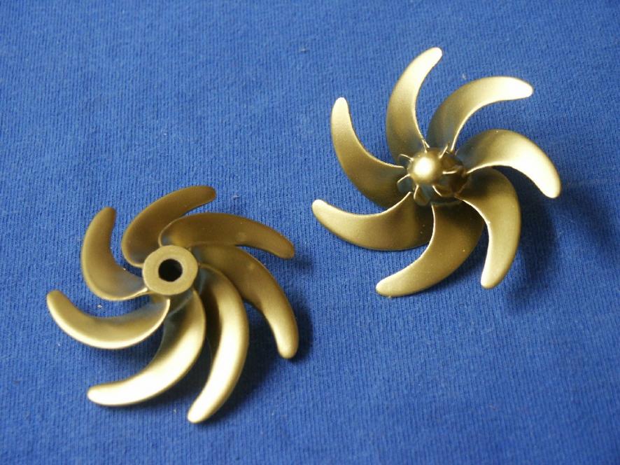

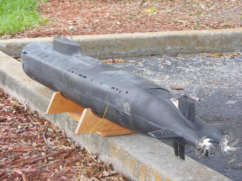

            Kevin is indeed sending me two of his props. Once they are cleaned up and drilled for set screws I will red loctite them on the shafts and blue loctite the set screws.Click image for larger version
ID:	58815 I should be recieving them any day now.:biggrin:

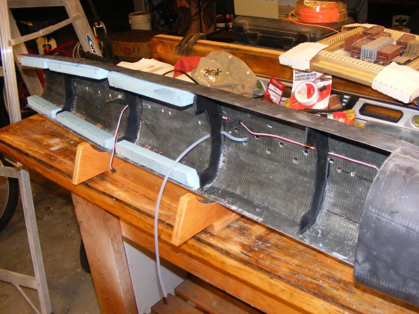

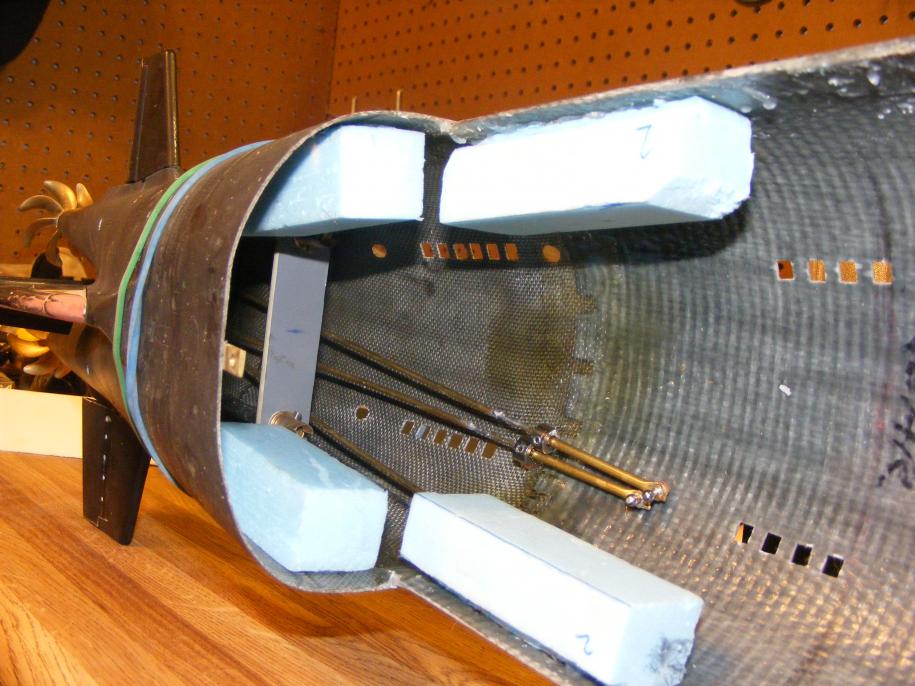

              This is the final arrangement of foam in the upper hull. That along with 1 lb. 5 1/2 ounces of weight on the keel. This causes the sub with full ballast tank to float with the sail just out of the water.Click image for larger version

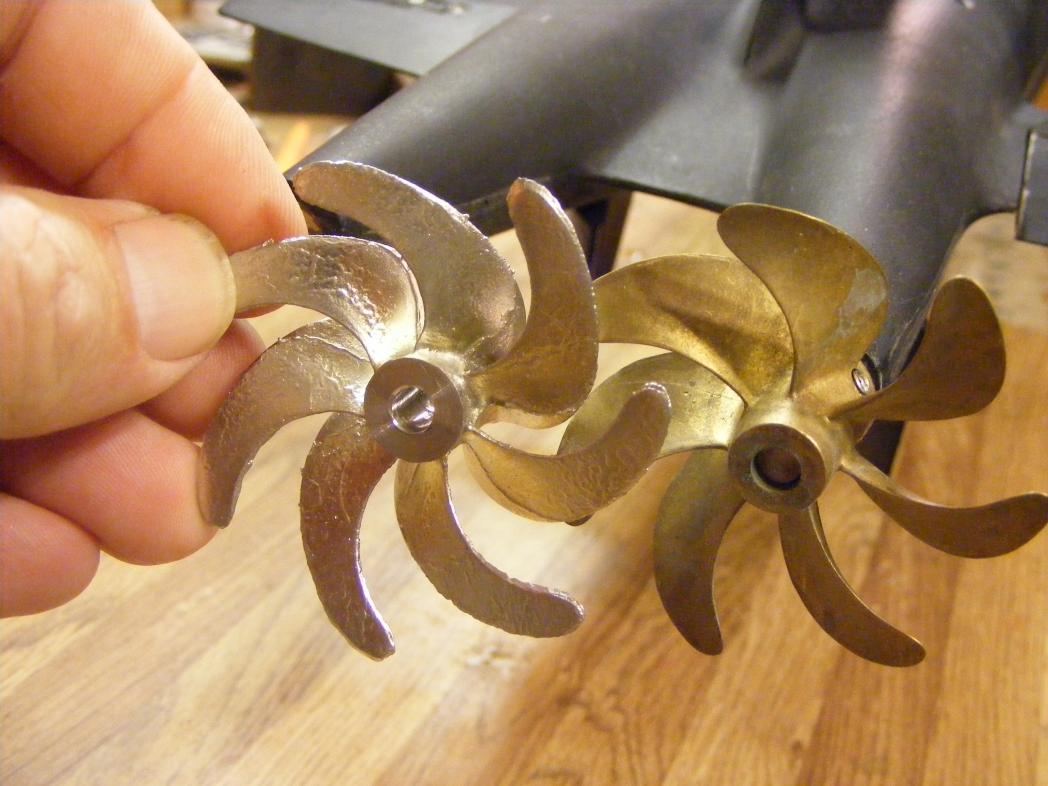

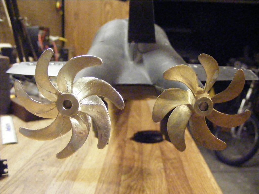

ID:	58821 I recieved these new props from Kevin Mcleod and am quite pleased. Kevins props are the silver ones and the brass looking ones are the original Scaleships supplied units. If you look at the side view you can see that the blades on Kevins props are longer and that looks like it will translate into more blade area, perhaps more thrust. We will see. Top shelf quality if you ask me!

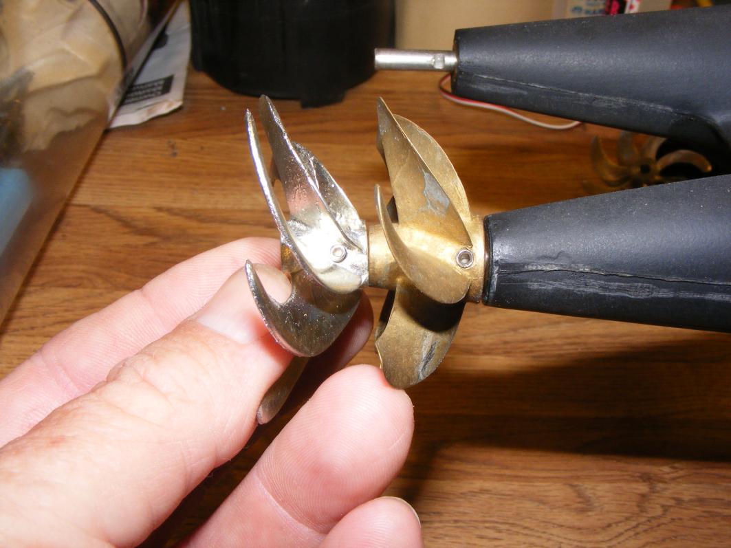

                        I got the new props mounted and ready to go. I had to cut the shafts a little shorter as the new props hub is shorter. Hopefully the red loctite and drilling a hole in the shaft to recess the set screw will be the end of the mystery of the missing propellor!!!!!!!!!
                          #42

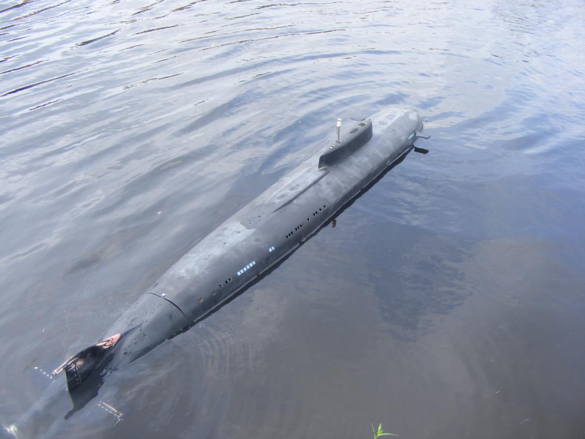

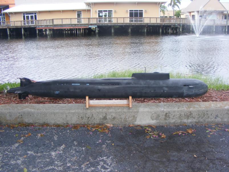

                          Ok, Sunday she went into the water again. This time we started out with a test of the new props. Because of their white metal construction their best thrust was produced at mid throttle, after that the thrust went downhill as the RPM increased. Using them to good advantage I put her thru her paces. One word will sum it up...Beautiful. With the streamlined hull and older version ADF ,periscope depth was a piece of cake. Using a detented right and left stick, fine control of periscope depth was achieved. The left stick up and down controls the front planes and each click, click, of it makes modest but visual changes to the subs depth in the water. Very nice!!! It does however take an acre to turn around! I would estimate that the surface turning radius is 30 feet, thats 60 feet dia.!!! Too much. For one thing , on the surface the upper rudder is out of the water and is useless. I will probably(Agahst!) add a add on rudder extention to the lower rudders at some point. Its a good thing that I can use the props to slew it around when needed.With the Seaview you have the prop wash against the rudders to help and not just the force of the water coming from the boats motion to deflect you. I was just thinking about a forward rudder but dont get me started on stupid non scale stuff like that. A bow thruster is really not necessary when you can forward and reverse each of your props. Im going to be shooting some operational videos shortly to demonstrate its fine scale performance and also its Snort performance.
                            #43
Name:	Oscar & Blackjack 017.jpg
ID:	58914Click image for larger version
Name:	Oscar & Blackjack 016.jpg
ID:	58913Click image for larger version
Name:	Oscar & Blackjack 015.jpg
ID:	58912 Here are some of the picsClick image for larger version
Name:	Oscar & Blackjack 014.jpg
ID:	58911 taken on Sunday.Click image for larger version
Name:	Oscar & Blackjack 018.jpg

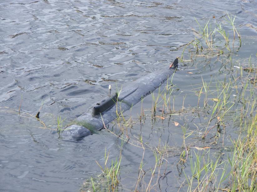

ID:	58915 If you will, you will notice the Oscar surrounded by weeds. It became a victim of driving too close to them and thinking that the visible weeds was all that was there. Invisible underwater weeds, like invisible underwater submarines, do pose a threat.

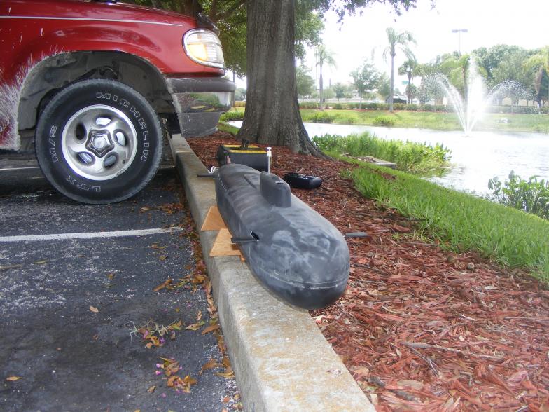

                                I went out Sunday to check turning radius and to get some videos of it on patrol in the alligator pond. Murphys law stepped in and the voyage was cut short.Click image for larger version

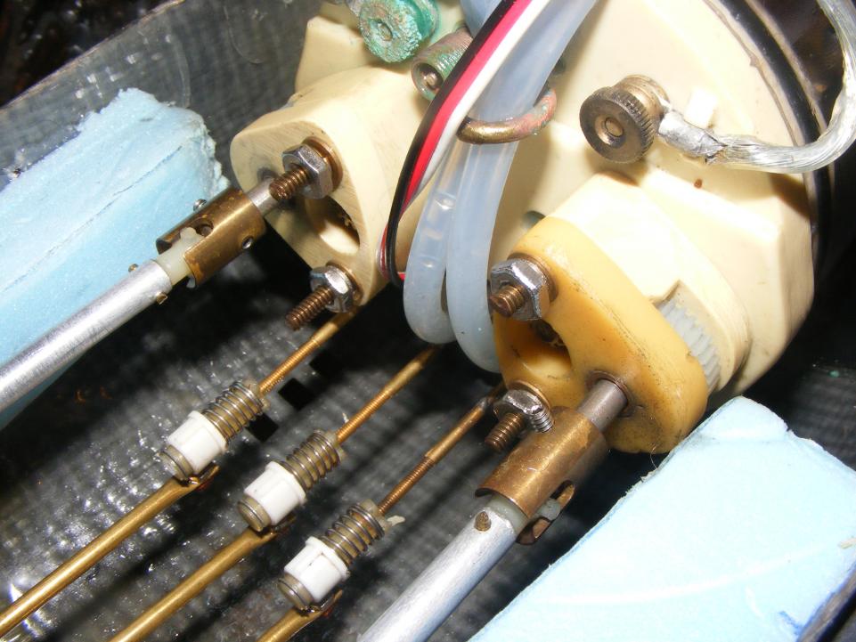

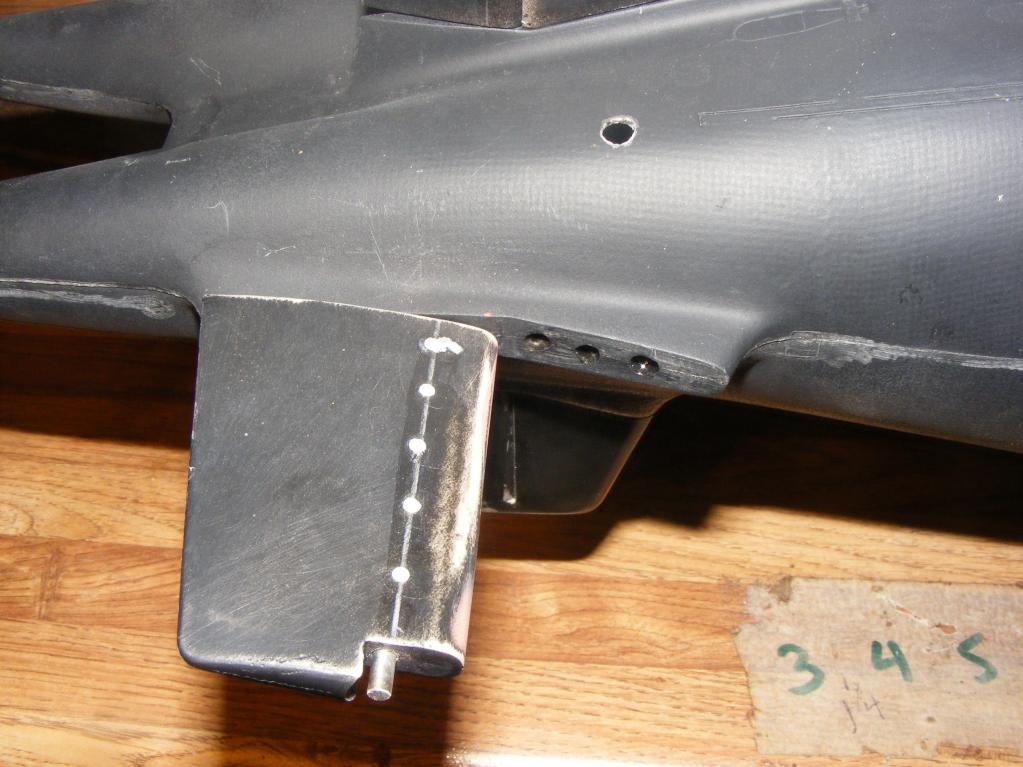

ID:	58941 The screws on the gearboxes came loose allowing the gears to disengage each other. They have an appointment with the tube of blue loctite. Then I lost some of my steering. All the control surfaces use a stainless steel shaft with a good friction fit. During the build I drilled some holes along the length of them and dripped in CA. but they keep coming loose. Now I will pull them apart and cut some grooves in the shafts and open up the control surfaces and use epoxy to stop this from rearing its ugly head up again. If that was not enough then this happened.Click image for larger version

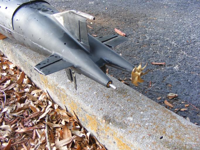

ID:	58942 I lost the forward section of the stern plane. Very embarrasing!!! WELL IT WAS THERE WHEN I STARTED OUT! Vladamir wont be able to recieve my cry for help until the evening(timezones you know) so we will see what he has to say. That will put an end to my operational efforts for probably a couple of weeks so I can get to work on the Indexer, and that will be challenge enough!
