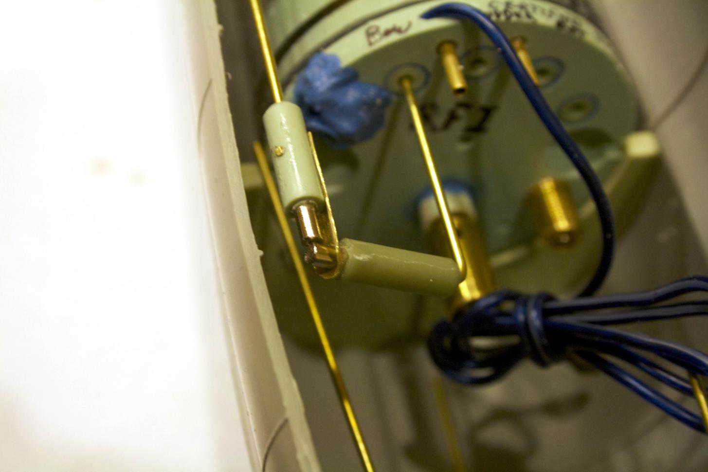

    replied
    Thank you Gary!
    The rudder is disassembled. The axel was very tight to remove, needing pliers to pull out. You can see that the axel has a flat surface ground into it. This is where the grub screw will sit against to prevent slipping on the axel.
Name:	Bronco Type 23_071.jpg
    Made a z-bend on a pushrod with one of my favorite pliers and put a tiny touch of CA onto the pushrod where it meets the dive rudder bell-crank horn. Here you can see that I can turn the pushrod 90 degrees and the bell-crank does not flop around. The bond is easily to break and allow the pushrod to move freely.
Name:	Bronco Type 23_072.jpg
ID:	84869Click image for larger version
Name:	Bronco Type 23_073.jpg
    Drilled a 1/8" hole on the topside of the rudder and fed the rudder axel/shaft through the bell-crank and down through the rudder. Tighten it all up. The set screw or grub screw on this blew-crank is a paint in the tuckus. After everything was set up is still seemed to slide, but I could not see down to the bell-crank (maybe during daylight.
Name:	Bronco Type 23_074.jpg
ID:	84871Click image for larger version
Name:	Bronco Type 23_075.jpg
    Compared to the rudder, the rear dive plane is a breeze to install. I did need to ream out the holes for the shaft of the rear dive planes a tiny bit. Then once installed (which was super simple), one plane was not tight on its axel/shaft. So much so, that it could not support it's own weight. I am going to assume that these are to be attached with RTV rubber?
Name:	Bronco Type 23_076.jpg
ID:	84873Click image for larger version
Name:	Bronco Type 23_077.jpg
    Here is a shot of the bell-crank on the rear dive planes.
Name:	Bronco Type 23_078.jpg
    The bow planes were the easiest to install. For this on I used one complete length of 1/16" brass wire for the pushrod.
Name:	Bronco Type 23_079.jpg
    Long length of brass wire being used for the pushrod.
Name:	Bronco Type 23_080.jpg
    I am going to route the wire down the side of the sub-driver over the flat tops of the sub-driver foundation on either side of the hull. We will see how that works.
