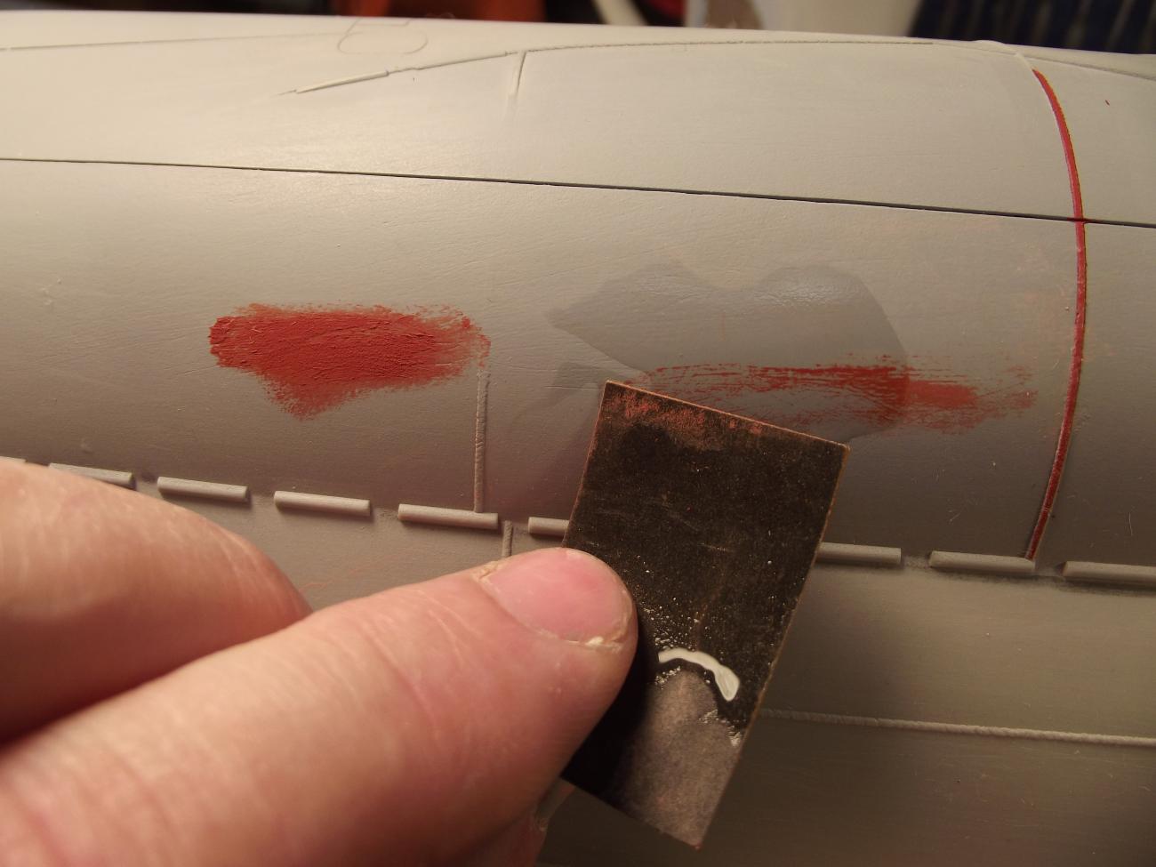

Today I did a test on weld lines.
Here is the erased section.
Placed tape so that it matched the missing weld line width.
Sprinkled in some baking soda and rubbed it into the gap.
Using a brass wire touch the CA to the baking powder weld line.
Rub any loose baking powder into the weld line to soak up any CA not cured.
Take a sanding stick and sand it down to level the weld line to the tape (or slightly higher).
Peel the tape off and there you go a weld line that looks pretty close to the original.

Worth remembering that a weld bead on a hull is likely to only be about an inch wide (prepares to be corrected), so thats going to be 1/32 inch on this model boat. Dont overkill the lines.
On my Koryu i sprayed some paint into a pot, allowed it evaporate for a while, then daubed the gloopy paint mix onto the hull, after similar masking tape tracks were madeLeave a comment:

Thanks for the idea. I use Baking Soda and CA. I am not too worried about the details, I will recreate them.Leave a comment:
You might try thin strips of tape to represent the welds. When you paint the hull the tape will show up as a raised line. If you're not happy with the look you can always sand off the tape. Might be worth a try.
