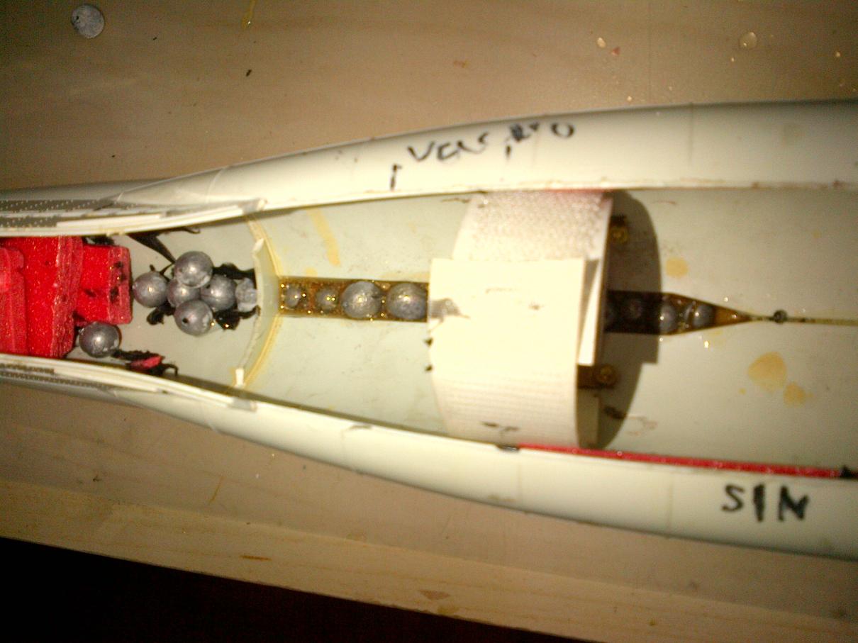

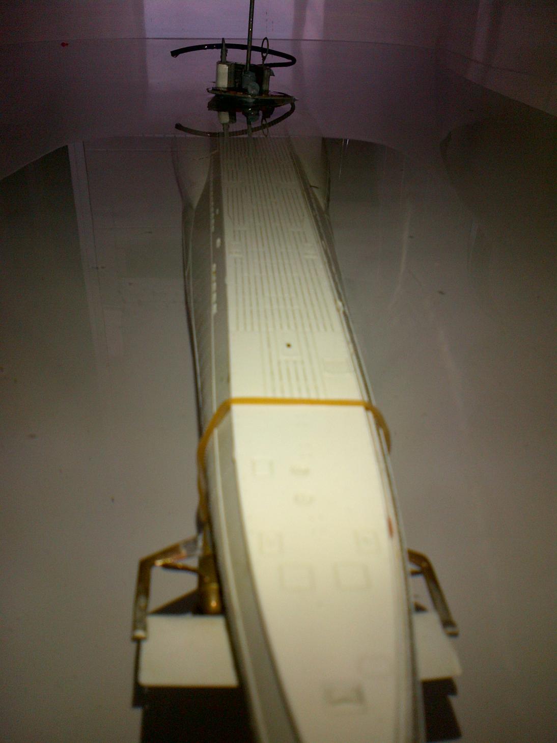

        Could you please estimate total weight of lead you used for ballast, and general distribution?
        I realize your build is unique with the snorkel, but I am also in the bathtub trial phase and am curious.

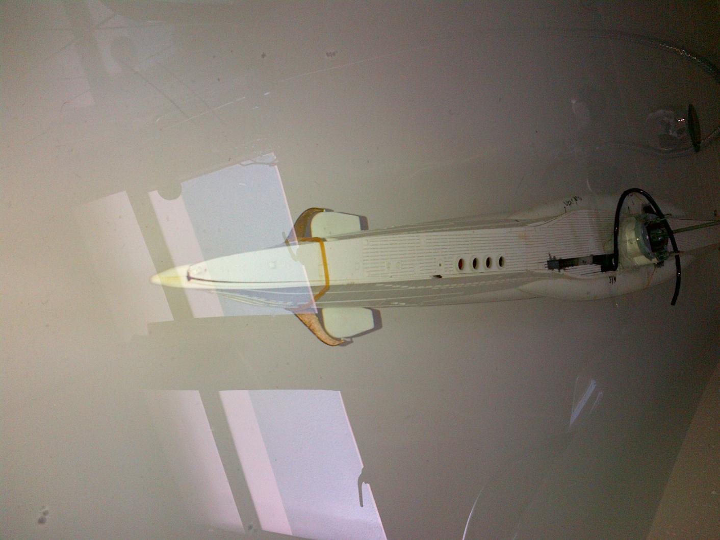

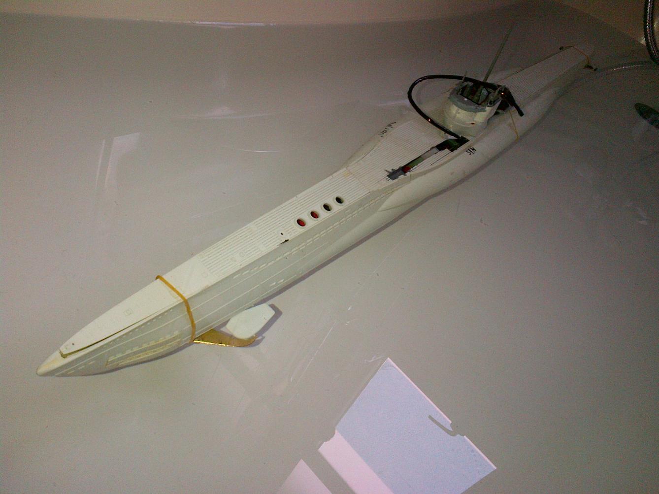

            Sitting nice. How does it sit when empty?
            Cheers Chris
              Oz - above waterline , im being more critical about getting a good submerged trim with tip of periscope/ snorkel above water. With some features missing this is as far as i want to go right now, as i add the snorkel, sail details etc the hull will sit lower.

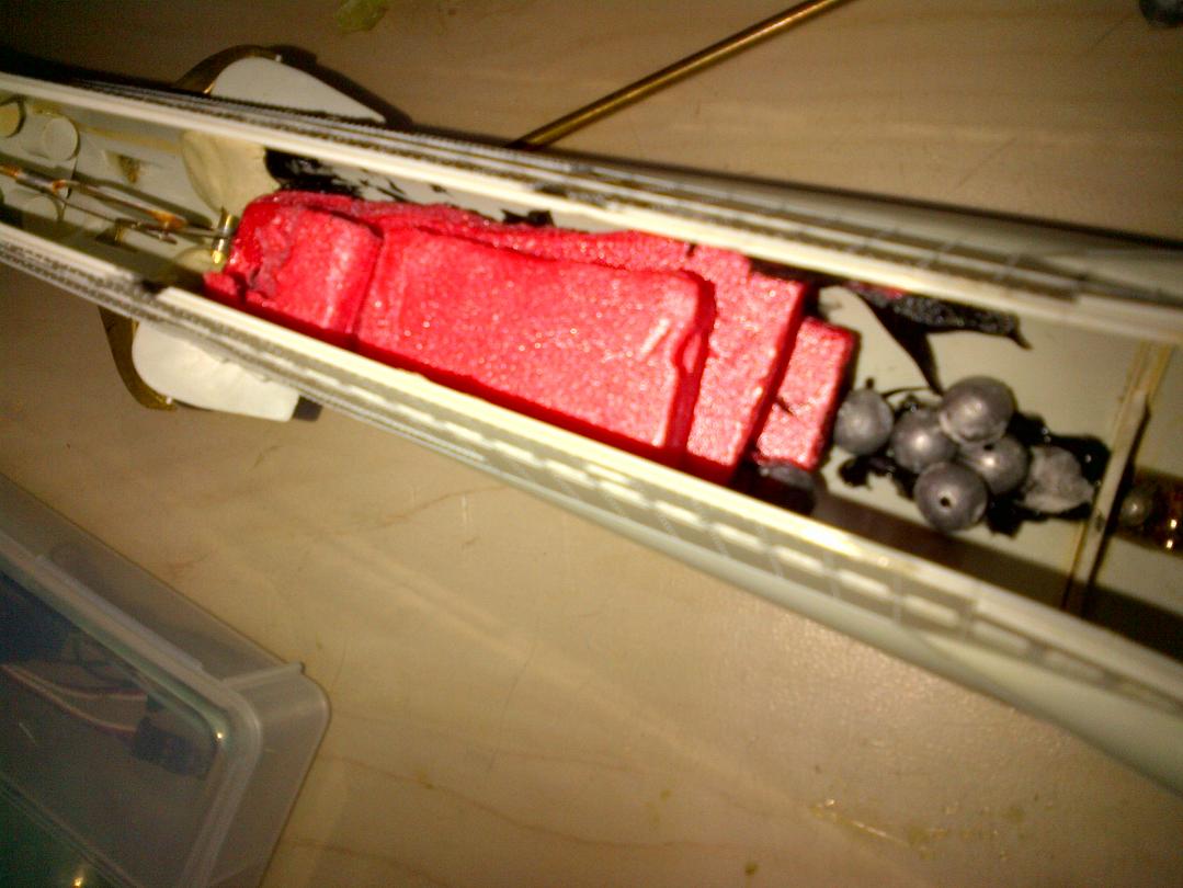

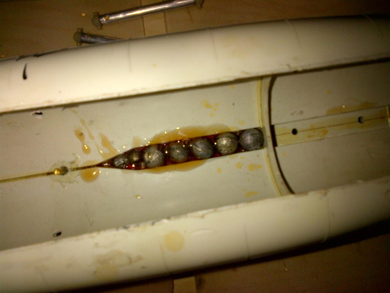

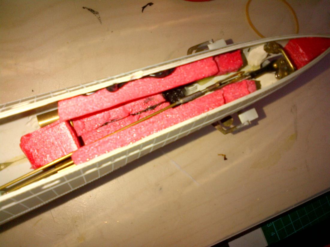

              Addington see photos. Note the brass parts are heavy, and also the thicker prop shaft and brass props all add up. i don't have a lot of lead in mine, and could probably remove more from the rear middle section to reduce the foam at the rear (I did try to pry at it the other day, but i risked breaking the hull, so might need to drill some of it out. Both ballast bulges are full of foam, and there's some more from stern which is not shown
              I'm please with the brass work, but the stern area could do with some weight reduction
