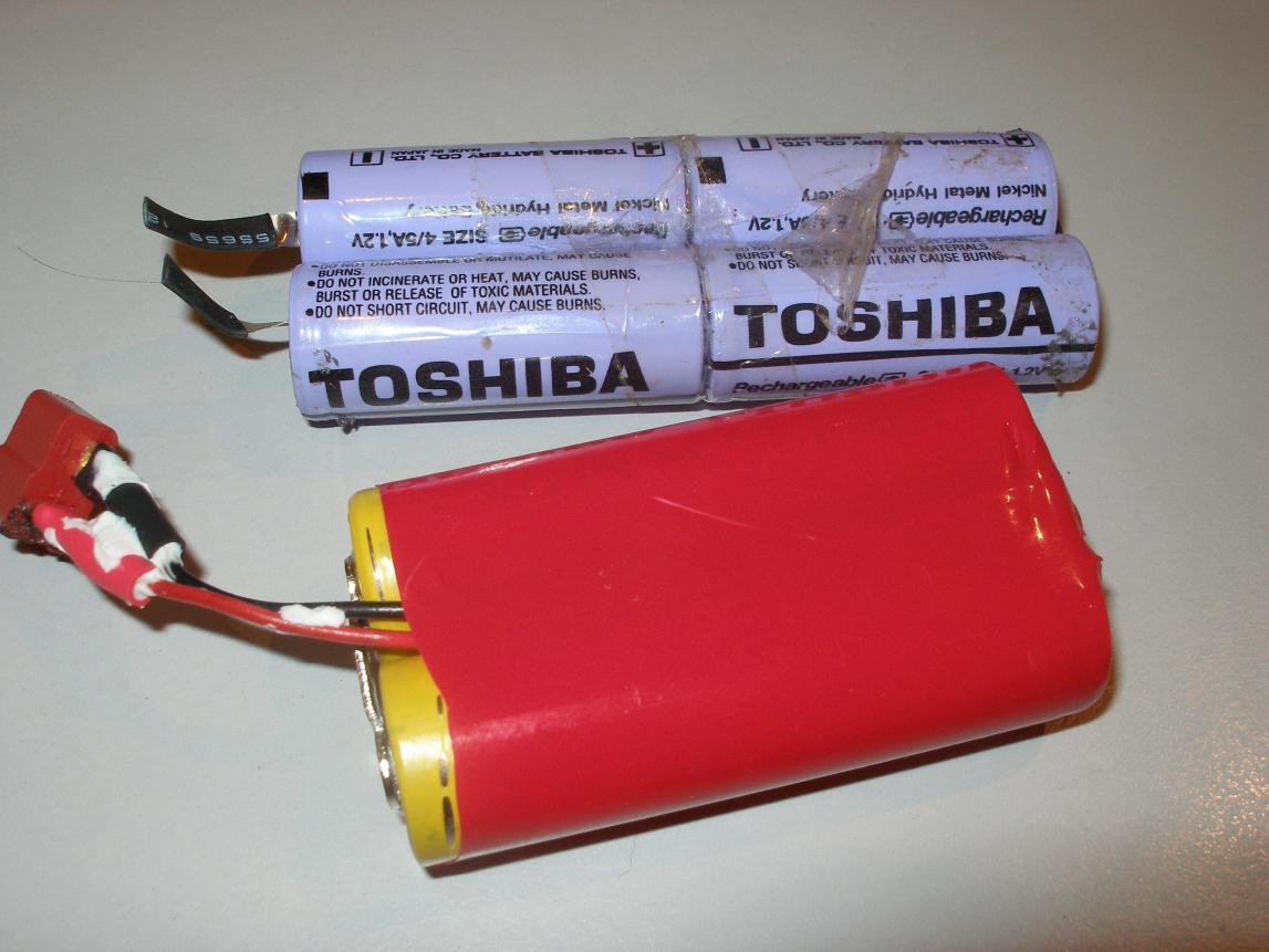

    In my usual style, everything is over engineered and strengthened. Once I get a bit further on, I will profile the brass parts so they look more in scale. Strength has already been proven after one of the cats knocked the hull off the desk, it landed on the stern and slightly misaligned some parts but otherwise it escaped. Also shown is my A123 battery pack

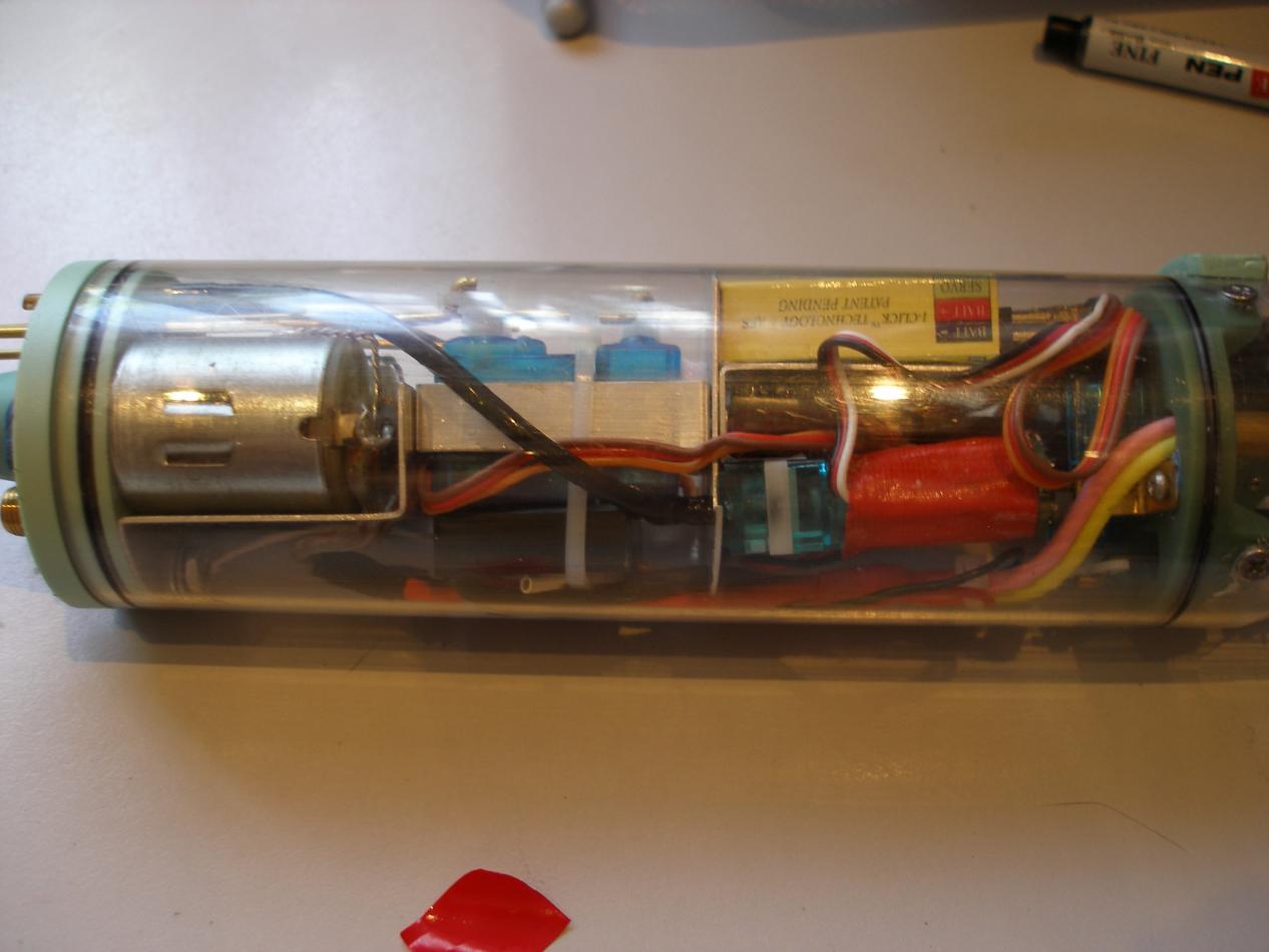

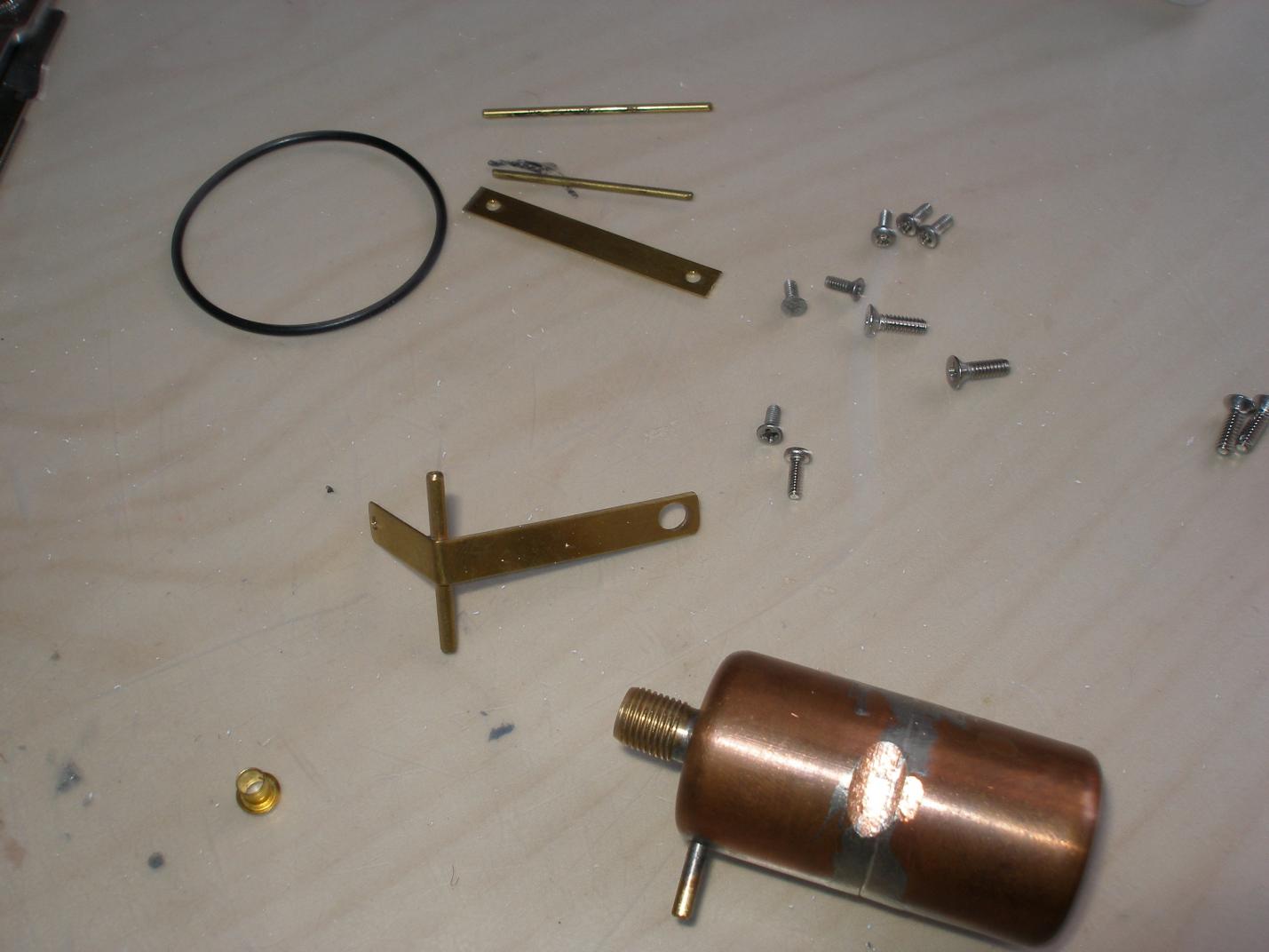

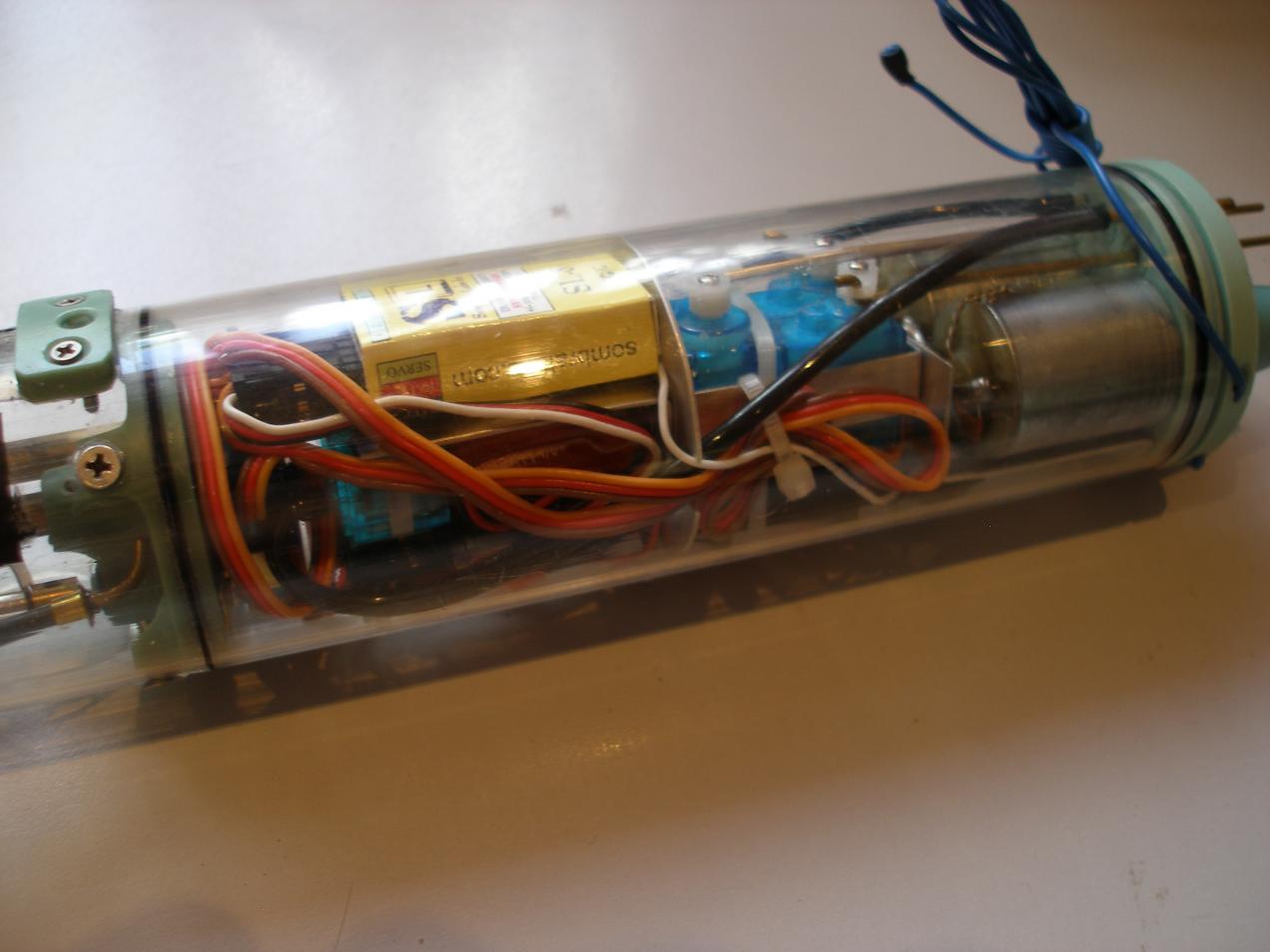

    Step two was to get the ballast tank assembled, something which I thought was going to be a mother of a job, however Tuesday was a public holiday, so I sat down and made a start. Aside from a couple of schoolboy errors (one bulkhead back to front, gas tank in wrong way round [there’s a cut out to clear the conduit]) the whole lot was together in less than an hour, and that included coffee, mistakes and general laziness 

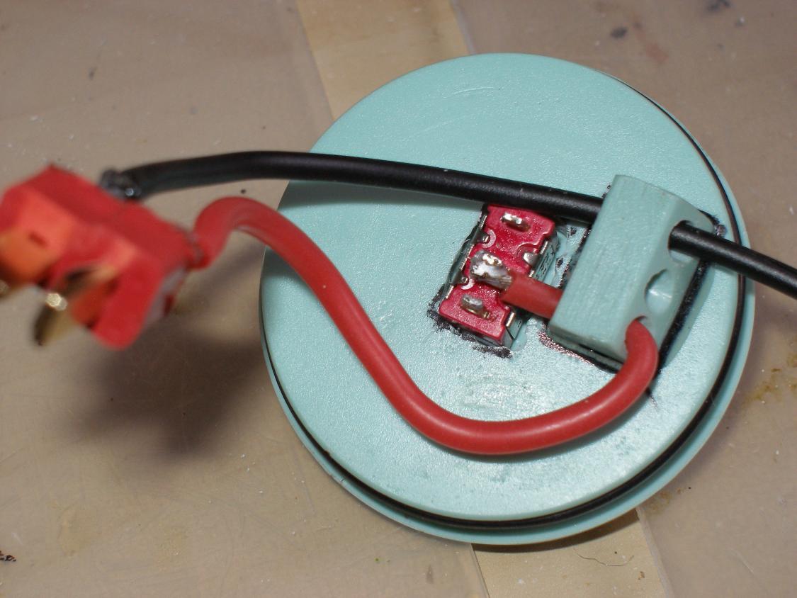

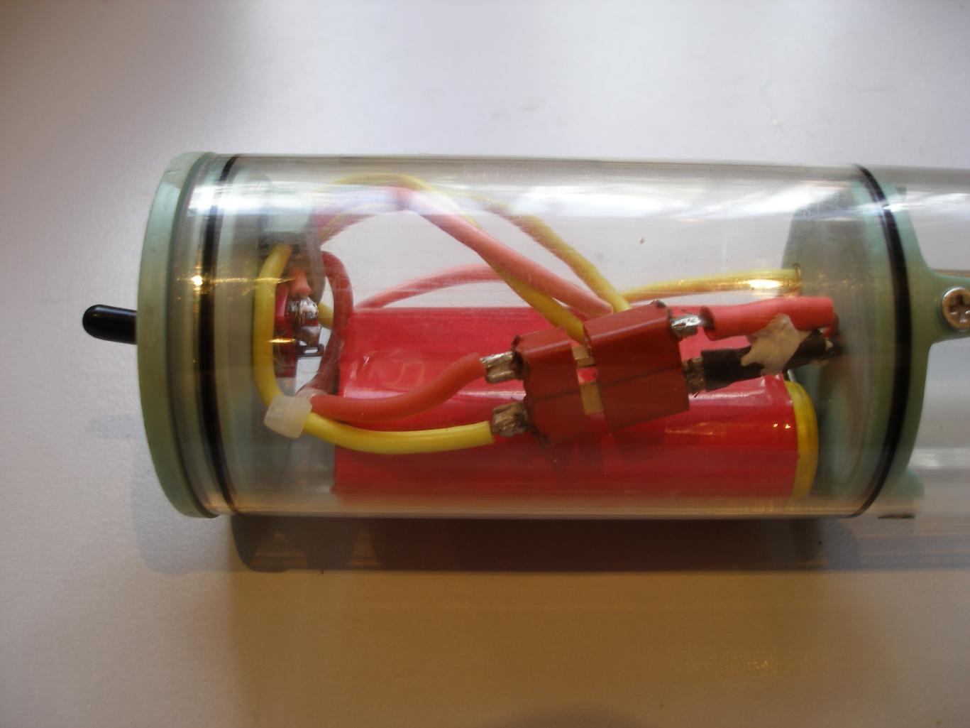

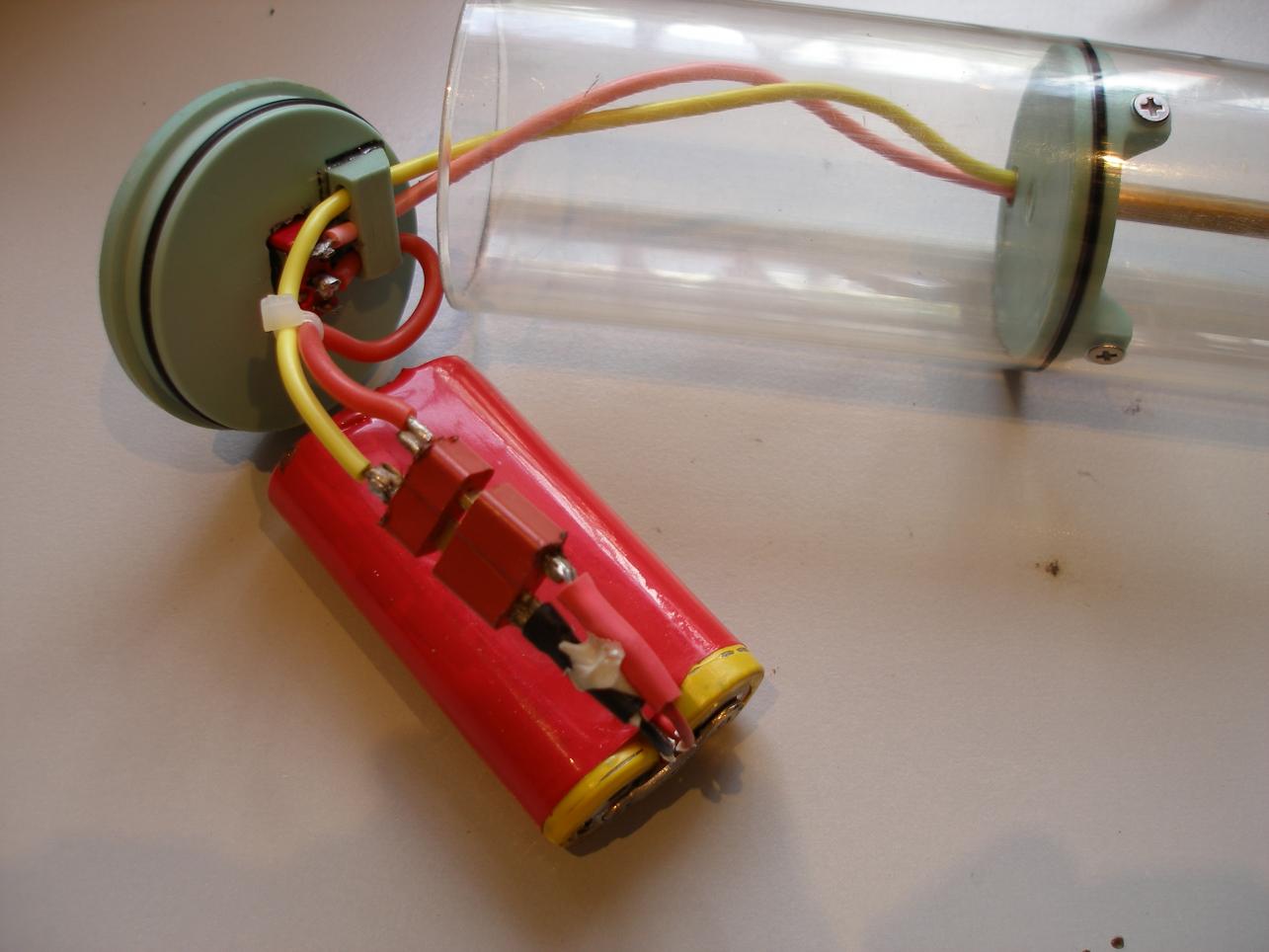

    I also fitted a switch to the dry forward end cap. Drilled a hole to accept the threaded part, then a slightly bigger recess, which I then dremmeled out into a rectangle to accept the switch body. Also drilled out the wiring strain relief block and epoxied it into place. Need to get some more silicon wire, and finish up the wiring now.
    Lastly the snort manifold was slightly misaligned, so I opened the holes up and prepped this for attaching to main bulkhead

          Not much this weekend, had a wedding Saturday. Anyways tested the ballast tank, and firstly noted it holds just shy of 250ml, not bad considering.
          Then noticed i had water getting into engine room area. Looking at the o ring it seemed to be seated ok, but there was just a whisper of water passing the o ring. Took the bulkhead screws out and wiggled the bulkhead and tried again, this time no leak. i suspect one of the screws was just pulling the lexan tube out of shape, and so i've backed off the screws a bit, they are only for axial location anyway.

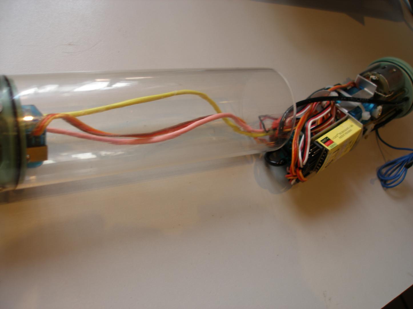

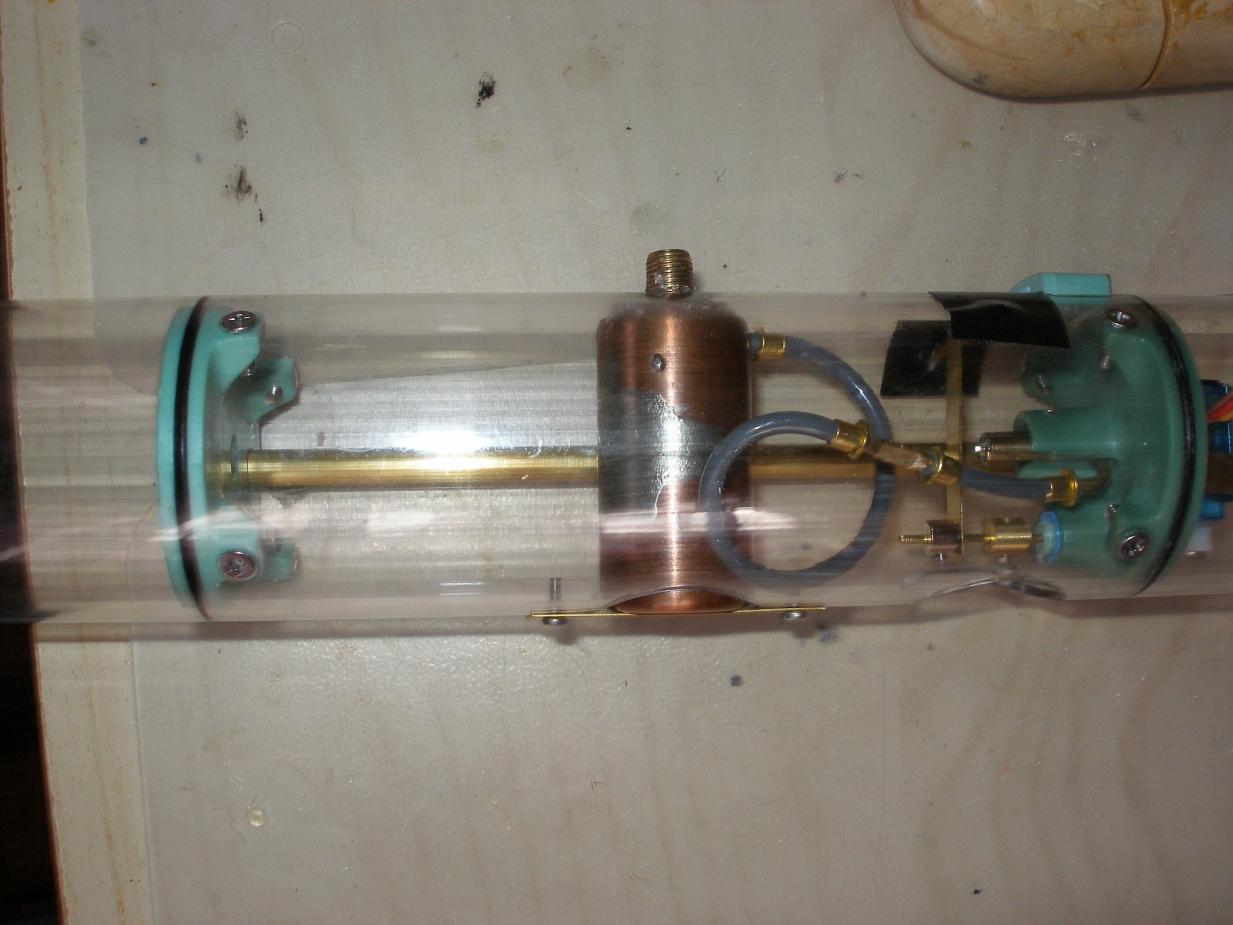

            WTC nearly assembled. Need to relocate the snort pump as the hoses are being blocked by the ballast servo. Also vent valve is leaving, do you need quite a bit of force to hold this shut???
            Lastly with the WTC central lengthways in the hull and just off the bottom of the hull, the WTC shaft ends are about 1 1/4" from the output shafts, but with around 1/2" offset. Is this normal, looks like im going to have a noisy transmission with that kind of offset

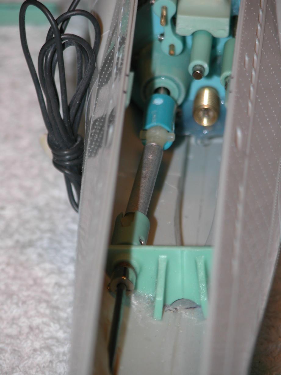

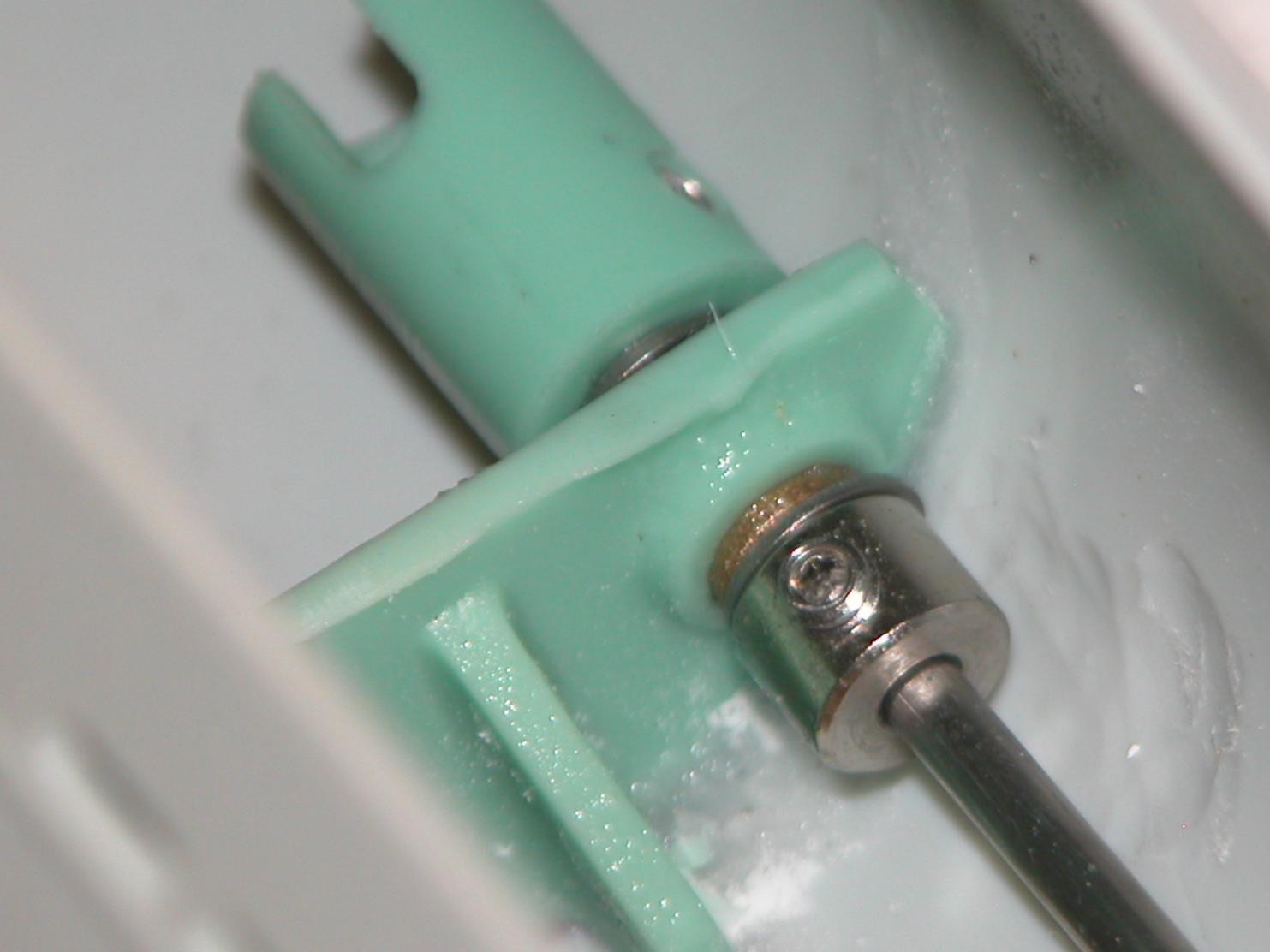

              Your running gear, from SD to shafts, should look like this:

                Looks like the drive shafts from the WTC are just beyond the rear of where the saddle tanks fair into main hull. If thats the case i should have enough spacer length.

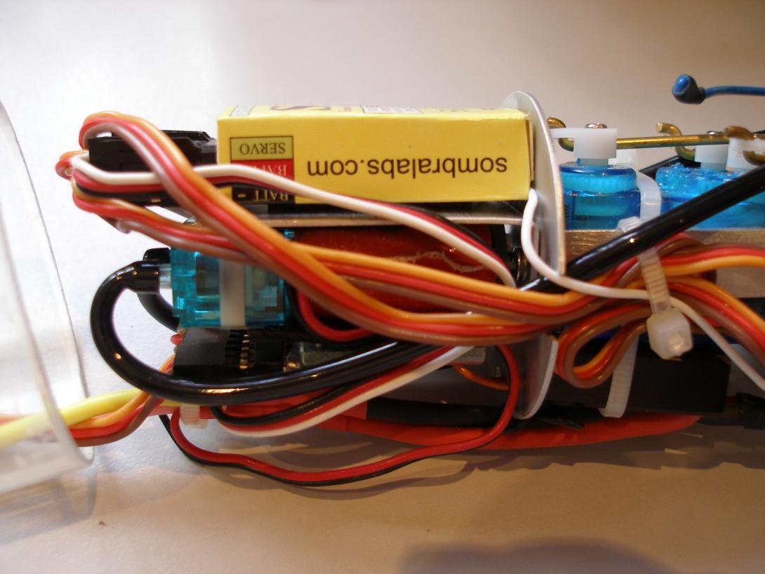

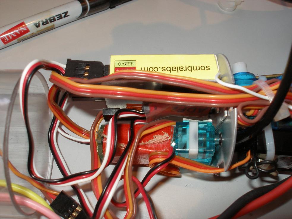

                Here's the assembled WTC now using the sombra SL-8 which works flawlessly with the ADF.
                Still slightly leaking through vent valve, which also doesn't seem to open very well. but we are getting there

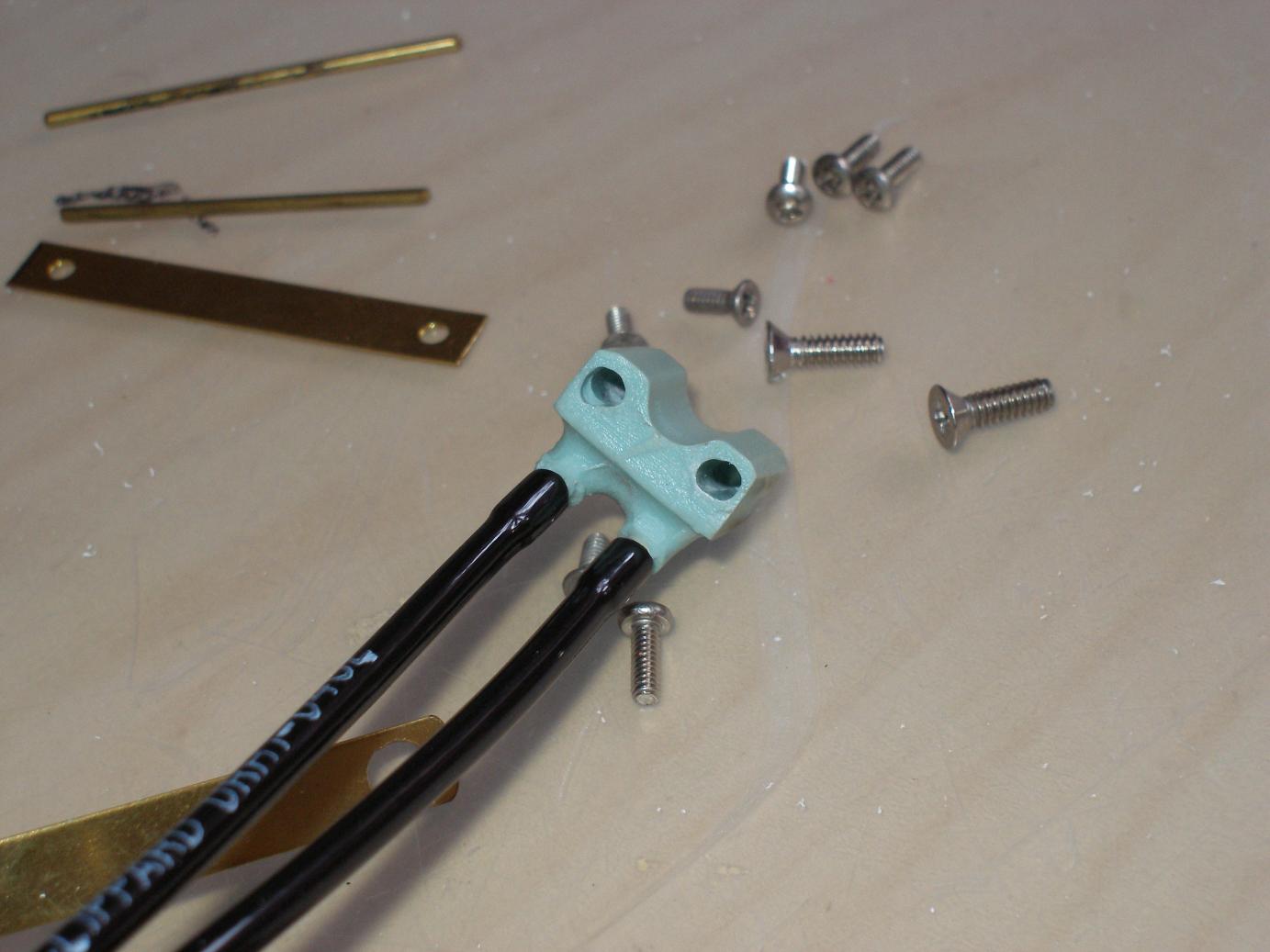

                  Thanks to all your photos, I've found out where a couple of the parts to my Gato are supposed to be used! The wire strain block is for the switch and the dog bone with set screws is for the forward planes. I swear, building this sub is like putting together a puzzle without a box top photo to guide you. I think it makes a better builder out of you. It makes you really think.

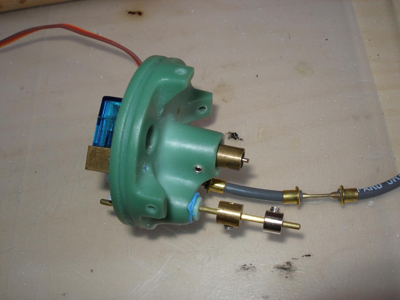

                    Geez, i was having a really bad time with the vent valve, i was getting leaks or not venting at all. I was at stalemate. So i went back to the transmission side of things. I got my drive shafts remade. Re aligned my inboard bearings and generally made the boat more tidy (remember I'm not using the fittings kit! I got the WTC nicely installed in the hull, and realised they way forward now was to finish the WTC. I was glancing over the caswell website and found this
                    Doh, this is exactly what i needed, so three things to adjust
                    Wheel collars
                    Schrader valve ( I didnt know this, double doh)
                    and lastly the the vent valve itself.
                    Not realising the second part i was trying to make the vent valve work in harmony with the schrader, not realising the schrader could be moved. As David says in the video, last resort is the vent valve. I had been taking my vent valve on and off and resealing it and losing a day every time.
                    Anyway a couple of hours (i had to reset the RX and the ADF) and every thing is working well. Should be able to get it properly wet after christmas :)

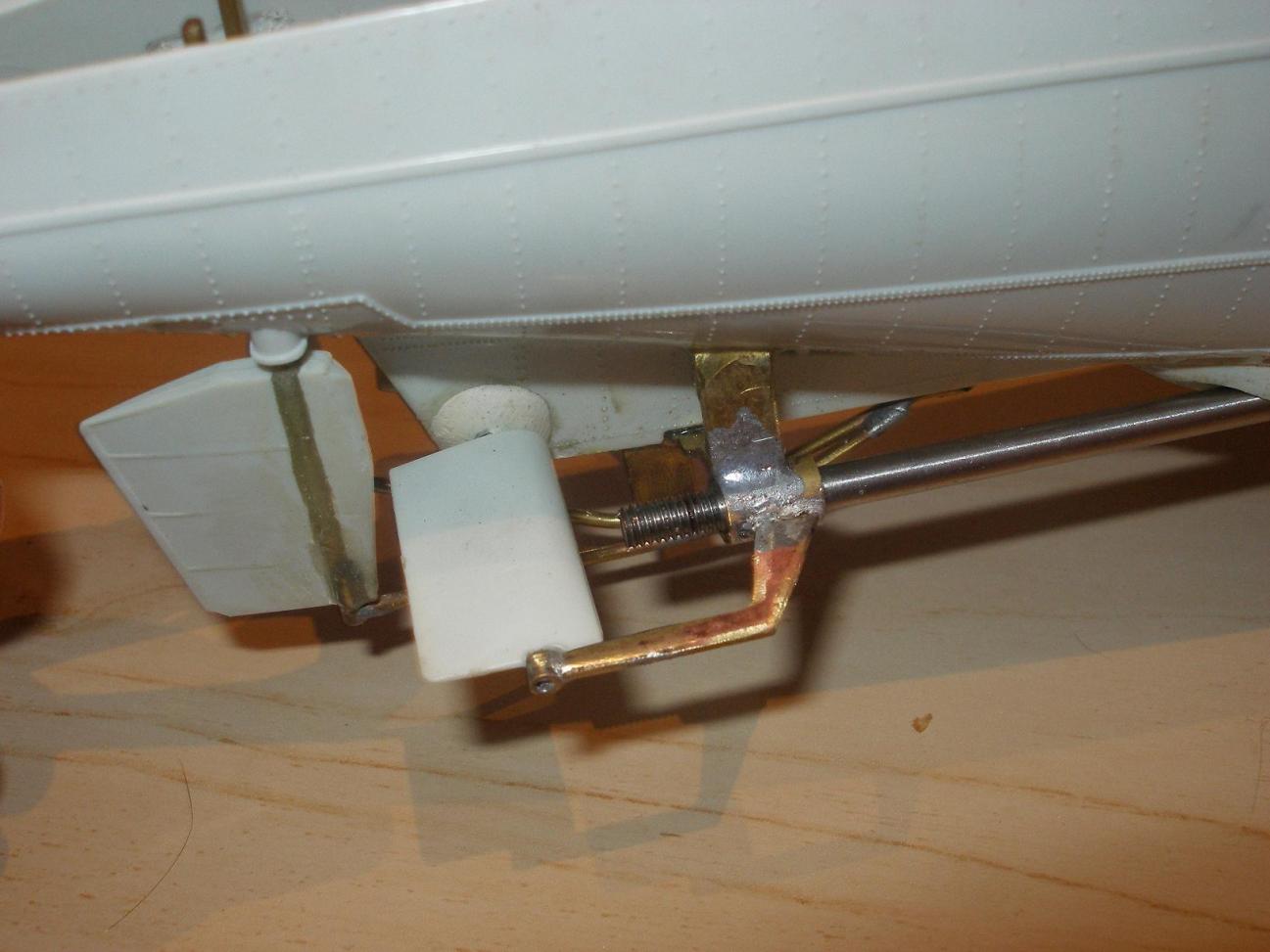

                          will post some photos of my twin rudder setup soon. Not as neat as the gear system, and its not parallel on full turn, but do i care :) Cut down wheel collars, brass rod and some soldering

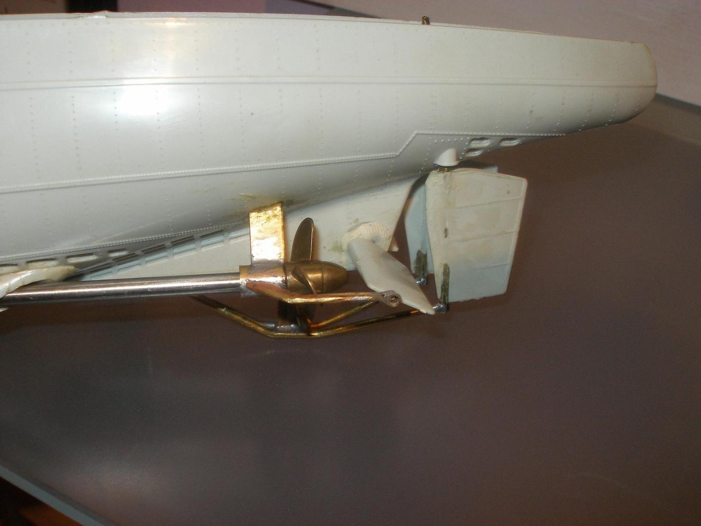

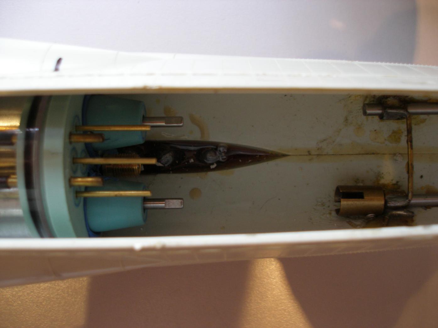

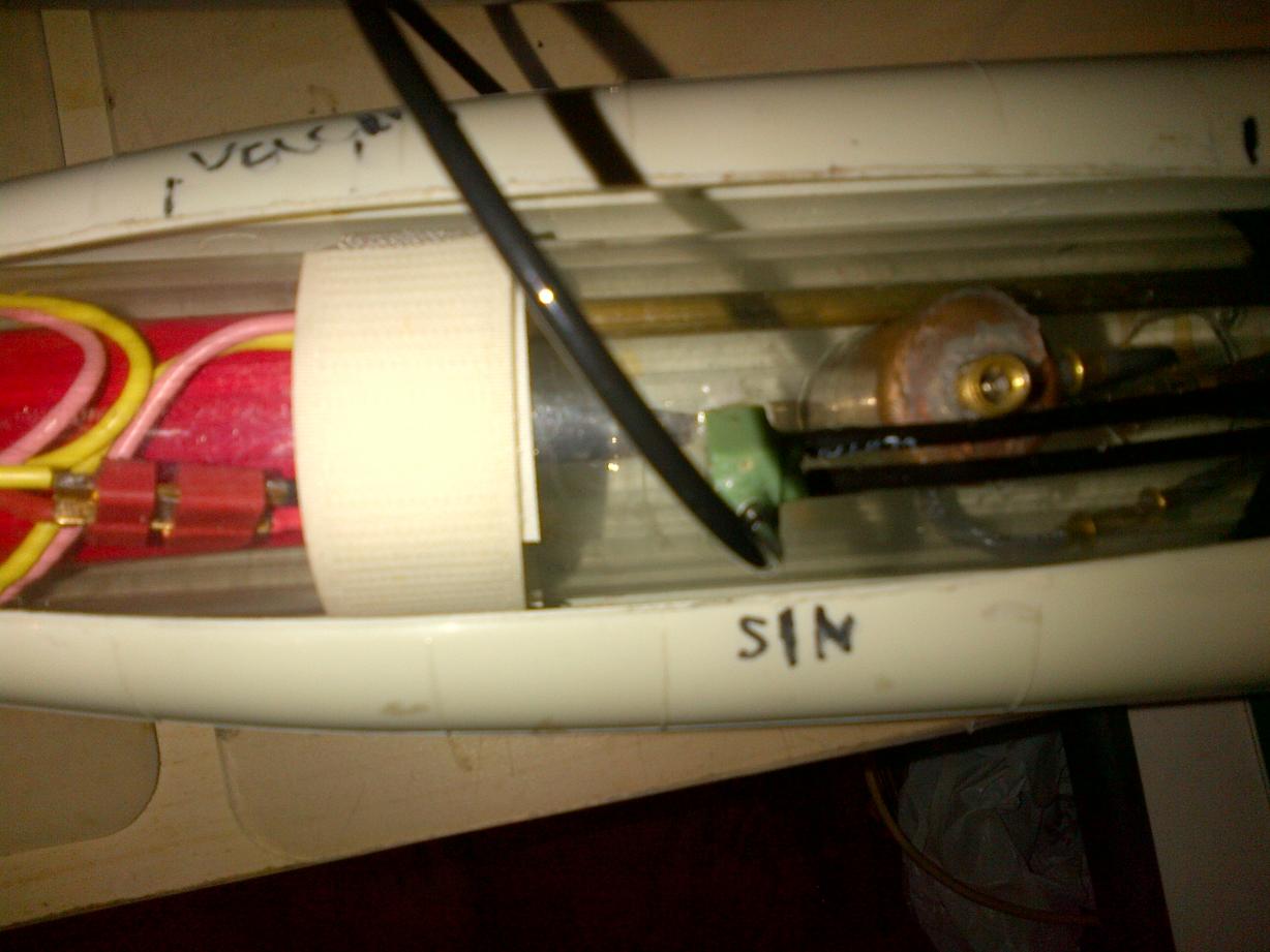

                            slowly slowly. some brackets to hold velcro strap in place and hold the WTC tight. You might think the snort is in wrong place, however im building a Snorkel type VII, so using the snorkel mast for snorting

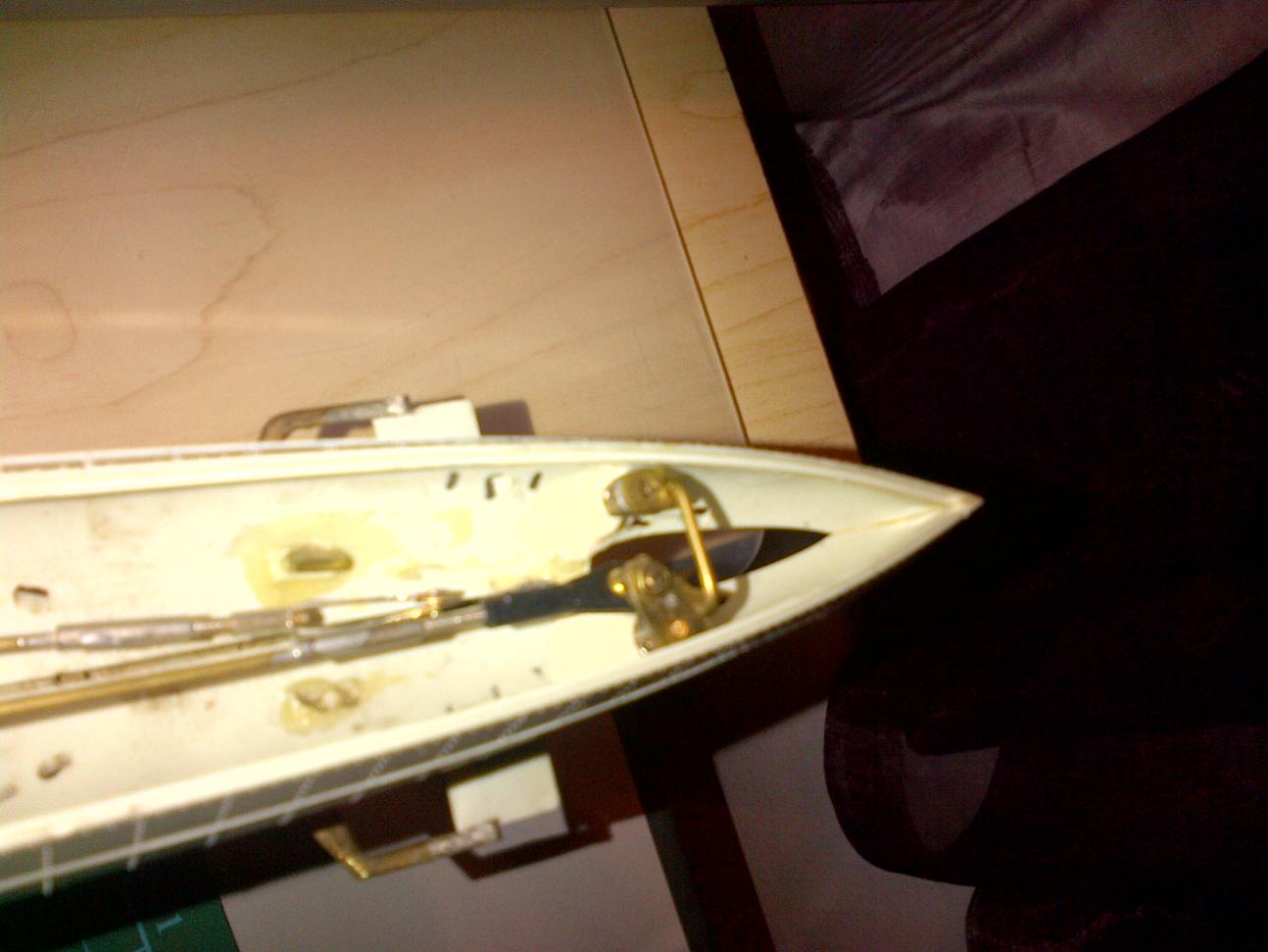

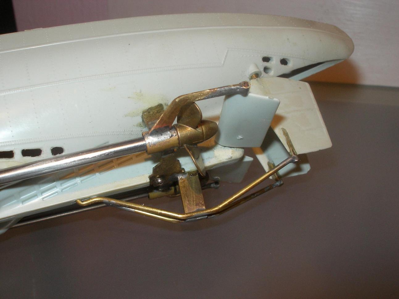

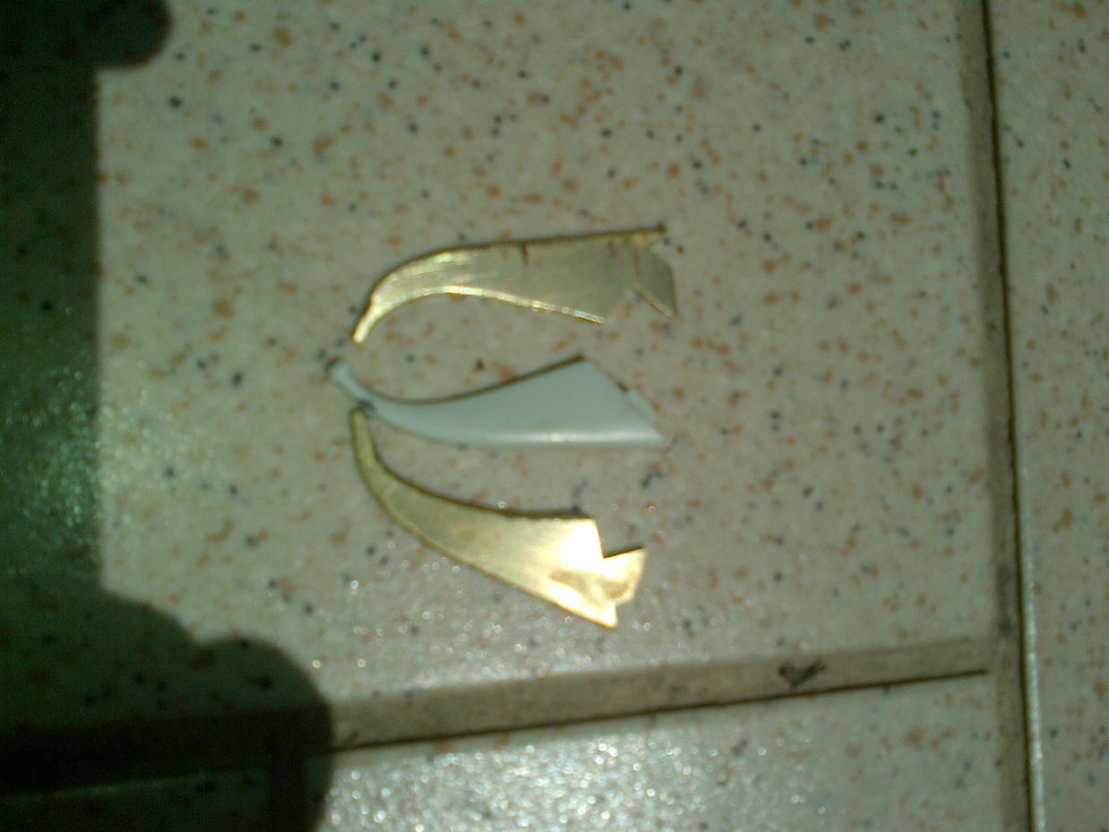

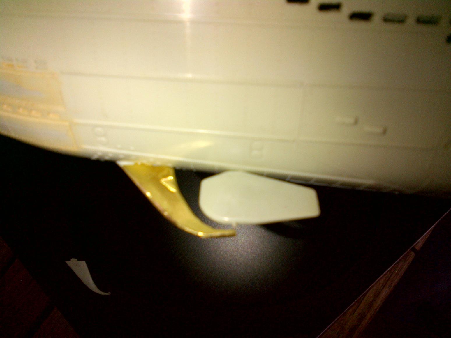

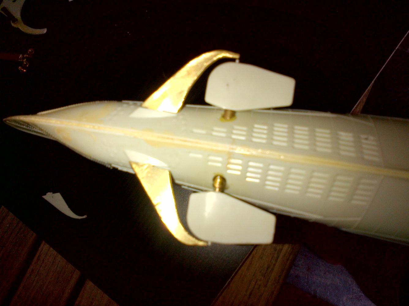

                            Then the guards for the bow planes, again im using brass to avoid anything snapping off :)
                            Also shown is the twin rudder control
