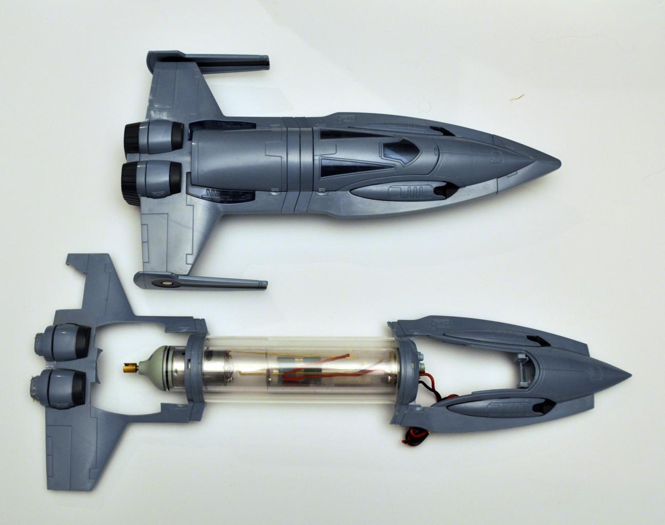

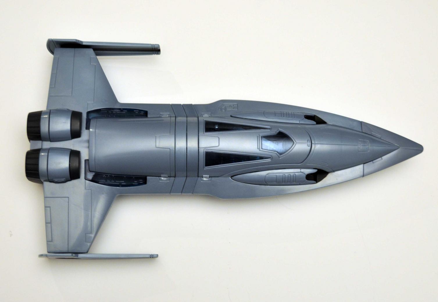

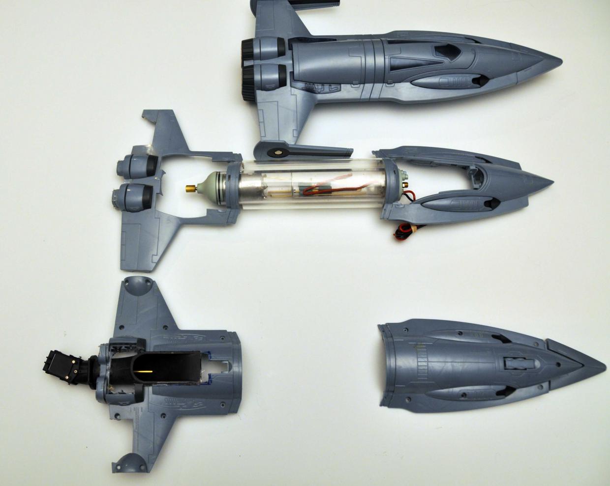

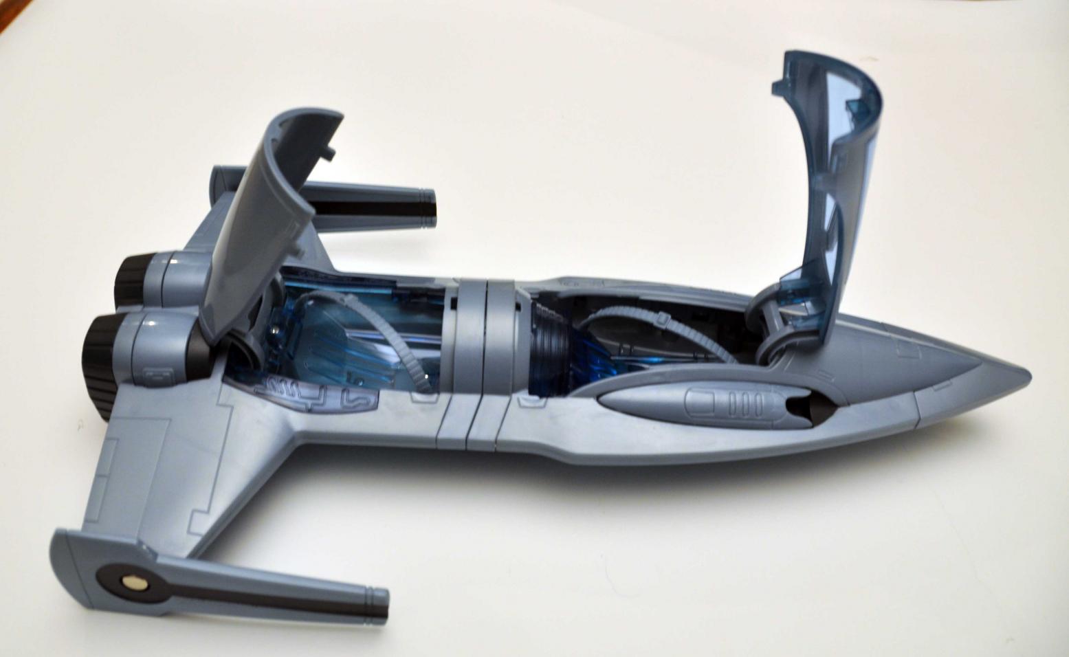

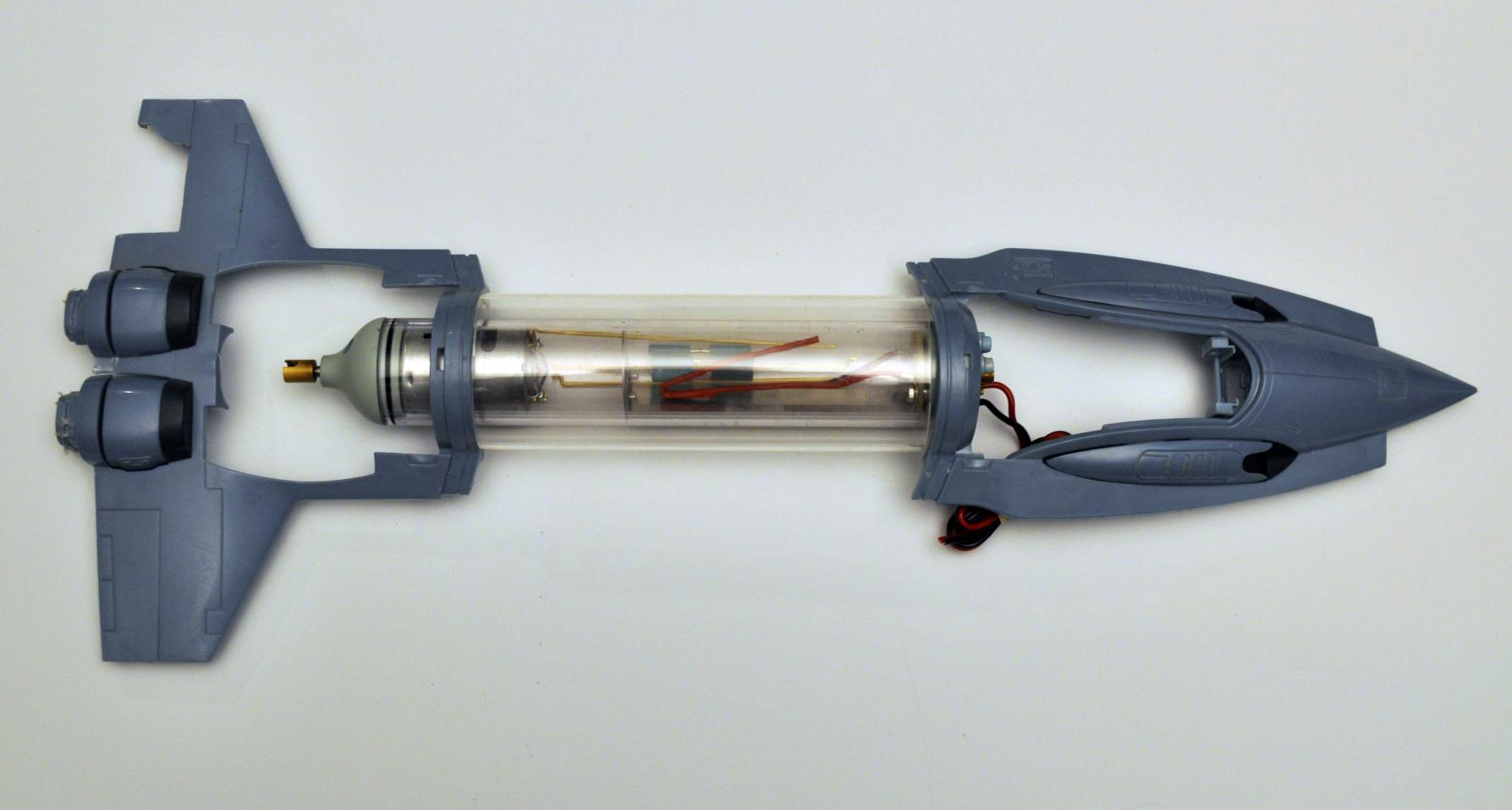

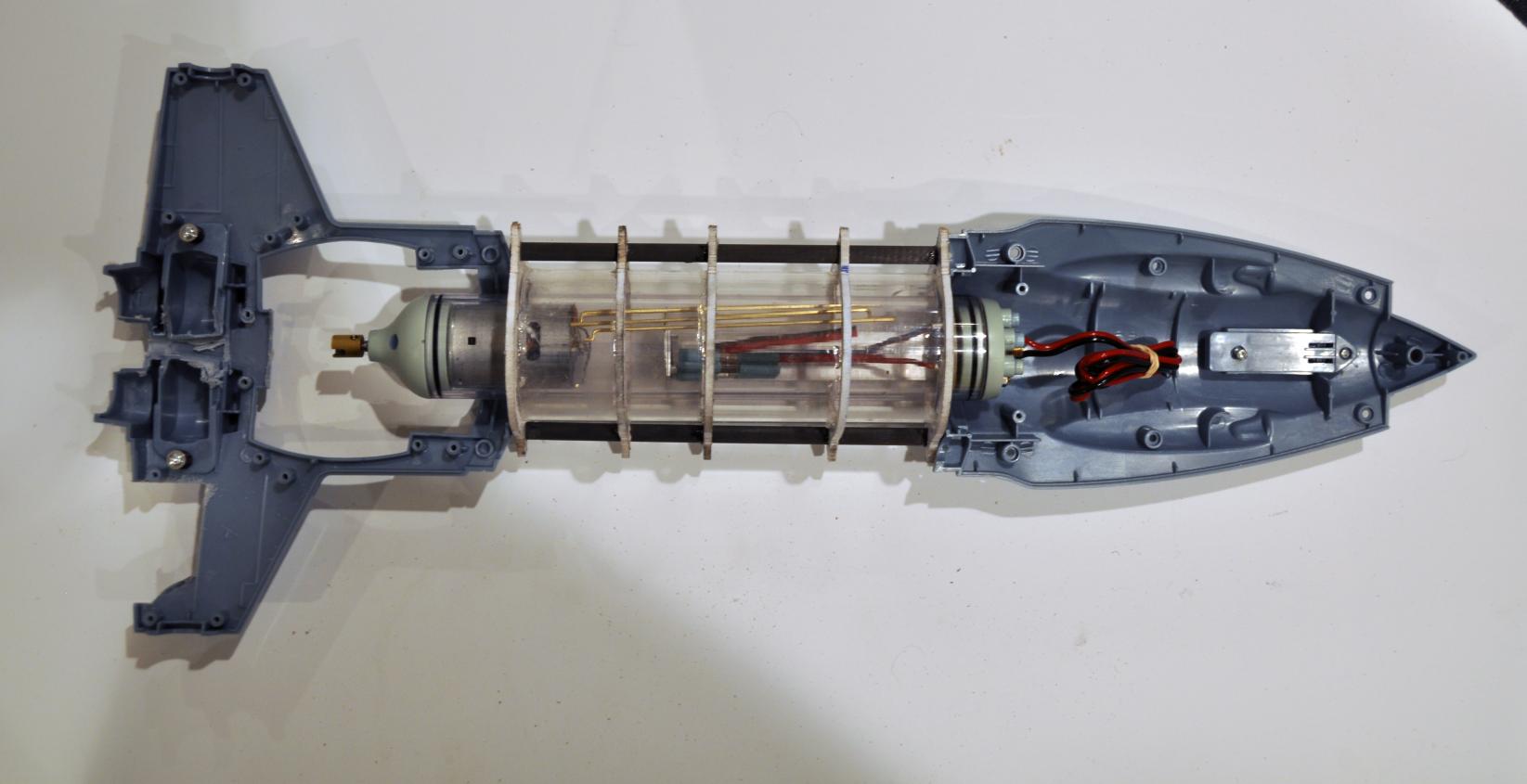

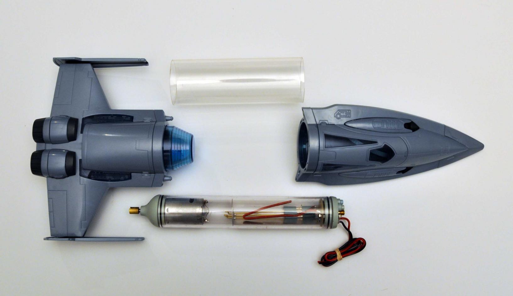

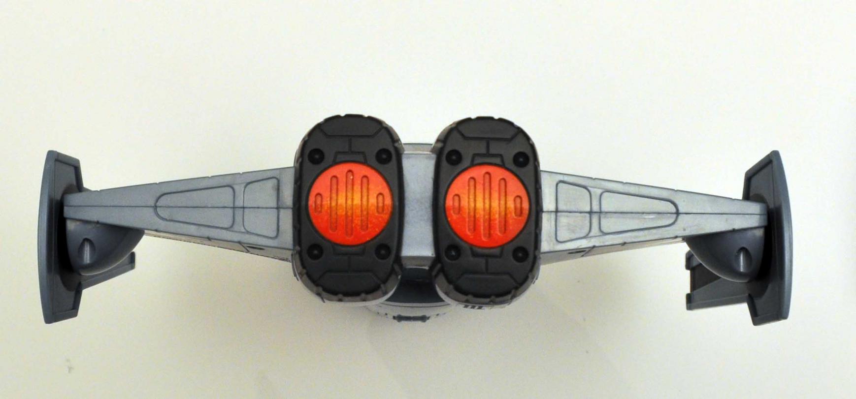

          Explanation of previous photographs [left to right]:
          1. Javelin 7 model as it arrived from ebay seller.
          2. Model of Javelin 7
          3. Hatches open showing easy access
          4. top model is 17 1/2 inch long and bottom one dissassembled with SubDriver placed in approximate location is 24 !/2 in long
          5.Bottom shows view of KMB Jet Drive installed
          6. Another view with lexan 7 inch extension tube with subdriver in it.
          7. Lexan tube, model halves and subdriver.
          8. Rear view of model . The entire model came apart by simply unscrewing the different sections. Except the rear area- The two black oval areas with the red center was glued and needed to be cut apart and peeled away. The glue was silicone and strechy.

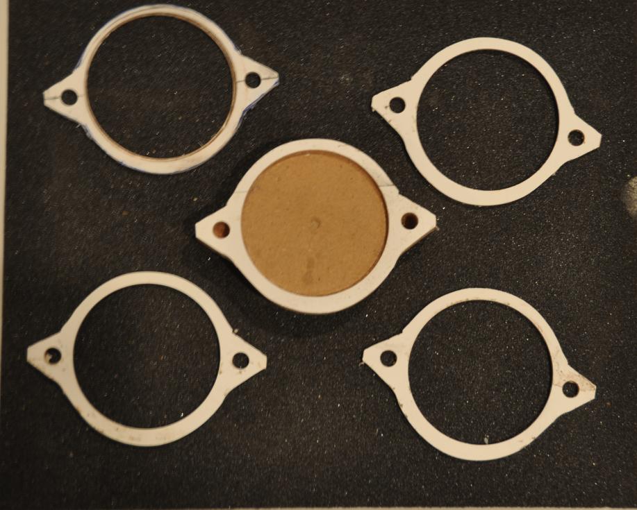

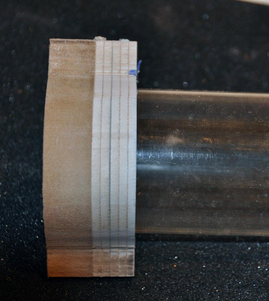

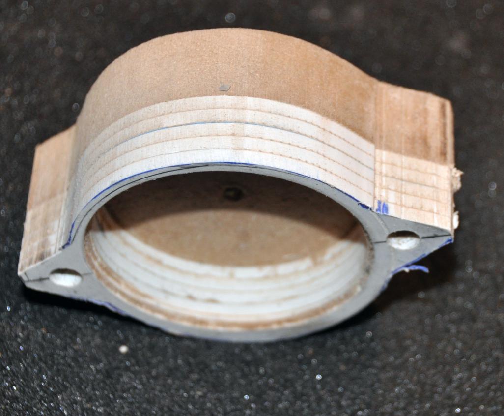

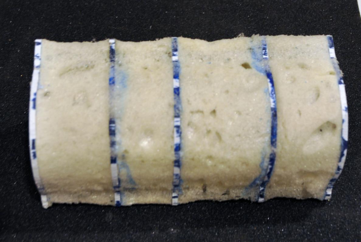

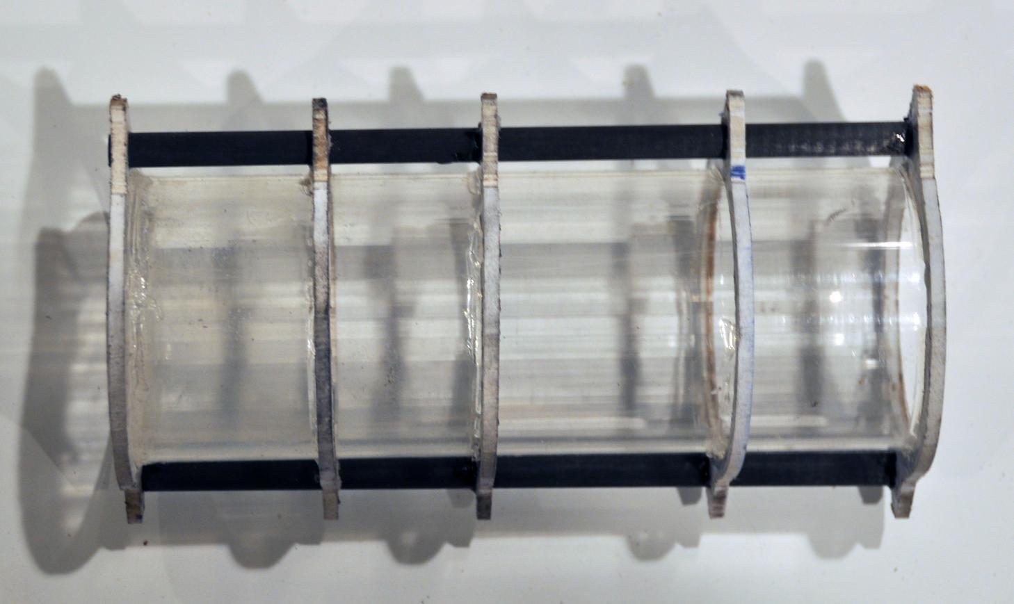

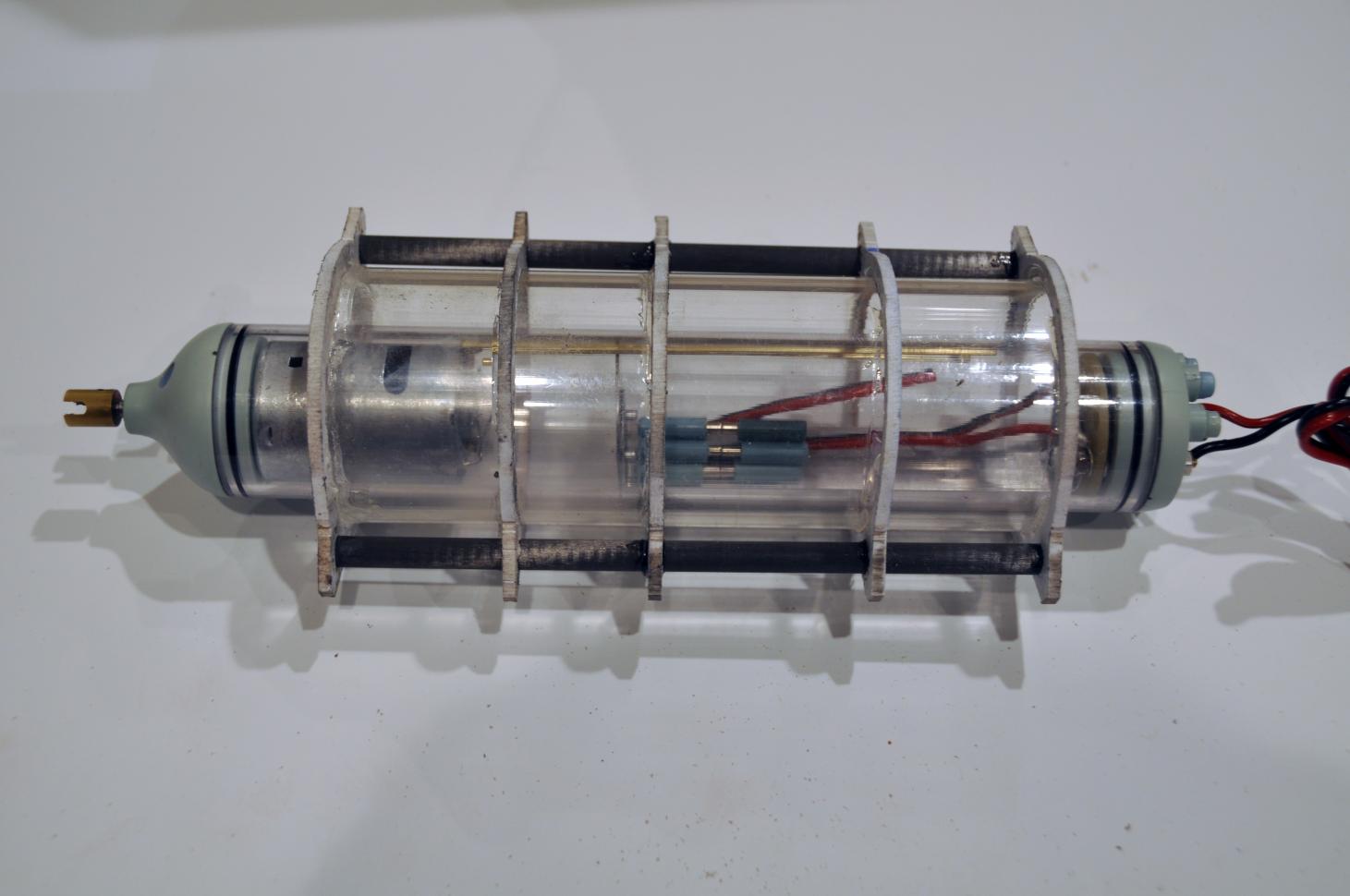

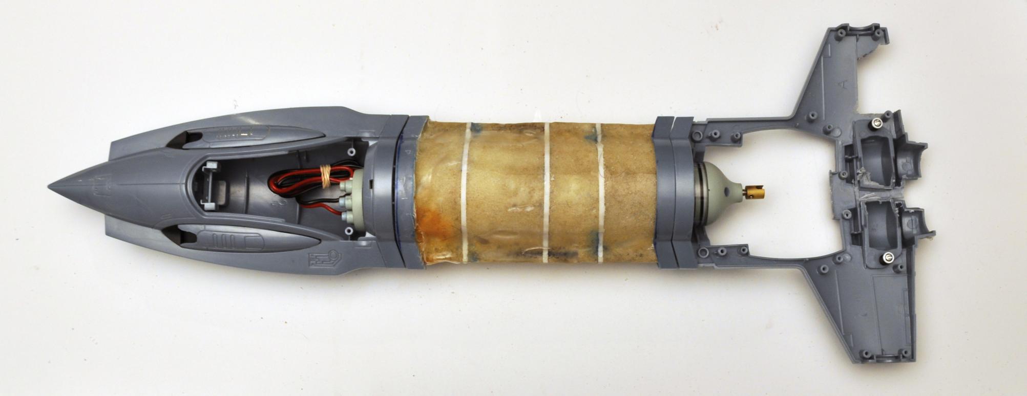

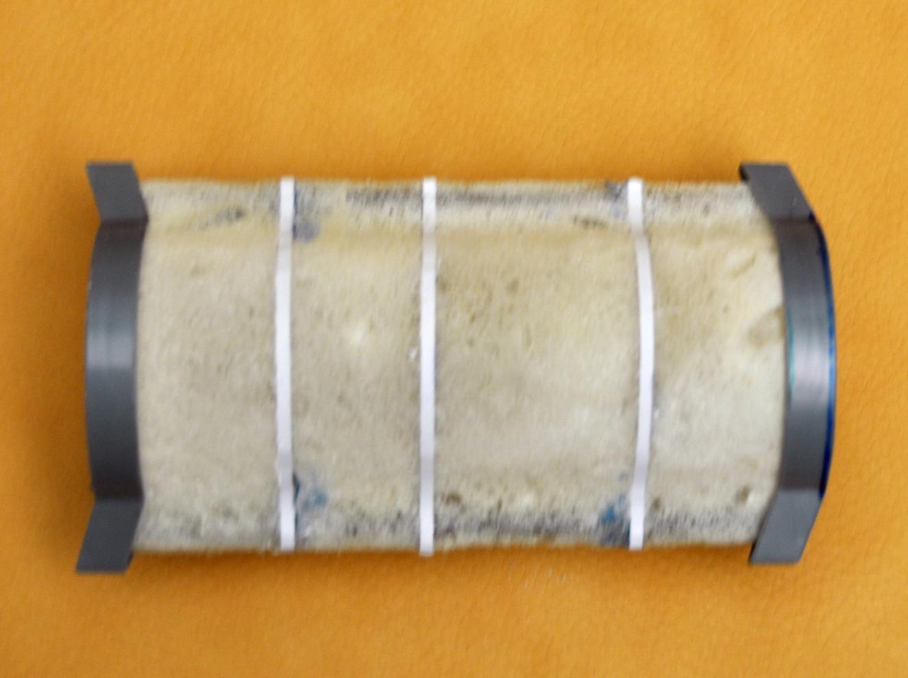

                      I am building the extended center section of the sub. Five ribs were made as follows:
                      Styrene was cut into five equal rectangles that were 1/4inch larger than the final rib size. Each piece was temporarialy attached to each other and to a waste block of wood with indoor-outdoor double side carpet tape. The rib outline was drawn on the top piece of styrene. A 2 1/2 inch hole was drlled in the center with a fostner bit. two holes were drilled the size of the O.D. to snugly fit a carbon fiber arrow shaft. This makes it easy to quickly align the ribs. The outside was cut with a band saw sanded on a 10 inch disk sander and refinded with a spindle sander. A drum sander was used to open up the inside diameter so that the 2 1/2 lexan tube would snugly fit. The ribs were placed over the lexan tube, the pre-cut carbon fiber arrow shafts were inserted and the skeleton was aligned. Supper glue was used to tack everything together. Expandable foam from a spray can was used to fill the spaces. The foam was left to set over night. Rasps were used to get the rough shape. Razor blades were used to trim the excess foam back to the ends of the lexan tube. The foam and the ribs were then trimmed so that the grey plastic end caps could fit over the styrene rib at each end. This removed an extra 1/8 inch of material to allow for the fiberglass hull. The material was removed with the disk and spindal sanders. The end caps were super gued in place. Four layers of fiber glass cloth and resin were applied.
