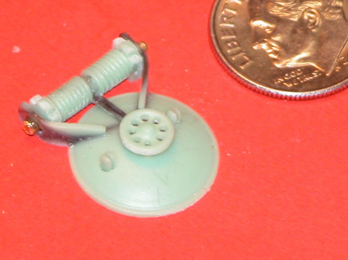

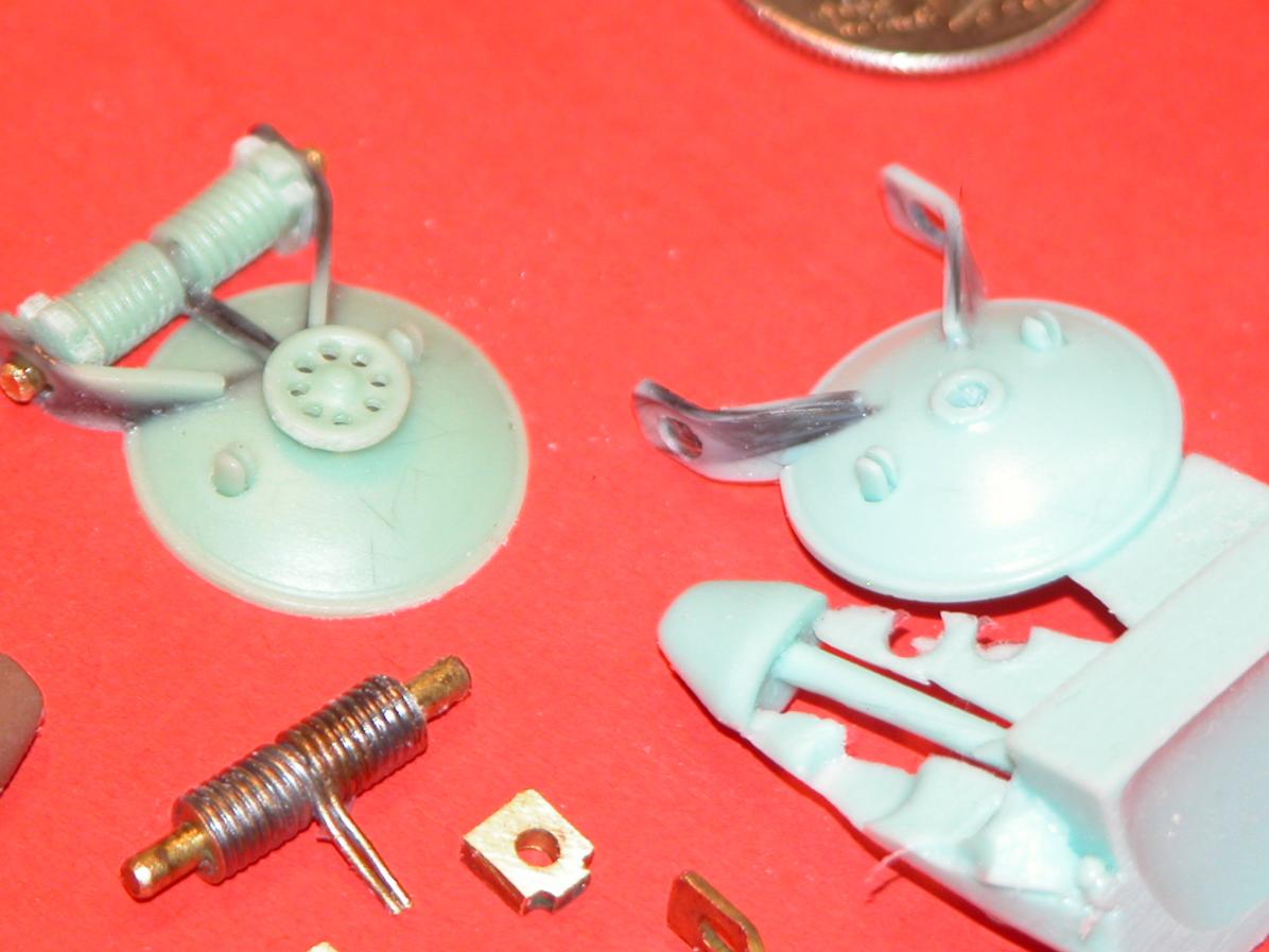

        Your pal didn't have a problem with the pressure (more is good), he had problem with his method of clamping the tool halves together -- that's what distorted the parts.
        All detail quality is driven by quality of the master and handling of the tooling rubber during mold fabrication; get those two things right, and you can capture any detail onto the part.
