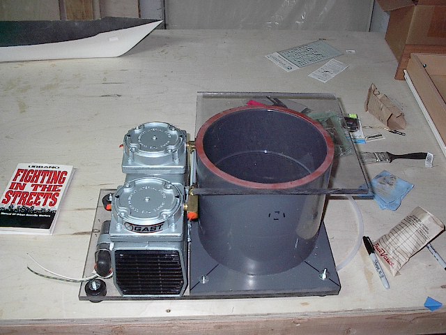

Name:	Javalin project.jpg
ID:	57711Dave I saw the video on casting resin and you said for a min of 29 hg for the vac chamber. with my new set-up
                    in the pic here i can only get 21.5 hg@5280ft alt. why 29hg? I have talked to other cast resin companys and they insist on 29hg!
                    Thanks Tom

                      Originally posted by Tom Spettel
                      [ATTACH=CONFIG]2344[/ATTACH]Dave I saw the video on casting resin and you said for a min of 29 hg for the vac chamber. with my new set-up
                      Thanks Tom
                      Your little diaphragm pump does not have the ass to pull the higher differential pressure (vacuum) needed to degass the mix. Subjecting any liquid goo to anything less than a near hard-vacuum won't separate out the gas from the mix -- that gas mostly air entrapped in the goo as a consequence of the mixing process, more extreme in situations were you are mixing a very viscus material such as RTV rubber and its catalyst.
                      You either pull 29" of Mercury or you're wasting your time. Good looking set-up you have there, but the pump ain't gonna get it done for you.

                        I have already degassed some rtv (oomoo rtv from smooth-on) and it worked great! no bubbles at all! I thought i could get away with compensating for altitude out here. no worrys the pump was a free-be. the perks of being a driver for UPS:) anyway the problem i am having
                        with air is the cast resin. Ted and i have tryed alumalite but the stuff solidifies so fast we couldent work with it. I would be willing to give it another try though..
